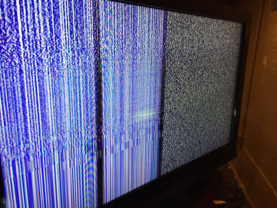

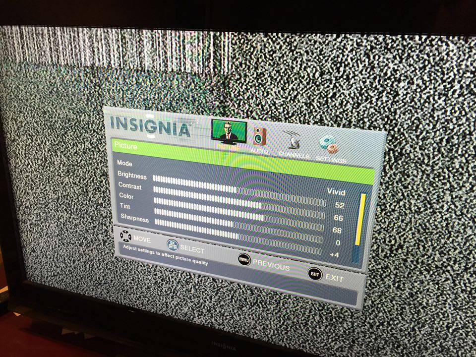

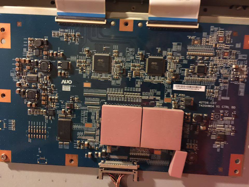

    I have an insignia that when i first turn it on, the screen is perfect. As it warms up the left half of the screen will start to get distorted and jump around and lines show up. Ill attach pictures. I am leaning towards tconn board but id just like a second opinion. thanks in advance

    try swapping the 2 cables on the tcon, or just hook up one side of the tcon board. See what happens...
