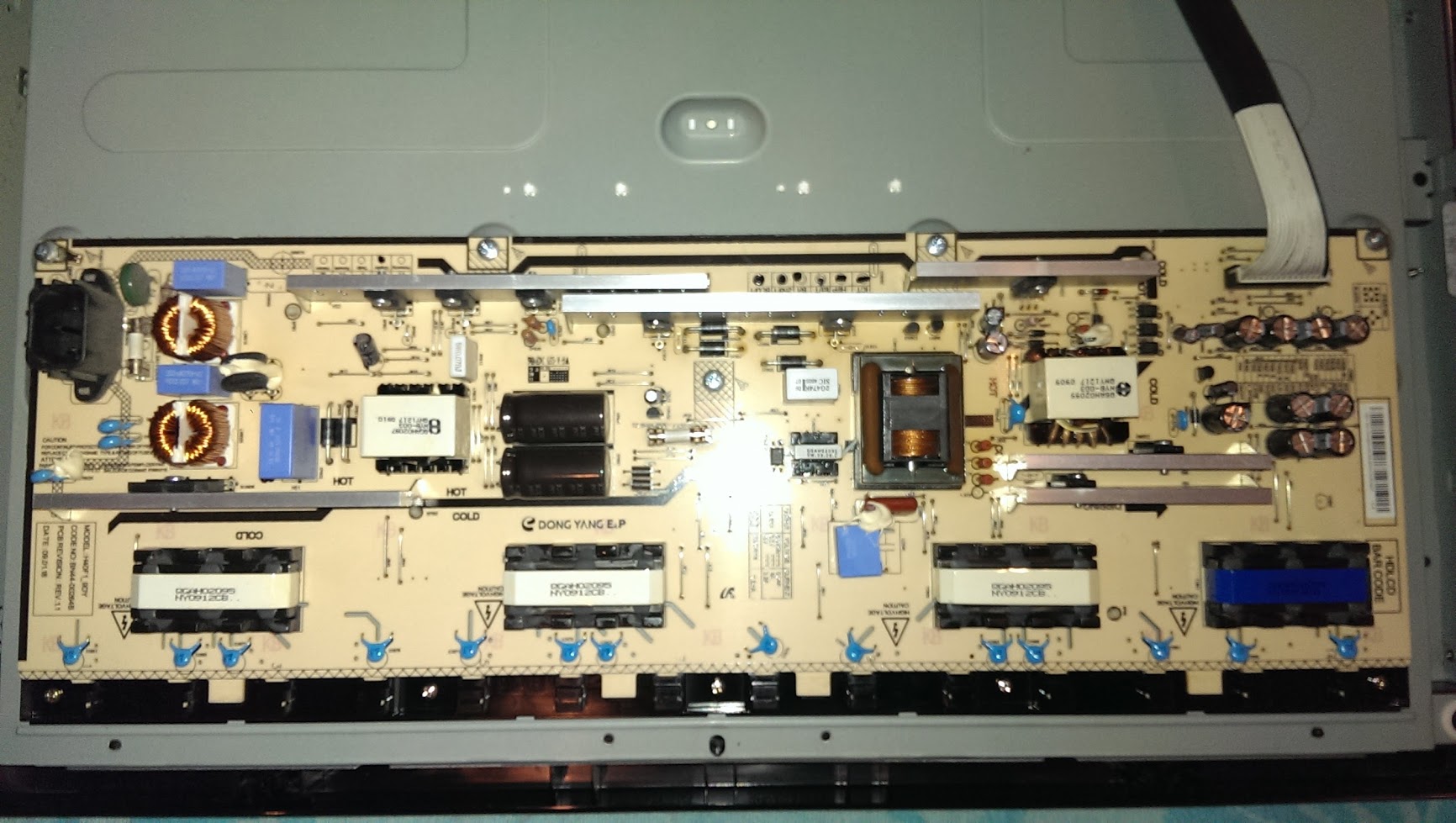

    I opened it up to see what it looked like inside. I saw some videos online that showed cutting a jumper solved the problem, but it turned out my motherboard was different. I did blow out all the dust from in there which there was a good bit. When I put it back together and turned it on it was working fine. I don't know if that was from removing the dust or that certain parts got discharged.

    Cutting the jumper is not a real fix, all it did is bypassing the protection circuit.

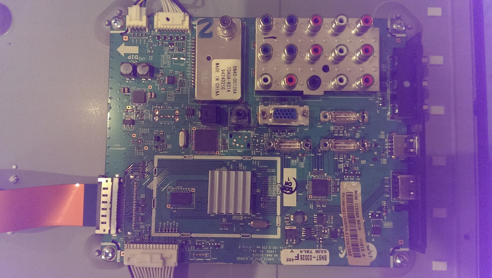

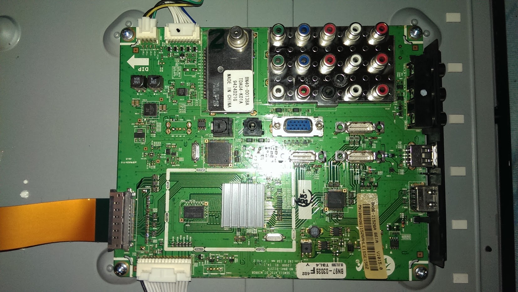

    How about uploading the pictures of the whole back side of the TV and the boards so we can see what we are dealing with?
      Re: Samsung ln40b540p8f flickering
      Sorry for my delay. I was procrastinating on taking the thing back down and opening it up again.
      It did it one more time again. My wife needed to take a picture of a QR code on the screen and it wasn't working so I went through all the power settings but that just started the flashing again and nothing worked and it just kept flashing. Just different rates of flashing. I then unplugged it, waited like 30 seconds, plugged it back in and it was still flashing but when I went to the settings I went through all the settings again and came back around to "off" it stopped flashing again.
      Anyway, it's not flashing now, but figuring out what's causing it and fixing it would be amazing. Let me know if you need better pictures. My phone takes horrible pictures in low light for some reason now so I can break out the real camera if this doesn't cut it.

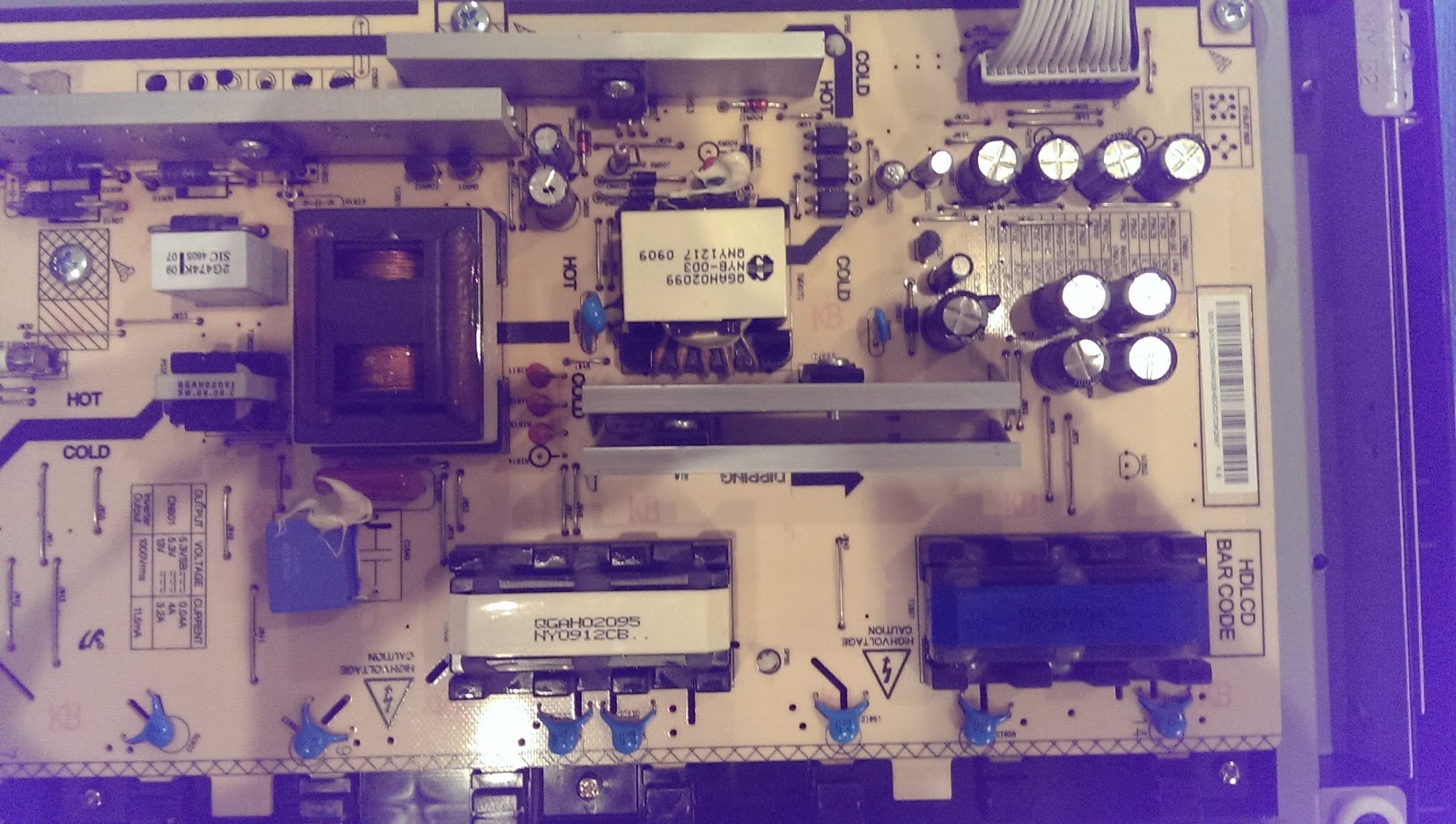

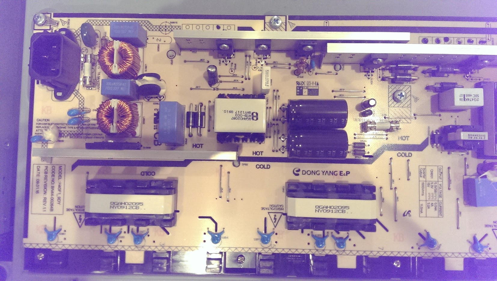

        What is the P/N of that power supply-inverter board? BN44-?????
          Model: H40f1_9dy
          Code No: BN44-00264B
          PCB Revision: Rev 1.1
          Date: 09.01.18

                Backlights are usually long slender boards that run up the length of your panel along the edge. From my experience I would say the backlights are the reason you are seeing the symptoms you are seeing, but not necessarily the CAUSE of the symptom. I would say this is likely a power supply issue, providing insufficient power to the backlights for them to modulate their flashing frequency which provides a dimming effect.
                In the case of this TV the backlights are integrated with the power supply into a single board, shown here...so it actually makes no difference lol.

                I don't see any bulging caps or obvious burn marks to say 'replace that component', but looks like this board can have some issues with the transformers burning out from the CFLs getting old and drawing too much current.

                  Yeah, from everything I've been reading it seems like the BN44-00264B board would be controlling that. The lights seem fine and they usually work fine for at least a half hour to even a few hours before the flashing starts. And every time the rate seems to be consistent based on what energy saver setting it's on. It also sounds like BN44-00264A, BN44-00264C, BN44-00284A, BN98-01984A boards are a suitable substitute.
                  I've looked over both sides of the board and haven't seen any signs of damage. The fuses seem good still. Tested some of the other parts based on a general tutorial for testing tvs and things seemed good. I would guess it's under-powered caps maybe that can't handle the heat but even if that was the case I'm not sure what a suitable replacement would be for what the board needs.
                  Currently I'm looking at just buying one of those replacement boards or shipping off my current one to be repaired, but I wish I could figure out which part of the board was controlling that, or test the caps without desoldering them. That and just trying to make sure that even if I do send it in that that board is actually the problem.

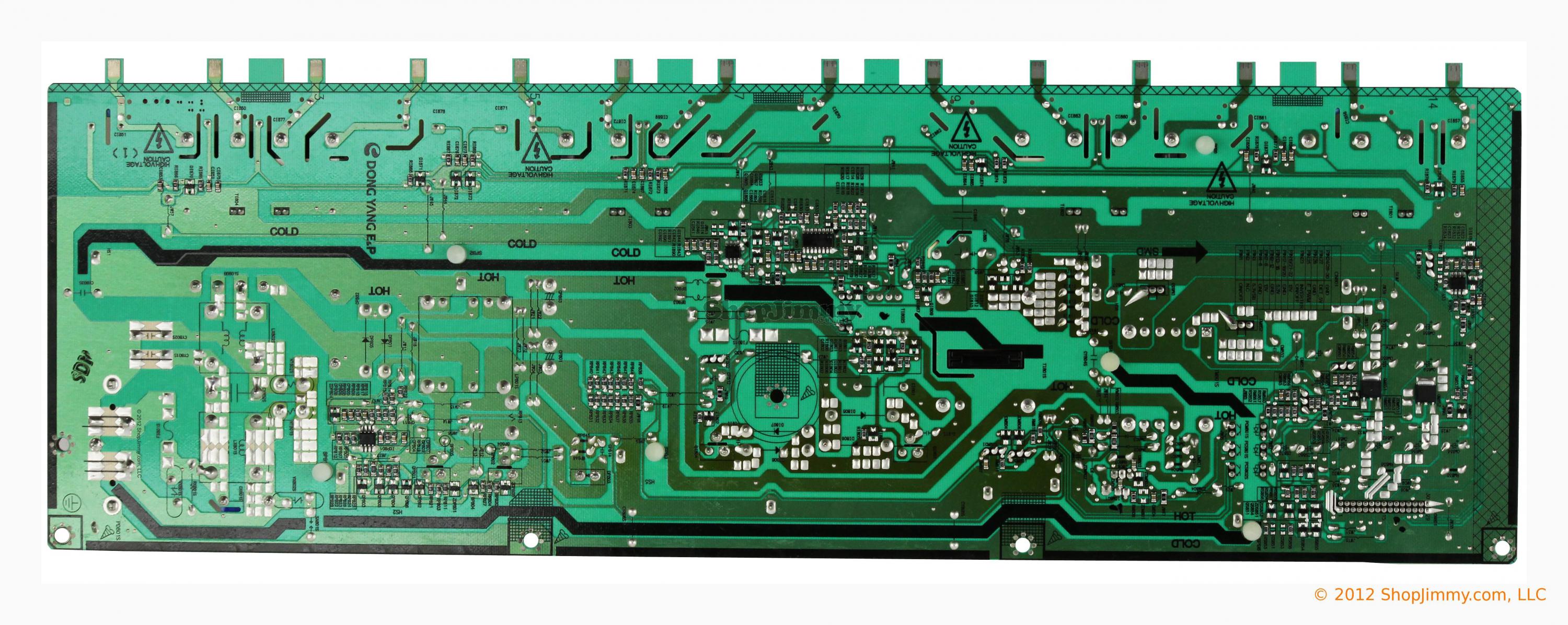

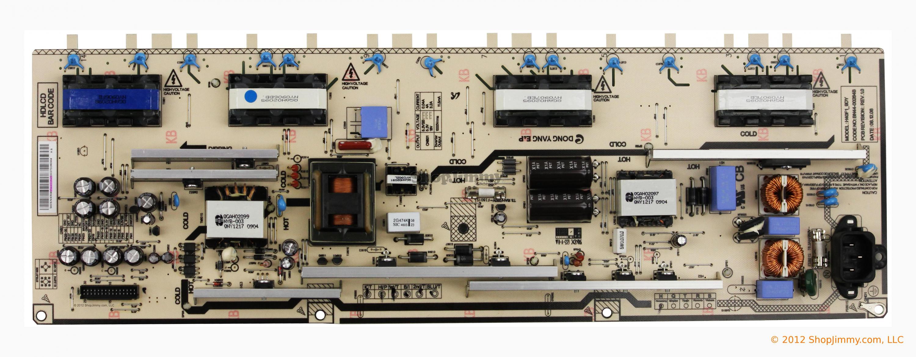

                      http://www.shopjimmy.com/catalogsear...?q=bn44-00264b
                      You have CCFL for backlights, and the board is power supply/inverter board combo.
                      What happen if you turn down the backlights level in the on screen user menu?
                      What DCV do you have measuring between the two legs of the main filter cap?

                          'Which cap is the main filter cap? Is it the two large ones?' yes.
                            Both caps are around 159.1 V it looks like.

                              It should be around 400VDC when TV is turned on, if not then the PFC Voltage booster is not working.

                                They are both about 383 volts when turned on. Is that high enough?
                                  If it is 360VDC or less then I would worry, so that is not that bad at 383VDC.
                                  Do you know if that 383, is stable when the backlights are flashing or it gets lower when the backlights level is set to max?
                                  It can also be bad lamps connections on the lamp socket or worn out lamps.

                                      Ok. Finally got it doing it. On low it was fluctuating between 377 and 381 volts, but mostly going between 378 and 379. And not at the rate of the flashing. Like every few seconds it goes up and down in voltage while the flashing is much faster than that.
                                      On the high energy save settings it's sitting at a pretty steady 380.
                                      With the energy saving setting off it's sitting at a steady 382 now after having been on about an hour.

                                        I think what we need is to look at the ENABLE signal feedding the PWM IC in the Inverter section to see if it is going High and Low when it is flickering.
                                        BN44-00264B
                                        Please get the P/N of UI801.
