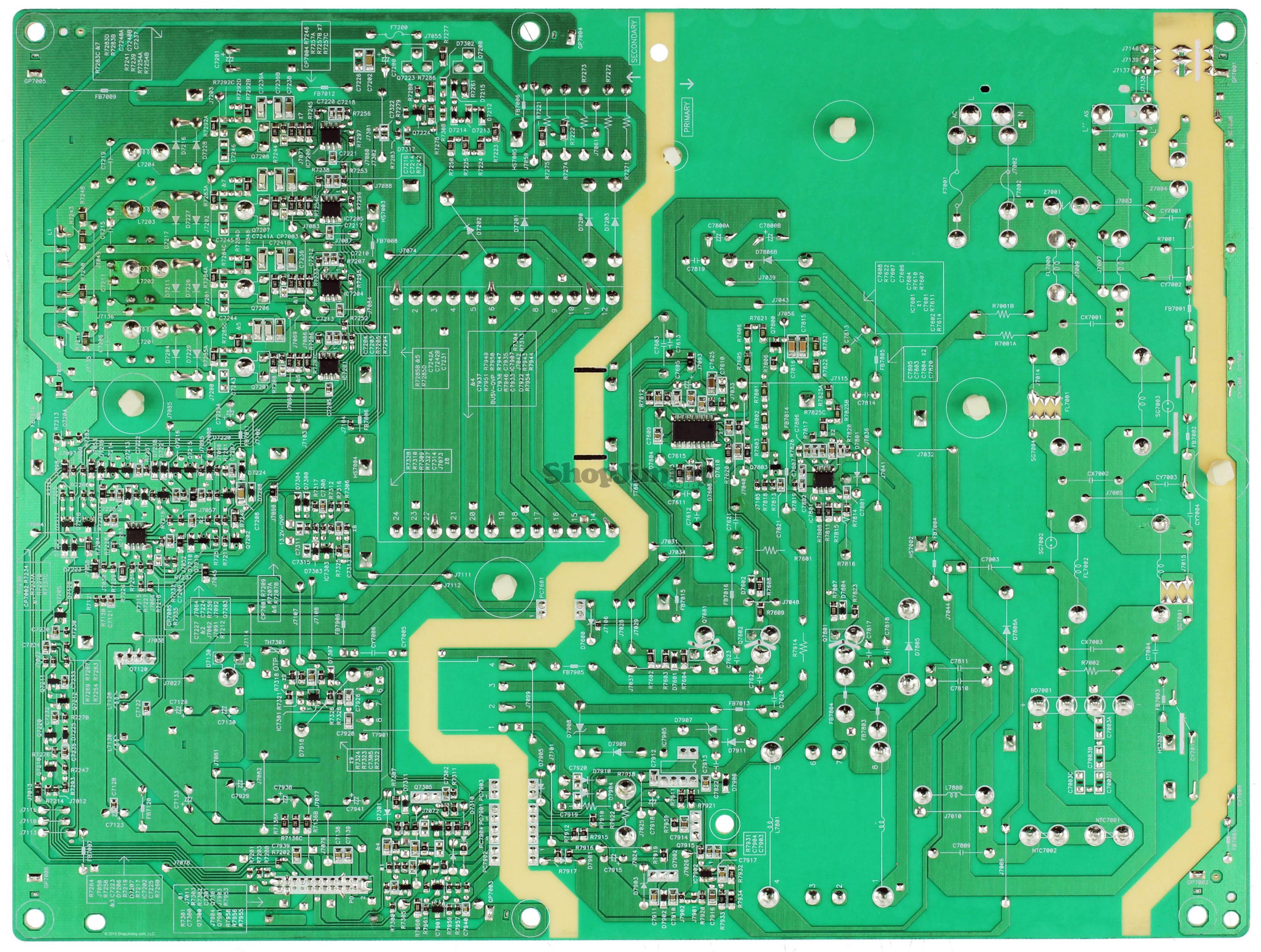

                            #33
                            Re: Sharp LC-60LE633U 2-5 flash
                            Please report the DCV reading of each L+ and L- of the LED connector.
                            Delta DPS-165HP-3A.
                            http://www.shopjimmy.com/sharp-runtk...pply-unit.htm#
                            Pictures provided by shopjimmy.

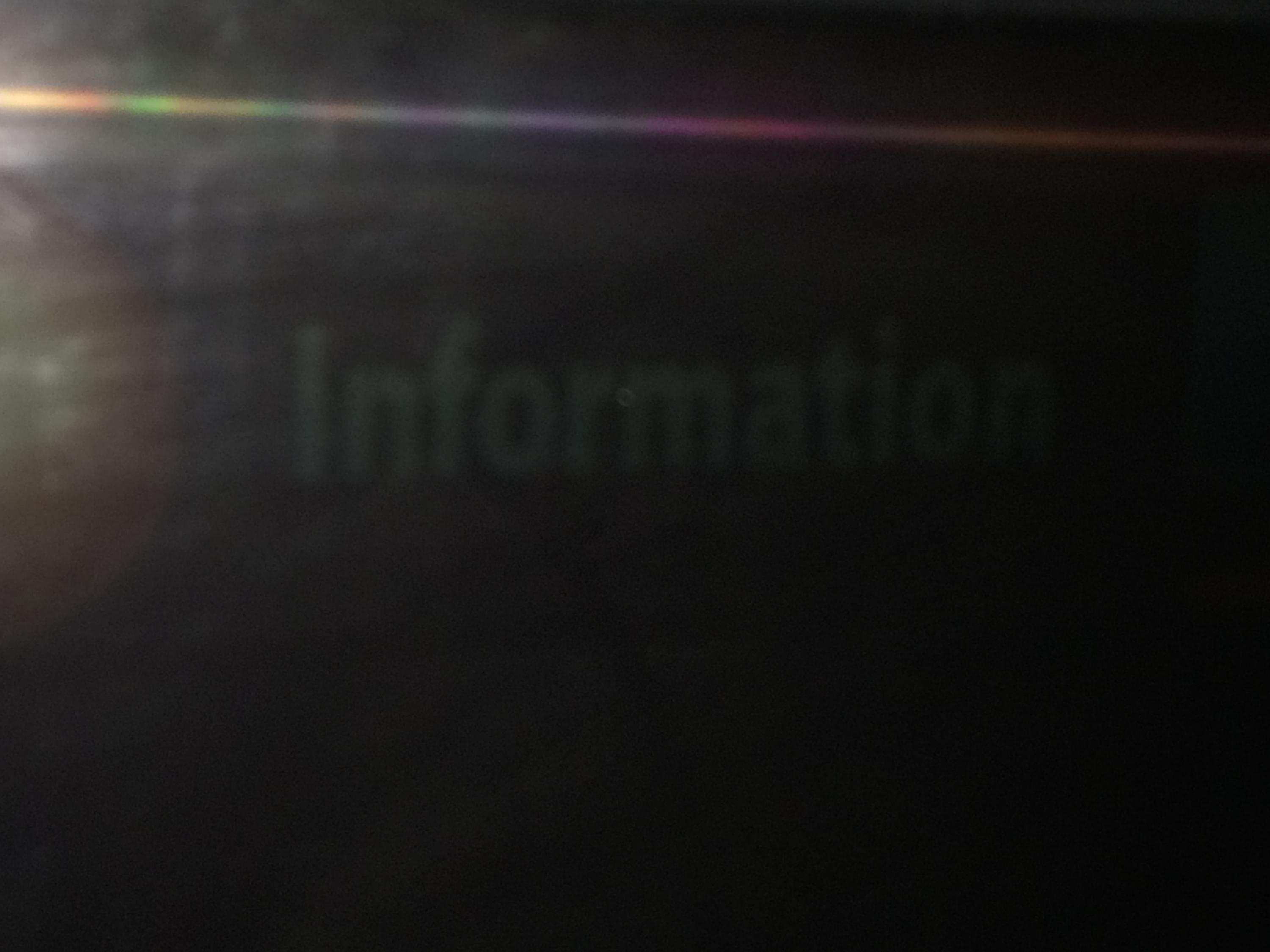

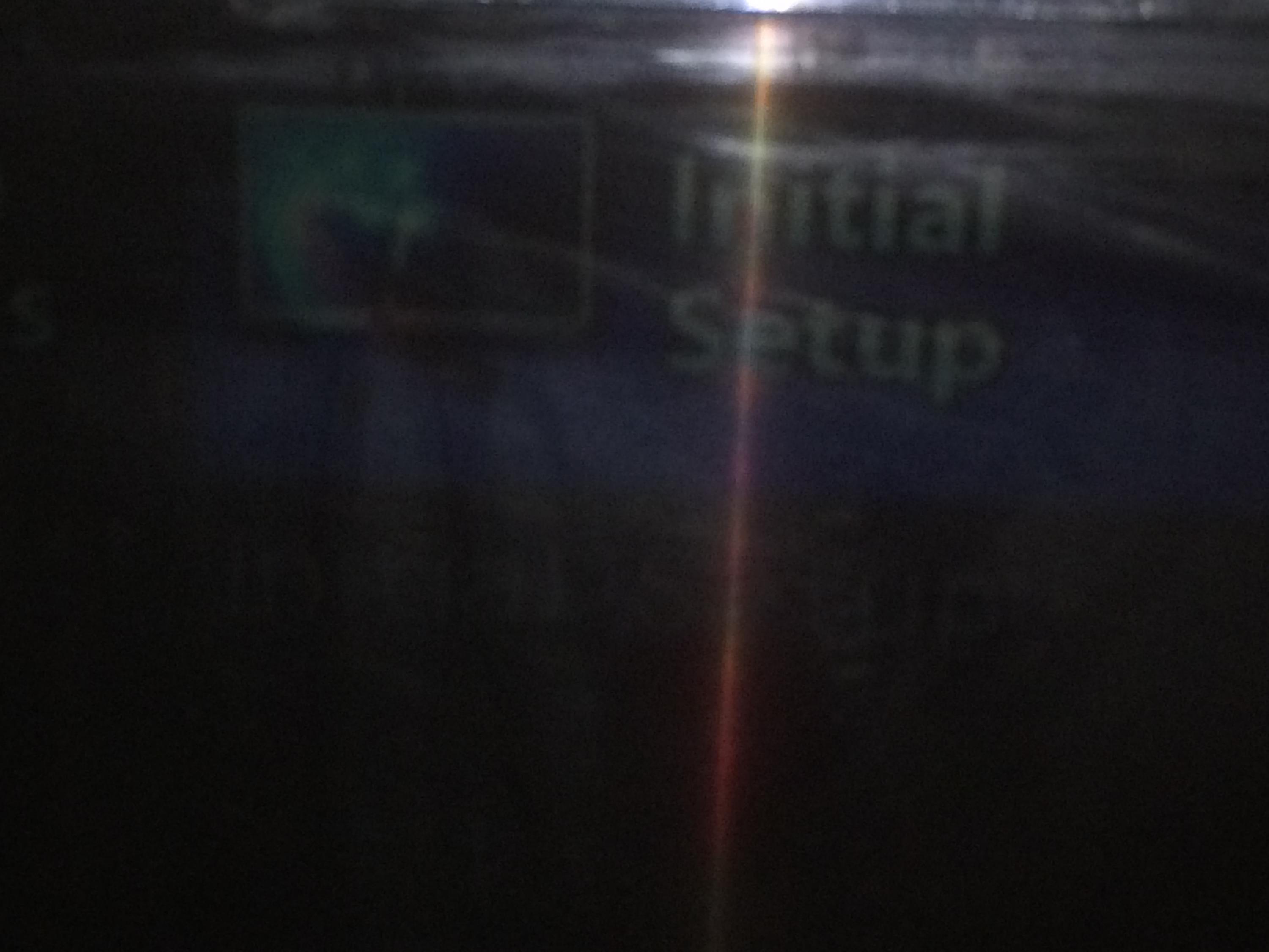

                                  To prevent mass confusion, I think it would be best if you take a picture right now of what you see on the screen to help us better identify your issue Something sounds add and I'm confused.
                                  • calimark
                                    • Apr 2015
                                    • 63
                                    #37
                                    Well you won't see squat now its daylight. but I attached some iphone photos from last night.
                                    Let me make clear- you can see everything in total darkness. The TV works in total darkness. I ran patterns on it last night, every inch of the panel works. Just literally dark even with backlight on.
                                    The backlights are lit- I pulled the panel, proved that & I can see the backlight is on thru the holes in the back.
                                    I suspect they are not bright enough to make the screen viewable. Does that help?
                                    BTW: I did say this thing has demons. I'm betting the guy I got it from mucked around with it more than he let on. There was no logical reason for that cable issue, but I'm glad I tracked it down.
                                      #38
                                      '+ to - leg is 75V for each pair at the PSU connector and at the actual strip' We need the reading with ref to GND not between the + and -.
                                      • calimark
                                        • Apr 2015
                                        • 63
                                        #39
                                        +ve to GND is 132V
                                        -ve to GND is 206
                                        That is for each one. Hence the 74V on each pair
                                        Should that 206V be sinking to GND? Making the led voltage 132?
                                          #40
                                          Typical LED driver: The Negative wire of the LED string is the Cathode which is sinked to ground through the PWM controlled power MOSFET and the current sensing resistor for current feedback to maintain constant current.
                                          Th + is the Anode of the LED string which is fed by the boost converter power supply.
                                          If you look at the board layout, all the L1+~4+ are tied together and fed by the switched power MOSFET Q7223, the filter caps are C7200, 7201.
                                          The PWM controlled sink power MOSFET Q7201, 7206, 7207, 7208 are for each LED strings (4 strings), and the 4 PWM controller ICs 7201, 7204, 7205, 7206 are for driving the PWM ICS. I do not see boost converter being used on this board.
