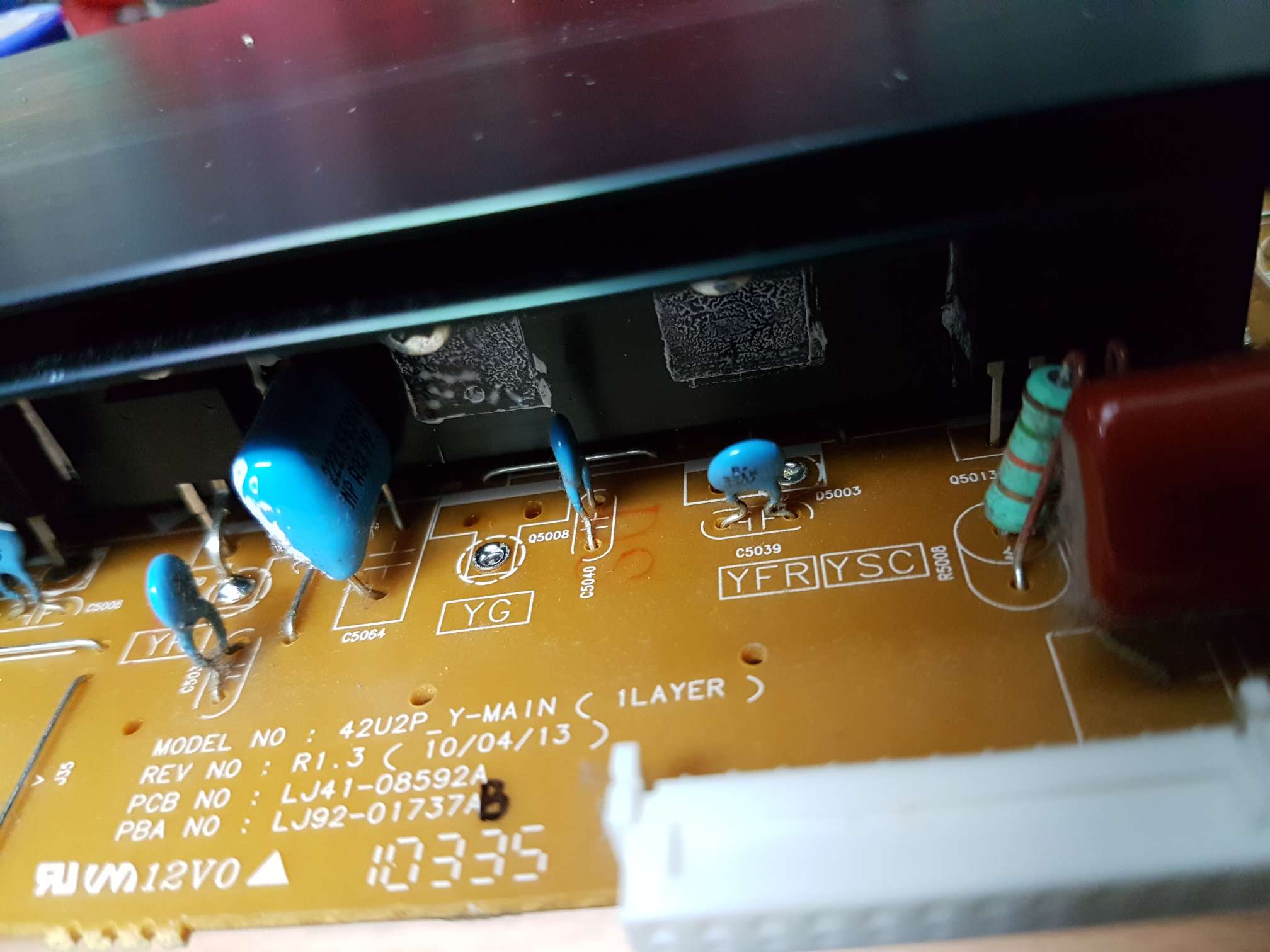

                          Hi, I also found 3 broken IGBT RJP30E2 transistors in the Samsung Plasma PS42C450B1W and one broken SF10A400H diode - how do you think, just replace these components or some more? I'm afraid that if I change them, they will break down again
                          PCB 42U2P_Y-MAIN

                                #35
                                Re: Part RJP30E2 IGBT replacement part
                                Hello.
                                I have one board like this ( LJ41-08592A) with 3 IGBT shorted and two diodes, and I desolted all 4 IGBT, when I returned to assemble the new ones, I noticed that there was 1 IGBT which is RJP63F3 and the other 3 are RJP30E2 and now I do not know where to install the RJP63F3 because I do not have the electrical scheme and i´m lost, I would appreciate if anyone can help me solve this dead end situation.
                                It can be :Q5003, Q5007, Q5000, Q5008, Q5013 ?
                                Thanks.
                                Carlos Silva.
                                crying:
                                • whitspirit
                                  • Sep 2008
                                  • 2
                                  #36
                                  I found out by my self, I just had to dig more on the net.
                                  thanks anyway.
                                  D5004-sf10A400H
                                  D5003-RJP30E2
                                  Q5007-RJP30E2
                                  D5000-STTH02R06FP
                                  Q5000-RJP63F3
                                  Q5008-RJP30E2
                                  D5003-SF10A400H
                                  Q5013-K10A60D
