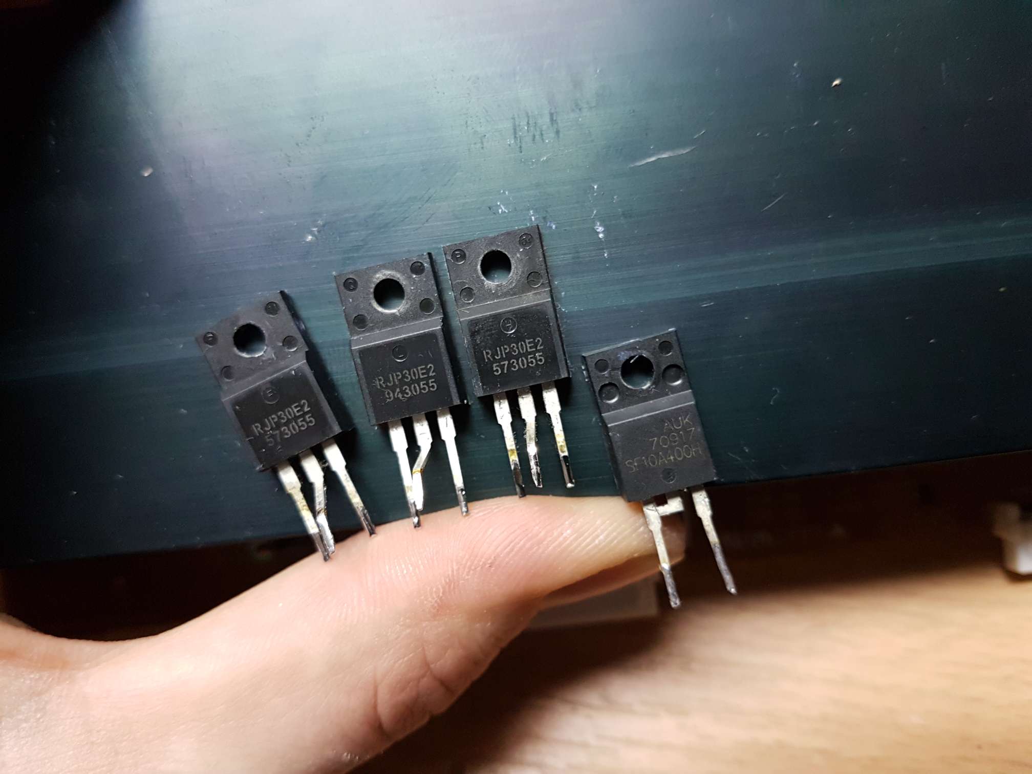

Part RJP30E2 IGBT replacement part
  • whitspirit
    replied
    Re: Part RJP30E2 IGBT replacement part
    I found out by my self, I just had to dig more on the net.
    thanks anyway.
    D5004-sf10A400H
    D5003-RJP30E2
    Q5007-RJP30E2
    D5000-STTH02R06FP
    Q5000-RJP63F3
    Q5008-RJP30E2
    D5003-SF10A400H
    Q5013-K10A60D
    Leave a comment:
  • whitspirit
    replied
    Re: Part RJP30E2 IGBT replacement part
    Hello.
    I have one board like this ( LJ41-08592A) with 3 IGBT shorted and two diodes, and I desolted all 4 IGBT, when I returned to assemble the new ones, I noticed that there was 1 IGBT which is RJP63F3 and the other 3 are RJP30E2 and now I do not know where to install the RJP63F3 because I do not have the electrical scheme and i´m lost, I would appreciate if anyone can help me solve this dead end situation.
    It can be :Q5003, Q5007, Q5000, Q5008, Q5013 ?
    Thanks.
    Carlos Silva.
    crying:
    Leave a comment:
  • Folxs
    replied
    Re: Part RJP30E2 IGBT replacement part
    I bought them on Aliexpress - but TV still doesnt work ;/
    Leave a comment:
  • bododot
    replied
    Re: Part RJP30E2 IGBT replacement part
    Originally posted by Folxs
    Hi, I also found 3 broken IGBT RJP30E2 transistors in the Samsung Plasma PS42C450B1W and one broken SF10A400H diode - how do you think, just replace these components or some more? I'm afraid that if I change them, they will break down again
    PCB 42U2P_Y-MAIN
    i encounter too like on what you show on your image. The difference is the 3 traniz is SGPF4536 same diode SF10A400H it is samsung plasma display model: PS51E470AIR. Hard to find this parts in my area.
    Leave a comment:
  • Folxs
    replied
    Re: Part RJP30E2 IGBT replacement part
    Hi, I also found 3 broken IGBT RJP30E2 transistors in the Samsung Plasma PS42C450B1W and one broken SF10A400H diode - how do you think, just replace these components or some more? I'm afraid that if I change them, they will break down again
    PCB 42U2P_Y-MAIN
    Last edited by Folxs; 03-15-2018, 01:55 PM.
    Leave a comment:
  • ReeceyBurger123
    replied
    Re: Part RJP30E2 IGBT replacement part
    Any 12v should be fine and not cause any issues all though running them atb12v might be a little loud so try 7v or 9v maybe.
    Leave a comment:
  • tech2014
    replied
    Re: Part RJP30E2 IGBT replacement part
    awesome
    Leave a comment:
  • Kokey
    replied
    Re: Part RJP30E2 IGBT replacement part
    Oh yes once I get the fans in and locate a 12v source on the bord that is not going to interfere with the operation of the tv 👍
    Leave a comment:
  • Kokey
    replied
    Re: Part RJP30E2 IGBT replacement part
    Oh yes once I get the fans in and locate a 12v source on the bord that is not going to interfere with the operation of the tv ��
    Leave a comment:
  • ReeceyBurger123
    replied
    Re: Part RJP30E2 IGBT replacement part
    Wow that's awesome, good work. Can you get us some images if you add some fans to it too ?
    Leave a comment:
  • Kokey
    replied
    Re: Part RJP30E2 IGBT replacement part
    Here is a pick of how it works
    Leave a comment:
  • Kokey
    replied
    Re: Part RJP30E2 IGBT replacement part
    Reecey success 😀It's working great right away it fired up . Now I need an upgrade and some fans and it's all good
    Leave a comment:
  • ReeceyBurger123
    replied
    Re: Part RJP30E2 IGBT replacement part
    Awesome
    Leave a comment:
  • Kokey
    replied
    Re: Part RJP30E2 IGBT replacement part
    Thanks Reecy il keep u posted on how it all worked out ����
    Leave a comment:
  • ReeceyBurger123
    replied
    Re: Part RJP30E2 IGBT replacement part
    Haha sorry shows my maturity but yeah seems legit the word "shit" and this Tv in the same thread I also when rebuilding some Q97 Samsung Plasmas add fans in them to cool the Ymain and Psu. Keep us updated on what you do
    Leave a comment:
  • Kokey
    replied
    Re: Part RJP30E2 IGBT replacement part
    Was thinking same thing to get a computer fan over both boards
    Leave a comment:
  • Kokey
    replied
    Re: Part RJP30E2 IGBT replacement part
    Yes shit lol 😂
    Leave a comment:
  • Kokey
    replied
    Re: Part RJP30E2 IGBT replacement part
    Lol pretty close
    Leave a comment:
  • ReeceyBurger123
    replied
    Re: Part RJP30E2 IGBT replacement part
    Lol sorry but "data shit" haha made me laugh Also yes that would work. Maybe add a small fan over or under the heatsink to help them cool a little better ?
    Last edited by ReeceyBurger123; 04-13-2016, 05:23 PM.
    Leave a comment:
  • Kokey
    replied
    Re: Part RJP30E2 IGBT replacement part
    Is it posible to replace them with FGPF4536 ?. The data shit seems puretty close ?
    Leave a comment:
  • the_rem
    Unknown transformer : how to find a good replacement part ?
    by the_rem
    Hello guys,
    I would like a quite old but still good 800 W ATX PSU to be repaired. The problem was an extremely heavy coil whine coming from the small secondary transfomer on the PCB.
    I desoldered it hoping the references on the upper side would allow me to find a adequate replacement part. Sadly the written references drove me nowhere but to the manufacturer (I-MAG). I sent them a message like a bottle in the see asking them to send me a datasheet of the transformer. And... They responded ! I received a kind of datasheet (see attachment) but my competencies do not allow...
    04-23-2025, 01:48 AM
  • FreakyMex
    Trouble to identify part (Lunii screen) for replacement
    by FreakyMex
    Hello guys. I'm a complete noob in electronics. I'd like to repair my child Lunii's (a "story box"), basically an audio player that allows the childs to choose between several options the places, characters, objects of the story, and then play a story according to the choice of the child. There is a screen that display the selected option before each choice. The Lunii fell and the screen is now broken.
    I'd like to repair it (probably just have to change the part, because the lunii still works perfectly fine) but I can't manage to identify the part/order it online. Do you have any...
    02-17-2025, 01:16 AM
  • edugimeno
    Finding the wrong part at a loooong led strip, part works fine, part flickers, all parallel...
    by edugimeno
    Hi There!
    I'm trying to help my friend who owns a restaurant be just bought.
    He has a very long LED strip running along all the walls and columns. The strip is attached facing down 2in above the floor, using a wall panel that ends in a metal rail that finishes the panel underneath
    It's stuck using, I guess, the 2 sided tape that comes with the strip
    The issue is that like 1/2 of the full length, including 1/2 one wall, another entire wall, and one column, flickers after 4 or 5 minutes ON. Particularly it flashes staying OFF most of the time and flashing ON for 1 tenth...
    09-05-2024, 09:34 AM
  • G-Sting
    iPad Pro A1876 SHORT Part Identify Help Needed
    by G-Sting
    So My iPad was not charging and booting up . i went to a local technician and he checked with thermal and this Part marked in 1st Photo is Short.
    So then i went on to boardview and downloaded the schematics and identified this part in 2nd Photo. Now i am confused what exactly is the part called ? where should i get this from ?
    i contacted my technician and he sent me his BoardVIew screenshot in 3rd Photo. In his Boardview the part is called X2826.... Something
    SO My main concern is what part should i order what should i search the name for ?
    on Ipad...
    05-15-2025, 09:30 AM
  • Cvrado
    Led TV Board Replacement, same part number and model, different size
    by Cvrado
    Hello my friends!
    I have a question that I think you can answer and help me with!
    I have a faulty main board from an led TV. And I found the same part number board and design but is from a 43" TV and I want to use it on a 65". On its stickers , all are the same except the wattage for the LEDs backlight, both state different watts and LED Voltages!
    So I presume that the backlight inverter section from the replacement board has lower wattage then the original one, am I right?
    My concern is that the board won't draw enough voltage to the bac...
    03-02-2024, 05:05 PM
