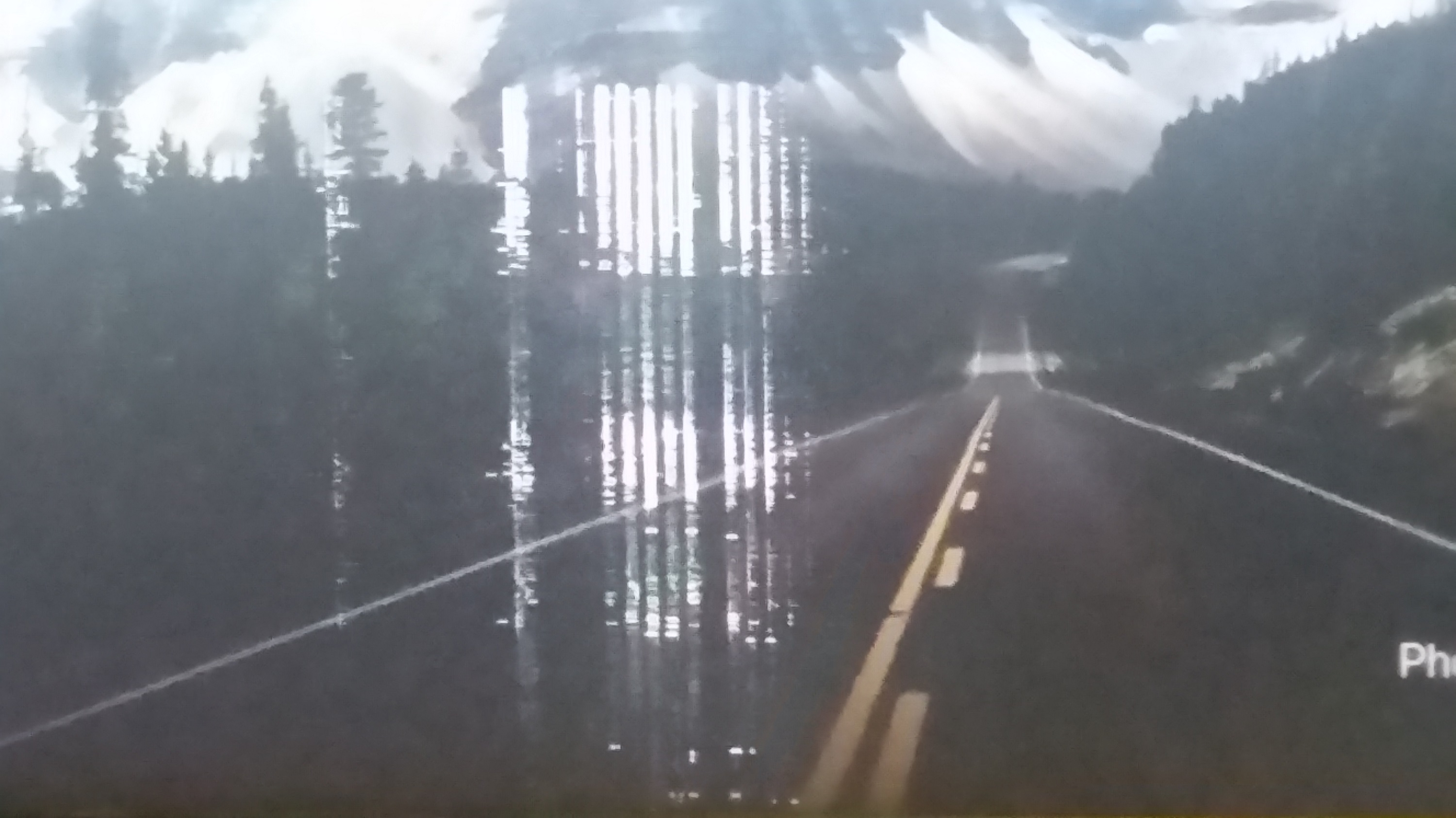

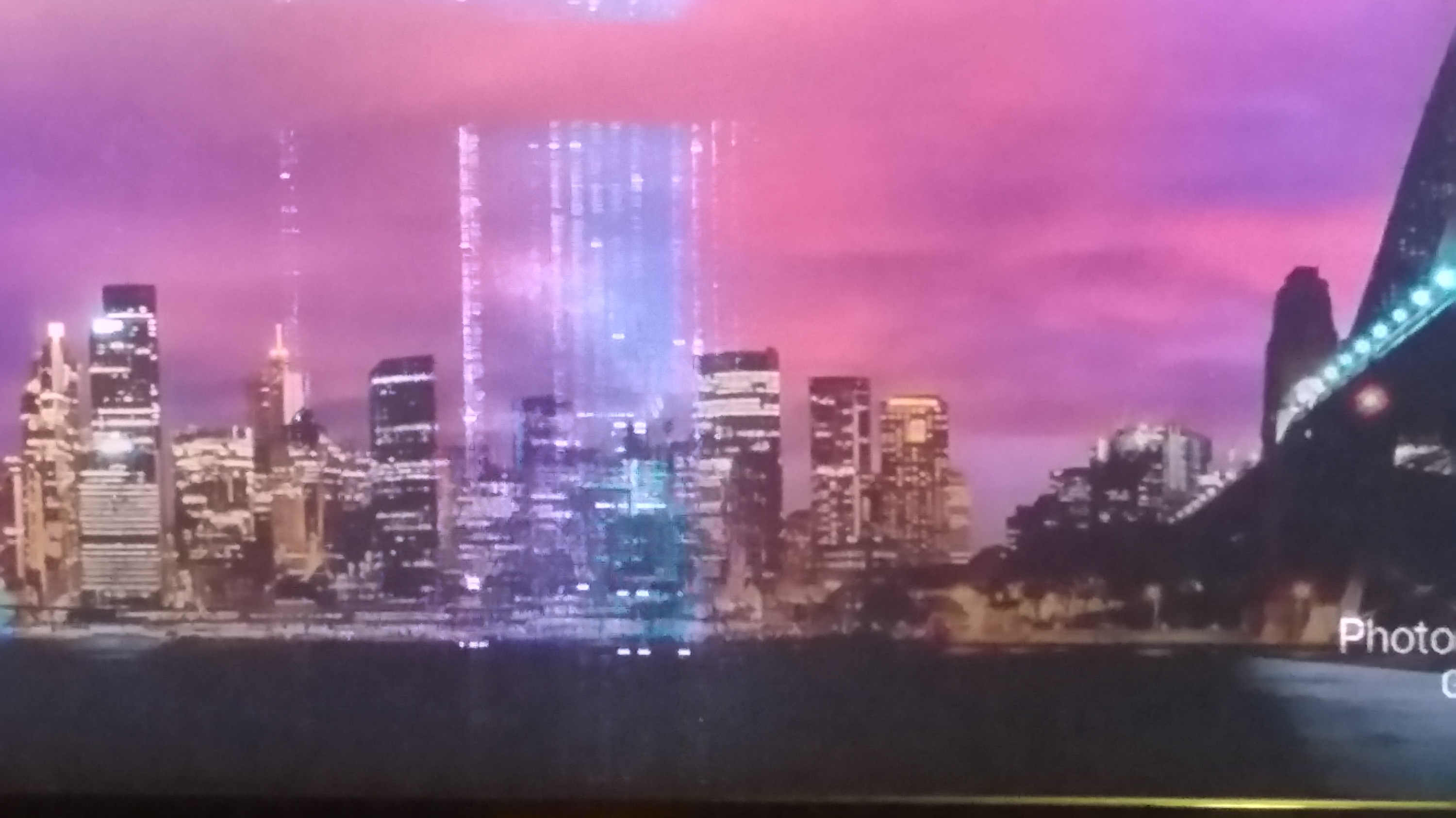

    I've had this LCD forever and the picture started flickering.
    its worse at 1080P then at 720P. Just wondering if its an easy fix. New TV is much cheaper. Pictures don't really capture it that well.
    Bright solid colors make it worse then say black.

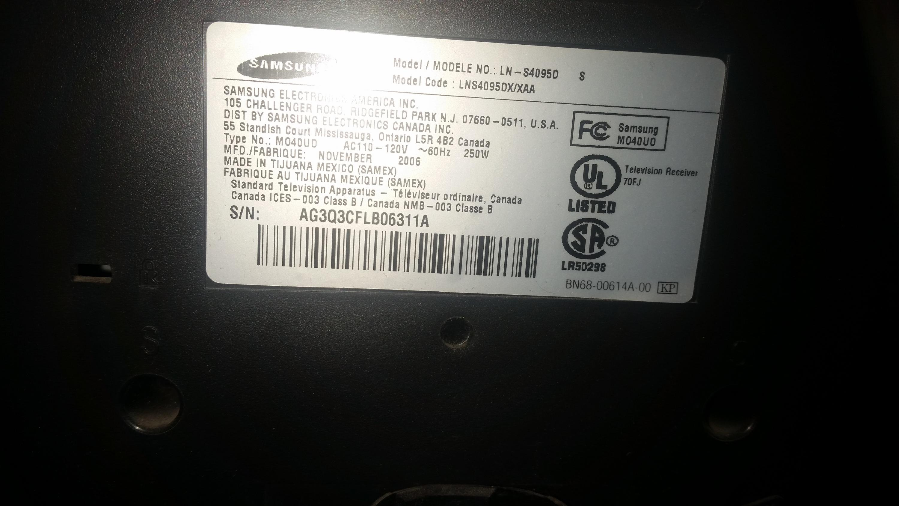

    more pics

      Try flexing / squeezing the frame and see if it fixes it. Looks like a tab bond issue.
