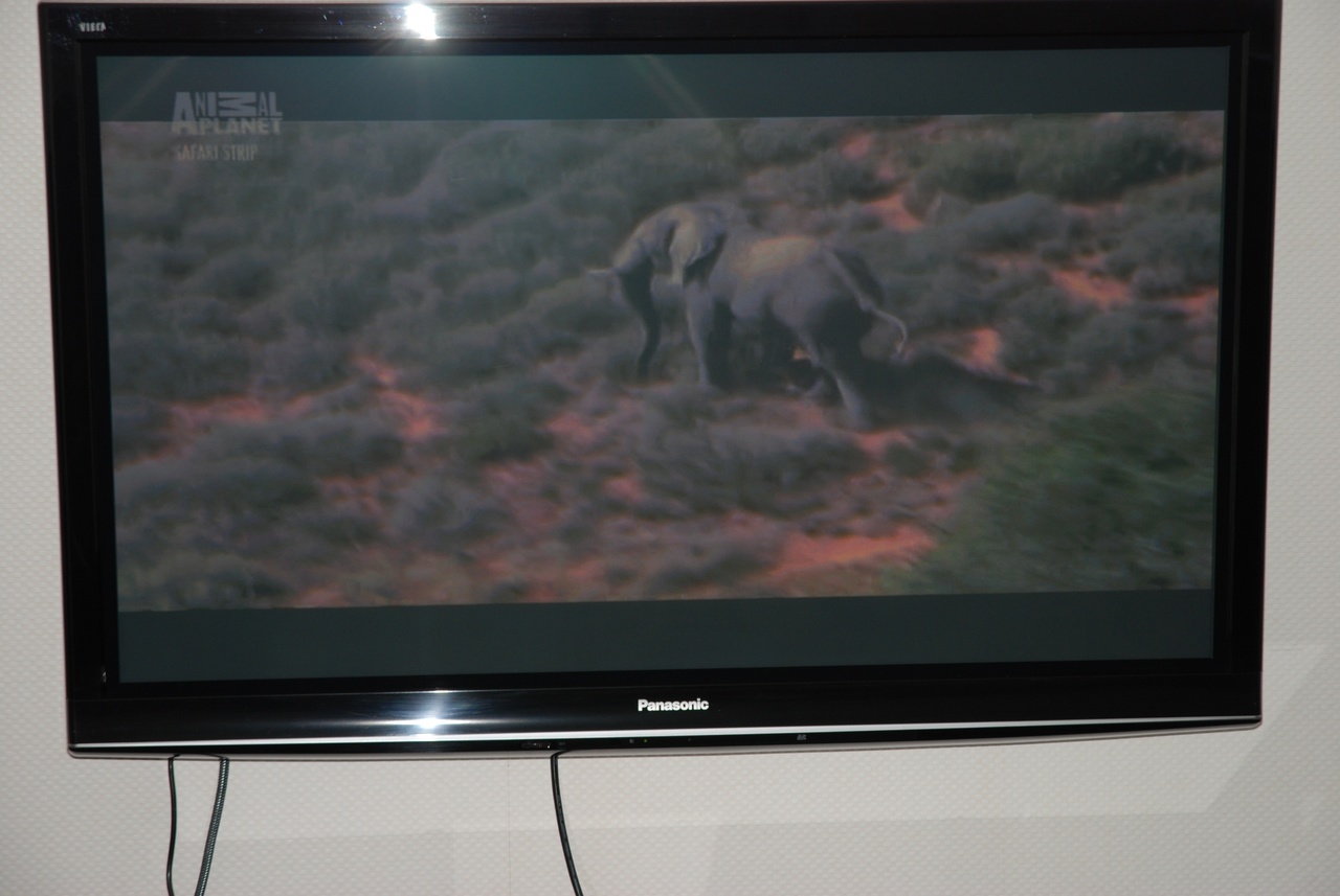

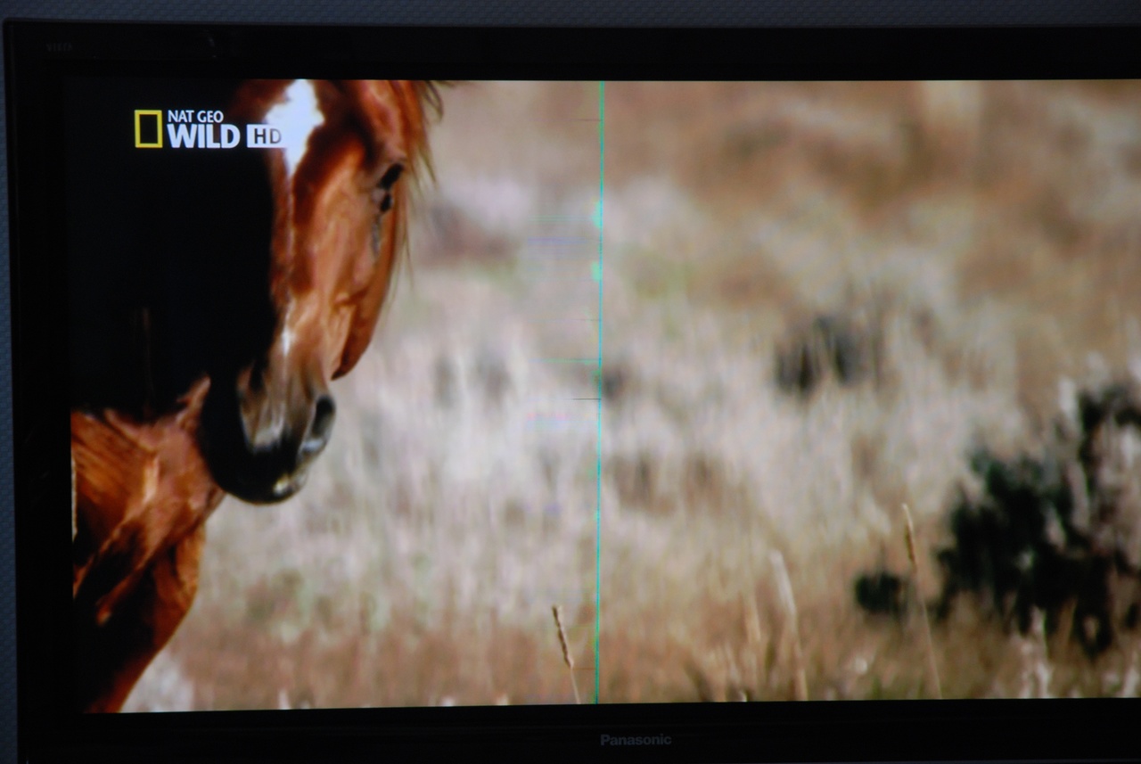

    Hey Guys ,
    I can buy this tv really cheap but i need some advice.
    It will run fine for some time and then after a while this vertical line appears.
    Is this a a connector that needs to be reseated? For example , that it expands deu to tv/ribbon cable heating up? Or dust issue?
    If its a panel failure , it would be visible from the beginning right?
    Thanks.

    Possible panel driver failure if thats the case its unfixable as they are bonded to the panel. Try re-seating sll the connectors for that section of the screen.

              Im suspecting its a badly seated ribbon cable as the lines on the screen appear after a while.
              Its probably not seated correctly and because of the heat it expands and starts to display these lines.....
              OR the ic is bad and it displays those lines because of heat?

                      Thought about it and i bought the tv. Tv is working perfectly , it was just a badly seated ribbon cable and dust.

                        Braver man than most. Well done. I would have walked on this one. What had me interested was not the vertical but the irregular horizontal jaggered lines off it.
                        So do you want to tell us which ribbon? I'm curious.

                          Im not sure which one it was. I removed all 4 heatsinks in the centre and cleaned the cables. I noticed that some screws were not tightened that good , reassembled all the parts and its working perfectly.
                          Maybe it happened when the owner removed the stand ?
