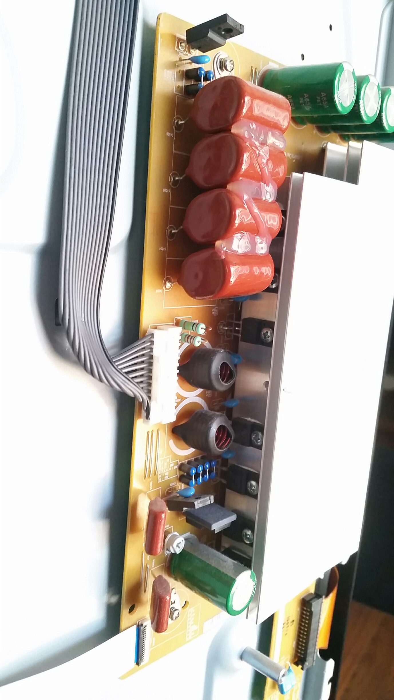

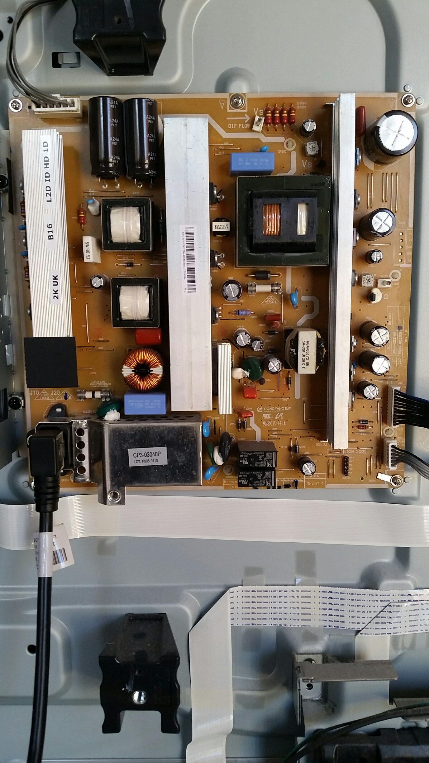

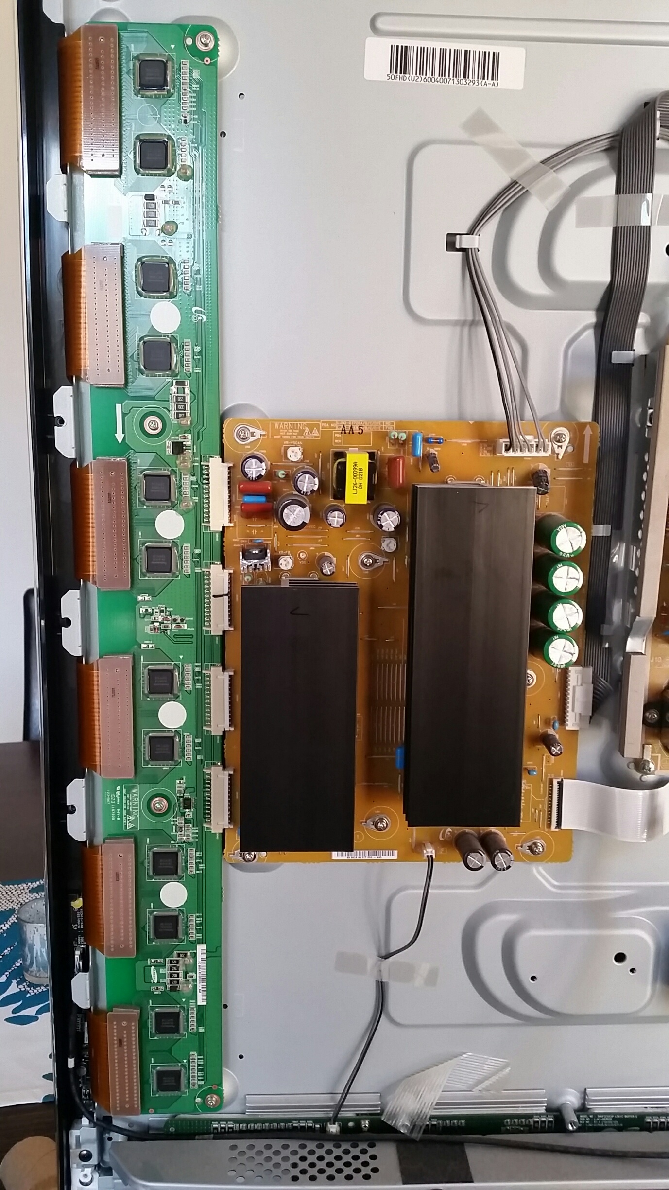

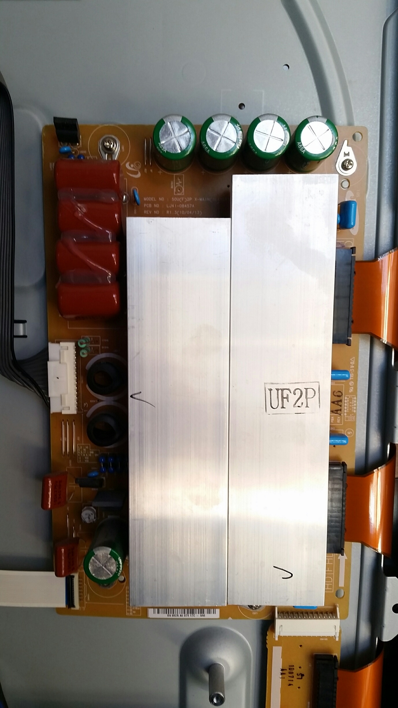

    Hi All.
    I'll start by saying while I have some electronics experience I am by no means a techy.
    I am trying to repair my samsung 50" plasma.(ps50c550)
    I've read many articles about it but haven't really been able to nail my issue.
    The first sign of probs was when it started to show reddish pixels at the base of the screen. Then it shut off and now it does the power cycle thing.
    I have inspected the boards and there are no visible bad caps, damaged or burnt components of any sort. No dry joints.
    There is a little heat discoloration of the xsus board.
    On my model I am unable to individually unplug the ysus xsus as the xsus runs through the ysus. however if I unplug the xsus from the ysus it doesn't power cycle. I still get nothing on screen though and at no time do i ever get audio.

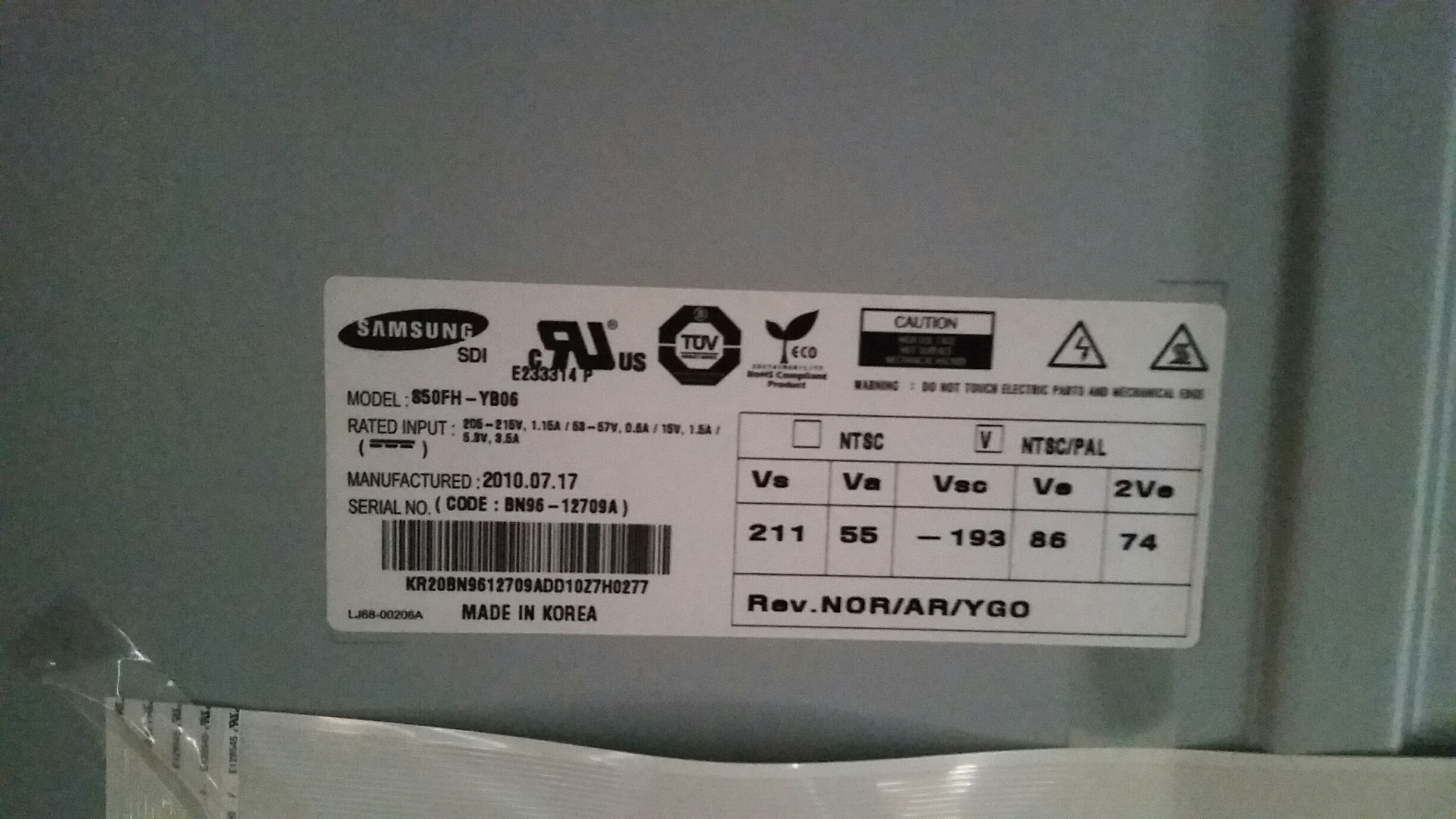

    During the power cycling I am getting over 300v @ VS instead of the stated 211v. I get around 20v @ VA rather than 55. These fall away if stay on them with the meter.
    My suspicion is the xsus but before I buy it - anyone have any ideas or further tests I can run.
    P.s. If i unplug everything from the power board i get no voltages.... even if I trick the board on with the "blue wire" to the control board. but i think there must be multiple triggers.
    Thanks for any help... I can't afford a new tv at the mo..

          Re: diagnose samsung plasma ps50c550....
          Test the boards for short circuit between vs,va and ground you may find its shorted some fets like the smaller ones do

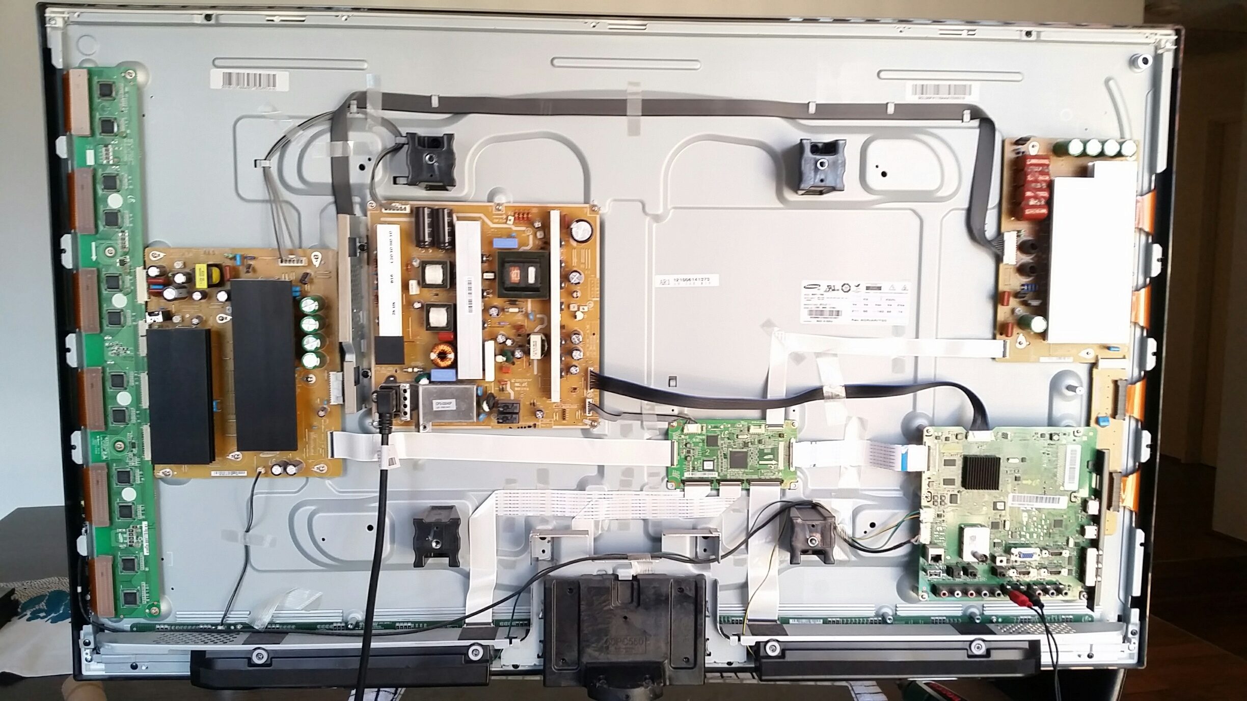

            Posting pictures of the back of your tv showing the boards with clear pictures may help you more with fixing your problem

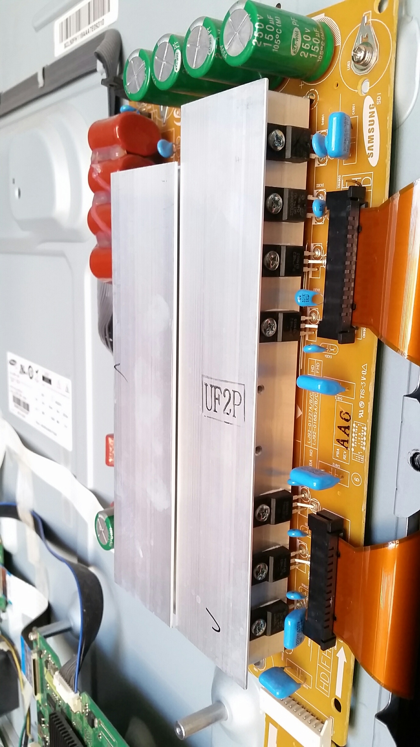

              Hi wills123.
              Thanks for the help.
              VS is shorted to ground.
              I unplugged all the boards and put them back 1x1 and it shorts again at the xsus.
              Do you think this confirms my suspicion of the xsus board?
              I am rather excited at the prospect of repairing the board rather than just buying a new one. Is there a way to test the fets without removing them from the board?
              Thanks heaps.
              Darren.
                  Pics

                      I'm in the process of repairing a few plasmas, and I keep reading that the square buffer chips die on most of these, and sometimes damage the y or x board driving it.
                      • ReeceyBurger123
                        Never Give Up !
                        • May 2014
                        • 7325
                        • Britain
                        Normally the sustain board will kill the buffer on Samsungs. The fault on this one is likely to be the IGBT transistors on the Ymain.
                          At razor, yes xsus has a fault, test the y buffer board an u may find that has short too, on the smaller sets its the two outer fets on xsus that short, u may be able to replace just those but be warned if buffer has a fault or the y sums it will short again. Most people reccomended changing all 3 boards on the ps42c series. Just be sure to check each replacement board as there is a lot of faulty ones out there. I have two ps42c that need buffer boards that I have yet to locate good ones, had 4 sent to me faulty lol
