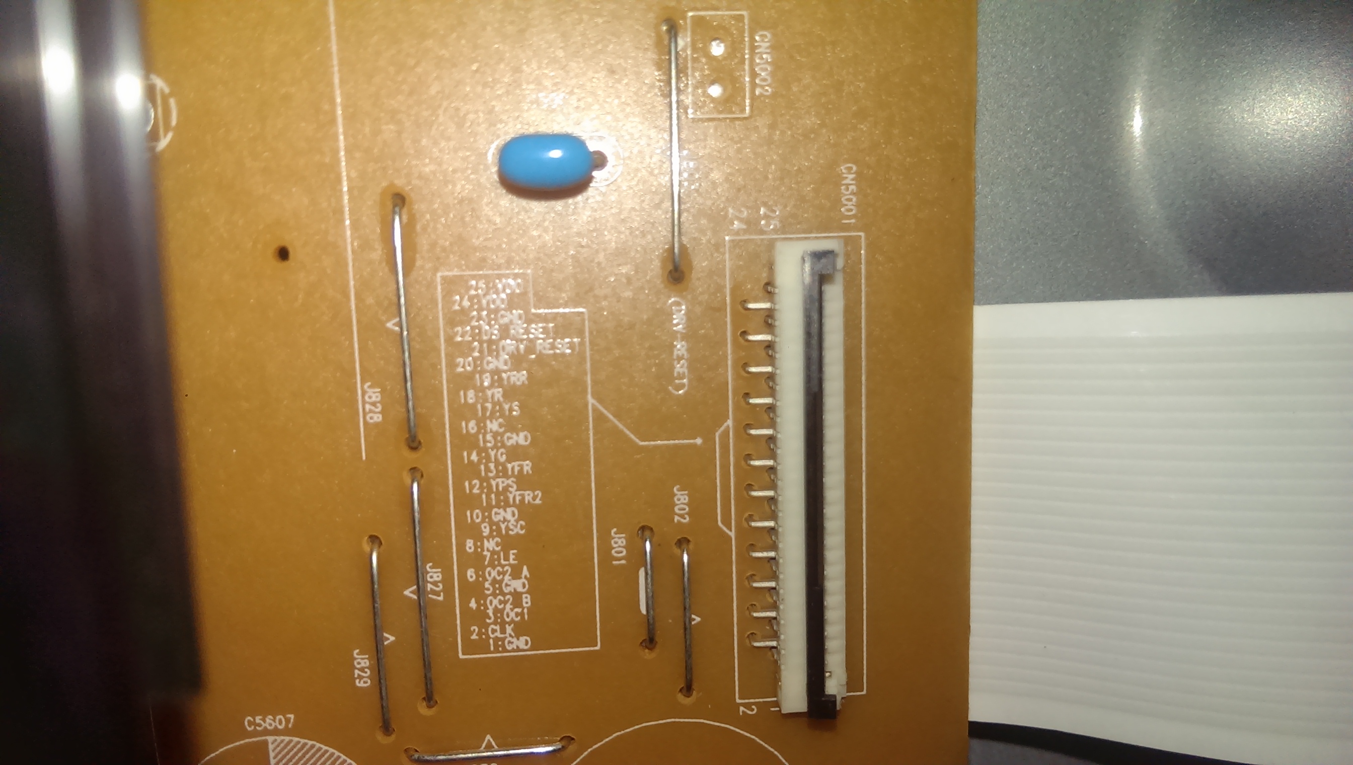

        the volts stay on with this cable remove
        • knightdad
          • Apr 2015
          • 54
          • usa

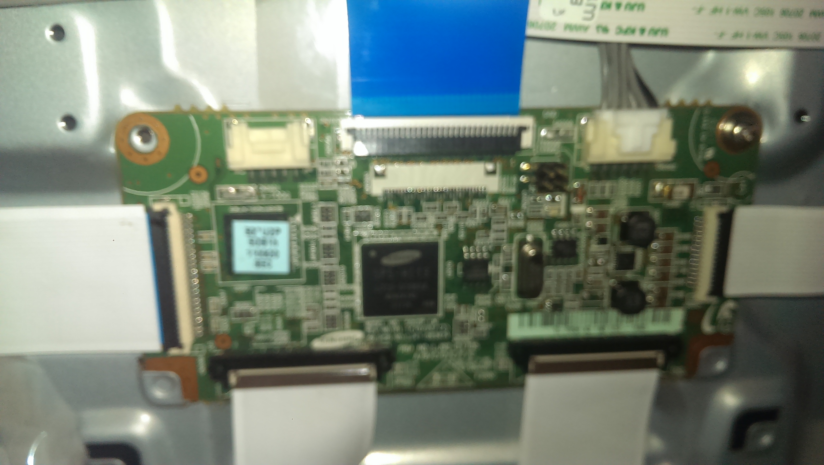

          Re: plamsa power supply
          the cable go from the y sus to the control borad

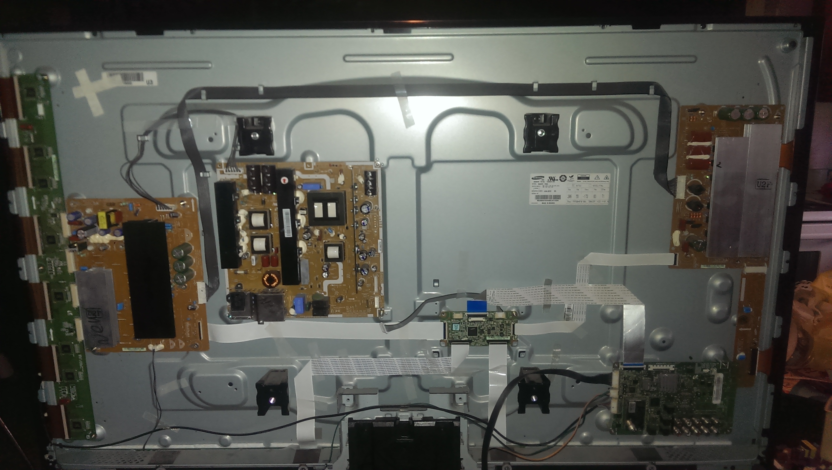

            ok here is back of set
              ok all I need just an little help
              could it be the main control board or the y sus ??
                Unplug Y main and X main (samsung uses X rather than Z) from Psu see if Va persists.
                  ok unplug the one cable going to y main it feed thes x main
                  volts are there
                  206 an 55
                    Ok plug the Ymain cable back in the unplug the Xmain see if voltage persists if so let us know.
