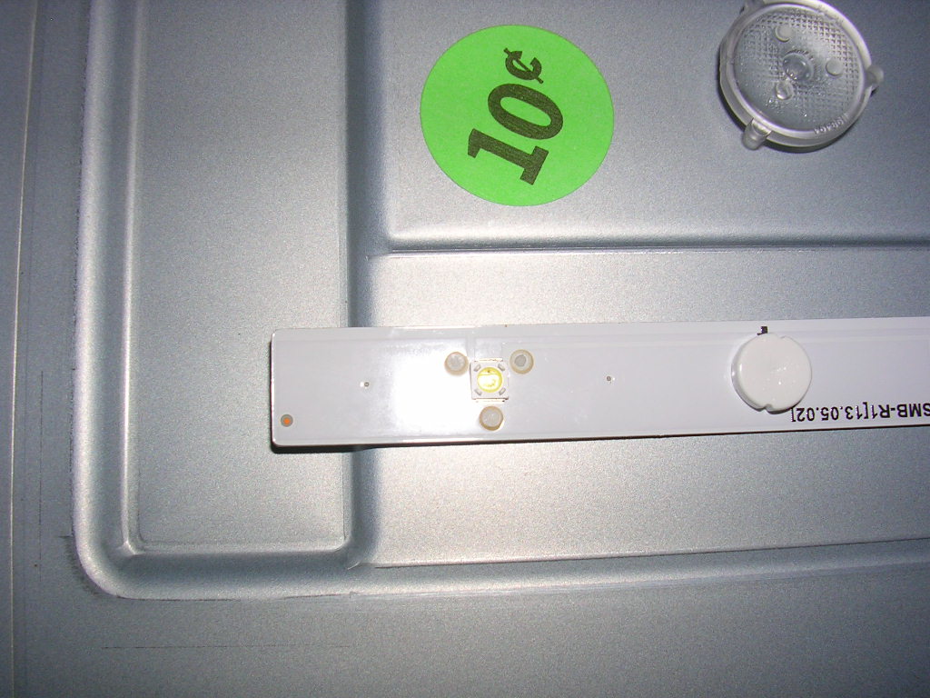

        Here's a photo of the LED with lens removed.
        I can't see how to get it off, without destroying the strip. And how to get a new one back on?

          U need to heat with heat gun or soldering iron to remove. Its better if you dont have the experience to find some strips from a trashed set on ebay.
            #45
            Re: Samsung UN46EH5000, No Backlight
            To remove the bad LED, apply one soldering iron to one side and one on the other. When the solder flows, slide the LED off the pad. Sometimes you can add 60/40 solder to the pads if they are visible to make the solder flow easier (alloys the hi-temp crap to a lower melting temp).
            Do not use a heat gun to remove the LED if you've never done it before.
            You're going to have to post a better picture - one where the LED covers 70%+ of the picture.

              It's actually quite easy. But first, get yourself a pair of calipers and measure the LED, X, Y and Z. You will also need some Sn60/Pb40 solder (0.020" to 0.032" in diameter) and some paste flux (NOT ACID flux, but ROSIN flux for electronics).
