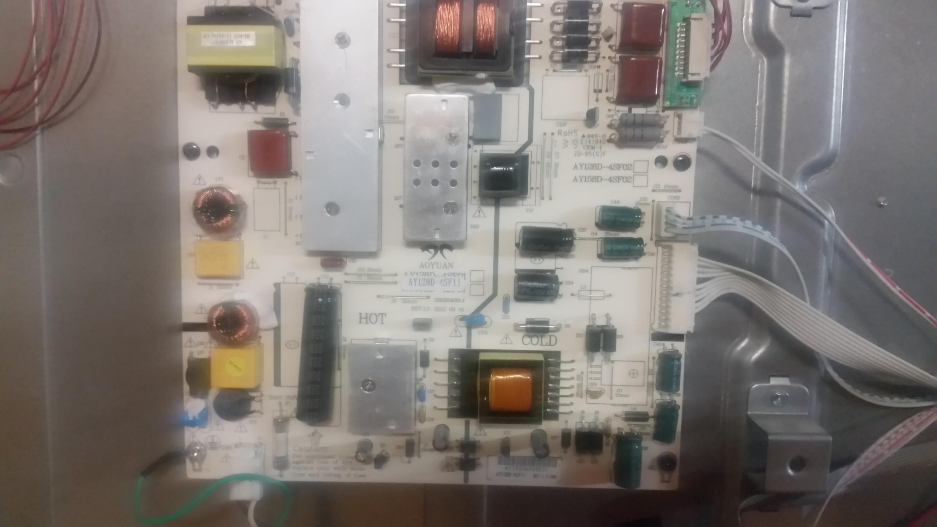

    Proscan 50" PLDED5066A-E no backlights

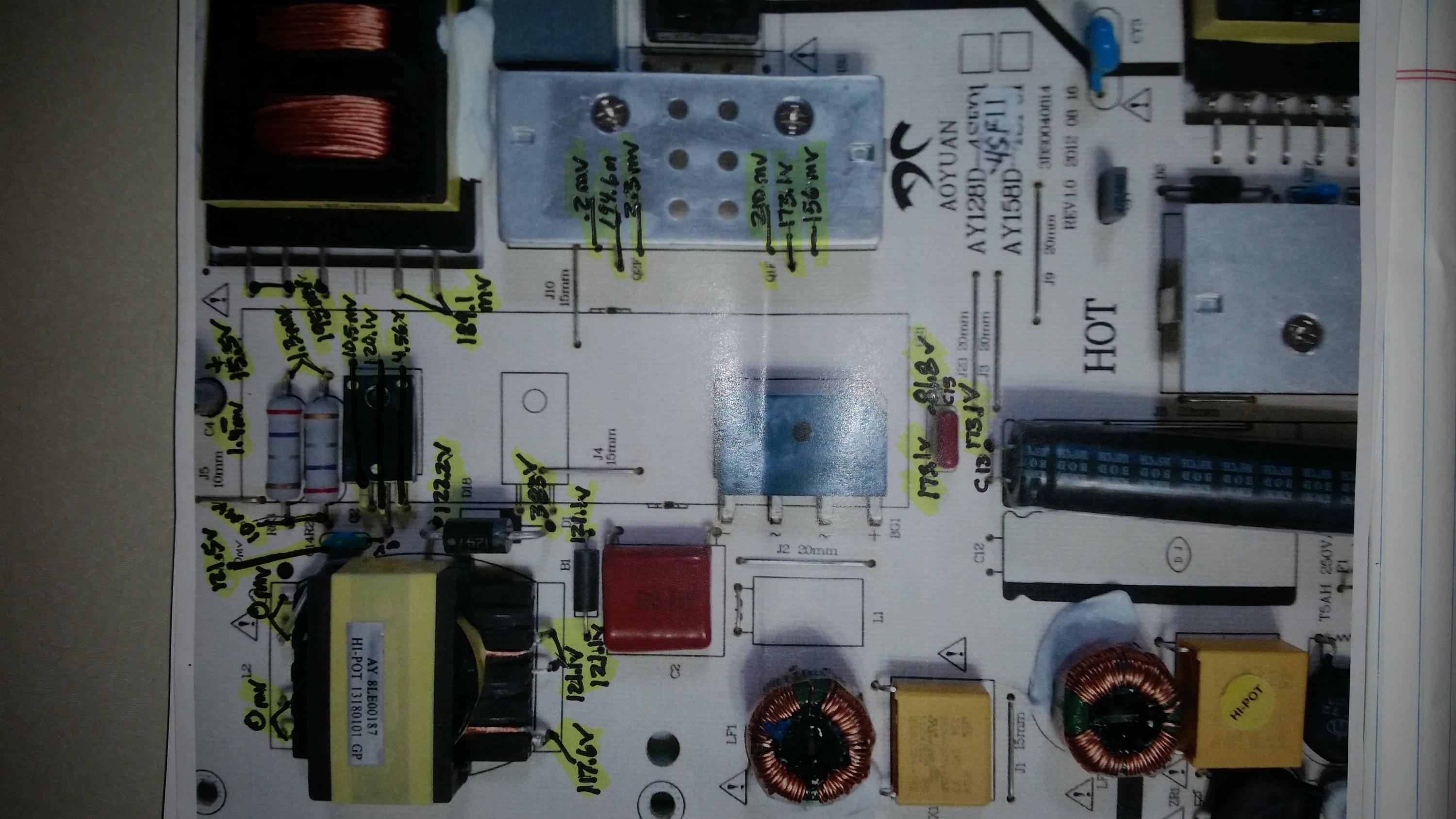

    I have a Proscan PLDED5066A-E that has sound but no back lights. When it is powered on, the red standby light will turn blue and you can hear sound but no back lights at all.
    SMPS – AY 128D-4SF11
    IC 1 – L6562A
    L2 – AY 8LE00187
    All reading is with the black test lead on negative side of the filter cap (C-13)
    C13 filter cap – 173.1 V
    C15-173.1V and 81.8V
    D18- 383V and 122.2V
    B1-121.1V and 121.1V
    L2 - 0mV and 0mV
    117.6V and 121.1V
    C14- 121.5V and 10.2mV
    10.5mV-----
    Q2- 120.1V--------------
    4.56V------
    10MV---R83---1.3mV
    10mV---R29---10mV
    C4-(-)1.4mV (+)15.5V
    T2F 195.4mV and 189.1mV
    Thank you for the help.

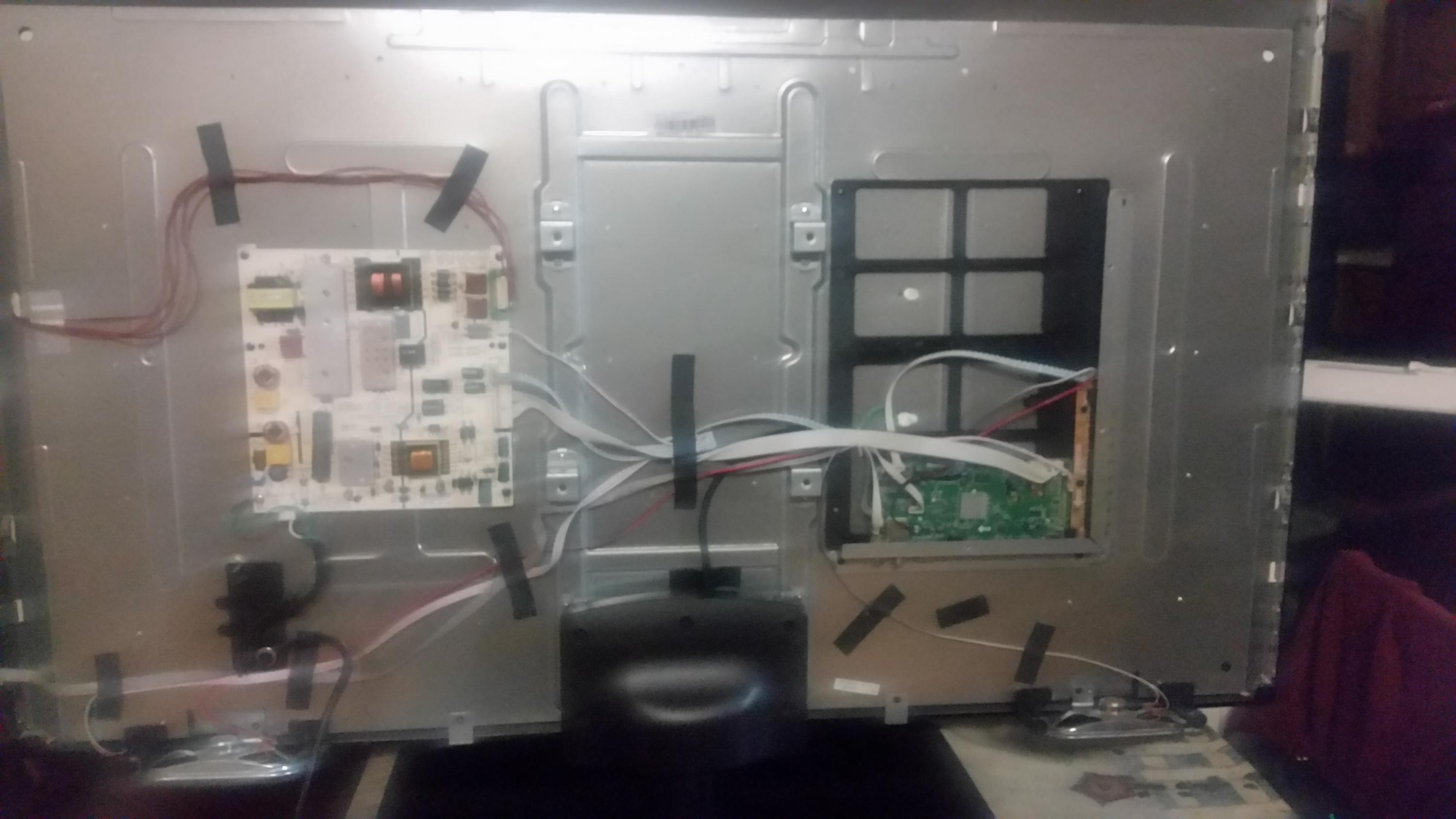

    pic

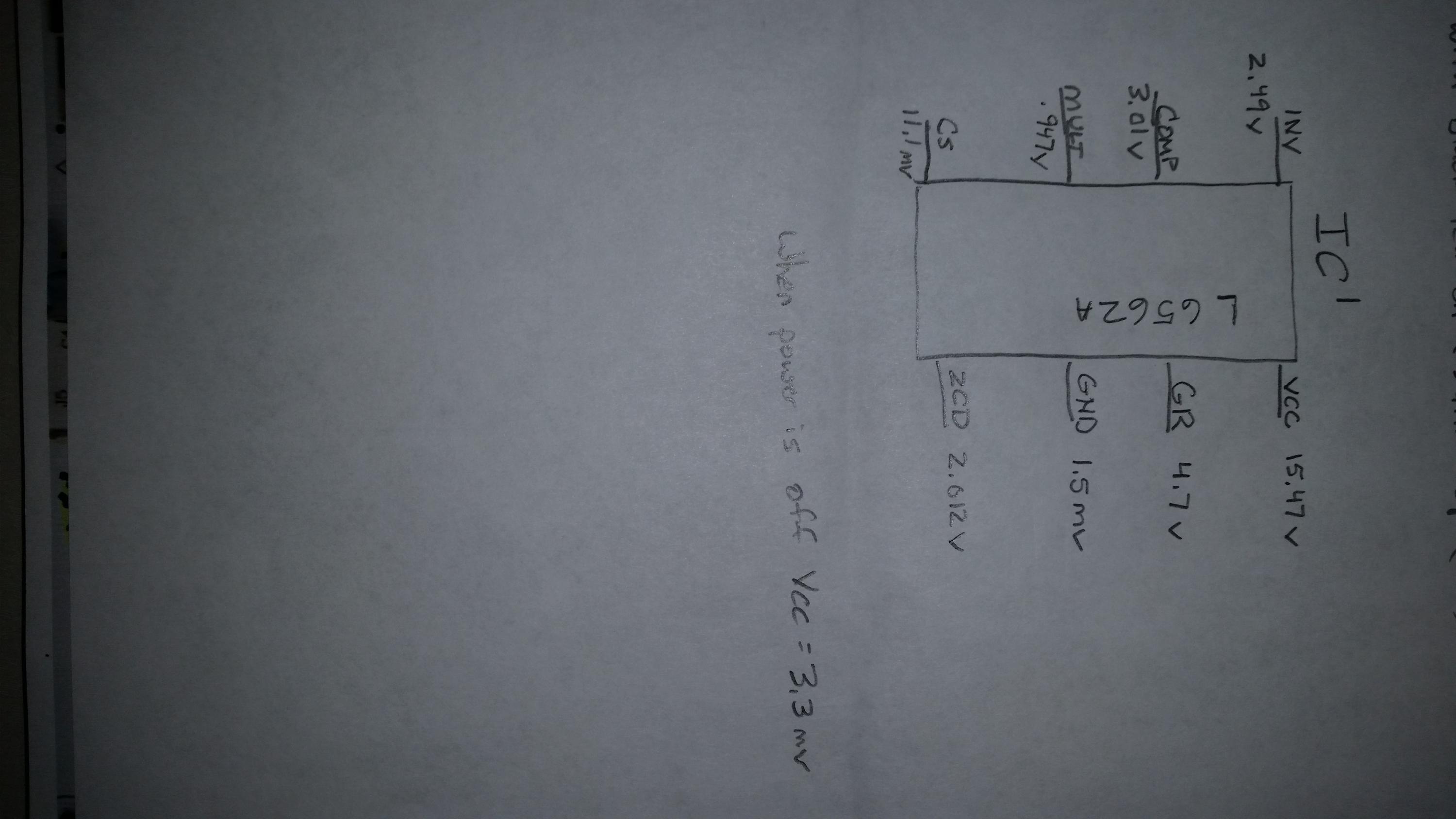

                Pic

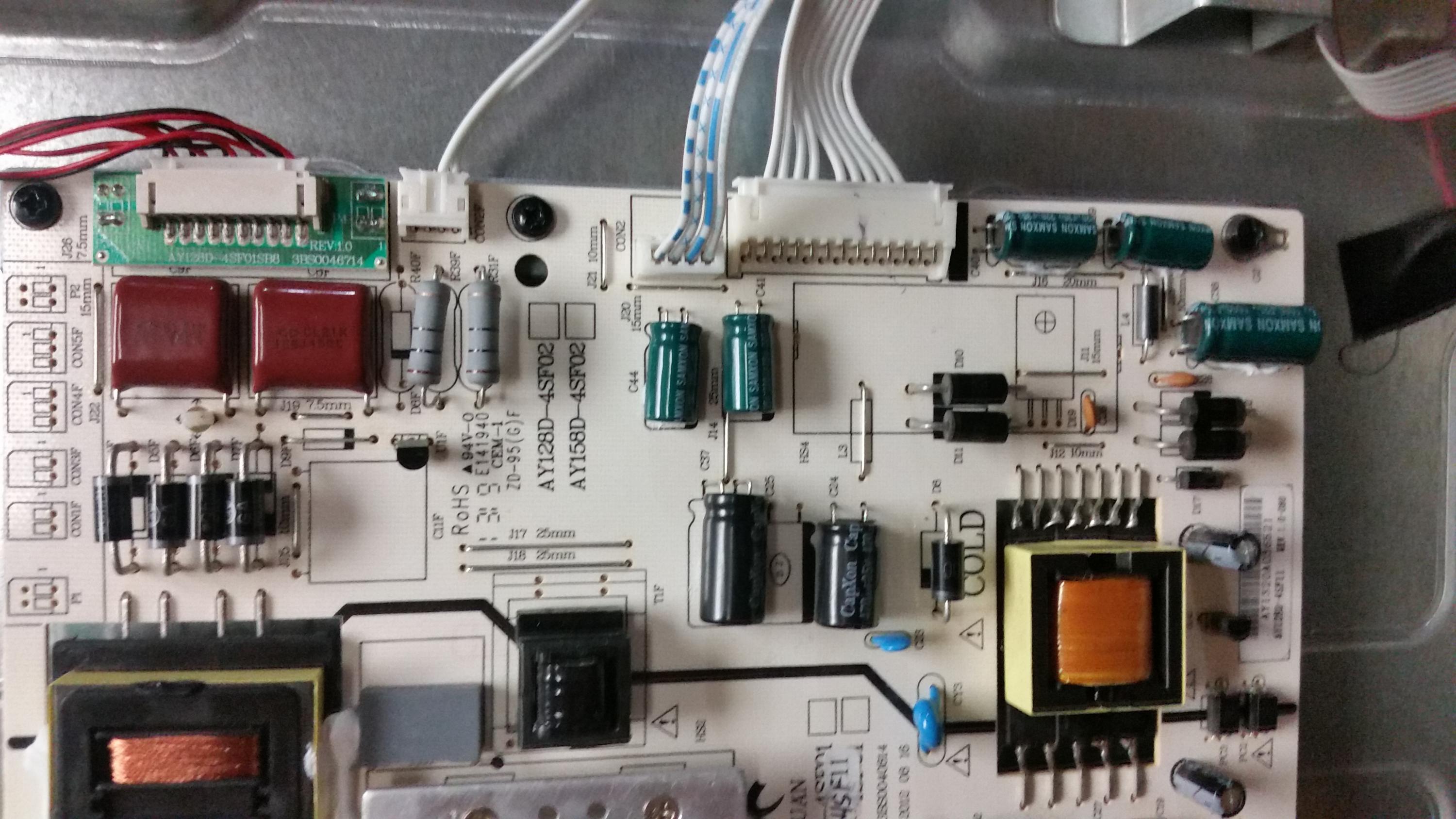

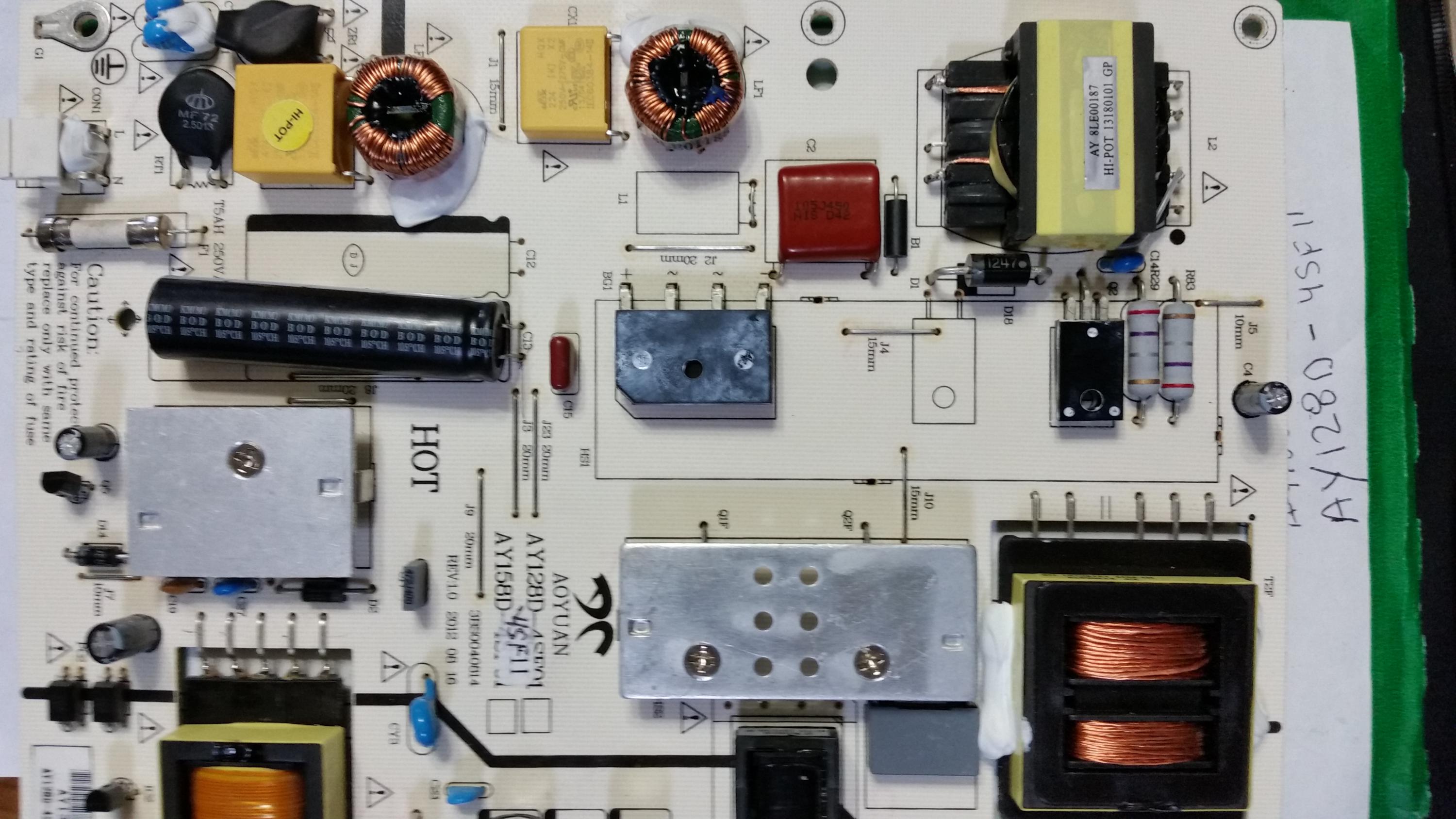

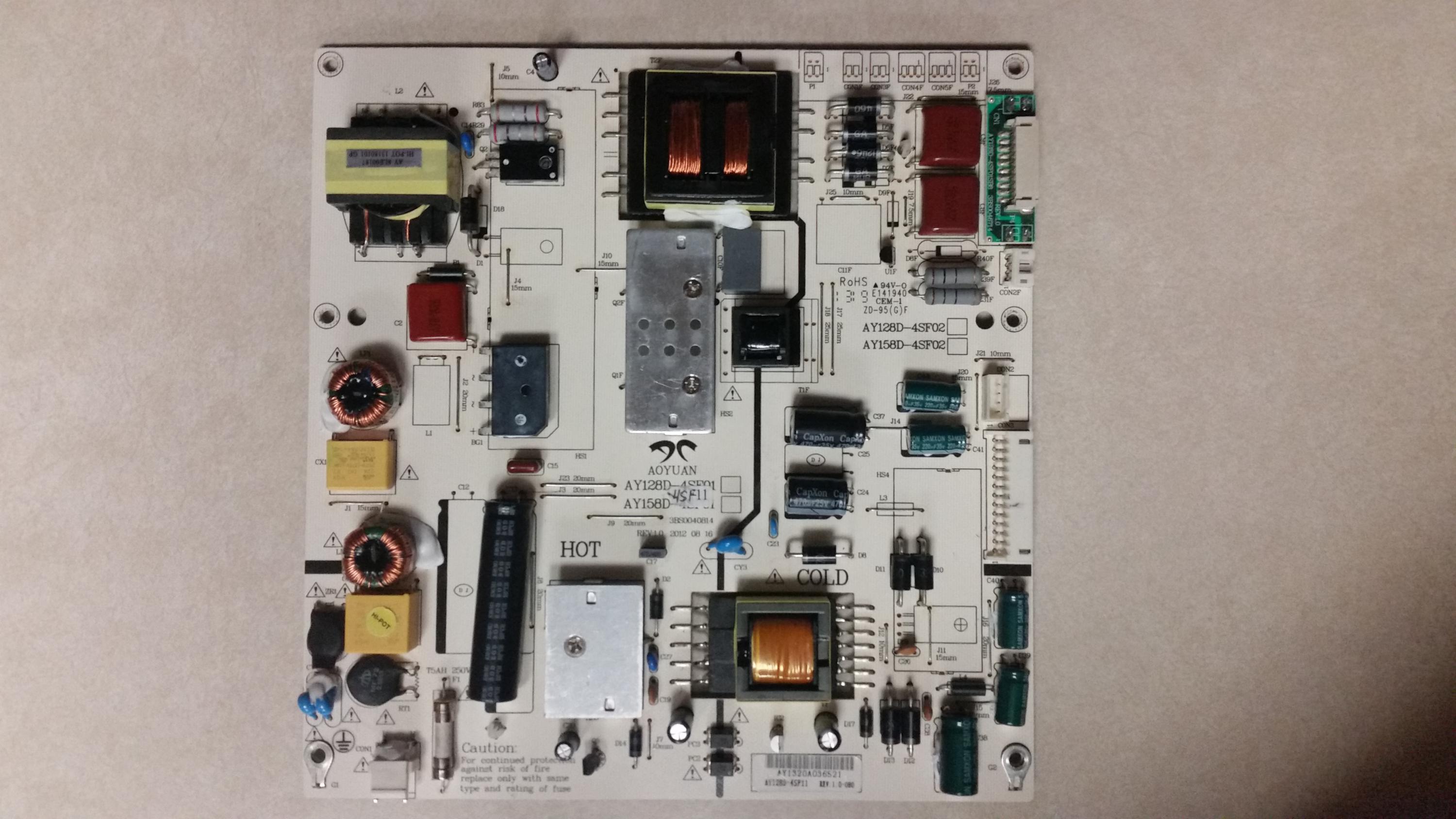

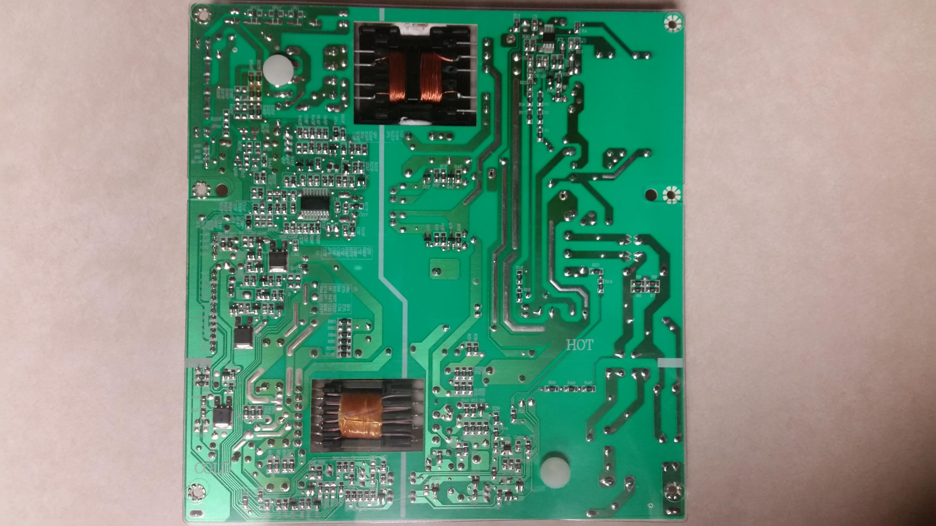

                                  Can you take really good clear straight shot pictures of the whole top side and the bottom side of the power supply-LED driver board?
                                  • mnpdreed
                                    • Sep 2014
                                    • 122
                                    Re: Proscan 50" PLDED5066A-E no backlights
                                    Thanks for helping. Here is the pics
                                    • CapLeaker
                                      Leaking Member
                                      • Dec 2014
                                      • 8087

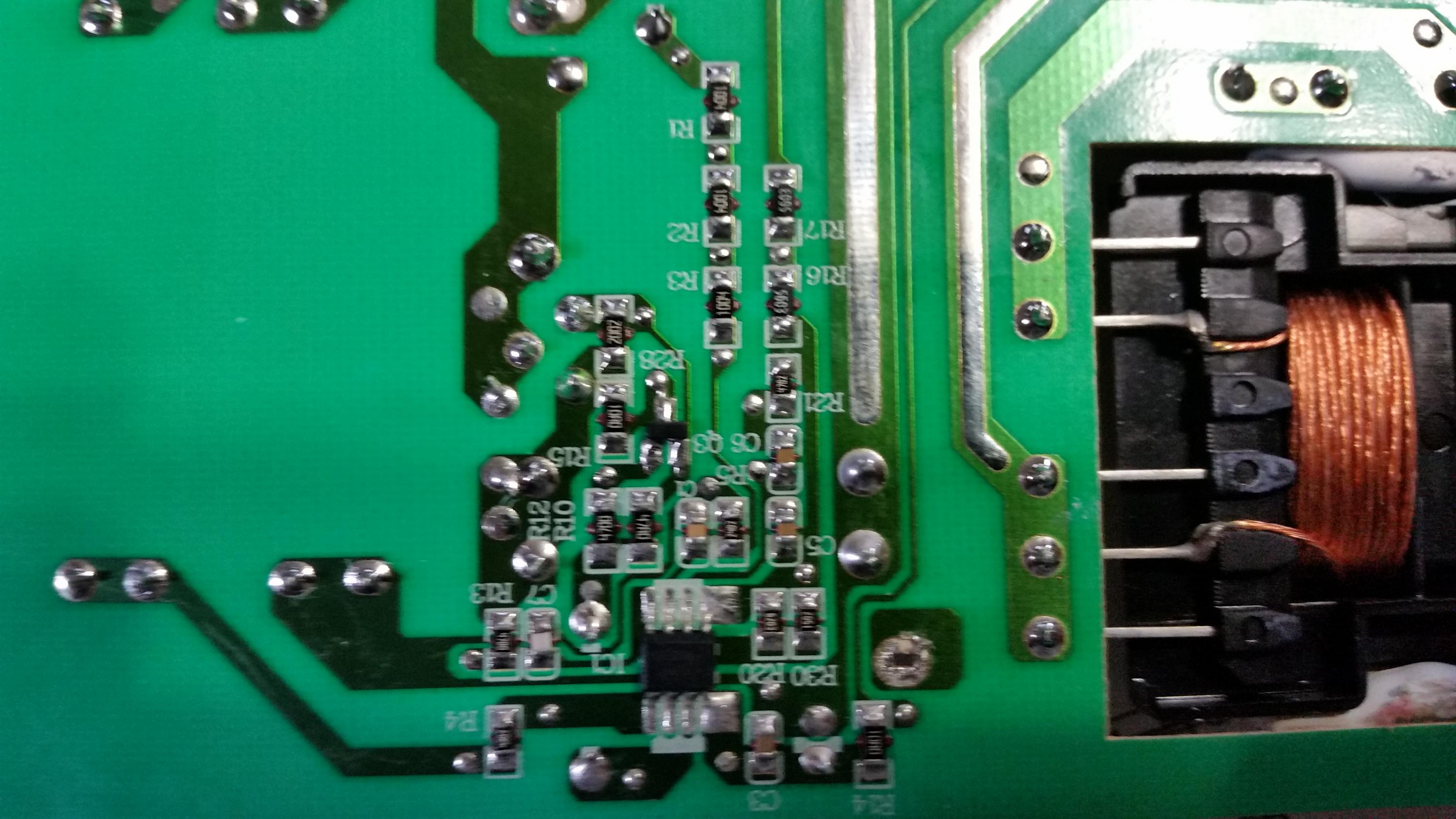

                                      Second pic top left corner, seems to be some SMD components that have a different brownish colour? Can't read it, as the pic is a bit blurry. Is that white round sticker for decoration?
                                      • mnpdreed
                                        • Sep 2014
                                        • 122
                                        The two white pieces are plastic tabs that hold the clear plastic over the back. I can take take closes up of different sections of the board if that will help.
