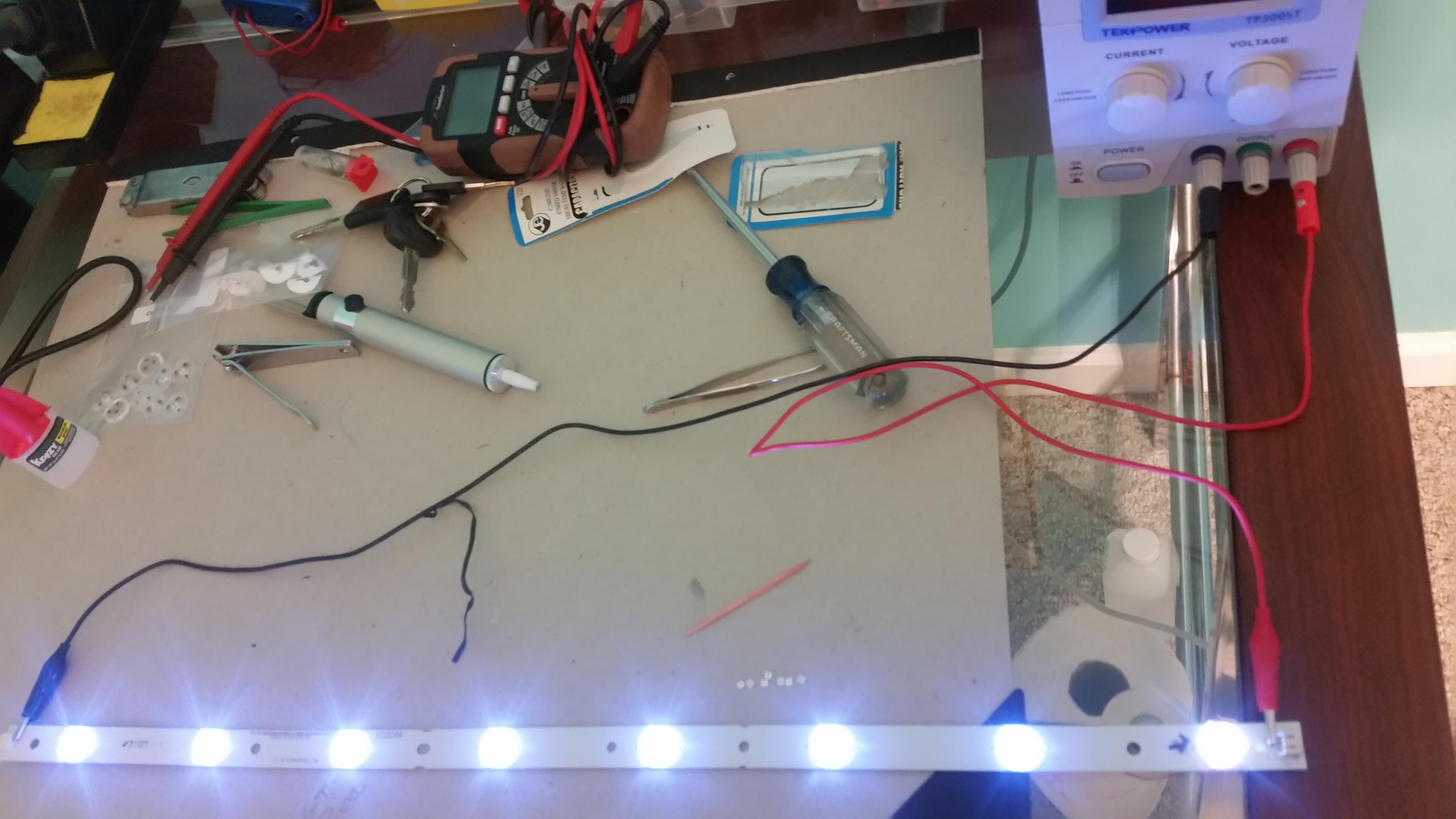

                #67
                Re: Proscan 50" PLDED5066A-E no backlights
                5 X 14. I connected two AA batteries and checked each light individually. They all worked.

                    #69
                    First I would like to thank everyone for the help. Update!! Apparently when I tested each LED in the strip I missed the first LED in each strip. I bought a power supply and tried to test each pair of wires with 45 DCV. I got nothing so I broke down and removed all of the strips from the tv. On all five strips the first LED is bad. The back of the strip under those LEDs are burnt. Sorry for the confusion.
                    Is there a way to remove the LED and replace those that are bad. The strip is around 25 each and the tv is not worth that much but I do have LED strip from another tv if there is a way to remove.

                          #72
                          1. remove the defective LED
                          2. remove excess solder with solder wick
                          3. Take a spare LED strip from another TV if you have one and cut out a piece of PCB containing a good LED one or two inches long
                          4. Glue that piece onto the strip to be repaired. Kapton tape and glue or double-sided tape.
                          5. connect the piece of PCB to the LED strip with wires.
                          DON'T bother trying to solder a LED onto the defective LED strip. It has big copper traces that serve as heatsink. Heating the LEDs to much during soldering will destroy them.

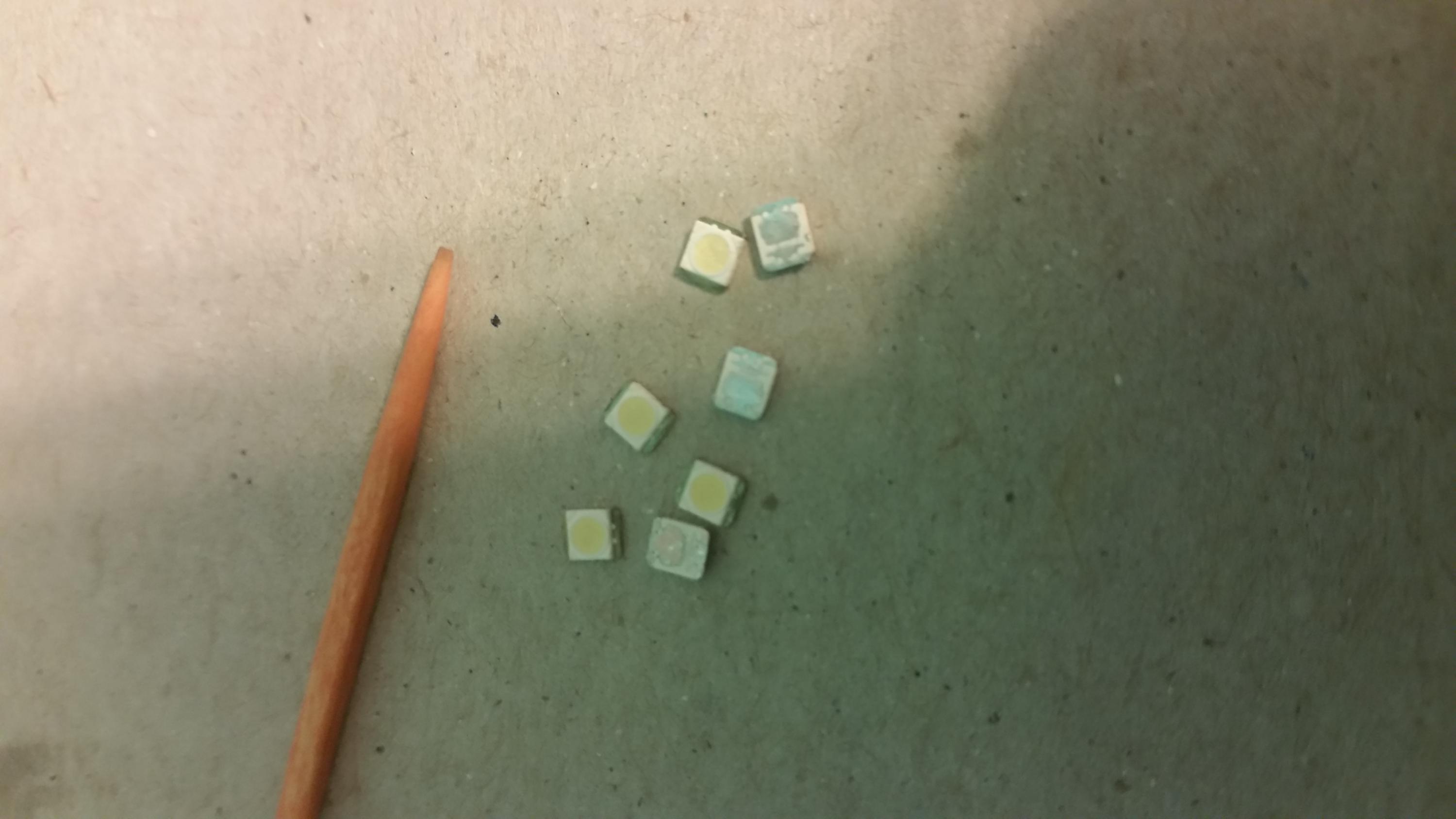

                              Here is an update. I bought a rework air station. I was able to remove some LED s from and old strip and replace the bad ones. First on a success. I will try and get them all done this weekend and install back in TV to see if it works. Thanks again everyone for helping.
                              • mnpdreed
                                • Sep 2014
                                • 122
                                #75
                                Decided to go ahead and complete the LED swaps. All of the bad ones were shorted. TV works perfect. Thanks everyone.
