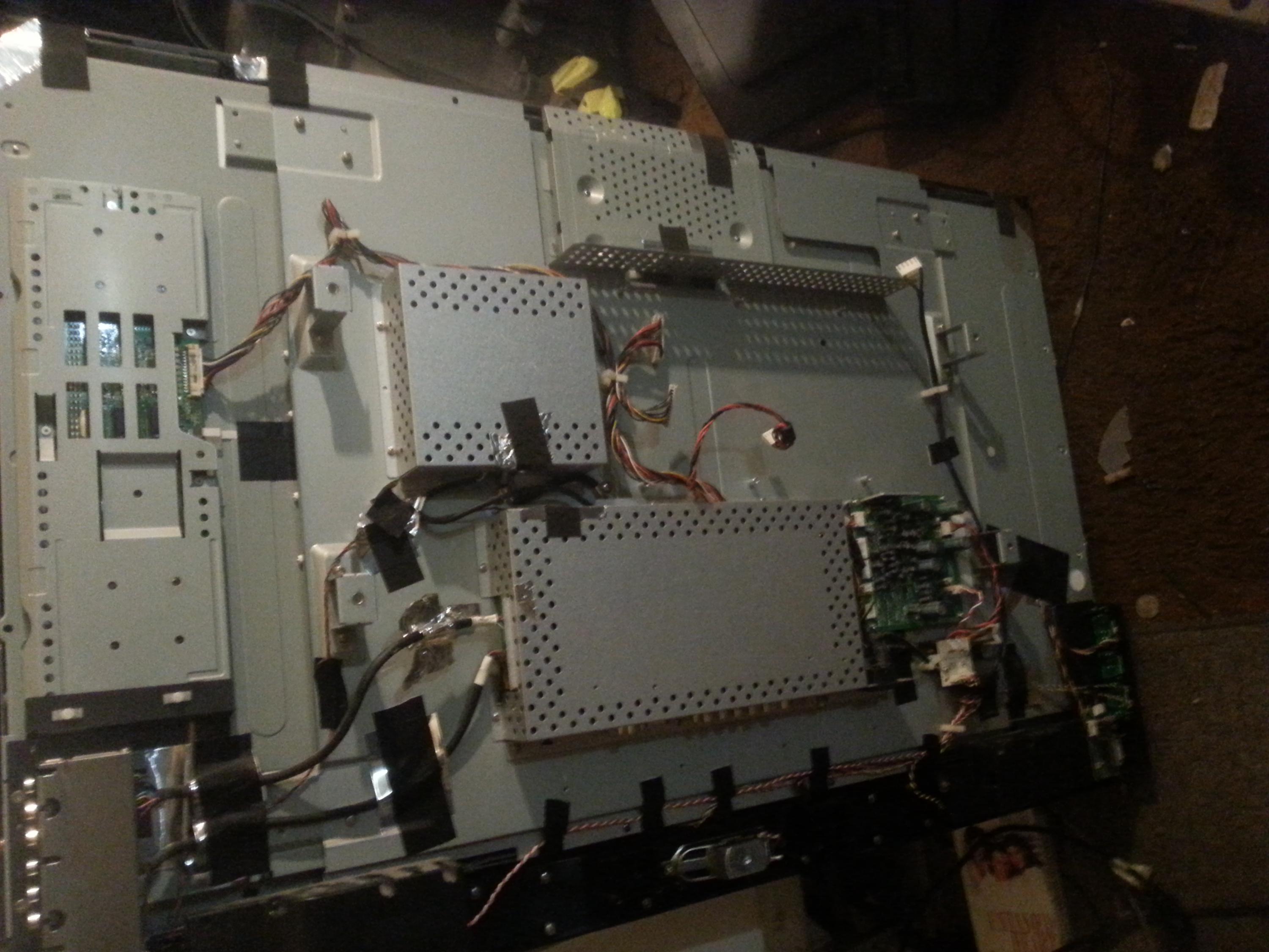

    I got a vizio hdtv in with good screen. But somebody took the power supply out and I cant identify it. The one that is supposed to go in here according the model number is one with the inverter built into the power supply. This one has the external inverter.. Im lost.
    Model according to cover is v420xvt1a

    0500-0507-0340

      Re: identify vizio hdtv power supply needed
      ozzy214,
      perhaps you need this [Vizio 0500-0507-0560 (DPS-284BPA) Power Supply for SV420XVT1A]
      http://www.shopjimmy.com/vizio-0500-...wer-supply.htm
      Link below for everything v420xvt1a
      http://www.shopjimmy.com/catalogsear...t/?q=v420xvt1a
