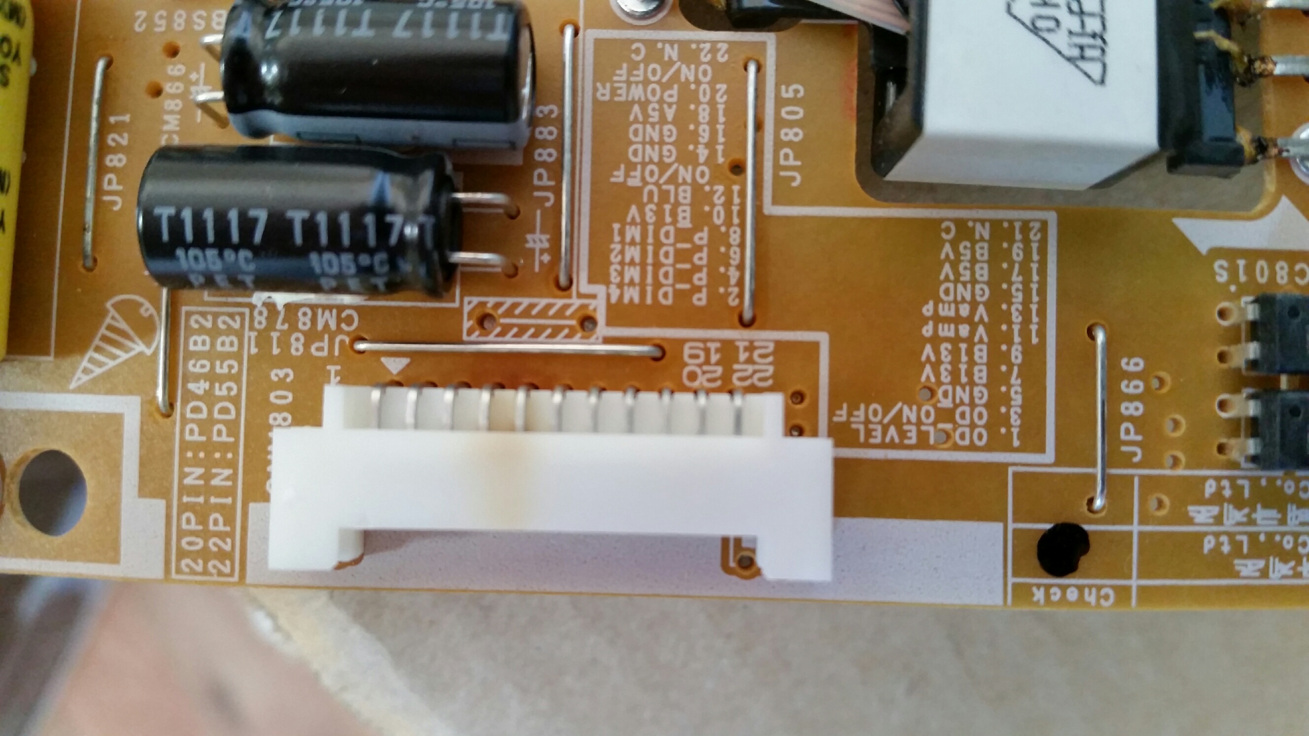

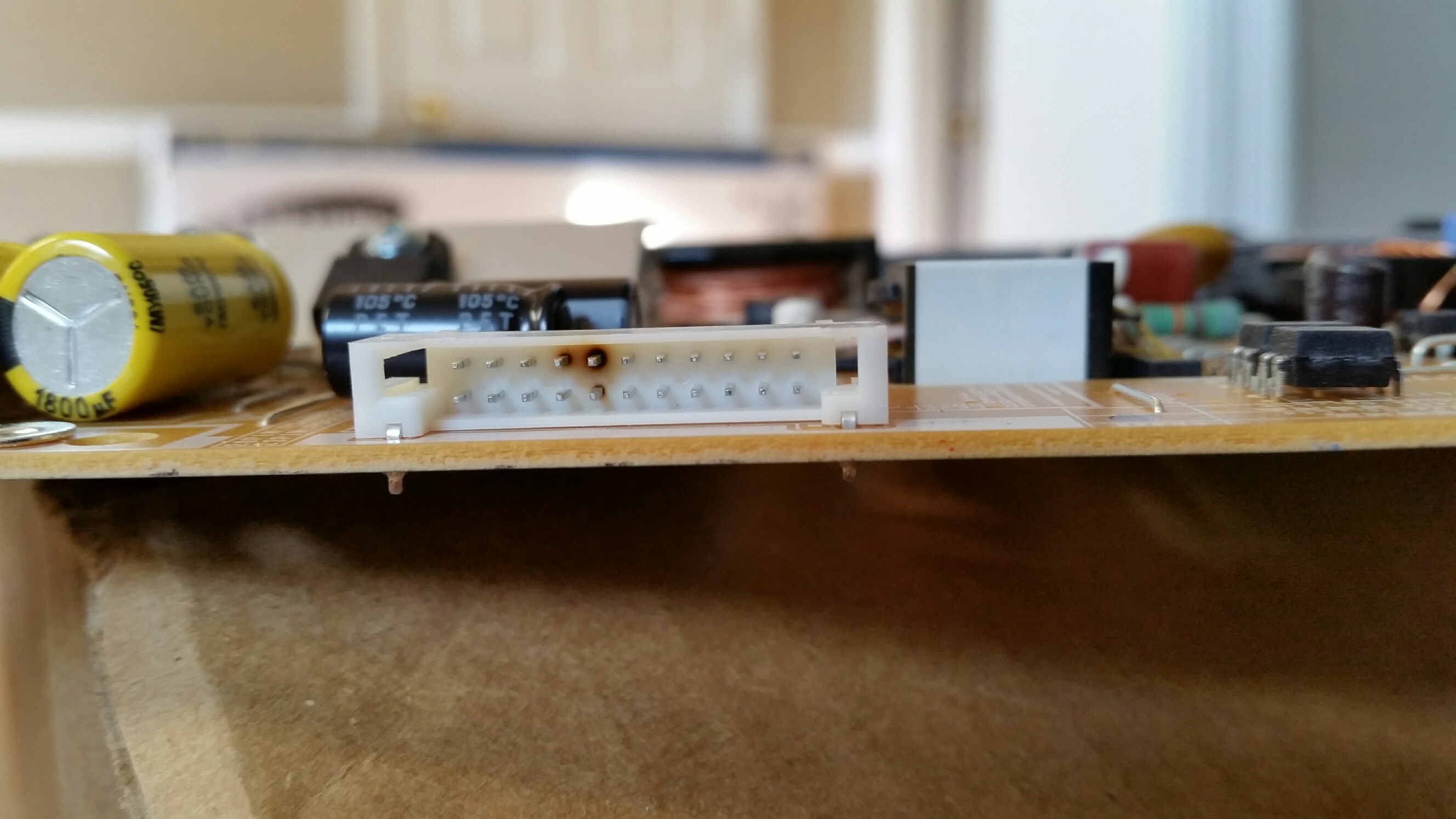

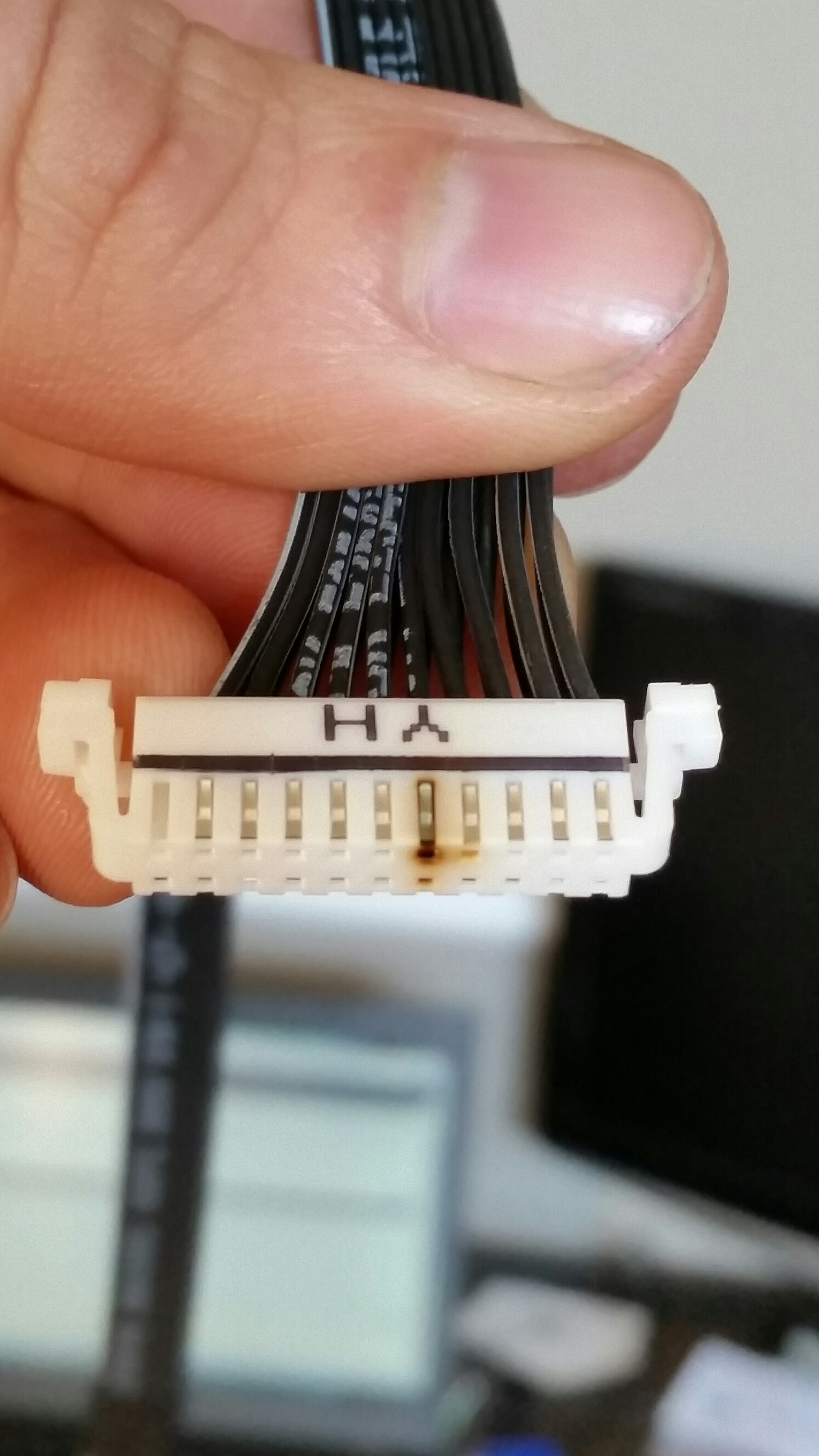

      Re: Samsung UN55D7000FLXA cycles on/off P/S to M/B cable appears to be damaged
      Here are some pictures of what I found. The bottom of the board appears to be normal.
        Looks like the 13v to the BU board. Can you confirm on the mainboard that pin 10 13v is not shorting to ground on that board?
                It could even be that pin was loose and heated up from high current going through a loose connection, causing the connector to be damaged and the TV to drop out.
                Since the TV still works mostly, there probably are not shorted parts. Maybe with Netflix only it draws less power so the dodgy connector doesn't come into play.
                I would replace the connector and cable, ensuring they are well connected and see what happens.
                  Or in a pinch you could get by and cut the wire off of the harness and carefully solder it to the back side of the mobo for pin 10 since the harness connector is already bad and see if that straightens you out
                      You probably wont be able to find one, do what freak says and what is shown in the video. More reliable !
                        Pin 7 and 9 carry the 13V (They use two wires for reason), so may be pin 7 is not carrying the current due to bad/open connection so most of the current is flowing though pin 9 instead. Check the the connection on pin 7. I would solder the wire as suggested.
                            According to the chart as printed on the board pin 10 is also for the same B13V as for pin 7 and 9, so that is correct.
                            So do you have 13V on those pins when TV is ON?
                                That would probably be the best option. If you can find a way to strip pins 7 9 and 10 off the connector to find a way to solder them directly to the corresponding connections on the board that may be your best bet for a long term solution. You have to be really careful to make sure you get the right wires on the right pins and solder the wires to the proper areas of the board. If you don't feel comfortable with soldering those wires to the underside where the pin connectors are soldered into the board you could trace the tracks to a suitable location on the board and you may have to add some extension wire to the wires at you clip off of the connector. All you have to do is follow the traces from the underside where the connector pins go to an area that you can solder the wire to that will not interfere with any other connection. Hopefully that makes sense. At least this is what I would do in this situation
                                      The p.n. for this cable ass'y is: BN39-01479A.

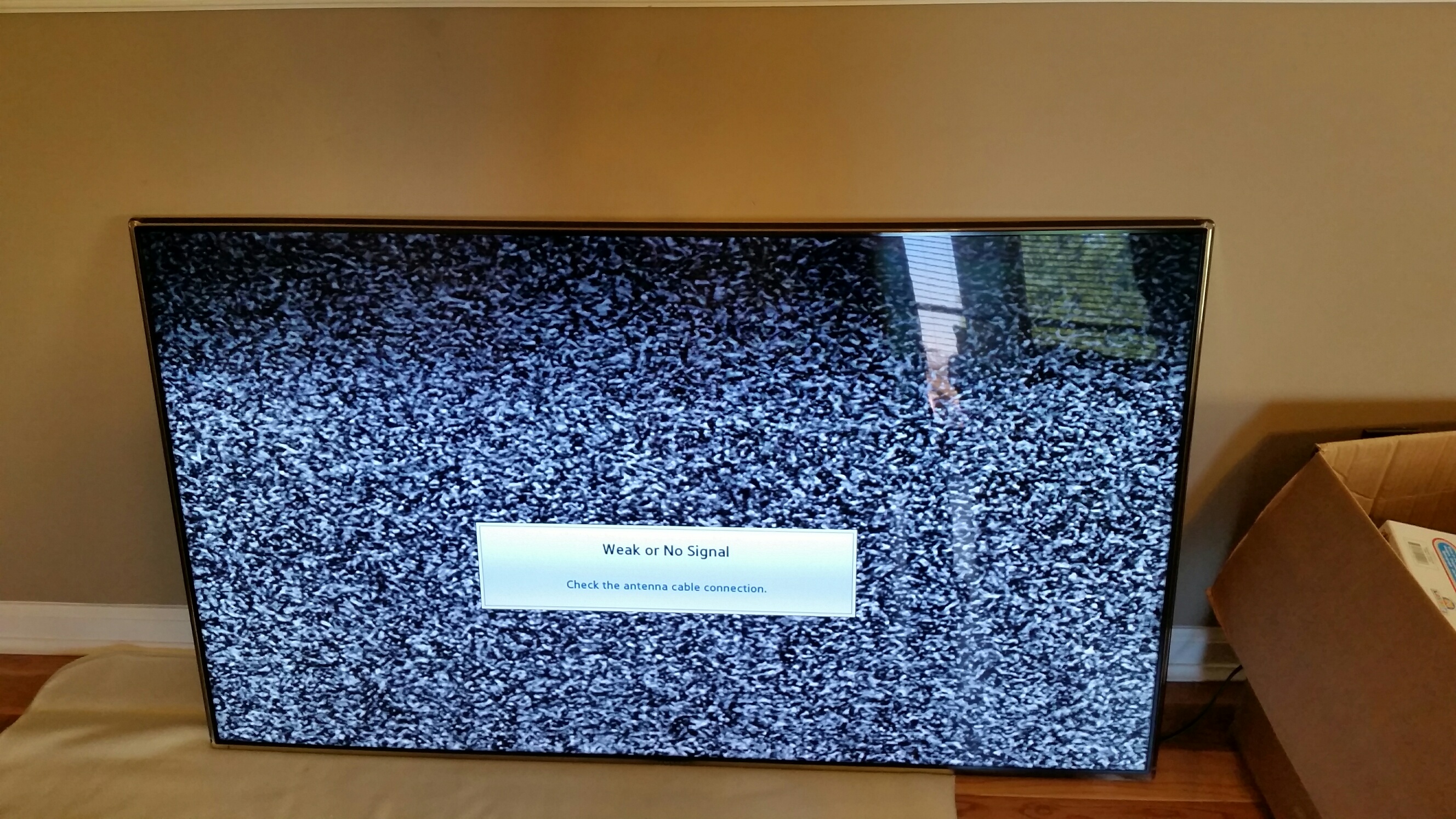

                                        I've soldered the wires to the connector and have the TV working again. Attached is a picture of the dark area at the top of the screen.
                                        As soon as I started playing a movie from my PS3 the TV started to cycle on and off. I noticed that it seemed to coincide with every time the screen went black, the TV would power off. As long as there was a picture on the screen it remains on with no issues, if the screen goes black between scene changes or after the piracy warning the TV power cycles. Any idea on what could be causing this behavior?
