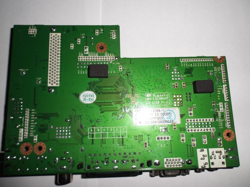

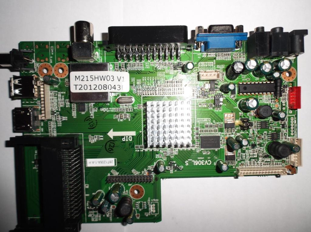

            • johnboy183
              • May 2008
              • 119
              Re: Akura 22" LED TV AMELADVD2YR215FDVH Standby problem
              hopefully some photos now
              • ReeceyBurger123
                Never Give Up !
                • May 2014
                • 7325
                • Britain
                Ahh classic Cv junk ! I would probably say failed firmware on this one, but do you know how to check voltage regulators just to rule them out ?

                          • ReeceyBurger123
                            Never Give Up !
                            • May 2014
                            • 7325
                            • Britain
                            Yes U11 is the Spi flash Ic or as I called it an Epprom. Have you found the software ? One thing you can also try is spraying U11 with refrigerant I use a can of compressed air upside down. Cooling the Ic can sometimes make it work.
