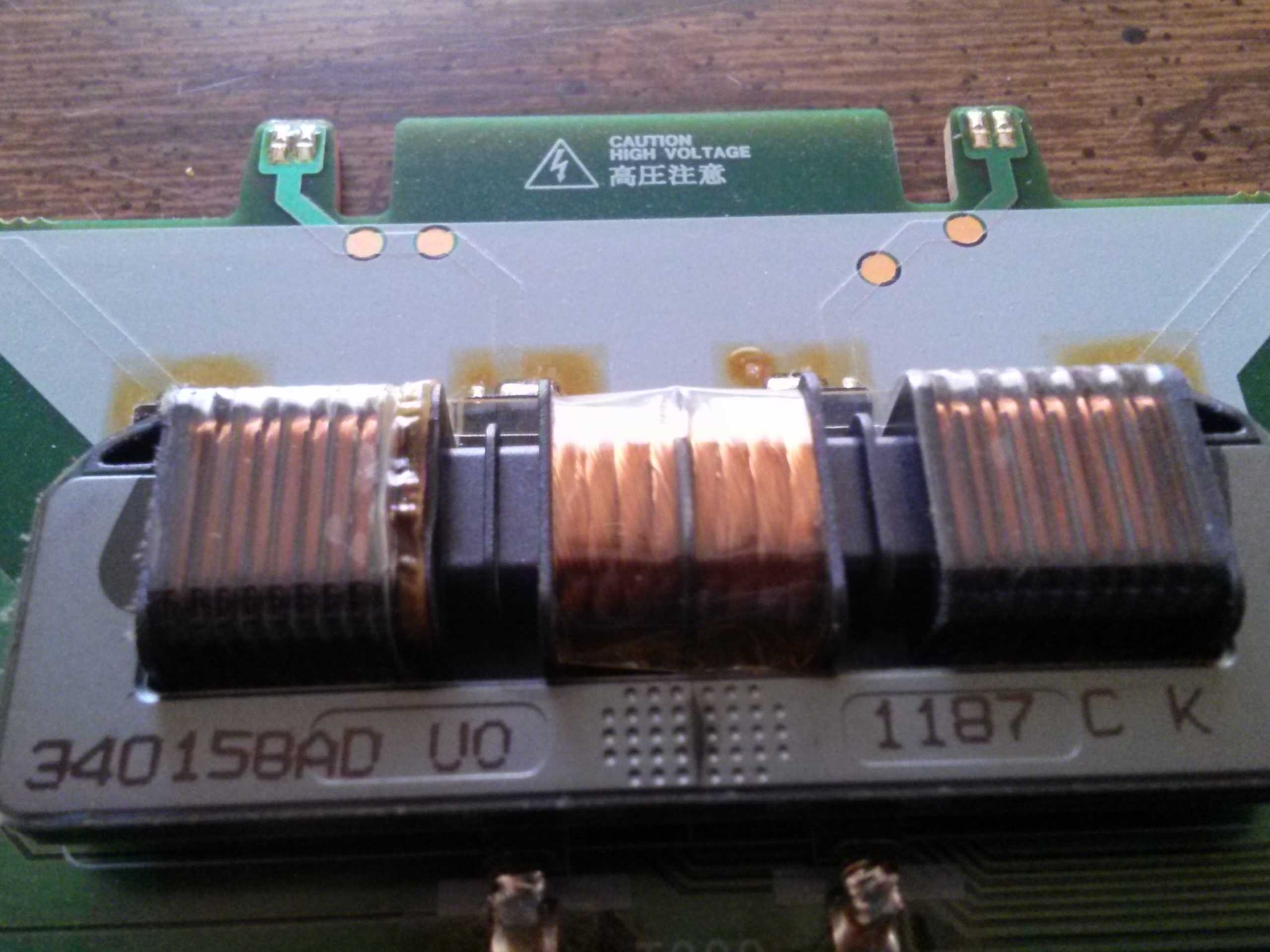

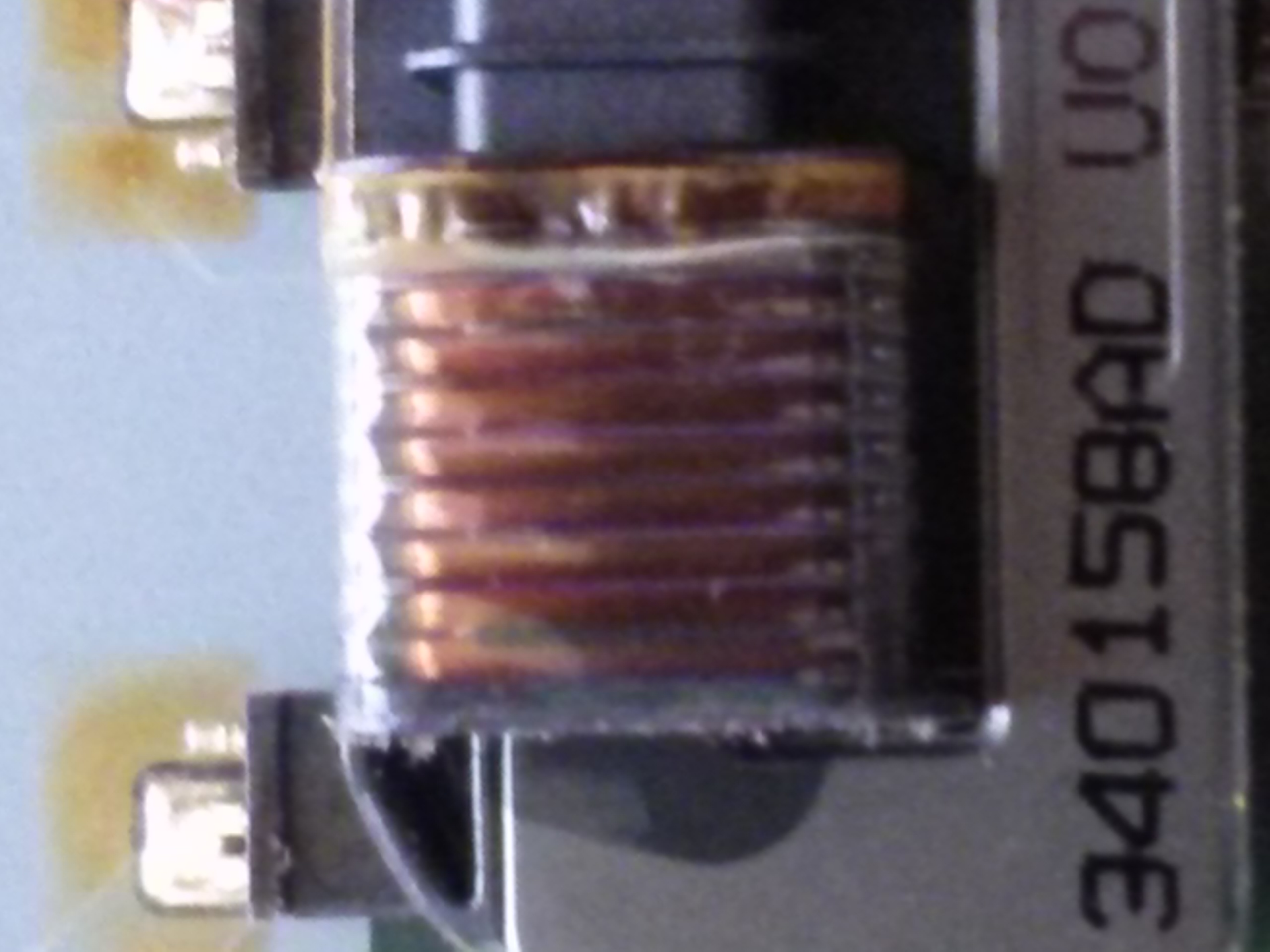

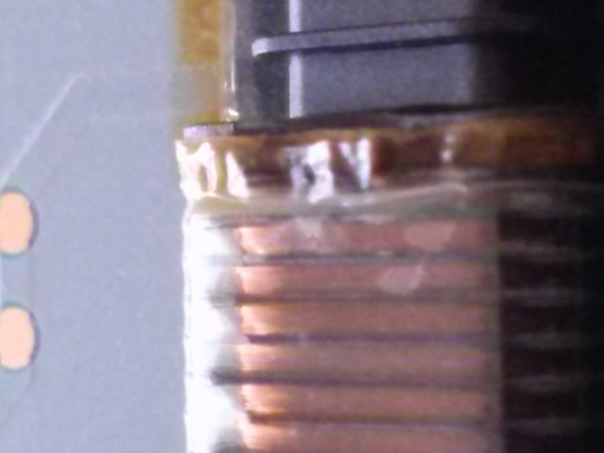

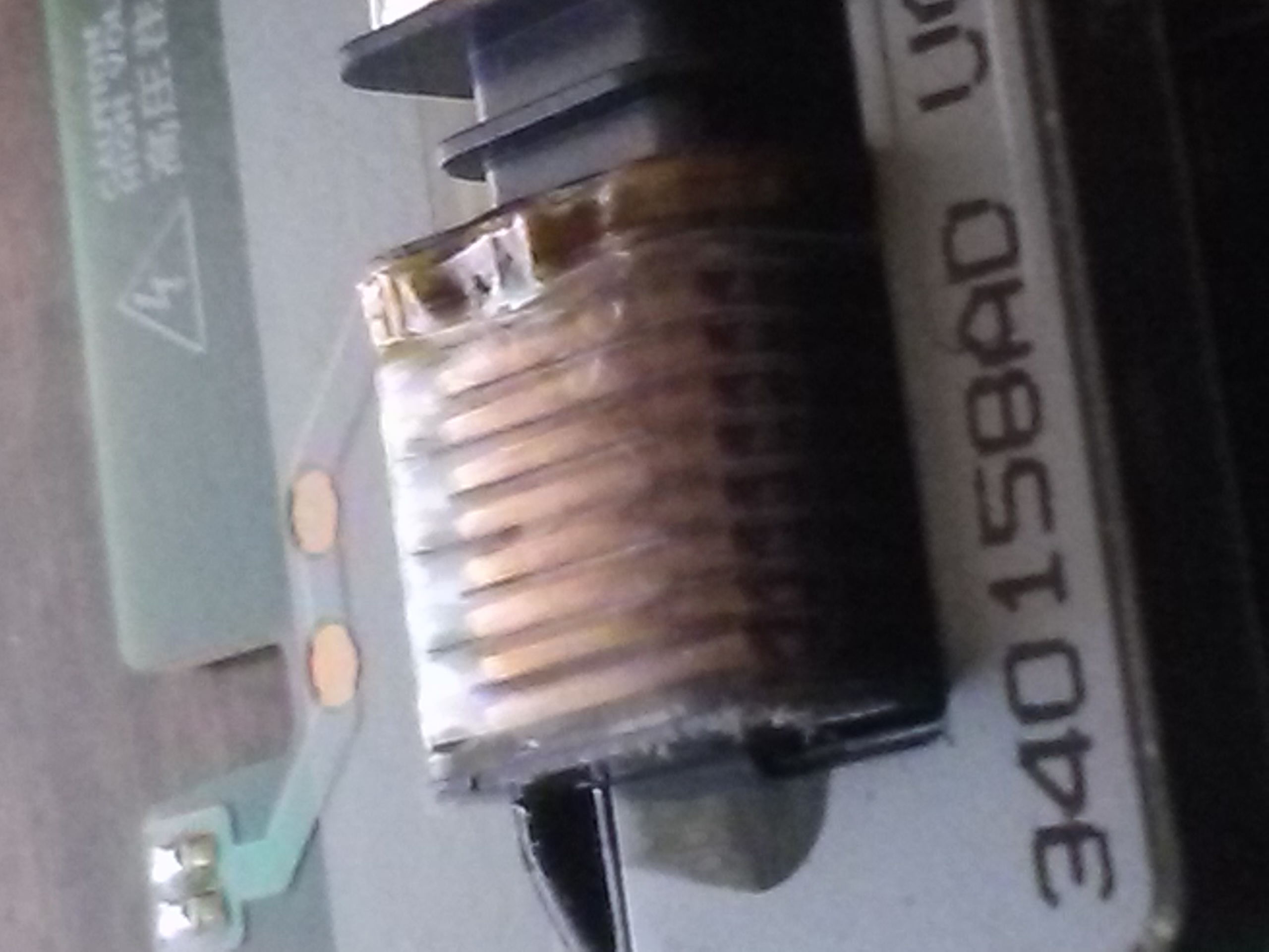

    this tv backlight turns on for 1 sec and shuts down. the cable to inverter tested 24v. It appears to be getting power to inverter. I noticed transformer at loc. T200 looks burnt(see pics).

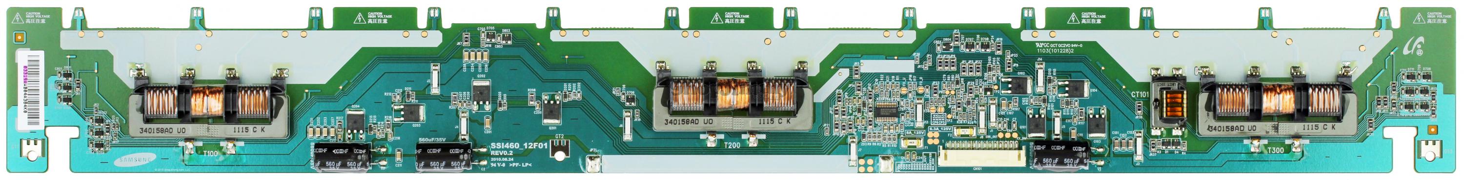

    the pic of entire inverter board is off shopjimmy site(not my board).
    First off I am wondering if anyone has a source for the
    transformer 340158AD or an alternate part. I cannot find one.
    second, can i check the circuit leading to the transformer with a multimeter to be sure other parts are good? if so how.
    Hopefully someone is familiar with this board and can give some input. it seems to be a common problem.
    i am going to look through my spare boards. update: closest i have on hand is 340163AD. probly wont work.

        Are you sure the transformer is bad? You can test for ohms on primary and secondaries. If you have a ring tester that is the best method. Have you tested feedback from lamps to make sure you don't have an out of spec bulb? Im not saying it couldn't be the transformer but there is a lot of tests you can do to confirm.

          Yes I am sure transformer is bad.
          I bought a board from buyqual.com. it should be here in 2 weeks.
