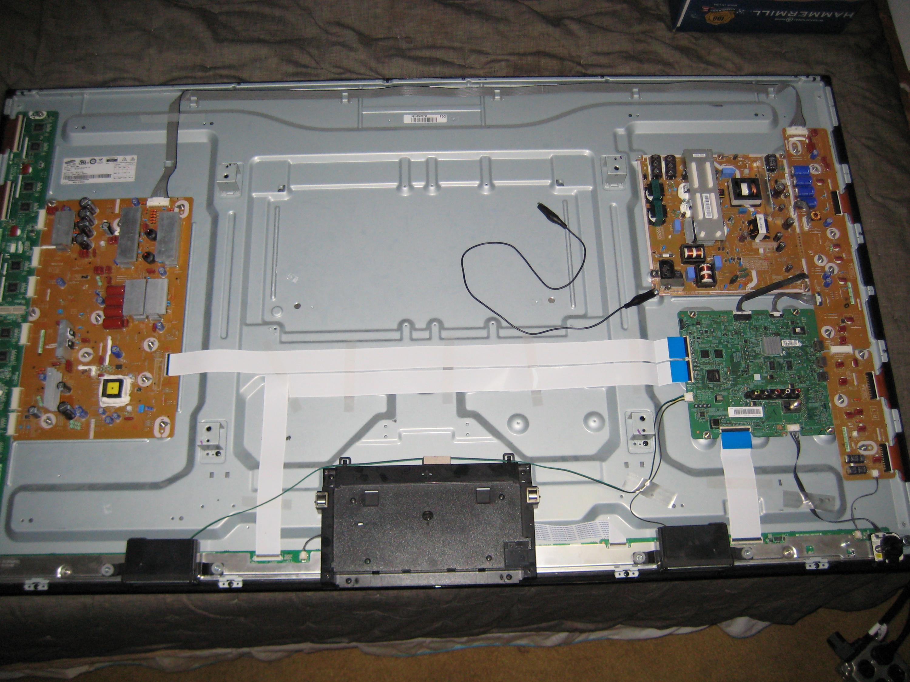

    Trying to help out a friend with a Samsung plasma that quit working. It is only a couple of years old. I am not familiar with plasma TV's at all, but I have had some success fixing various electronics so I thought I would give it a try. He had replaced the power supply and the main board, but then gave up. When you plug it in and hit the power button, it turns on the red power indicator and there is a green led on the main board that blinks slowly. No picture or sound. I have not seen one of these operate so I don't know if there is supposed to be a startup sound or not.
    Couldn't find a service manual for this specific model, but after doing some research I checked the voltages listed on the panel and found some problems on the Y-sustain board. After replacing some IGBT's and Mosfets, the Vs, Va, Vsc, and Ve voltages at the test points now match the label values, but only briefly after pressing the power button. Then they slowly bleed down to zero. To test again I have to unplug the set, wait a few seconds, plug it in, and hit the power button again.
    I see another test point on the Y-sustain board marked Outl, but I am not sure what voltage should be on it. I measure zero volts there.

        Are you saying the layout is exactly like the other thread?
        Ie: no control board.
        If so you need to check the critical voltages.
        VS and VA located on the power supply.
        VSC (Vscan) located on the y-sustain
        VE located on the z-sus
        There should be test points.
        All voltages may only appear momentarily, so you might need to turn the tv off and on and quickly check each point.

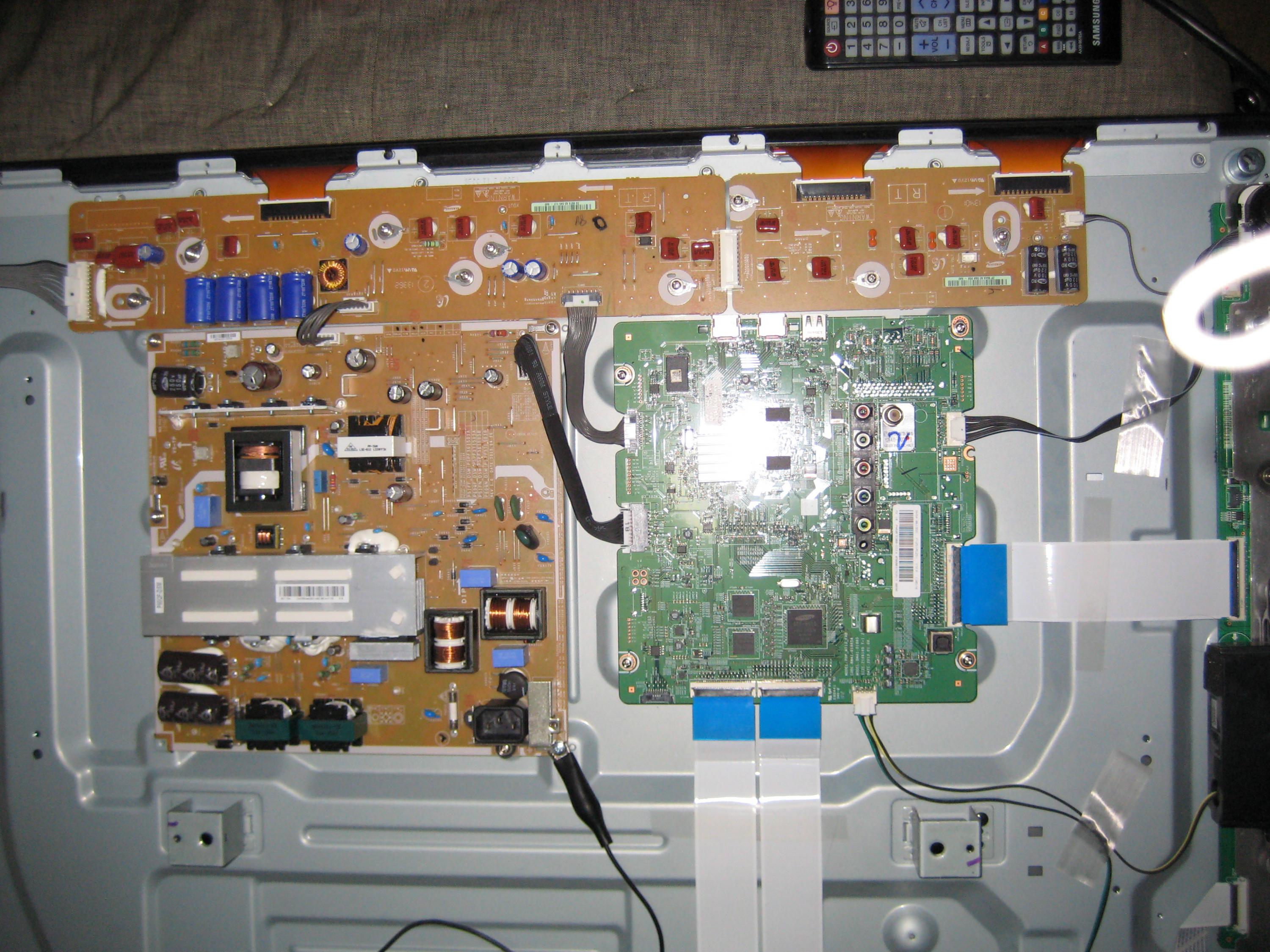

          Yes, I saw the label on the panel and found the test points. Initially the Vs wasn't working because of a shorted IGBT and the Ve wasn't because of a faulty Mosfet. I changed those and now the voltages are:
          Vs label 208 actual 209 momentarily at power on then drops slowly
          Va label 57 actual 56 "
          Vsc label -195 actual -195.5 "
          Ve label 113 actual 112 "
          If I understand the names correctly, there is no control board.
          I tried to get some pictures. Poor light and flash glare, but you can see the layout.
          I will try to flip it over and check carefully for cracks. Would a crack cause the power supply to go into protection?
          Jerry
            Re: Samsung Plasma problem PN60F5350AFXZA
            A crack will cause a failure to sustain, which will trigger a shutdown.

                  Try disconnecting both upper and lower buffer boards and power up. Does it stay on now?

                      I thought I would try checking them for shorts so I took them out. Not sure exactly which pins to check but I didn't find anything conclusive.
                      Those connectors to the Y-main board are annoying, but I got them apart again without damaging them.
                      With the buffer boards out, the voltages still do not stay on, but I did notice a slightly different behavior. When I plug in the power, the red LED on the front stays on. Then when I hit the power button, it goes out, blinks twice, slowly blinks ten times, and then gives two more quicker blinks. Is this some sort of code? Maybe it was doing this before and I just didn't notice it. The green LED on the Main board just continues to blink slowly.
                      Tucocaps: When mine was not producing the Vs voltage momentarily, I found that one of the IGBT's in the upper left of the Y-main board was shorted. I replaced both and then started getting the 208V momentarily each time it turned on. I have not tried shorting the PS-on for fear of blowing something out again.
                      Jerry

                                      Thought I should update this thread and close it out.
                                      I sort of dropped it when I got busy with other things last fall and the thread kind of got hijacked. Two weeks ago I started looking at it again. Disconnecting things doesn't seem to help at all on these sets. There must be feedback that shuts the voltages down if everything isn't just right. The repairs I had made to the Y-main board got the panel voltages to work momentarily at turn on, but I still had nothing on the OutL tp as I originally mentioned so I checked the board more thoroughly and found some more shorted diodes and transistors on the back side. There is a lot of circuitry on the back side.
                                      Giving up on the repairs, I ordered a replacement board on eBay that supposedly came from a set with a broken screen. With some skepticism, when it arrived, I checked the parts that appeared bad on the original and found no shorts so I installed it. Amazing! The TV came back to life and seems to be working 100%.
                                      Judging from the threads on this forum, it looks to me that plasmas are more complicated and less reliable than LCDs. Might be one reason they have gone extinct.
                                      Thanks for the help and I hope this info may help someone else.
