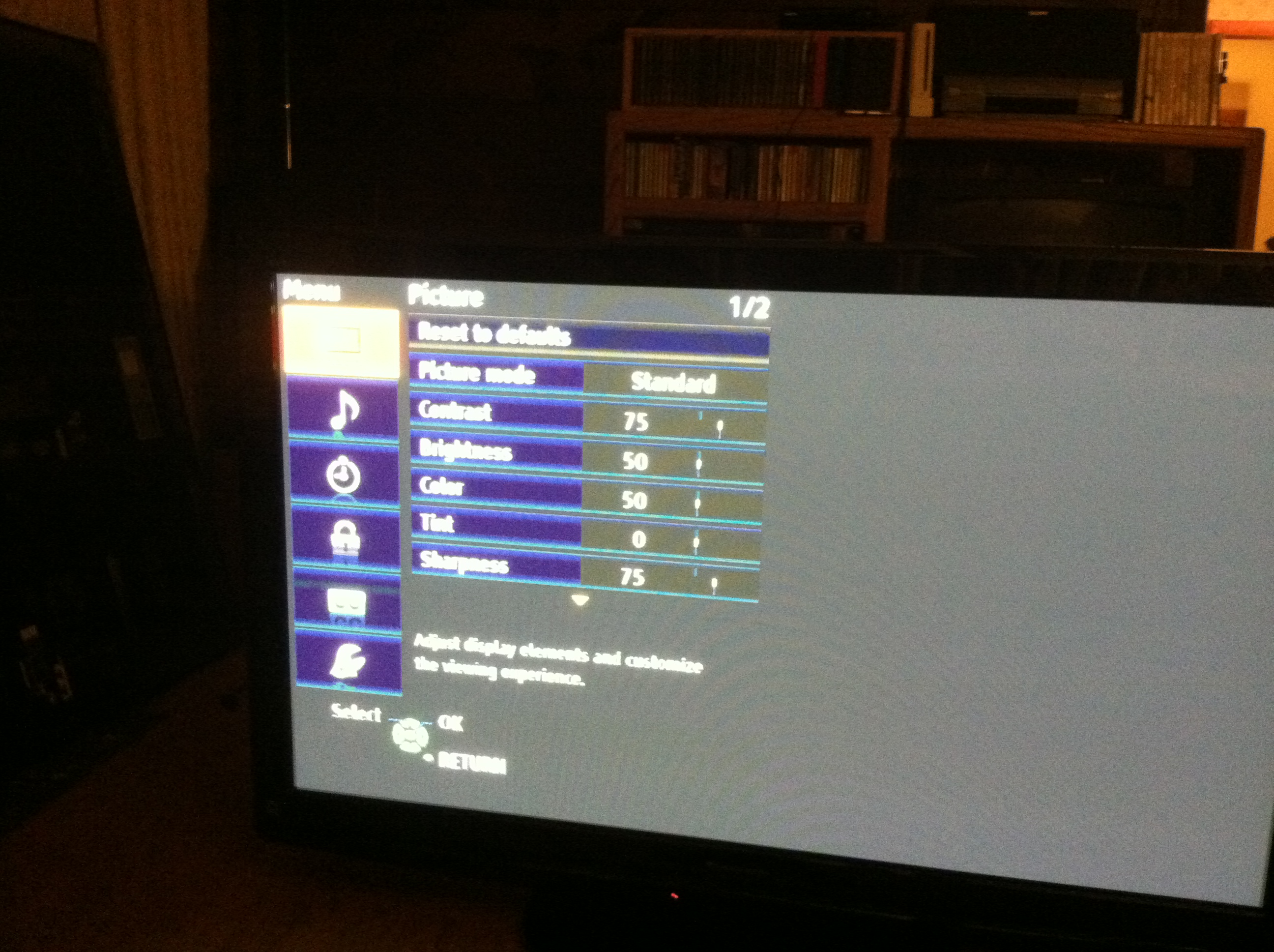

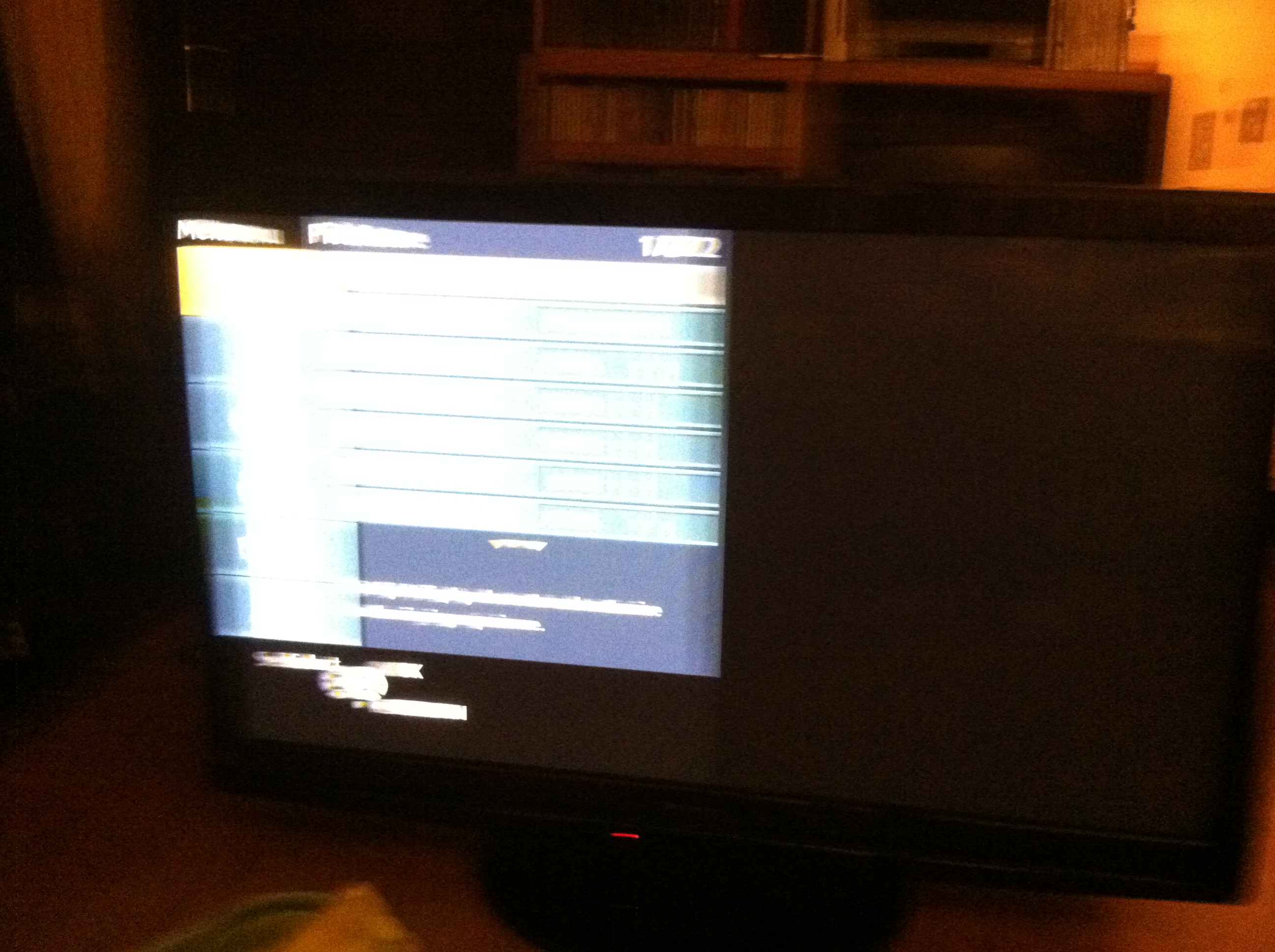

    I picked up this TV online, without knowing that it had problems. When I brought it home, it showed weird colors on poweron but it cleared up after say 5 minutes of running. I removed the SC (Ysus) board to inspect it up close, found nothing shorted or tampered with, so I put it back in, except I didn't put all the grounding screws. Upon power on, something blew on the SC board and gave me 6 blinks. Pulled it again, and upon examining up close, saw Q621, & Q661 shorted. Also IC773 (I think is an inverter) was shorted vdd/gnd. Ordered these parts from China and replaced them today, now the TV does fire up, the screen looks good for 2 seconds, when it starts pulsing with weird colors messed up at the same time. After a minute, the pulsing stops, but the weird color problem stays. I didn't keep it on longer than 2-3 minutes at a time, worried something might blow. At this point, looks like the repair is stable (it survived several power on attempts), but seems to be back to square one where I started. I have attached two pictures, first one immediately after power on (looks good) and the second after 2-3 seconds (colors messed up). Any have have any ideas what is going on here?

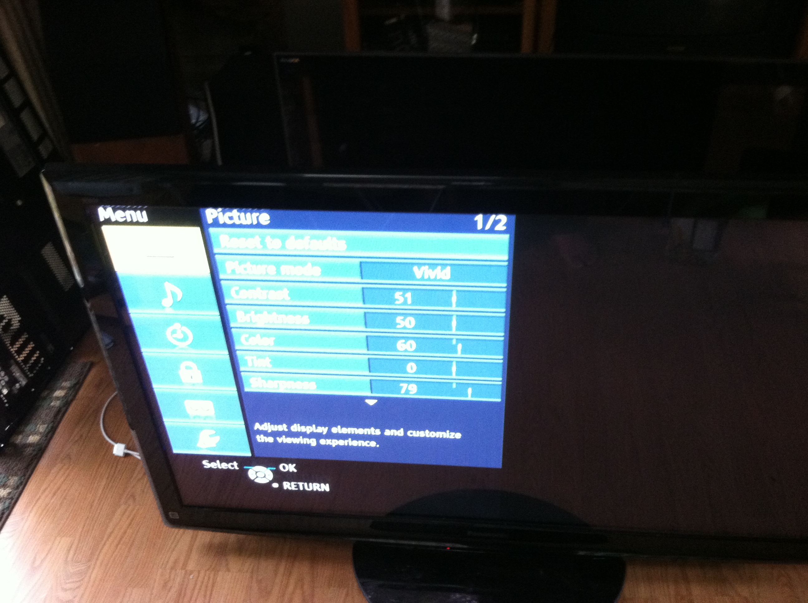

      Its a TC-P50C2. I noticed today that if I set the picture settings in the menu to be "Standard", it does the flickering and display poor color. However, if I set it to say "Cinema" or "Vivid", it looks good (no color distortions). Also, although unrelated, there is a faint greenish line across the screen right at the middle, several pixels wide. It is probably related to aging buffers, but I thought I'll mention it here. So really confused.

          I take that back, the problem still exists if I set the picture settings to "standard". It works fine in "Vivid", "Cinema" etc. No idea what is causing this. At this point I dont think it is a VSUS or SC board issue, as the behavior of the SC board should not change based on the software picture settings. May be worth trying an software update? But this thing needs a SD card.. sucks..

                            I made a video of the TV problem, can be seen here:
                            https://youtu.be/3SSyoCW5XTw

                              A little more update on this problem. As luck would have it, someone in my town was selling this very same tv in fully working condition, so I bought it for the purpose of swapping boards to isolate this problem. To my surprise the A board (main board) seems to be the problem. Installing the problem A board in the known good tv recreated the color distortion and Vsus test issues. No idea what could be causing this, at least I won't be engaged in a wild goose chase here.
