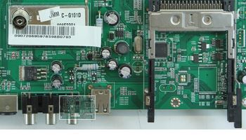

                                Re: Bush s642f factory reset
                                Can you supply a sharp photo of the power supply connector showing any legend alongside giving the voltages read.
                                Can you also supply a photo of the main board.
                                • dick_barton
                                  • Aug 2015
                                  • 6643
                                  • Wales
                                  There appears to be a 5V regulator feeding the tuner and several metal oxide resistors around the tuner you could check out.
                                  • jczarniak
                                    • Oct 2015
                                    • 179
                                    Good idea.
                                    I'll check that.
