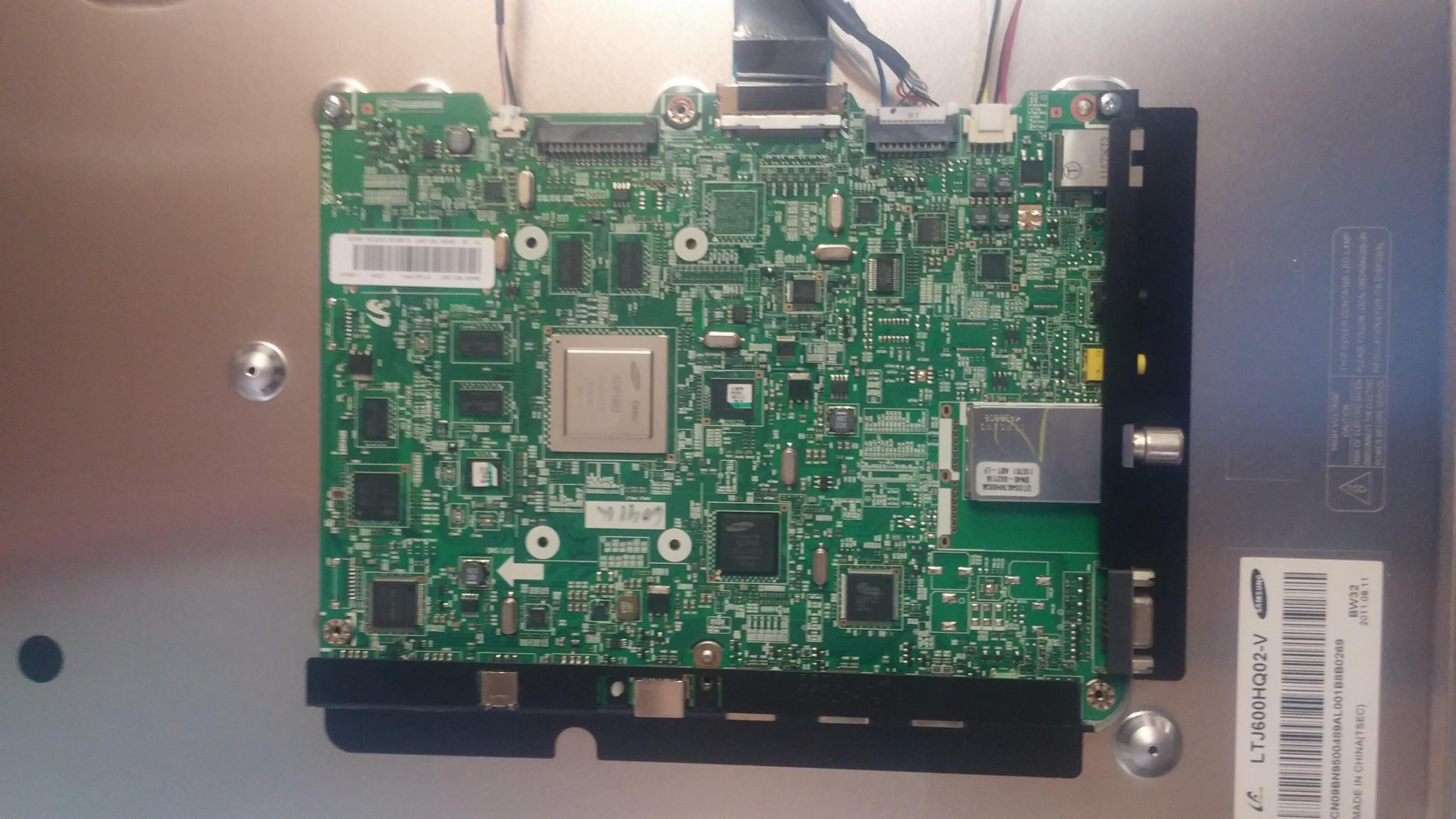

    Hi, I have a Samsung UA60D8000 which cycles on and off, there isn't enough time to carry out any measurements. I disconnected all cables from the power supply and I can measure the 12v and 5v rails. disconnecting the led strips only will not stabilise the supply but disconnecting the main board does but of course will not light the led strips as the TV cannot be switched on.
    I am unsure whether the main board if faulty as I cannot see the supply running fully with the main board plugged in.
    Does anyone know how the supply is activated by the main board and what pins are used or does this sound like a main board problem as I suspect.

    With the leds disconnected the power supply will likely go into protection so that test won't tell you anything.
    Take a careful look at the screen when it lights for even lighting. Could be a bad strip or two which shuts the ps off shortly after power on.
    Also hit the main board with a hair dryer. May have dodgy bga/solder connections.

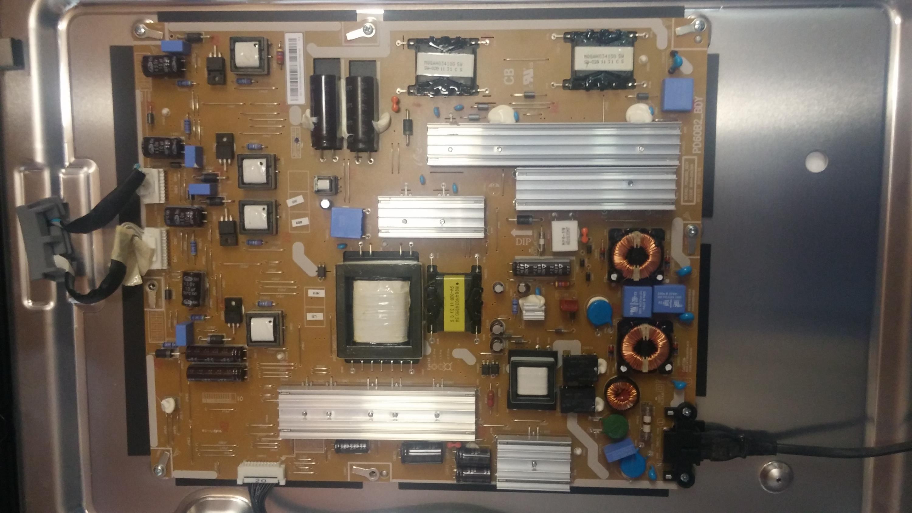

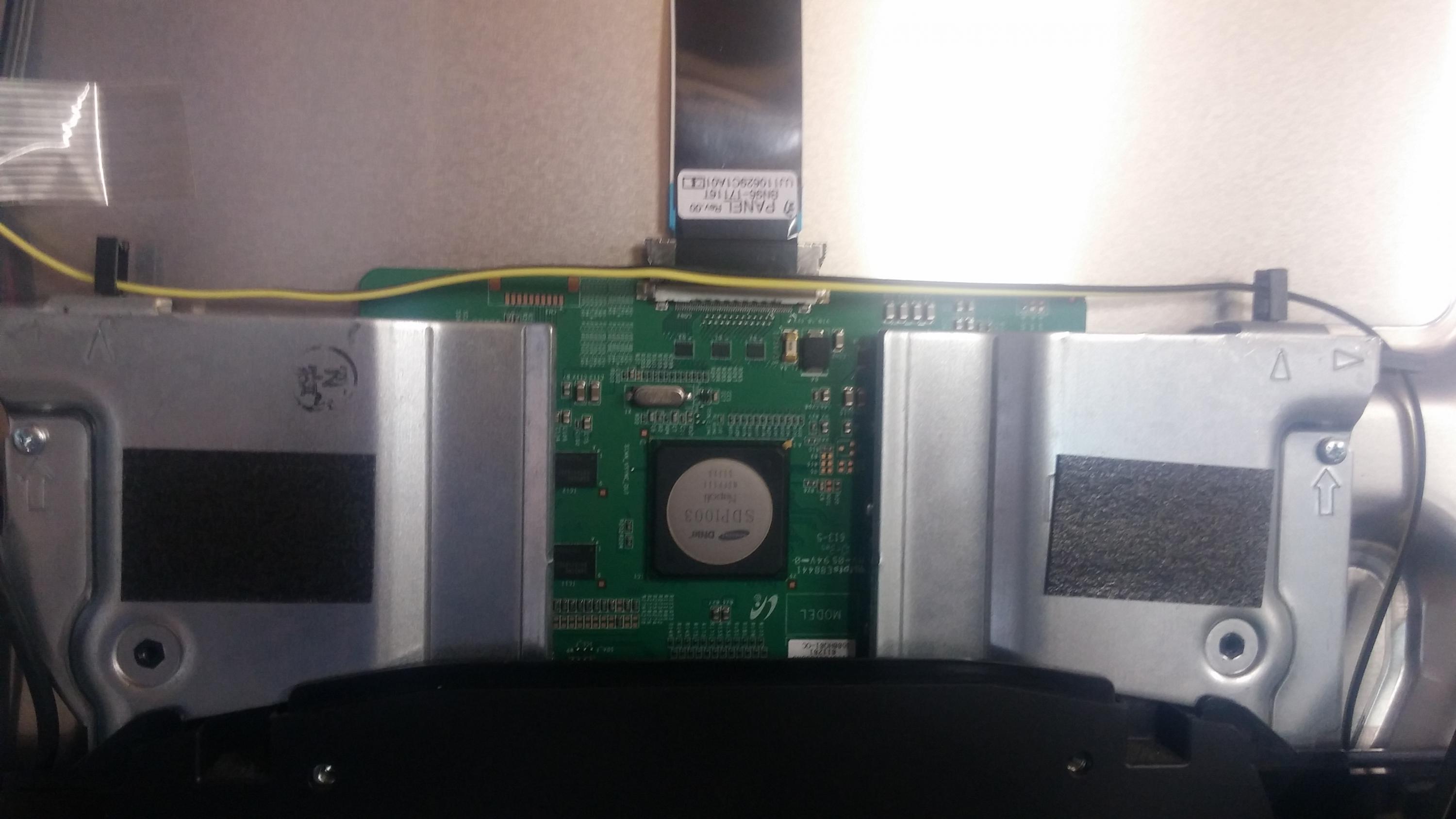

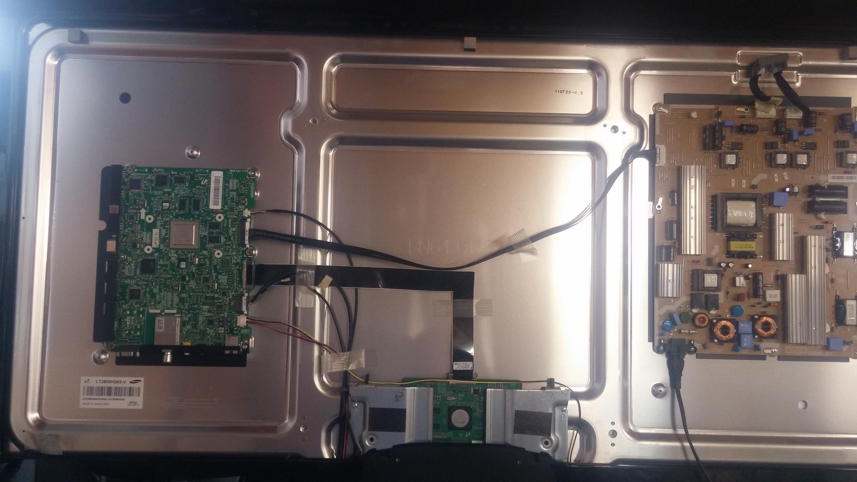

        How about pictures of the whole back side of the TV so we can see how all the boards are connected together?
        What happen if you disconnect the cable between the main board and the power supply, the backlights should come on and stay on when you plug the TV into the outlet (no need to hit the power switch).
        What is the power supply board P/N? BN44-?????

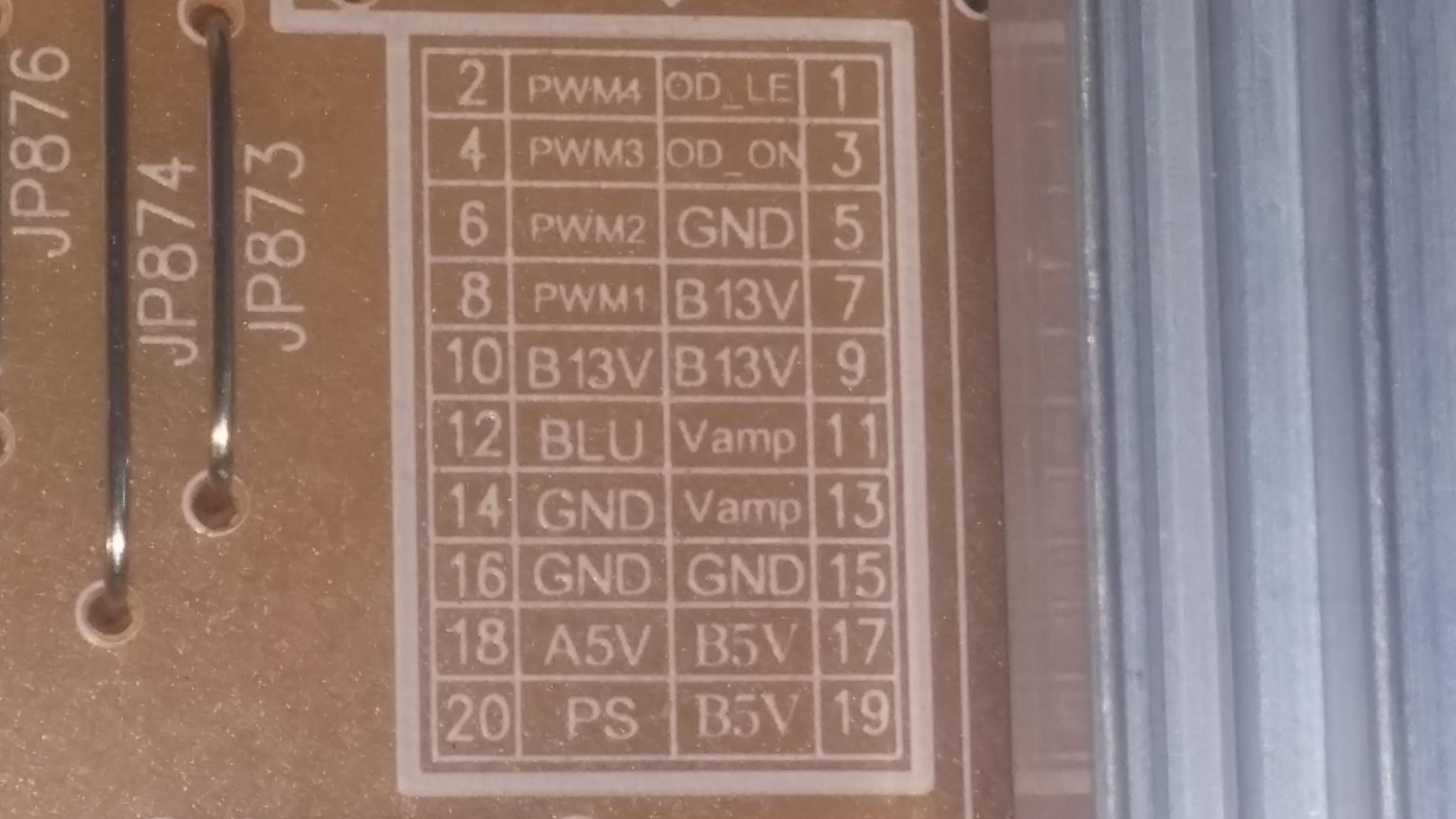

                        Hi budm, The Code is BN44-00429a
                          Re: Samsung UA60D8000 Cycling On/OFF
                          OK, shopjimmy does not have picture for the BN44-00429a, what I need is the Voltage readings on the white connector of the power supply board that goes to the main board, if you look closely you will see the chart printed on the board that tells you what each pin is for.
                          Can you take good closed up picture around that connector area so we can see what each pin is?
                          This board is not cheap.
                          • PHELLY
                            • May 2015
                            • 15
                            I took a few shots, this one seems to be the clearest
                              OK, pin 20 PS looks to be the PS-ON pin, pin 12 BLU is the BL-ON pin, and pin 18 is the Standby 5V.
                              So if the main board is not connected, then you should have steady DCV at pin 20 and pin 12, they should be >2VDC with ref to GND.
                              Then connect the main board cable back in place and check the Standby 5V, the PS PIN, and the BLU pin to see what is going up and down in sync withe on/off cycle.

                                So without the Main Board plugged in, pin 20 sits at 4.1v pin 12 at 2.9v, with the main board plugged in, stby is steady at 5v, pin 20 varies from 3.3 to 0v and blue pin varies but too quickly for my Fluke to read, drops to 0 and rises but instantly drops.

                                        'So without the Main Board plugged in, pin 20 sits at 4.1v pin 12 at 2.9v' That is what I expect due to the fact that the pull-up resistors are built-into the power supply board.
                                        'with the main board plugged in, stby is steady at 5v, pin 20 varies from 3.3 to 0v and blue pin varies but too quickly for my Fluke to read, drops to 0 and rises but instantly drops.' That means the main board is sending the command signal PS-ON is going up and down instead of steady state ON when TV is ON, this will cause the switched power supplies section to be tuning on and OFF. So you have main board problem not sending the proper PS-ON, and the Power supply/LED driver combo board that is not lighting up the backlights LED when the cable between the power supply and the main board is disconnected (it can be the LED driver circiut, the PFC not working, or bad LEDs).
