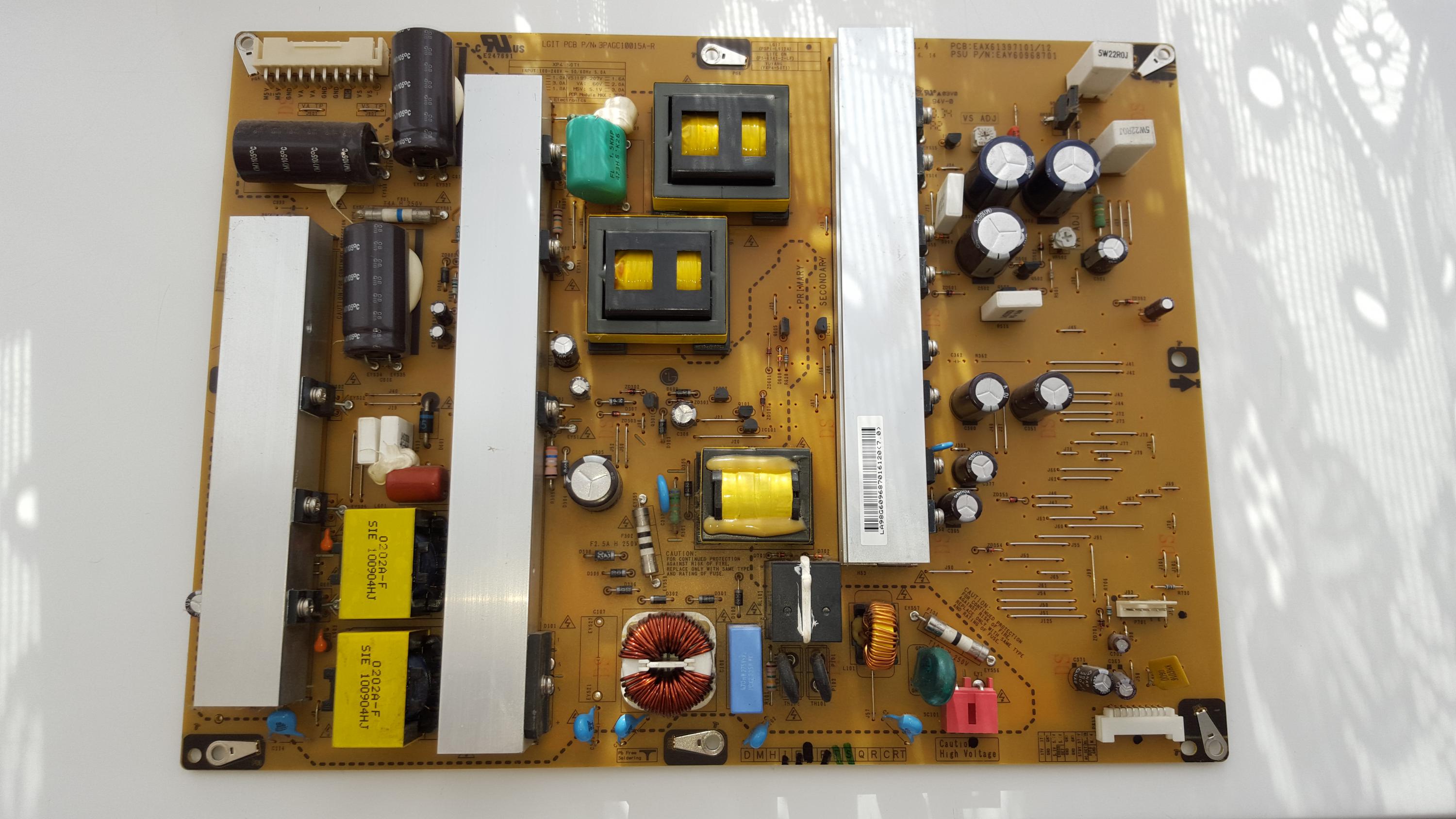

    got another tv im trying to fix with just a clicking fault i will upload more pictures soon
    i have so far tested the follwoing
    1. two 5W22 ohms resistors but they are good
    2. D304 is showing as shorted in circuit but ok when out of circuit
    3. No Vs or Va from the power supply even with the Ysus and Zsus disconnected
    any ideas how to test this part which is a common failure on these power supplys 3BR1565JF Regulator
    thanks

    Pin 5 is ground, so put black probe on pin 5 and touch the other pins with red probe.
    If any are shorted to ground then it's certainly bad.

        I had one and that Ic was failed however it never blew the fuse. Also the control circuit for that Ic is also prone to failure on these, will find the kit for that.

          Thanks Hamie its shorted
          i have ordered 3BR1565JF Regulator and a replacement diode ill change that and see how i get on
          @reecey yes i have seen in further posts that IC701 can be faulty as well but ill try this first then move on if not

                changed 3BR1565JF Regulator and a replacement diode but still the same as before clicking so maybe IC701 is faulty

                    can anyone point me into the right direction to test patterns or maybe jump the main board
                    Legend pins on Psu are as follows
                    17V 17V
                    GND GND
                    5.1V 5.1V
                    ERR_DET 5.1V
                    GND GND
                    GND GND
                    STBY STBY
                    AC_DET RL_ON
                    AUTO_GND M_ON
                      Re: LG 50PJ550 Clicking
                      What voltage do you get on RL-ON?
                        4.14 Volts

                          RL-ON to ground.
                          Vs ON to 5v stby.
                          Give that a try.

                            hi hamie do you mean jumping
                            RL-ON to ground and M-ON to 5v stby ?
                              You sure you've measured your voltages right?
                              I have a working board for this model, if the mainboard is unplugged RL-ON is 0v
                              Ac-detect, the pin opposite it, is close to the voltage you have stated you have RL-ON.
                                Sorry Hamie your right i was measuring the legend wrong with main board unplugged RL-ON is reading 0 volts but with main board plugged in then the tv clicks RL-ON is reading 3.9 volts then drops to 0 Volts

                                  ok I've jumped my board on and it's RL-ON to 5v stby.
                                  all voltages came up.
                                    jumped RL-ON to 5v no voltages came up just one click
                                      its strange because 3BR1565JF Regulator is showing as shorted again and the diode as well but i know if i remove the diode out of circuit its fine
                                        put in a new 3BR regulator and replace IC 701 also check on the back of the board there is a string of SMD resistor head to tail (in series )just by the IC about 11or 12 of them,I have had problems with these in the past, worth a look Flocko
