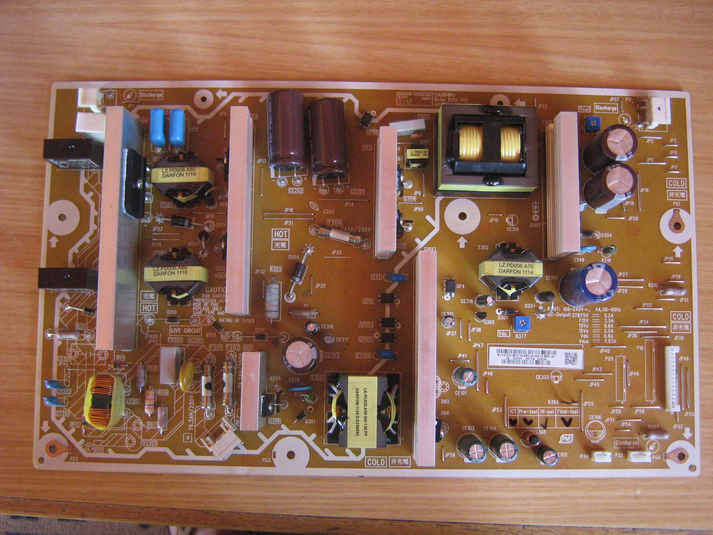

    [Posting this fault find to help others who might follow later.]
    Got this plasma from the dump/tip. Great looking TV with high quality features. Completely dead. No standby supply. Have traced the hot side standby supply through and appears to be OK but have not confirmed that it is actually oscillating. Looking on the cold side I see a SMT diode that appears to rectify the output of the standby transformer. It measures short circuit in circuit. I am about to remove it from the circuit and test out of circuit. Having difficulty reading the type number. I thought I saw LT1402 but nothing appropriate comes up on a Google search.
  • ReeceyBurger123
    Never Give Up !
    • May 2014
    • 7325
    • Britain
    Re: Panasonic TH-P42X30A no standby 5 volt

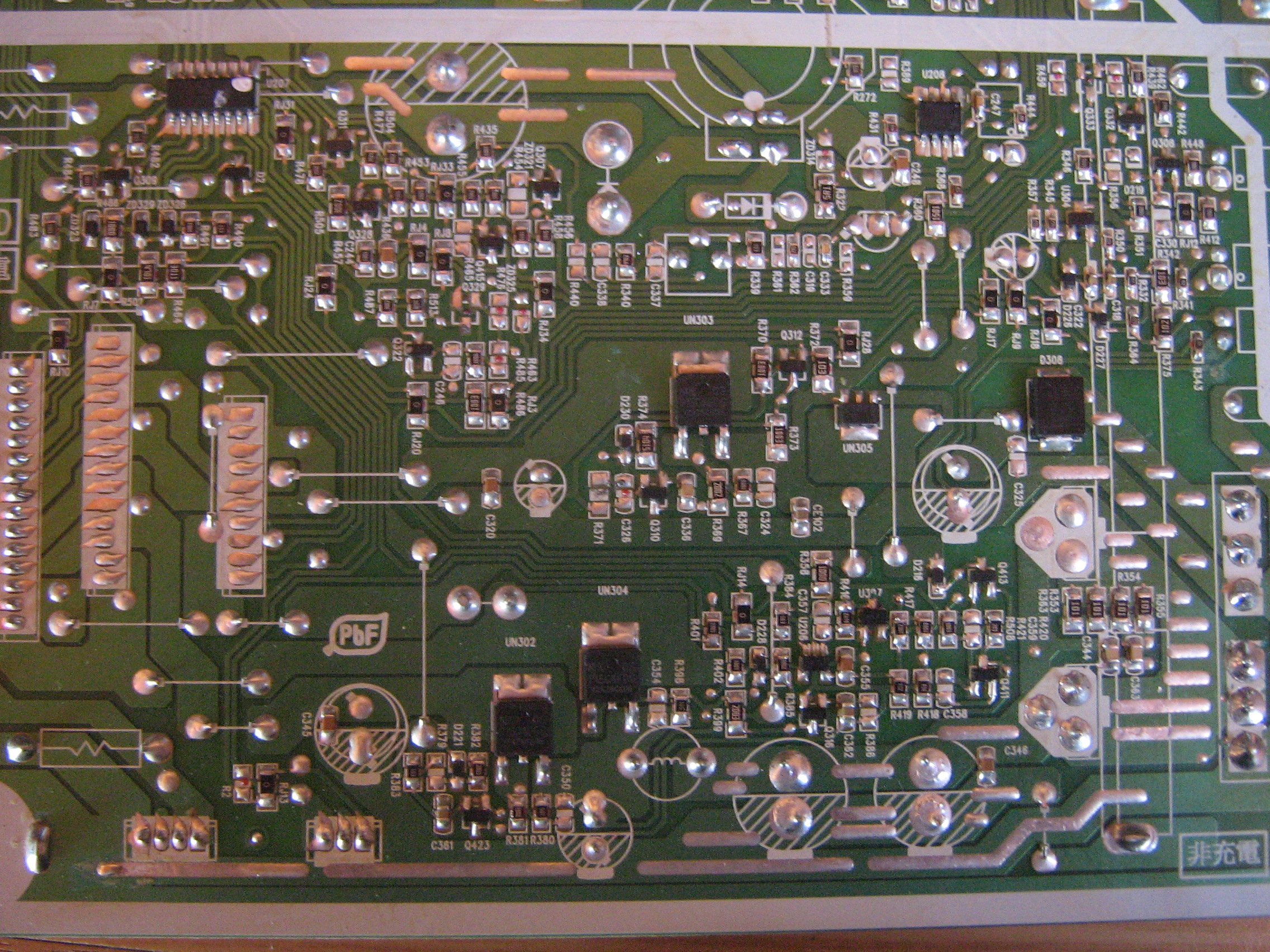

    Normally that diode is in place to protect the transformer so it probably will show S/C in circuit but fine out of circuit. Can you provide us with some pictures please ?
    • dkneyle
      • Dec 2013
      • 445
      The suspect diode is D308. You can pretty well follow the circuit by looking at the PCB tracks. The diode sits on the output of the standby transformer and half-wave rectifies the high frequency AC. The filter cap C325 does its job at the output of the diode in question. It does not appear to be a snubber diode.
