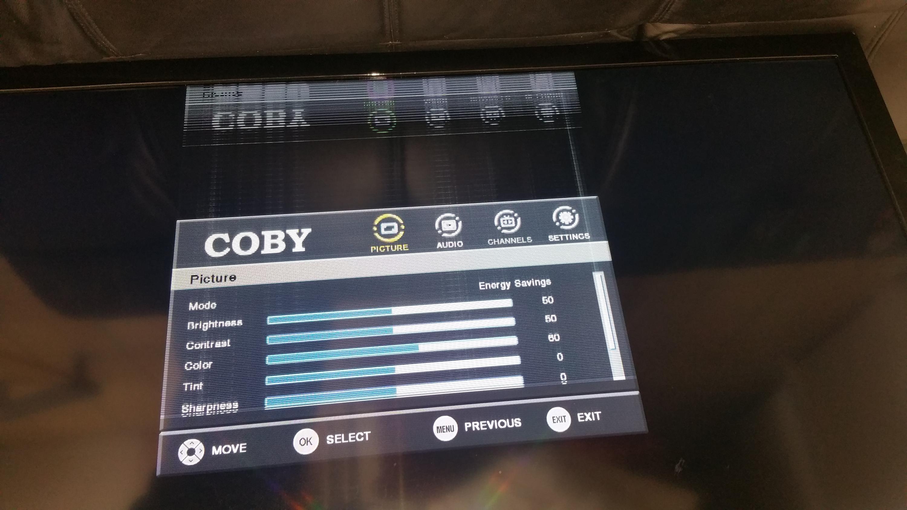

TV COBY LEDTV5536 Horizontal lines
  • alfredomfr1
    • Oct 2014
    • 318
    • usa
    Hi
    T-Con board or bad panel?
  • ReeceyBurger123
    Never Give Up !
    • May 2014
    • 7325
    • Britain
    Re: TV COBY LEDTV5536 Horizontal lines
    I would say panel.
    • alfredomfr1
      • Oct 2014
      • 318
      • usa
      How do I test a t-con board, because if the panel is bad the tv is garbage
      • ReeceyBurger123
        Never Give Up !
        • May 2014
        • 7325
        • Britain
        A Tcon wont cause that failure all it does is decode the Lvds signals, so its either your Mainboard or more than likely Lcd panel.
