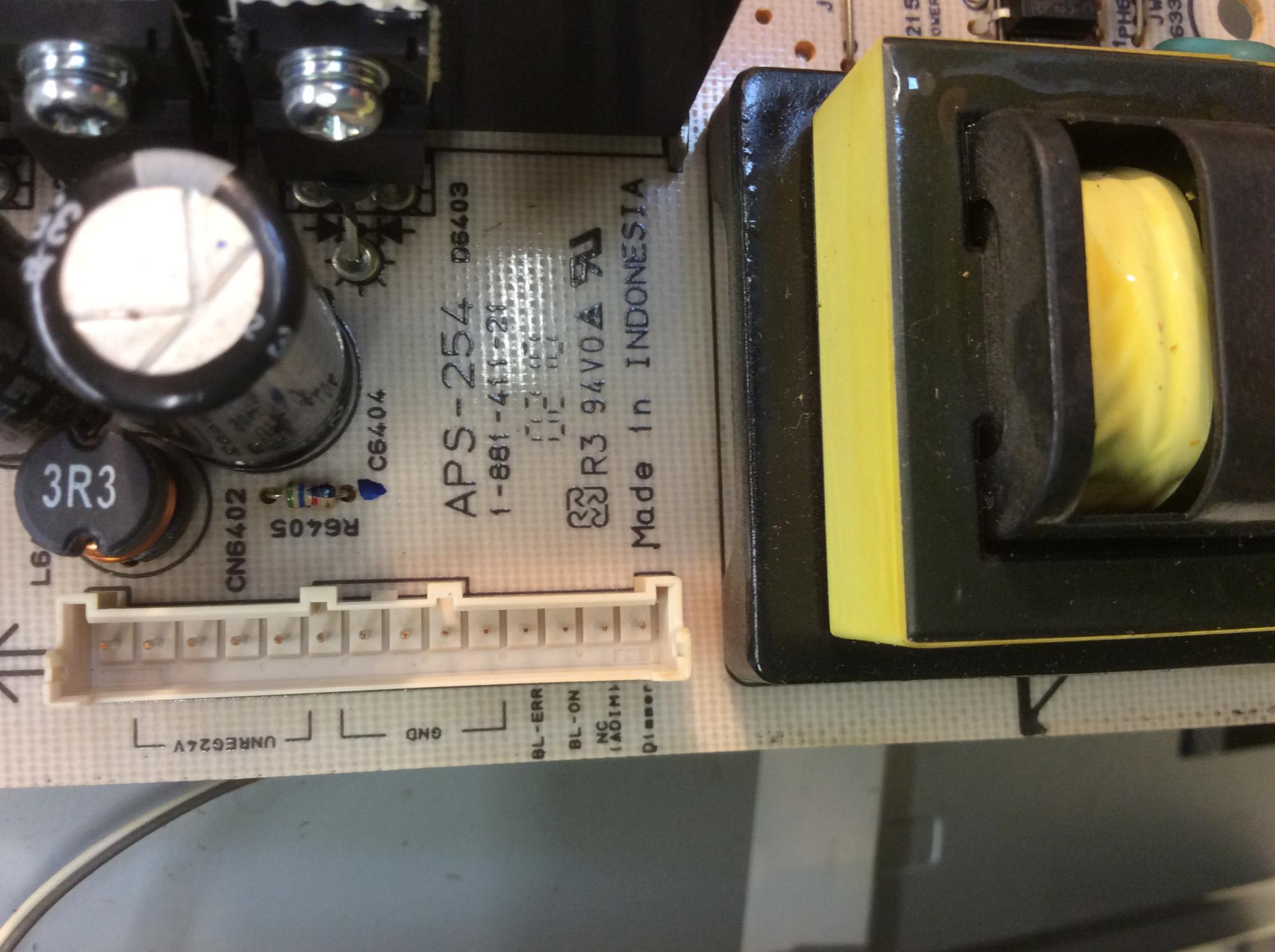

    I have a Sony Bravia KDL-40EX403 with a switch-on/off problem. It started by rapidly and eratically switching the picture on & off, then the whole TV on & off & on etc.
    In it's current state it is an intermittent fault as follows:-
    From cold & switched off: At switch on sometimes the picture and audio start up normally but only for about 20 seconds. After which either the ‘standby' or ‘on' light come on or both are off. Either way there is no picture or sound. Sometimes the ‘power on' button will bring the ‘standby' light on and then the ‘on' light, but never any picture or sound.
    I have no circuit diagrams so quite lost what to check. All I've managed to do is confirm that the 12 volt power disappears from the connector (CN6403) at the top of the PSU board. The PSU board is identified as APS-254, G2HE, 4-168-556-21 on the label (1-881-411-21 on the board!).
    The Main board (BAL) is 1-881-636-21.
    Help!!
    Re: Sony Bravia KDL-40EX403 switch-on/off problem
    I would check the DCV of the Standby Voltages and the PS-ON signals to see if they are stable or cycling up and down. Check and reseat the cables and board mounting screws.
      Thanks for quick response. I have tried the connector reseats & mounting screws, but no change. TV won't go off at the moment - Sod's law - It's been in the garage all night and it's cold in there. I don't know if that's masking a overheating problem.
      However I'm having difficulty finding relevant voltage monitoring points on the board (only have the board markings to go off and can't see any 5V markings). Can I use the chassis for the return or do I have to find the associated return?
        When making measurement in the secondary side (cold side) you can use chassis for the meter Black probe.
        How about up loading the good clear pictures of the power supply board, and the closed up pictures of the connectors so we can see the pin labels?

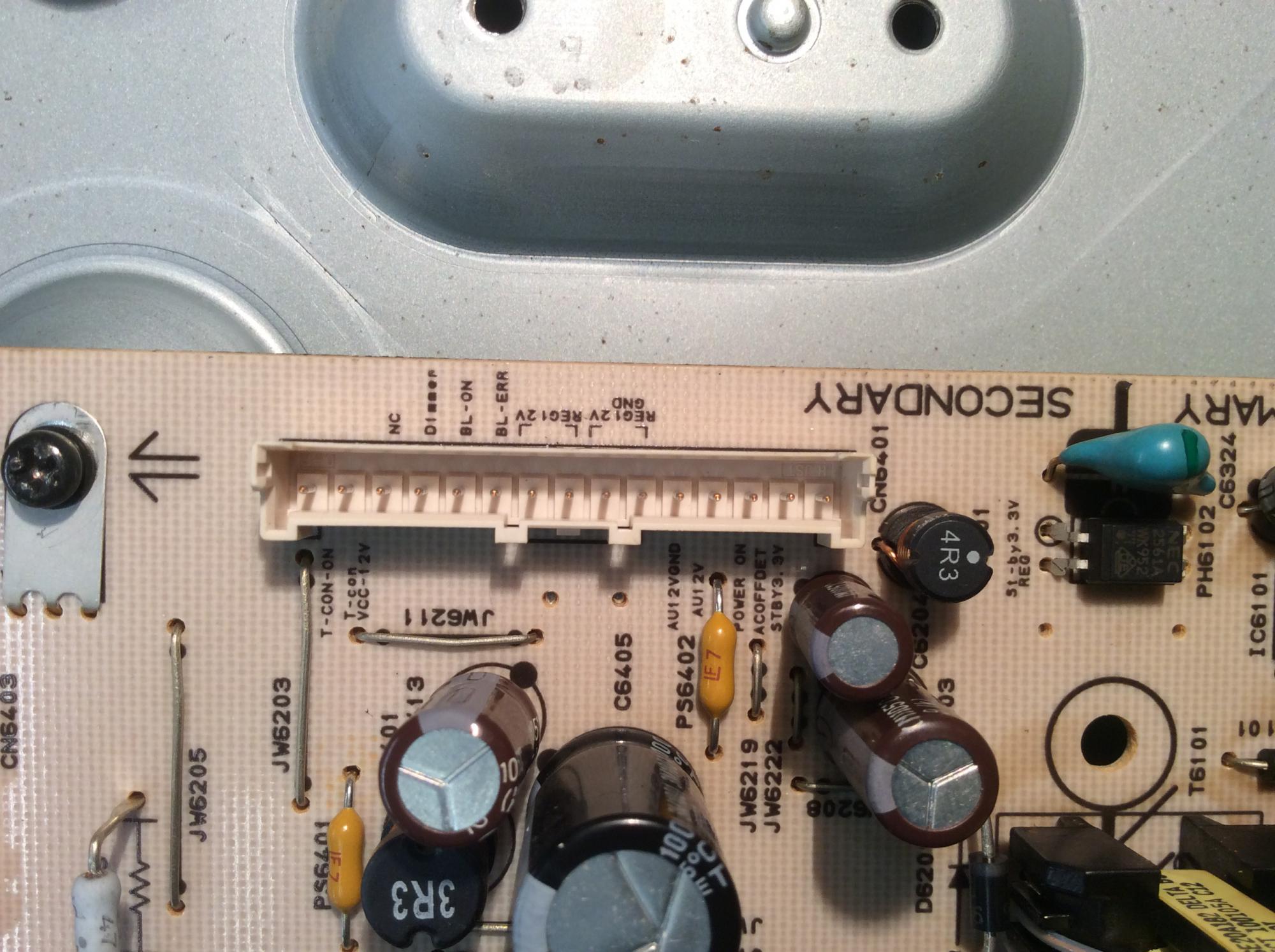

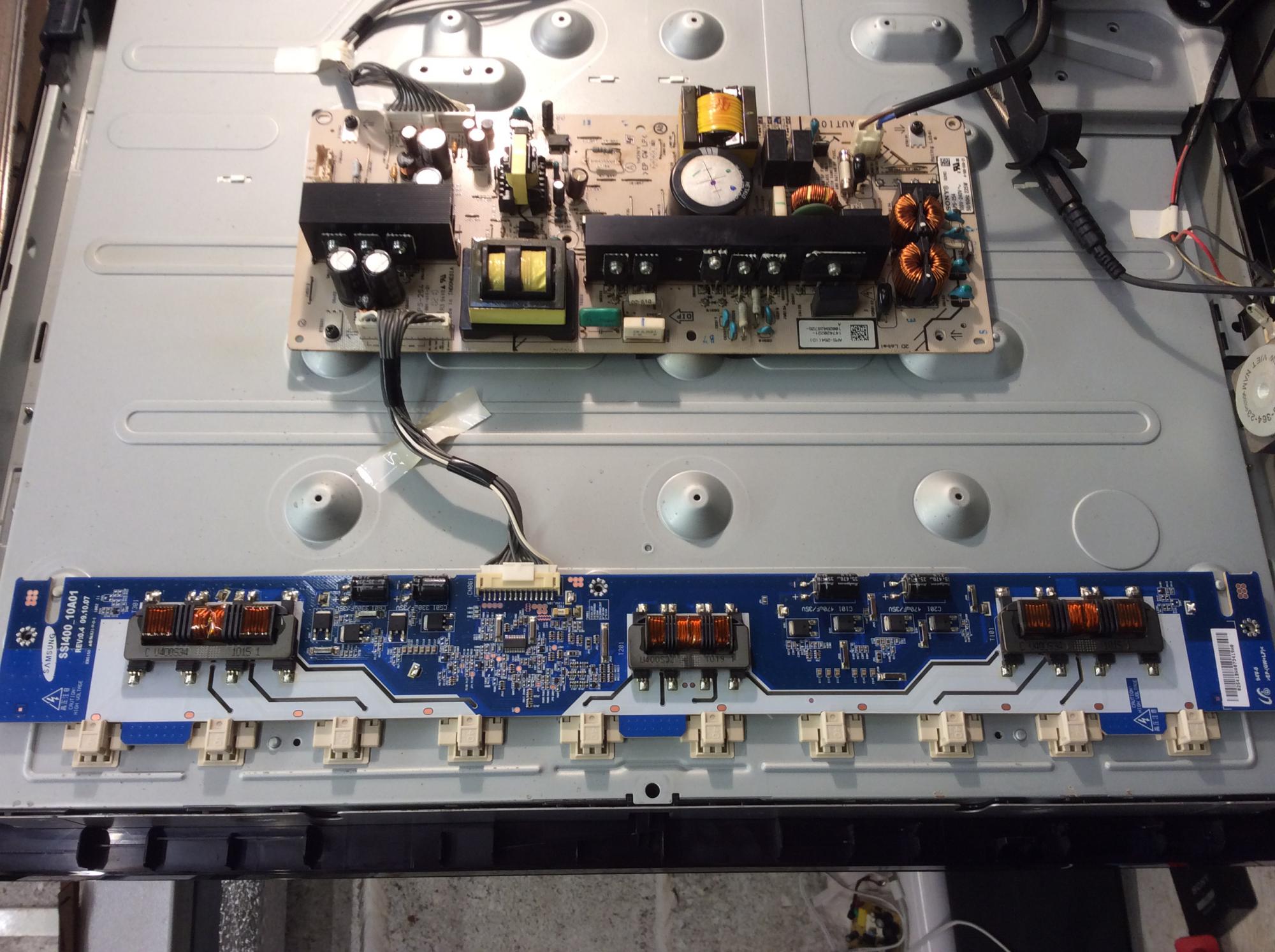

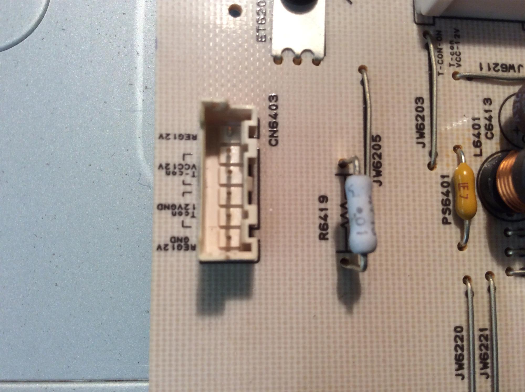

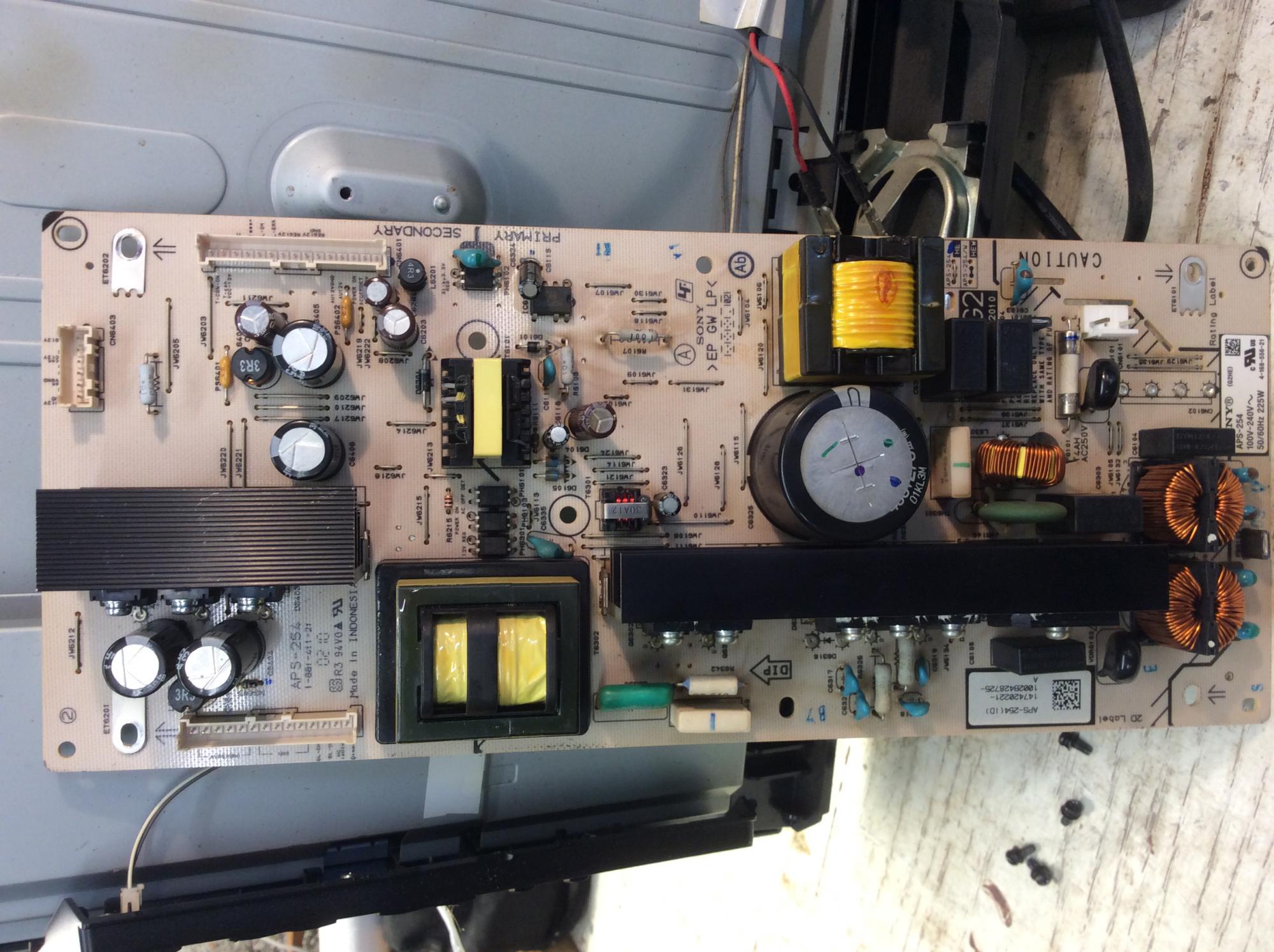

          OK. A few photos, general and connector close ups.
          (Can't seem to attach more than one file at once, so here's the first one)
            The second.
              The third.
                The fourth.
                  The fifth & last
