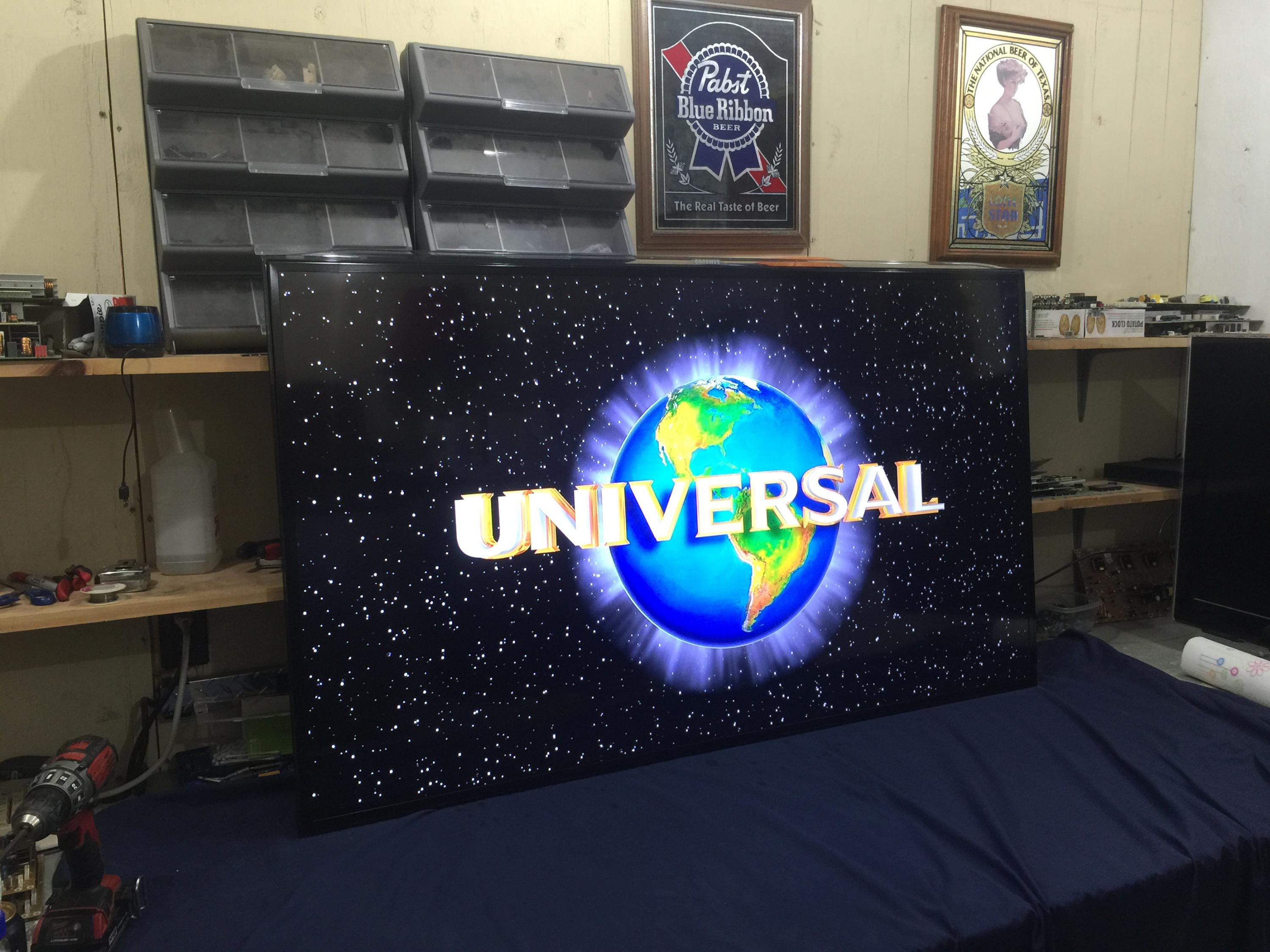

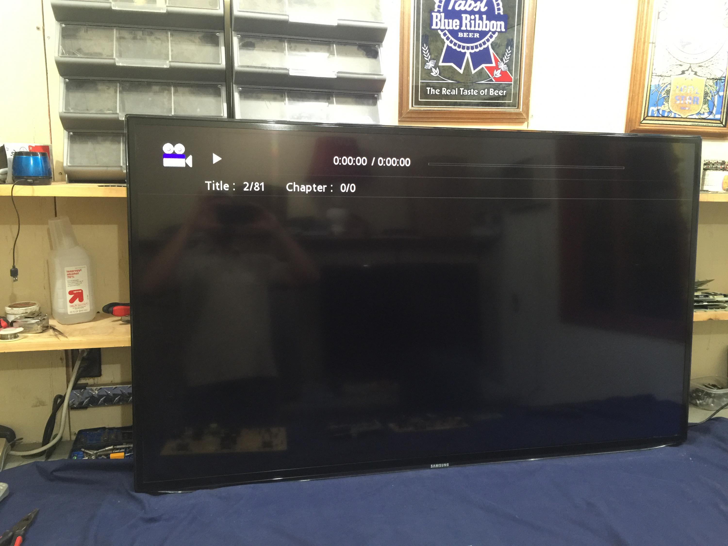

                Re: UN40EH5300 Service Menu / Any Way to Rotate the Image?
                Here's a couple pictures. First is upside down (you can see the Samsung logo at the top). 2nd is after changing the screen setting.
