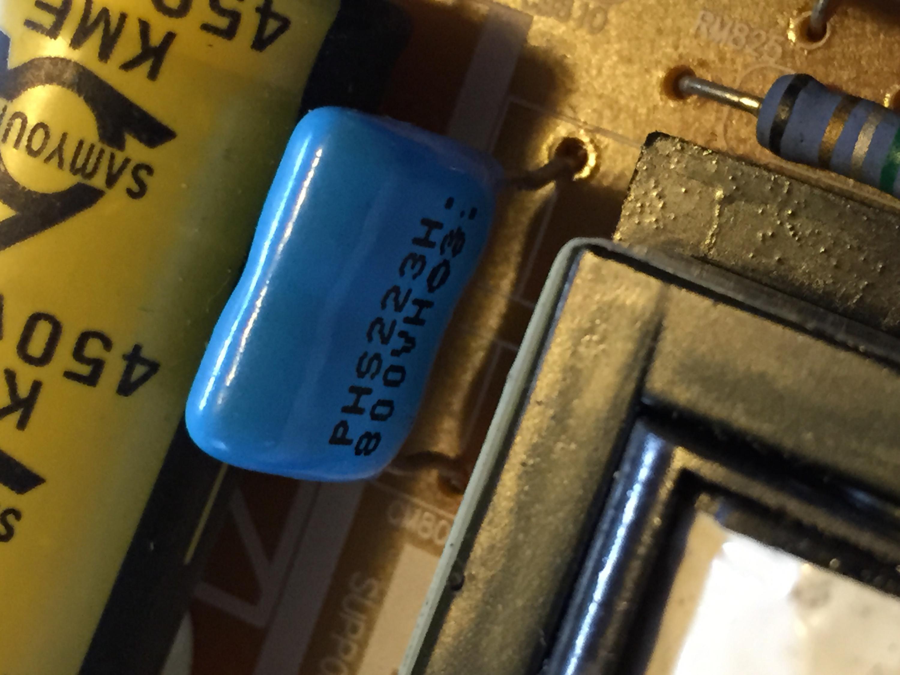

Ignorant question of the day. Can I use a .022uf 800V cap in place of .018uf 630V?

    I found a Samsung LN32C450E1D today. It had the same symptoms as the set in this post.
    https://www.badcaps.net/forum/showth...ht=Ln32c450%2A
    In that post, budm helped the OP find a capacitor to work in place of the original cap, a .018uf 630 "high pulse" cap.
    I found a 223H (.022uf) 800V cap on another board that I had in my cabinet. The set turns on now. Can I just use this cap instead of ordering the one bud suggested from Digi-Key?

      If the feedback signal level is generate based on the Xc of the cap then it may not work, it depends on the circuit design. That is >20% higher than the original.
      That cap probably has one end connected to circuit ground and another end is connected to the winding of the transformer for half-bridge drive setup and the feedback is taken from the top side of the cap. Are you working on the same board bn44-00338B? If it is then you are OK, the cap is on the high side of the circuit.

        That pretty much went over my head, but I think I caught the point. I'll order the replacement cap.
        Thanks Bud.

          I updated my reply.
            Re: Ignorant question of the day. Can I use a .022uf 800V cap in place of .018uf 630V
            Yes, same board. That is cool. Thanks again, Bud.
