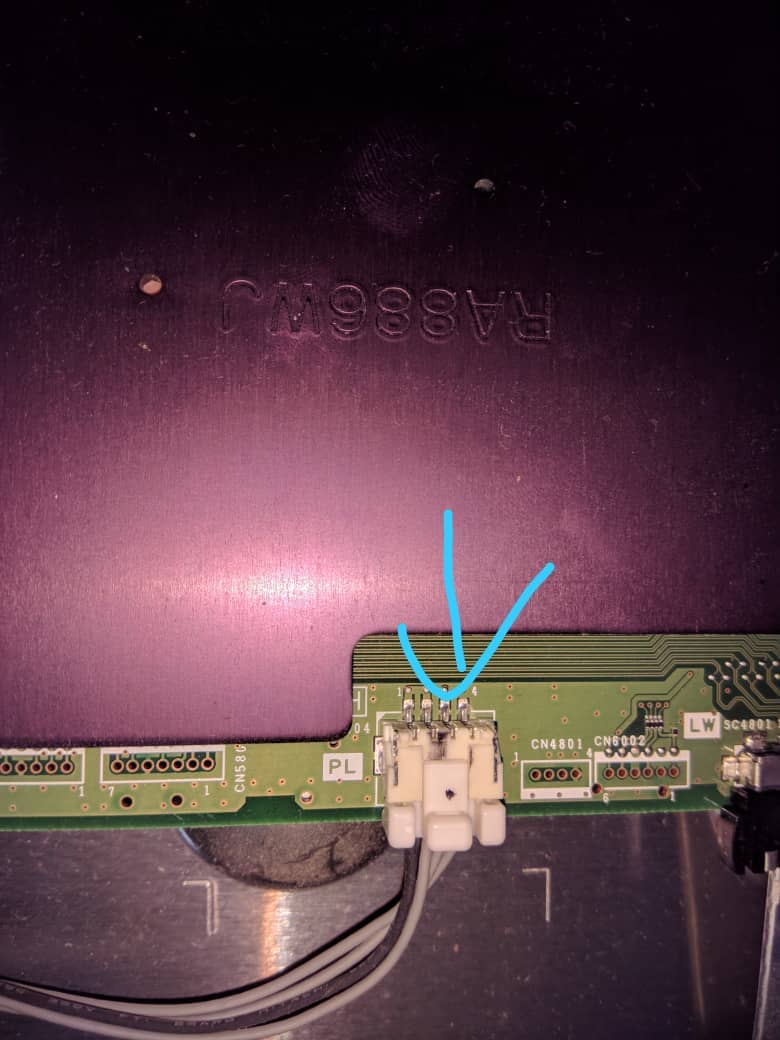

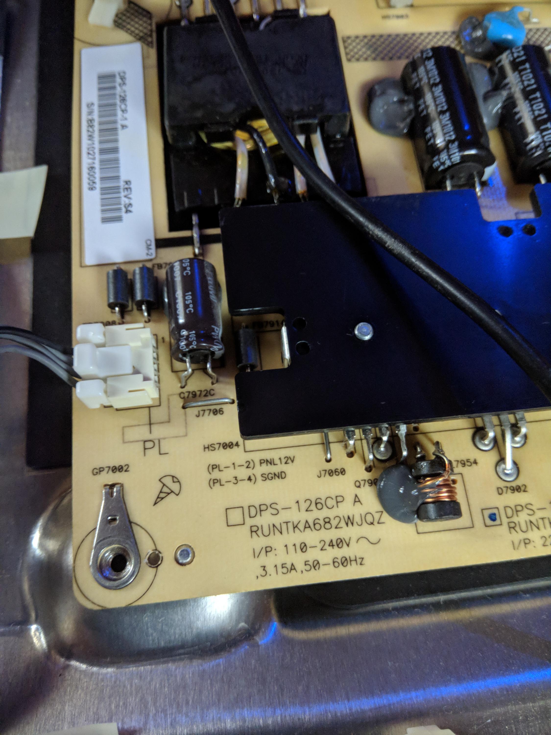

    Since you do have 3.25V PNL-POW control signal, so do you get 12V at the PNL-12V connector pin?
    Finally I was able to located PNL-12V. I got 2 volts when I Power on the TV and it immediately drop to 0

        The 13,2V output supply rail is regulated by the fixed linear regulator KIA378R12PI (Q7909) that outputs 12v normally, with an enable pin, as the d.sheet says the eanble pin (Vc) activates output when is >=2v, mine is 3v from the PNL_POW signal so i think the KIA doesn't work well.

          'KIA378R12PI' That is the common failure Switched 12V LDO regulator IC.

              Damn! Some sad doubts comes... I have supplied externally 12v to the tcon leaving the PSU tcon supply connector disconnected, before i switch on the tv i switch on the ext. PSU, the voltage falls to the same 7V, when i switch on the tv suddenly tcon voltage become 12v but after some secs tv goes in protection with the same 2 flashes and tcon voltage falls to the 7V. I have done researches on tcon, none of the power semicon tests in short with tester current in, also tested one internal mosfet of a pmic. I'm sad...

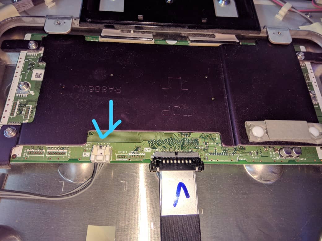

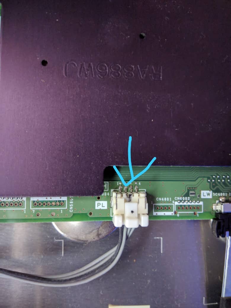

                I noticed something today, if 8 removed the tcon connector pin power from psu board I get 12volts on PNL pin 1 & 2 2 which immediately drops to 0.but when I connected the tcon I get 2 volts on pnl pin 1 & 2 and drop as usual. By the way the I think there might be some problems with the tcon cuz I see some black mark on the tcon Pl female comector. Here is ten attach pics

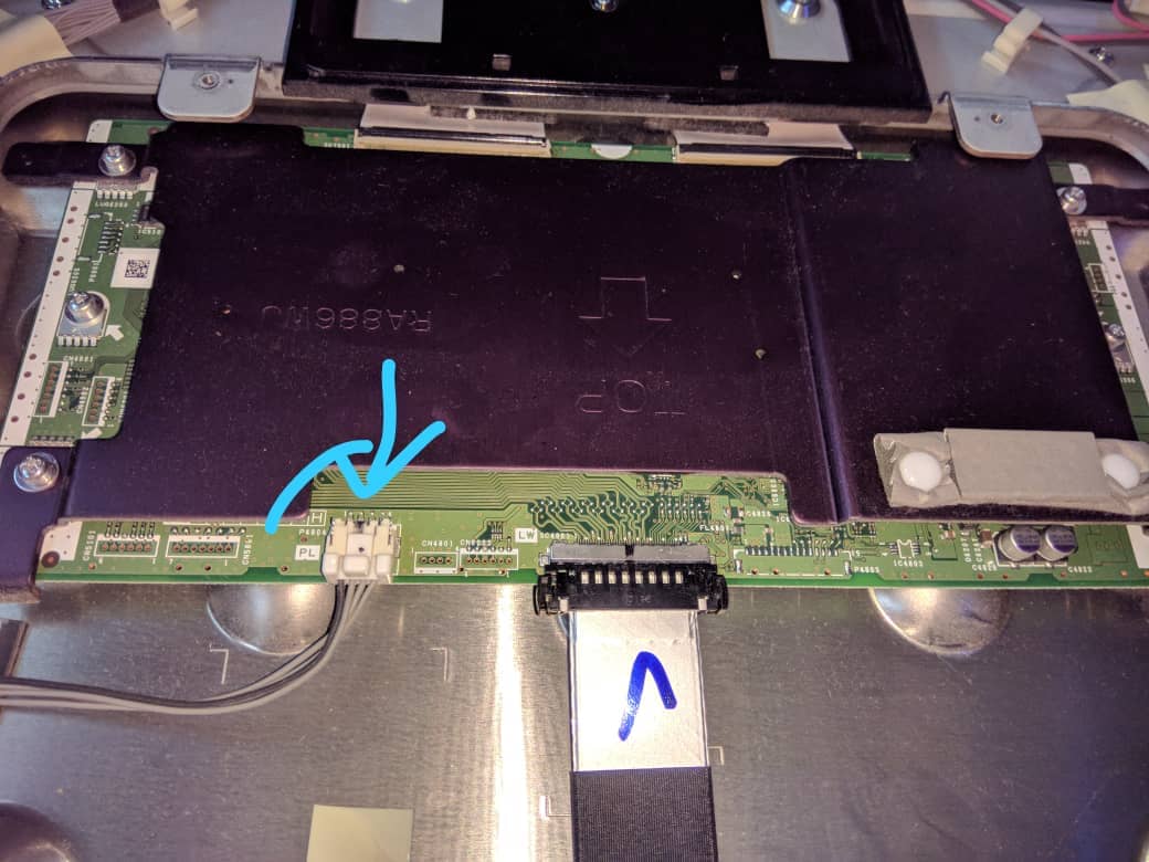

                  Too much pictures from me, e-ehm... that seems only a pencil mark..
                    Hehehe just wants to make sure that I ruled everything out

                          Disconnect the PL connector on the T-CON board then put the on the PNL12V pin on the power supply board then turn on the TV to see if the output will jump up to 12V or not, if not then more likely to be bad KIA.

                            I indeed get 12v when I disconnected the Pl connector. But only 2v flows in when I connected back the Pl. So that means my KIA378R12PI is OK right? What do u suspect the problem is

                              You have to put a resistor or a 12v Lamp as load to the PL output so you can judge better if KIA is good or not. If it stays on then the tcon has problems.

                                OK, next test will be with dummy load, you can simulate 1A load by using 12 Ohms 10W resistor to see if it can handle 1A load or not.
                                If you are going to use the lamp, you need to check its cold resistance first since cold resistance will be about 15 times lower than the hot resistance.
