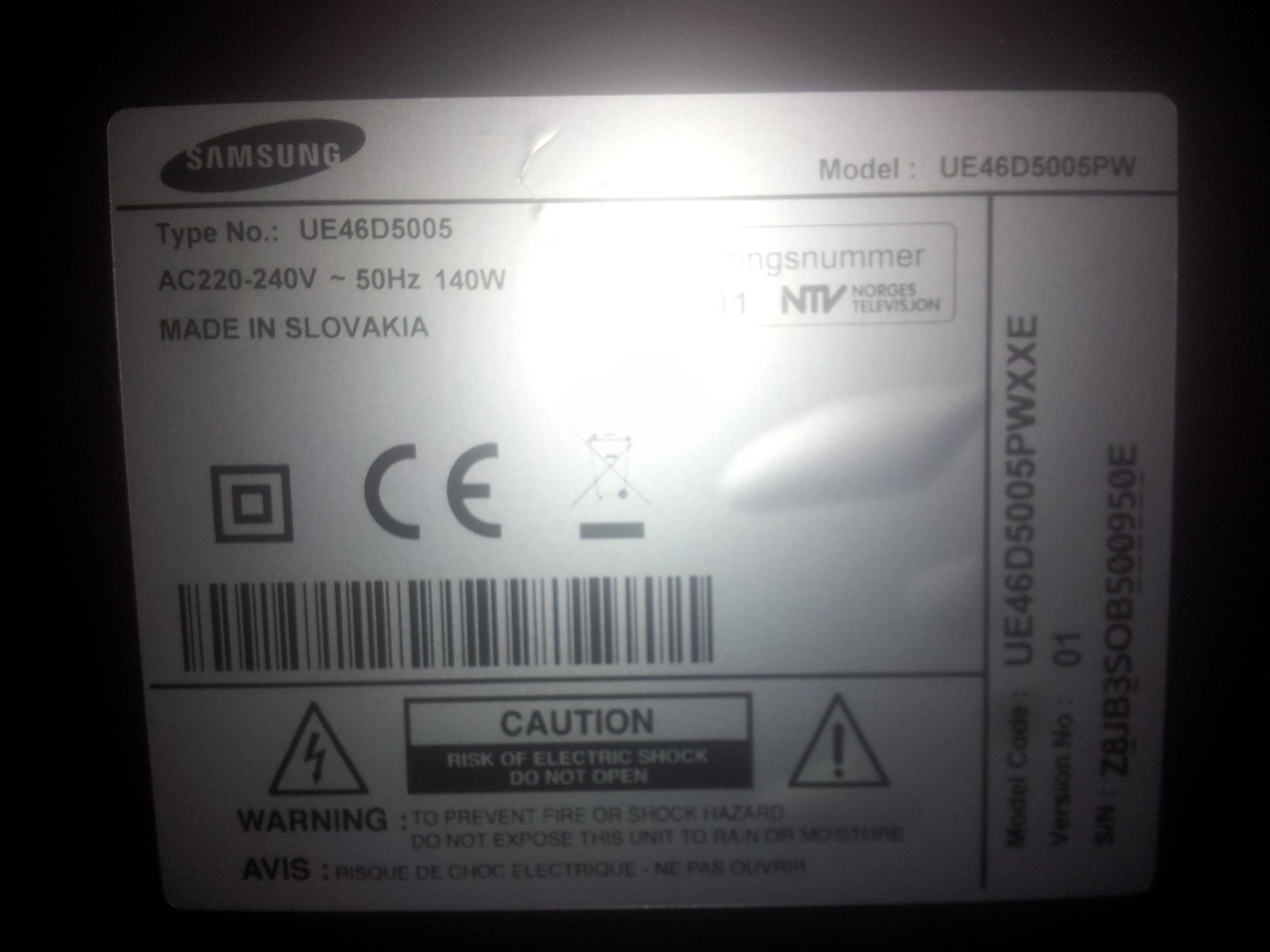

    Greetings, when I tried to power on my tv the other morning all I got was a flashing standby led.
    The TV is a Samsung UE46D5005 that I've had since it was new in 2011.

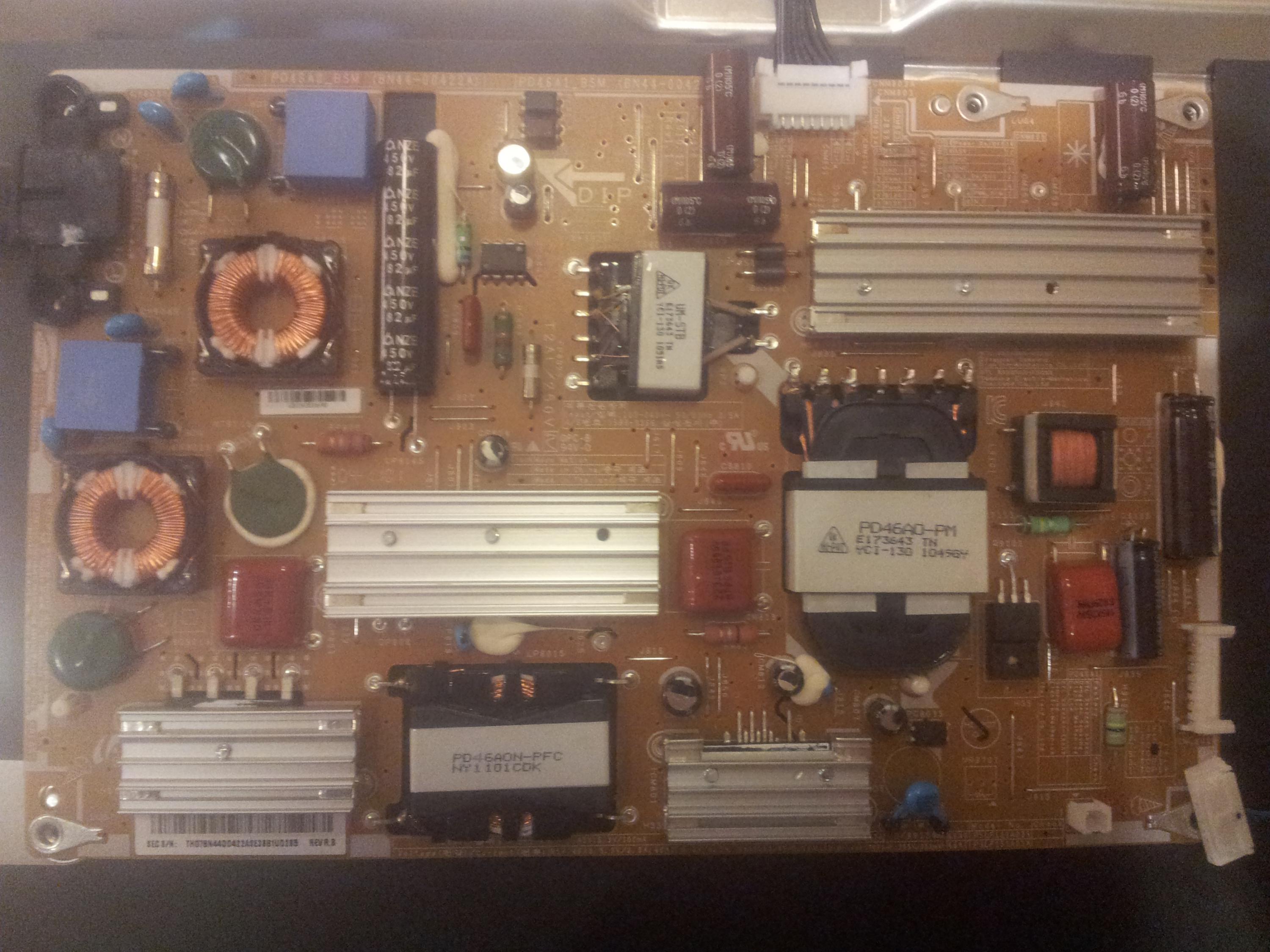

    Power supply is a BN44-00422A

    After visual inspection all electrolytic caps seems fine. No sign of damage on power supply or motherboard. 3 of the caps showed 0 farad on my DMM out of circuit so I swapped two them for same size and voltage rubicon ones, the 3rd which initially was a 25V 390uF I swapped with a 25V 560uF.
    The two fuses I've located passed continuity check.
    The big 87uF 450V cap shows 320V steady regardless if mainboard and/or led strips are connected or not.

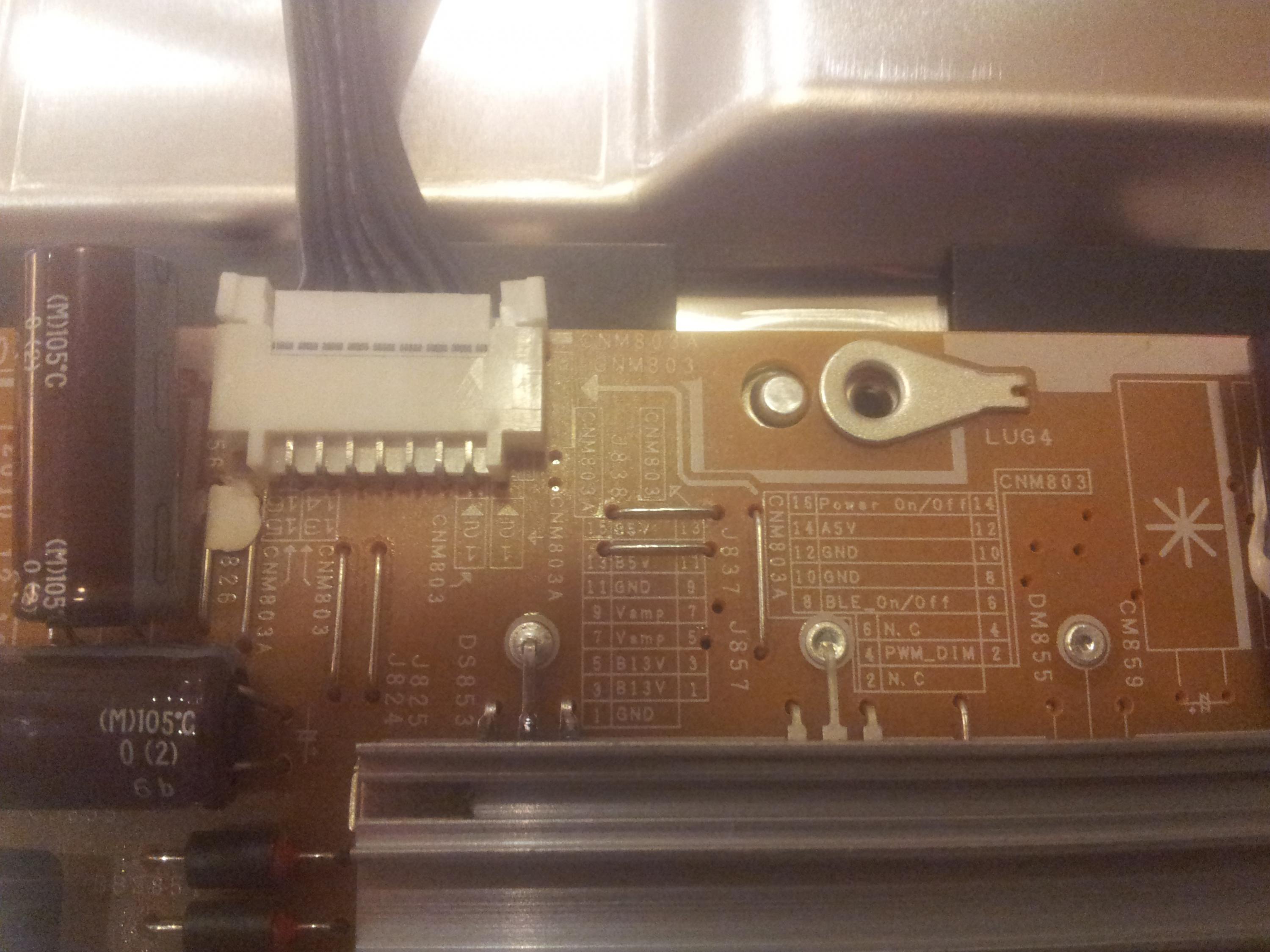

    When mainboard is disconnected and AC plugged in pin 14(PS_ON) measure 3.3V, pin 12(A5V) measure 5.4V. All other pins 0V.
    When mainboard is connected pin 14(PS_ON) goes to 0V, pin12(A5V) remains at 5.4V. All other pins are still 0V.
    Strange to me is that several of the caps in the area close to backlight connector shows 0V as if that part of the board never gets turned on. The 200V 68uF, 25V 560uf (upper right) and 25V 390 uF(upper center next to mainboard connector) are the ones showing 0V.

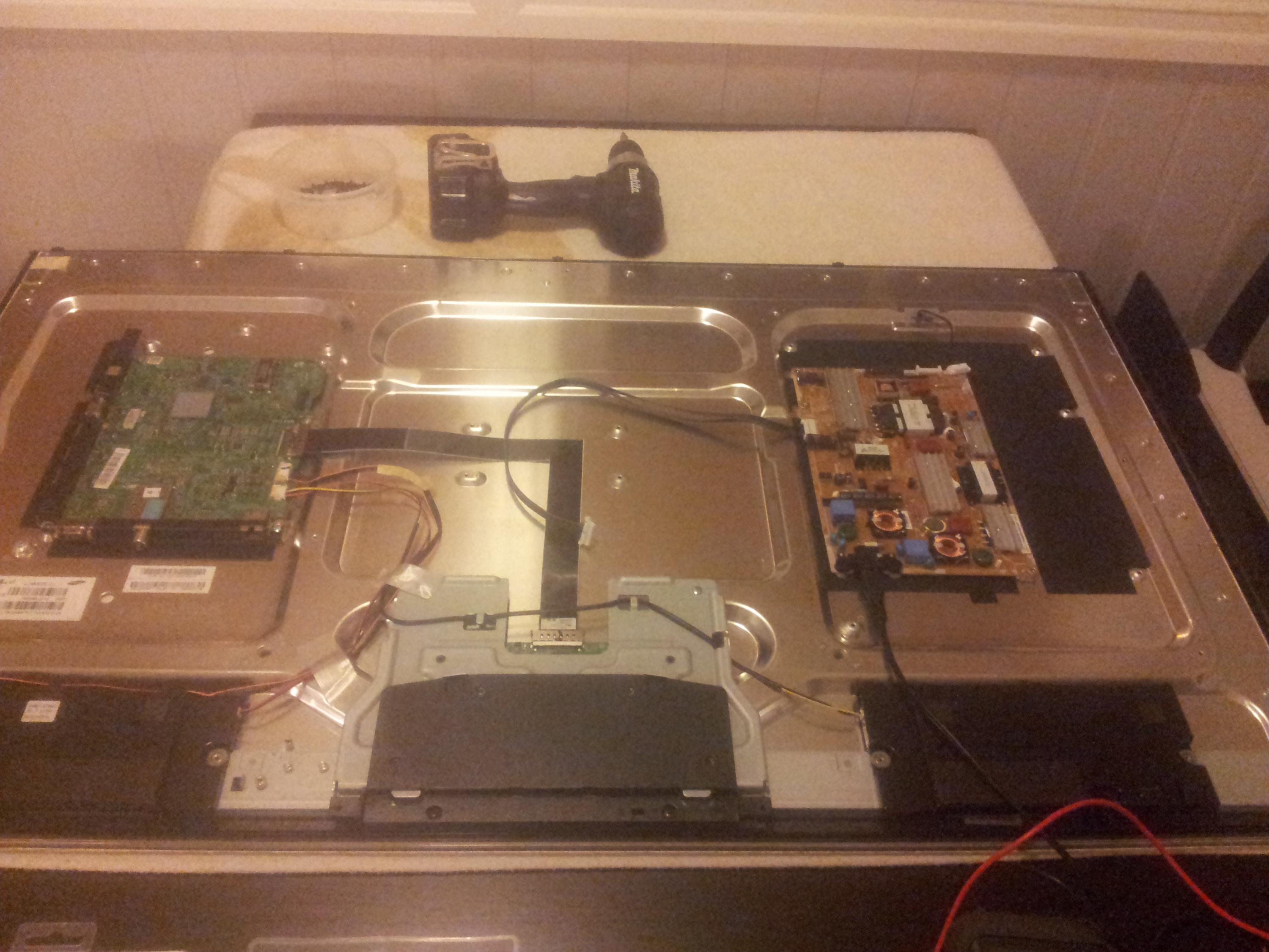

    Things I've tried after reading a lot on the forum:
    - Soft reset with remote. No change.
    - Unplug mainboard then connecting AC plug. No change. No backlight.
    - Unplug backlight. No change.
    - Hard reset by shorting EEPROM. No change.
    - Tried measuring the wires going to the led strip, result is in the million Ohm range, however I don't know how useful this measurement is or how to interpret it.
    - I attempted to access the LED strips for continuity check today but for some reason none of my phillips heads were a good match for the screws so I left it alone before I started stripping heads.
    So... what to do? How to rule out the good components and trace down the culprit? Thanks for reading my post.

          Is the PFC voltage booster in a package or comprised of several components on the board? How can I troubleshoot it?
            Re: Samsung UE46D5005 2x5 red blink, no picture
            It is a circuit consisting of IC, MOSFETS, DIODES, Inductor, caps, ETC.

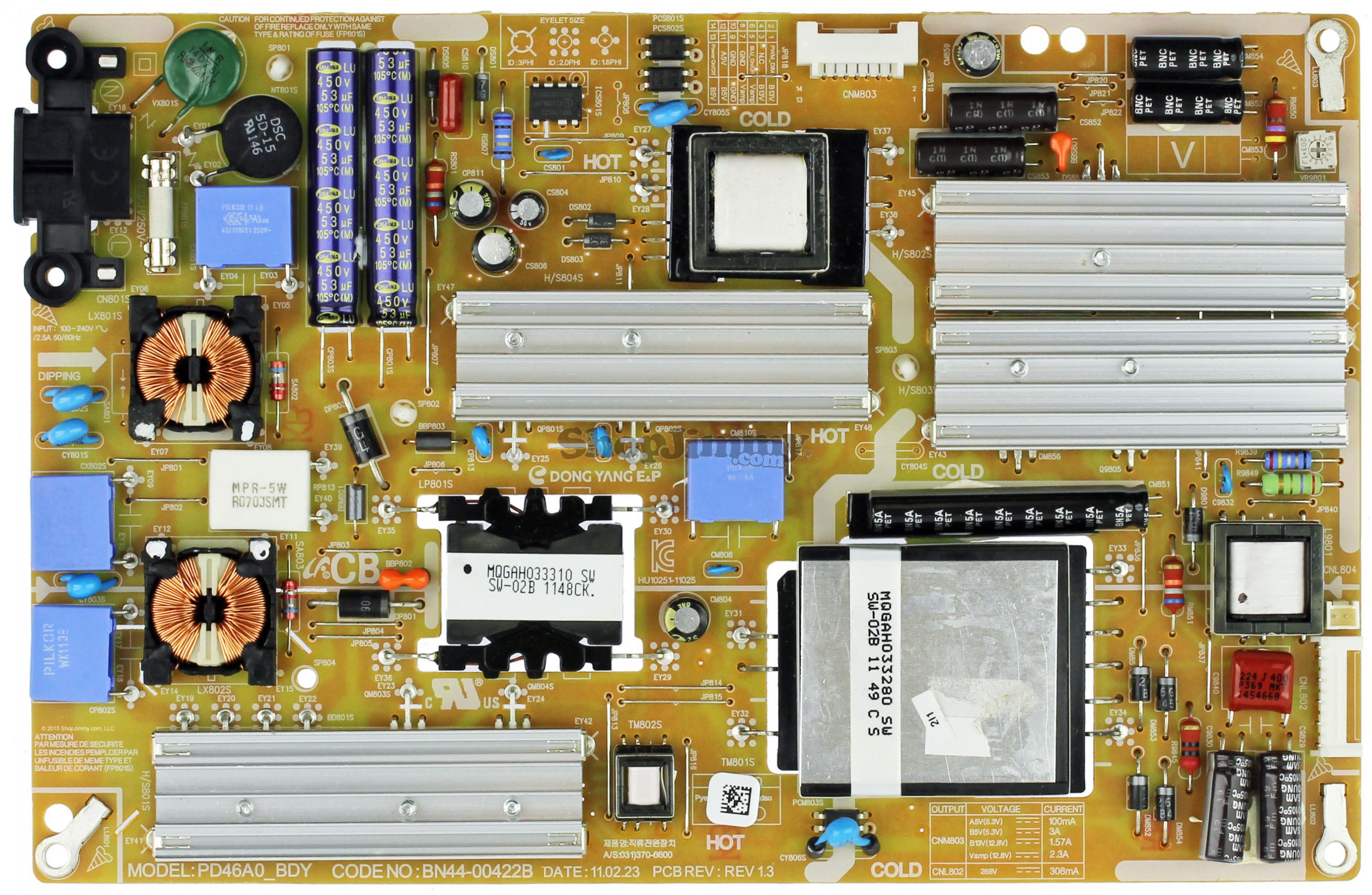

            We will need REALLY GOOD CLEAR pictures of the power supply board, both top and the bottom side to trace out the connections.
            The pictures you upload are cloudy/foggy looking.

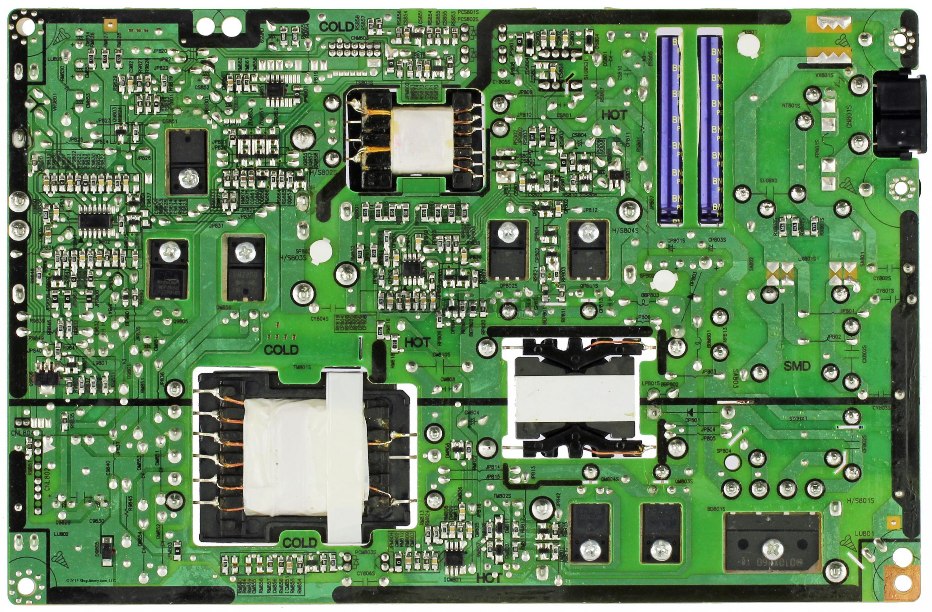

                  It has to be this kind of quality, for example, this is the pictures of BN44-00422B from shopjimmy. The layout is not the same as the 'A' version so I cannot use it for tracing..

                            I think you are doing something not right. The standby voltage is always there, but the other voltages just start when a PSON and a BLon signal from the main board is applied to the PSU. Next thing is that if the PFC isn't working (roughly 400vdc) on the main cap, you won't get all power rails up either.
                            To check the backlight, you have to verify that the PSU is getting a PSON and a BLon signal from the main board. Then measure the power on the connector. You may have to use your meter on min/max because the power might ramp up and down too fast for your meter. You have to do that for each led strip.

                                        I am looking to buy a new power supply board for my TV in this thread. The current psu is labeled BN44-00422A. Are there other models that will be compatible with my TV as well?
                                        Would for instance this board work? Even though it looks a little different.
                                        BN44-00422B SAMSUNG Power Supply
                                        https://www.ebay.com/itm/NEW-BN44-00...4AAOSwo8hTouWU
