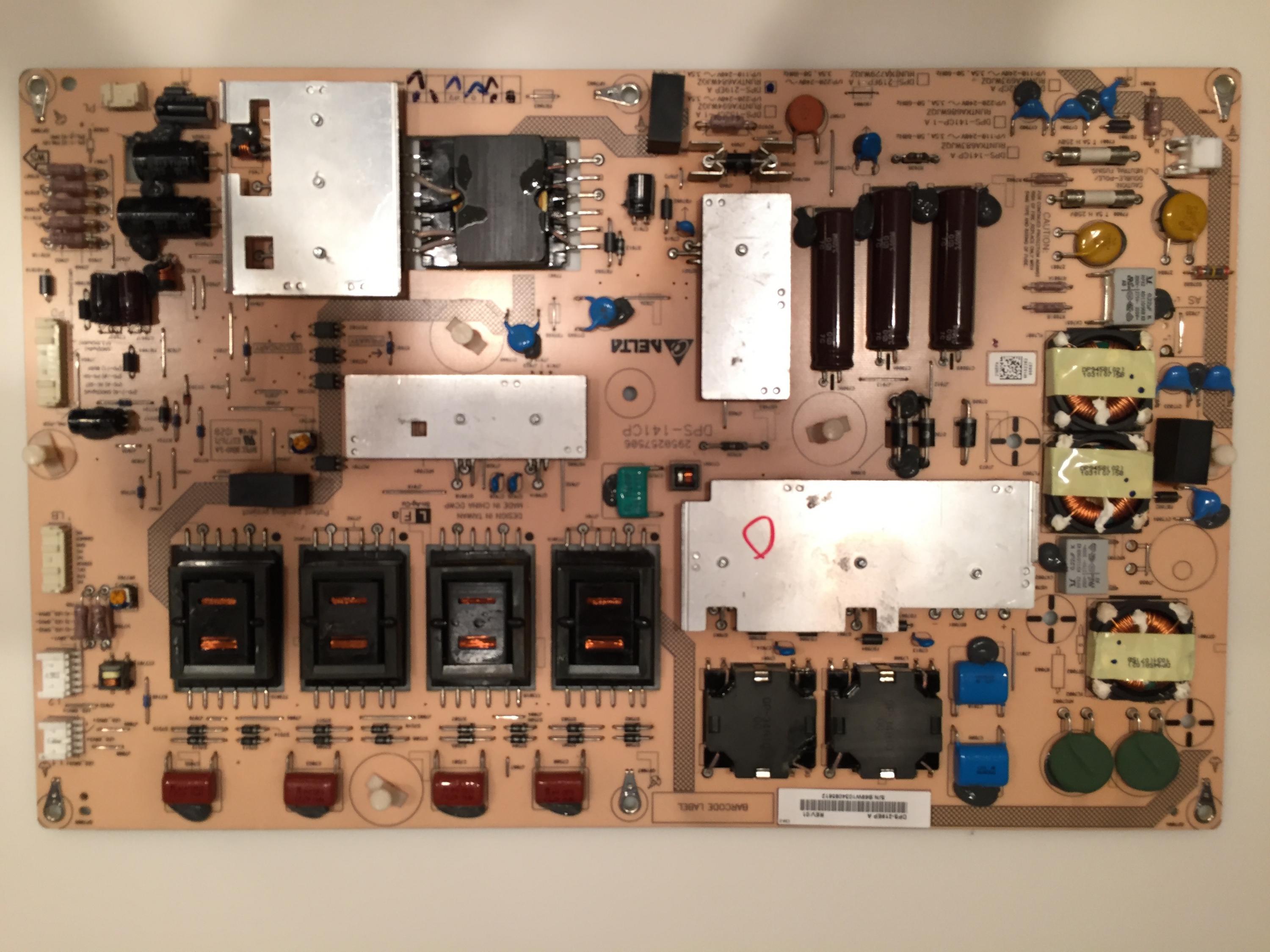

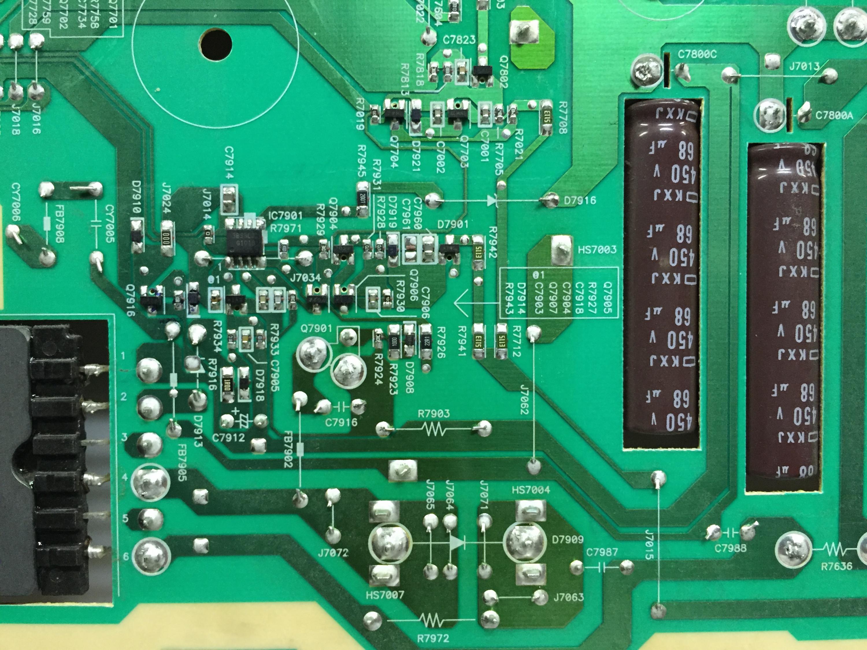

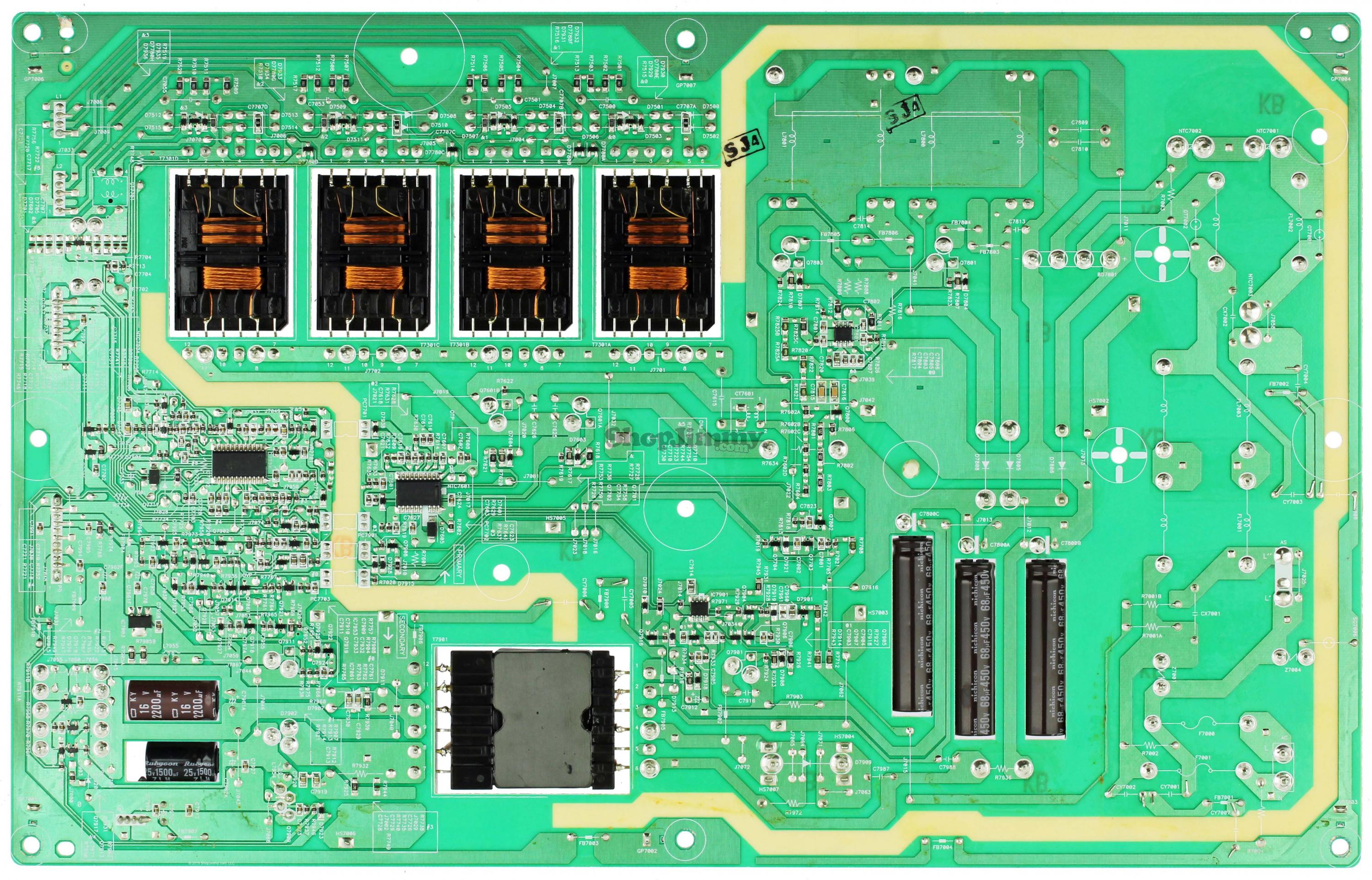

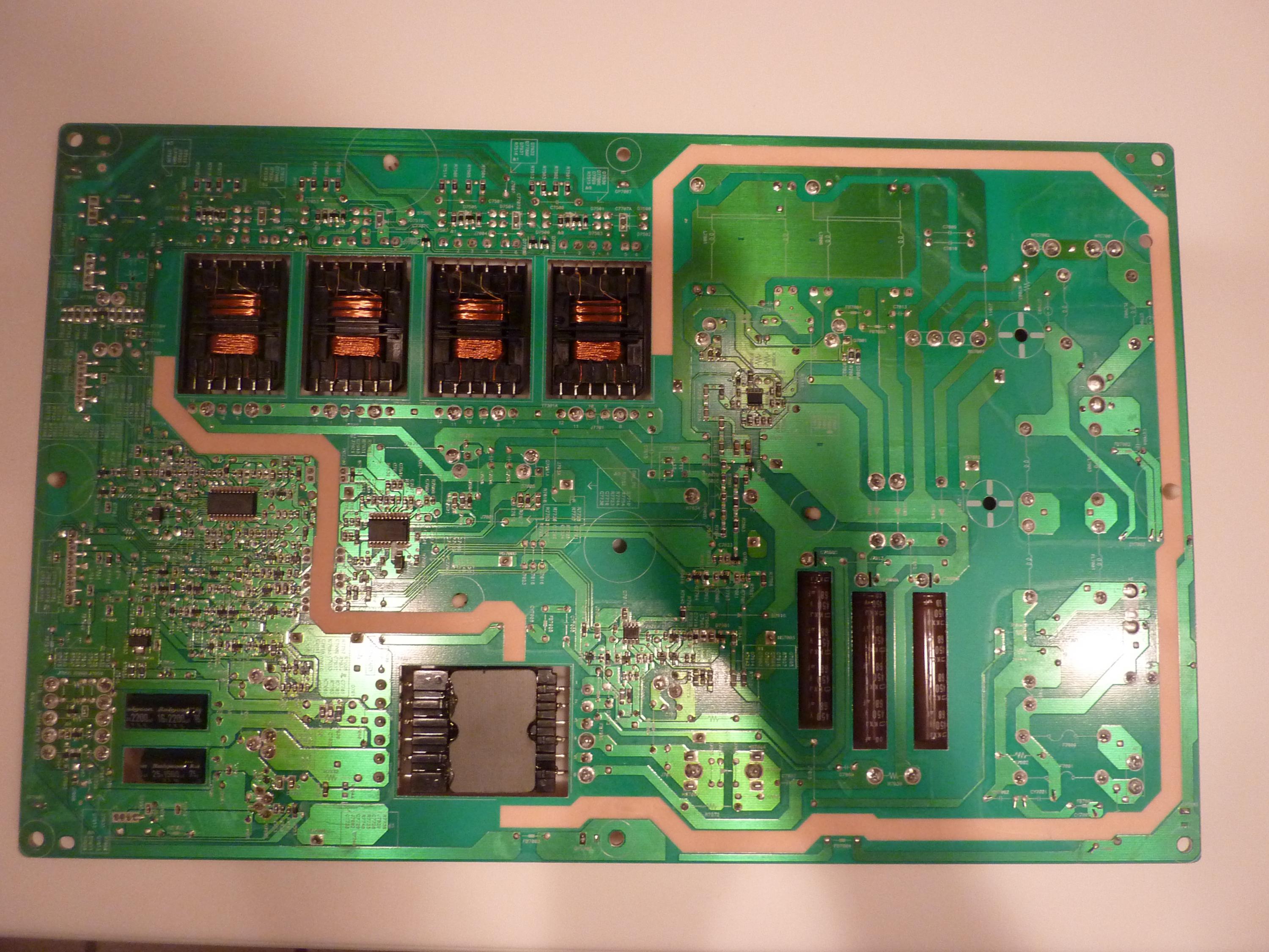

    Hello. I have a dead TV with at least a power supply problem. I have 5v standby, but when I force the power supply on, I don't get all the output voltages. In particular, I get 0v on the 12v PL connector or PNL-PWR signal. The PFC boost is not working--voltage on the main caps stays around 160v.
    I don't know much about how to troubleshoot the PFC IC and related components. As shown better in the third photo, R7903 reads 0.7ohms in-circuit, so I am thinking it's shorted. I am not sure what the resistor value is supposed to be because it's located under a heatsink for Q7901 and I can't see it. It appears to be connected to the gate of Q7901, which itself doesn't seem shorted. No idea about IC7901. Is it likely only the resistor is bad? Thanks for taking a look--I appreciate the help.
    Re: Sharp lc-60le810un power supply
    R7903 should be <1 Ohms, that is the resistor for the Source pin of POWER MOSFET Q7901.
    How did you go about forcing on the power power supply? Which two pins did you use?
    PNL-PWR is the command receiving pin which needs >2.5VDC to force on the SWITCHED 12V LDO for the output 12V-PNL pin.

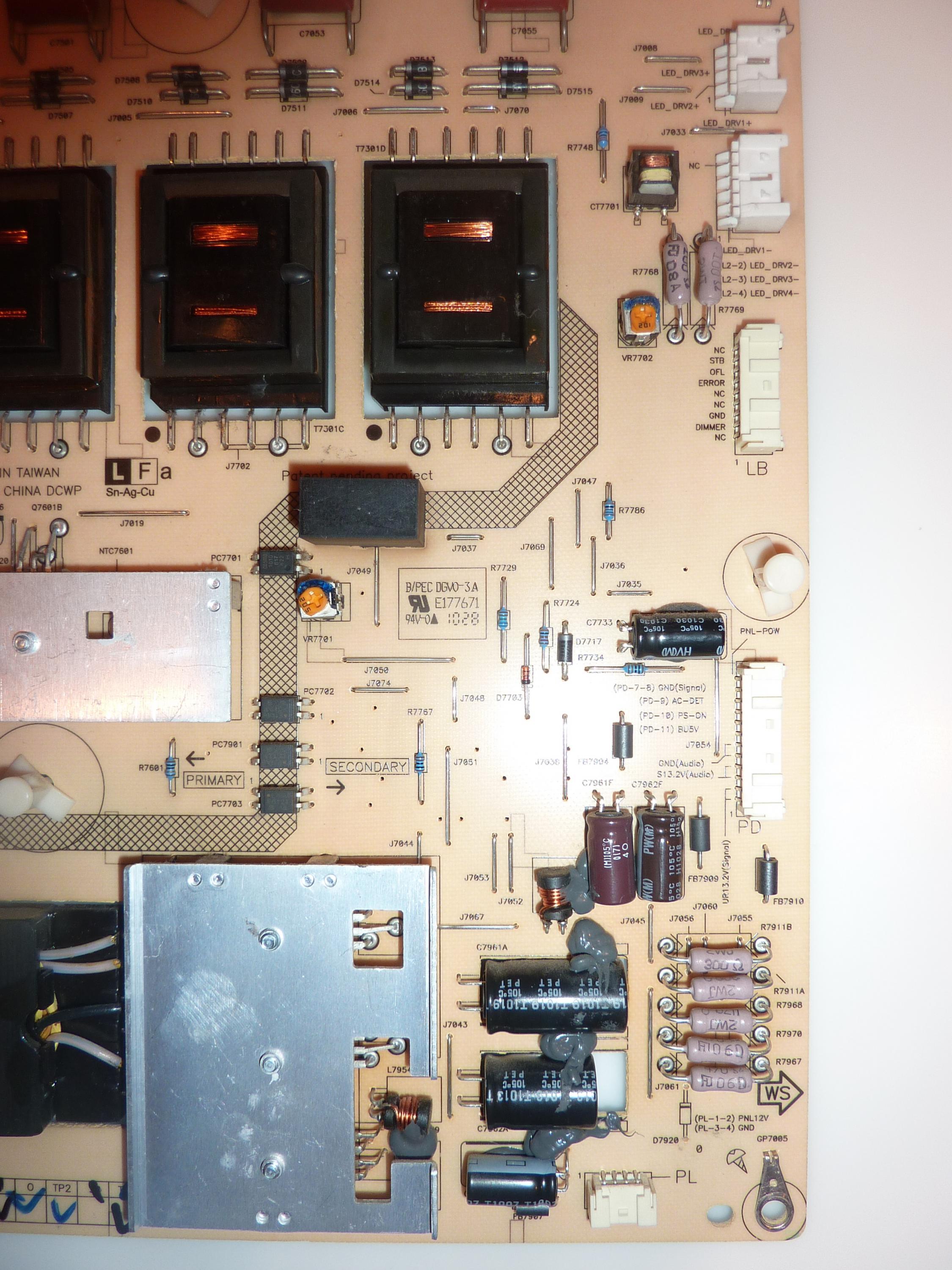

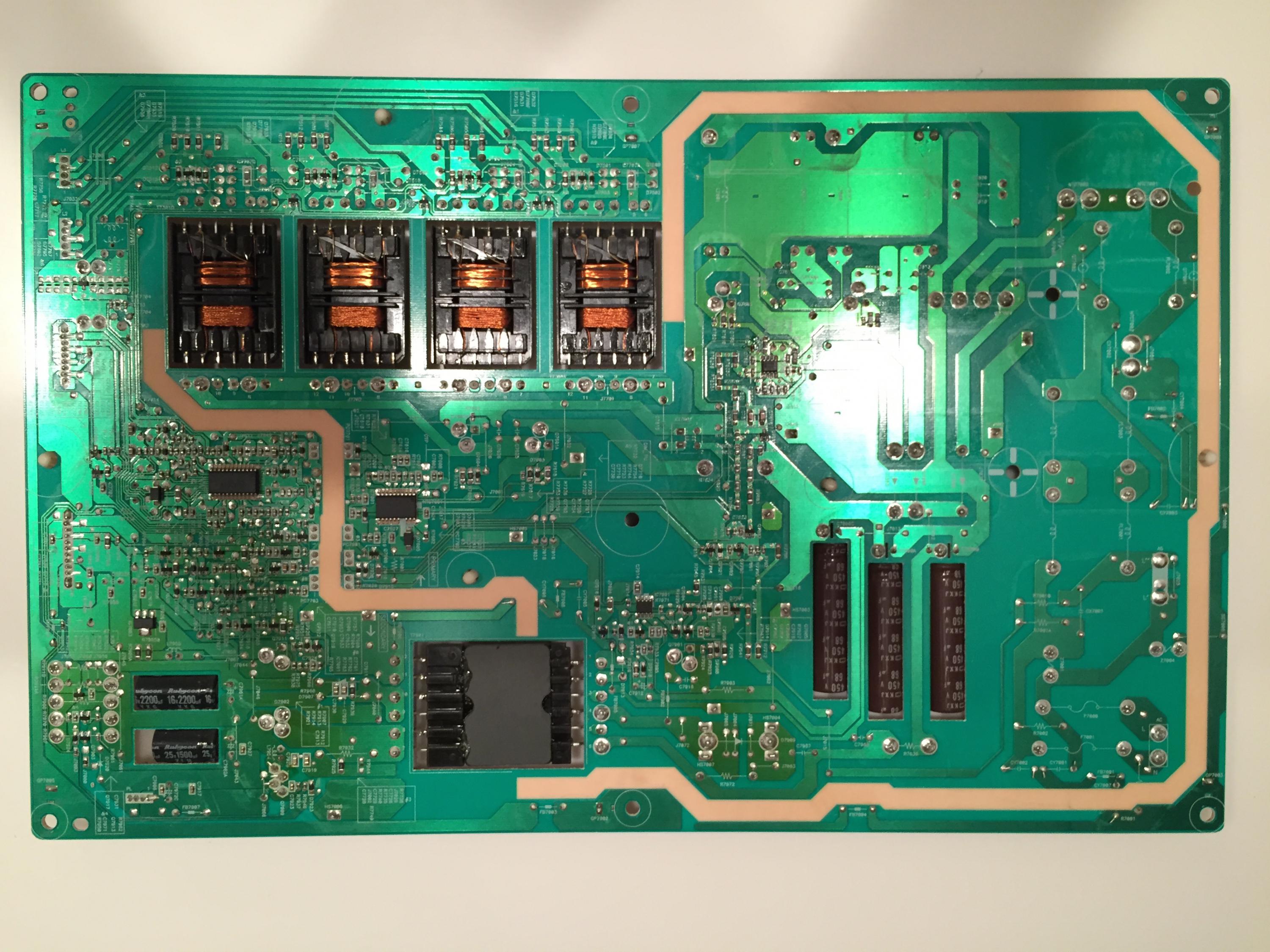

    I need much better pictures of the whole top side and the bottom side, and then the closed up pictures of the connectors that clearly show the pin names of each pin.
    I cannot read the model number of the board as printed on the barcode sticker, I can see DPS-????????
      To switch it on, I was connecting BU5V to PS-ON. When I did this, the 13.2v lines turned on, but the main caps didn't boost to 400v. What do I do with PNL-POW? Short that to 5v?
      Hopefully the new photos are better. There are several posts here about LED strip problems with this model, so that could be the real problem here. But the set appears dead so far, so maybe the power supply is the problem. The barcode reads "DPS-219EP A"
        "What do I do with PNL-POW? Short that to 5v" You use 330~1K 1/4W resistor between BU5V and PNL-POW to turn on the switched LDO IC Q7909.
        I ALWAYS use resistors for forcing on the circuits. So you need to have PS-ON and PNL-POW force on signals to get the 12V at the PL connector.
        But you still have problem with the PFC Voltage booster, you need to check Diodes D7805, 7806, and 7808.
        Need to also check and see if the PFC Controller IC is getting the VCC to run. Can you get the P.N as printed on top of the IC?
        The LED driver circuit needs that boosted Voltage to run.

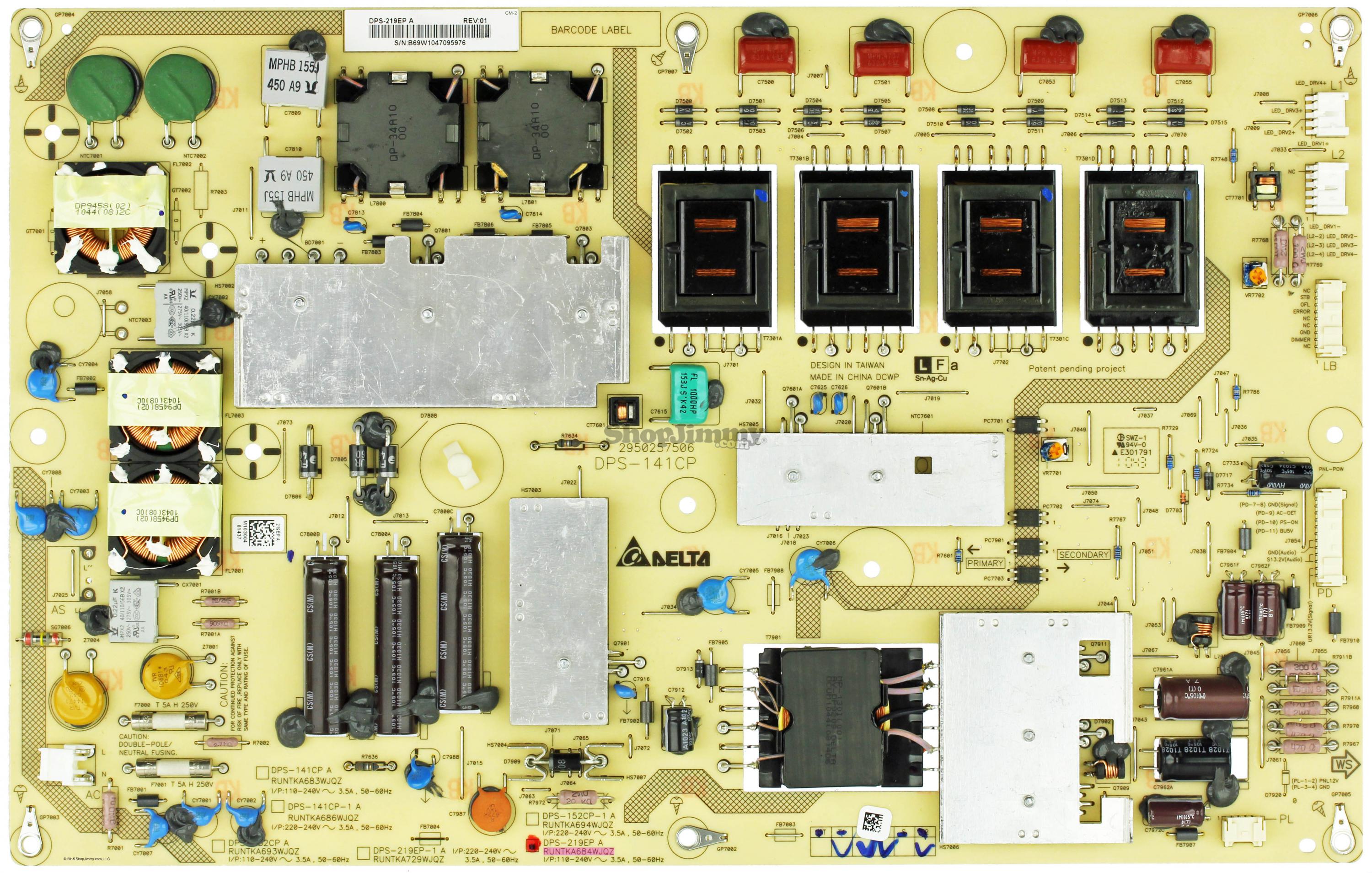

        DELTA 'DPS-219EP A' Pictures provided by SHOPJIMMY.

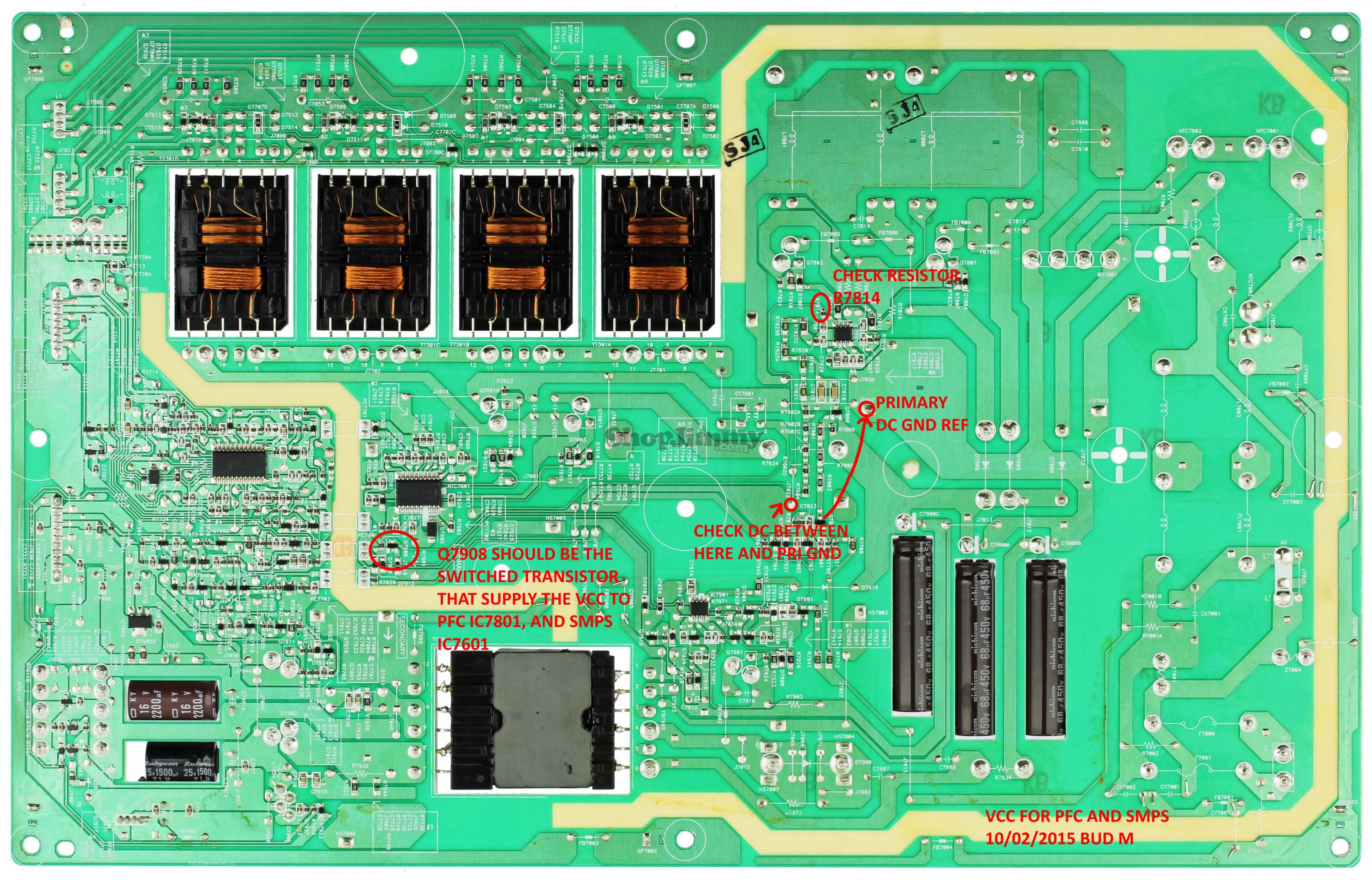

                        T7901 is standby transfromer, winding on pin 1 (GND) and 2 is AUX winding for running the STBY SMPS IC, the D7913 and cap C7912 (all these are OK otherwise you will not have STBY power supply) is for making the DCV to run the ICs. It is the switched transistor and the resistor that I suspect to be bad or the switched transistor did not get the PS-ON.
                        Check the DCV and the resistor, See if I am correct.
                        Picture provided by SHOPJIMMY.
                          The voltage between those points (DCV) is still 0v. The resistor looks a bit funky under the magnifier, but it reads about 10 ohms. The transistor Q7908 has 0.2v at the gate, 0v at the source and 16.85v at the drain. I guess the transistor isn't being switched on with just 0.2v. Where do I look next? Do you think the optocoupler (pc123) failed?
