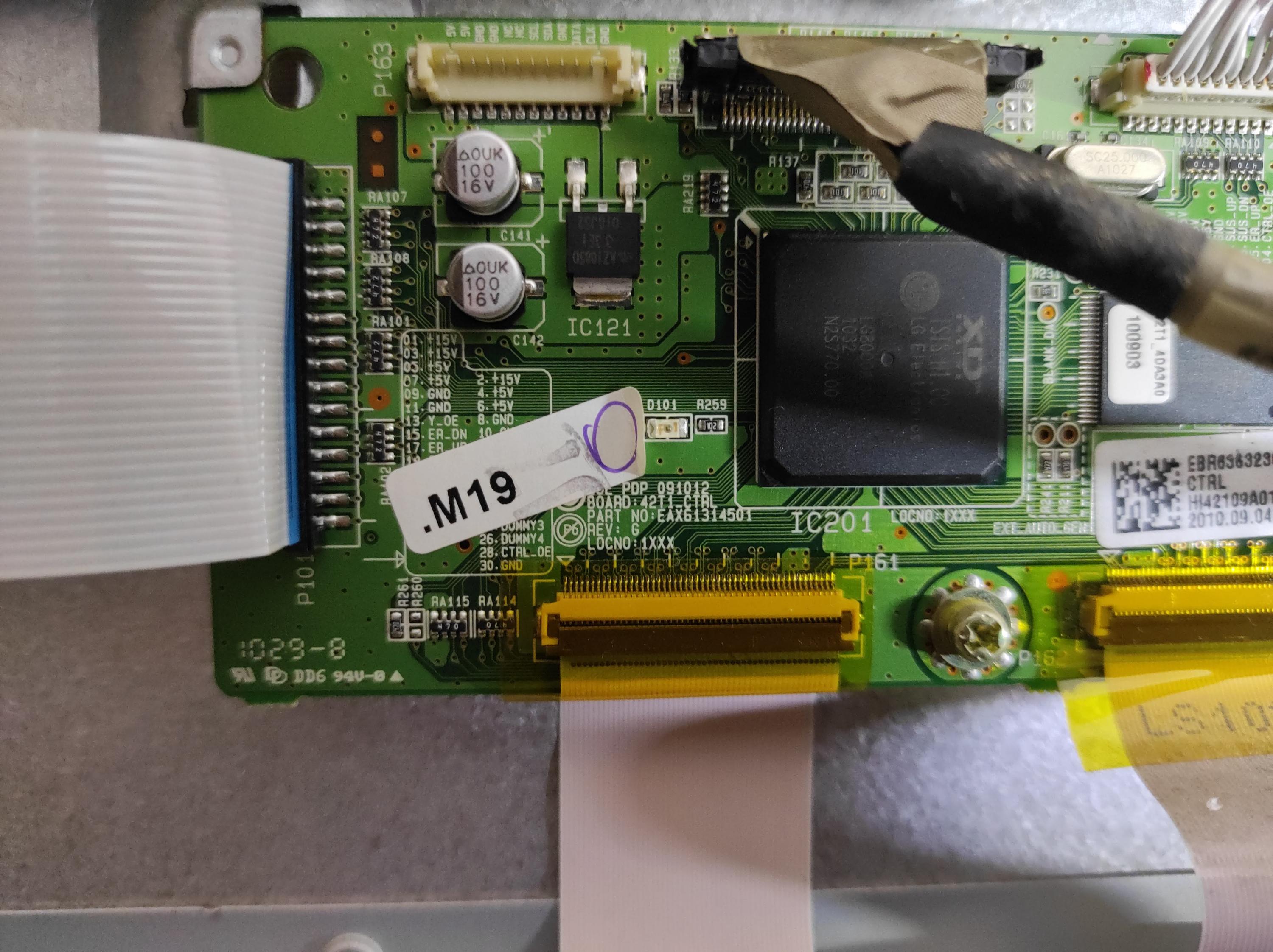

42pj350 no picture has sound.
  • Rickig
    • Mar 2015
    • 112
    • England
    Red LED on at standby, off when powered up.
    Vs = 205V
    Va = 65
    Vsc = 145V
    Vzb = 110
    Vy = 195
    Shorted EXT AUTO GEN on the control board. Still no picture.
    Any thoughts?
  • Rickig
    • Mar 2015
    • 112
    • England
    Re: 42pj350 no picture has sound.
    Johnboy had same symptoms and was control board. Is there a test for this I can do?
      Did you disconnect the lvds cable?
      • Hamie
        • Apr 2014
        • 1383
        Is there a LED flashing on the control board?
        • Rickig
          • Mar 2015
          • 112
          • England
          Yes disconnected. No light on ctrl board
          • Hamie
            • Apr 2014
            • 1383
            Almost certainly control board fault.
              Common issue on these is the Ymain and Xmain failing, however when these do fail the tv wont start at all. I agree with Hamie sounds like a Tcon fault.
                Thanks.
                Ordered ctrl will update when fitted
                • Rickig
                  • Mar 2015
                  • 112
                  • England
                  Was ctrl board. Set up and running again.
                              HI!
                              Just read many posts related to this TV and mine was like:
                              Sound and everything works but no image. Voltages on the panel are correct and 15V has 18V ok. Looking for the control board and the led don't light up, so with the set working, i tried to put some pressure in control board XD IC and suddenly the led on ctrl board started blinking and image appeared. I must assume this is a ctrl board with bad XD IC bga joints and it should be replaced.
                              This is only another testemonial to confirm that when you have all voltages and no image it must be ctrl board fault.
