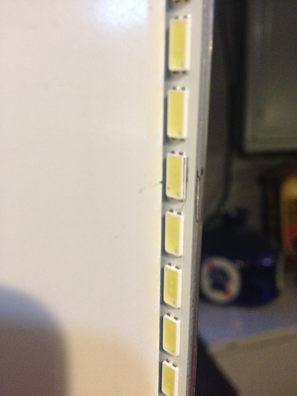

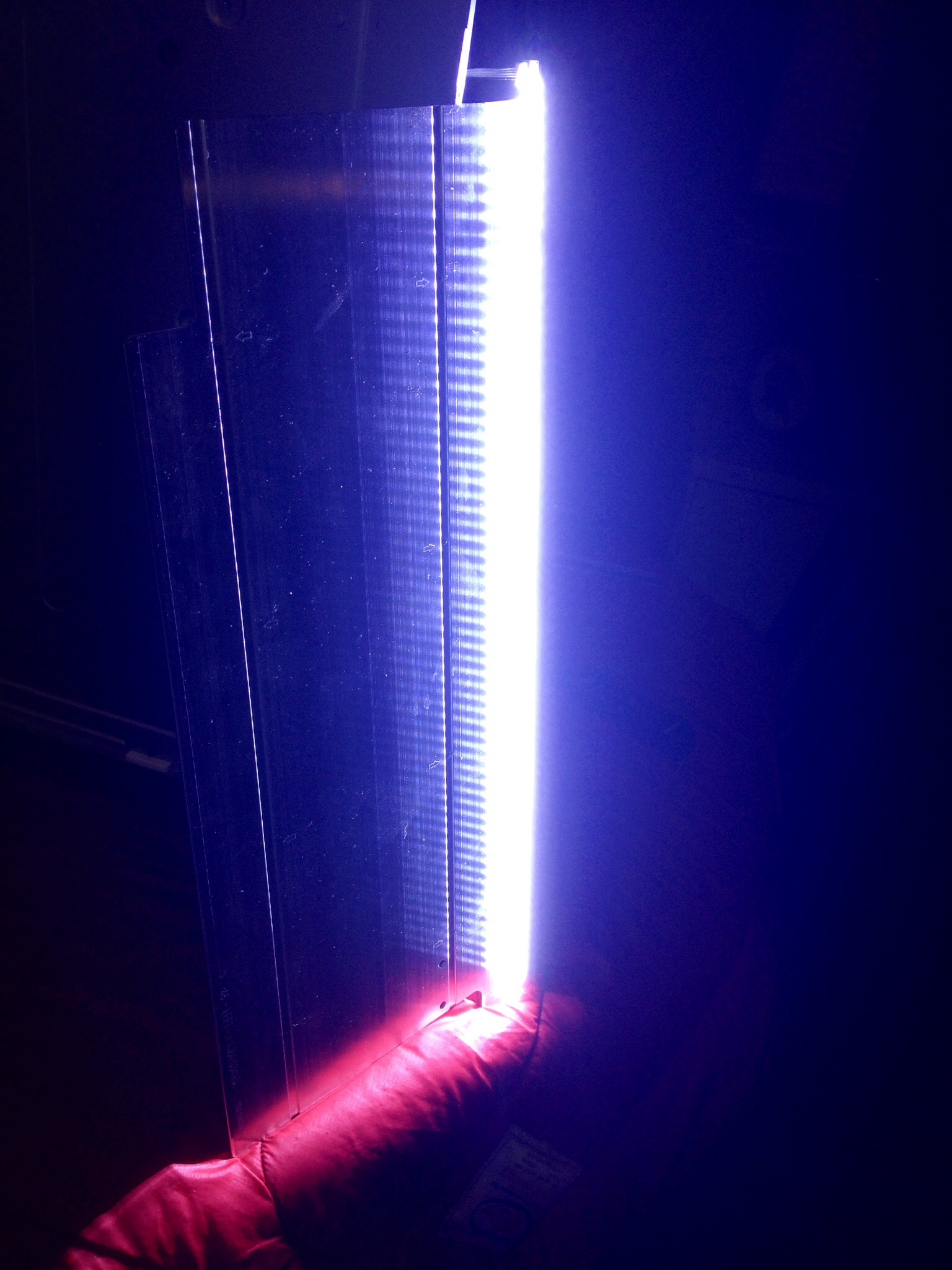

    I took the TV apart to see how many LEDs were out and found one! What's the easiest way to remove one of these LEDs? I have a light strip from another TV that I can use to replace the LED. I am having trouble removing the led without damaging it. Any help or advice is greatly appreciated!

    With a heatgun heat up the underside of the board for about 40 seconds.
    Then slide the faulty led off the strip .

      Do not use force. It will just slide when it's good and ready.

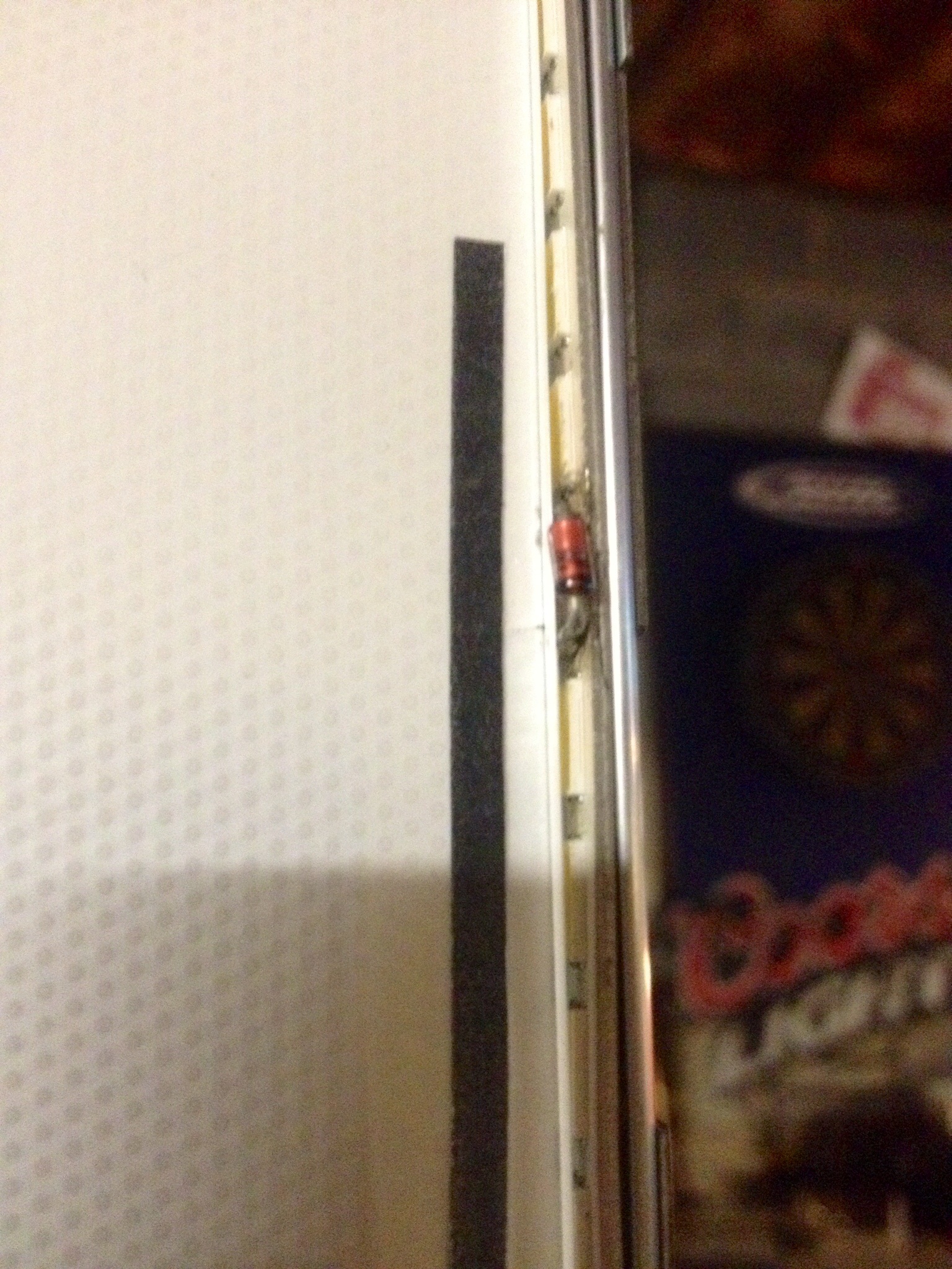

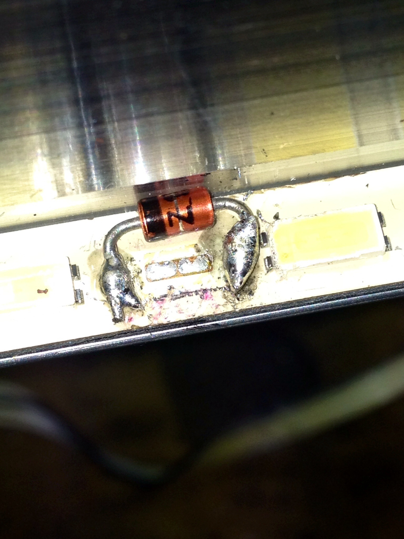

              Okay the led I had was to small and it would have failed due to much power. Now I did the same thing as the gentleman did in the video. Soldered a zener diode in. Now the back lights come on for 2 secs and shuts off! I checked the zener diode and it's good. What now guys?

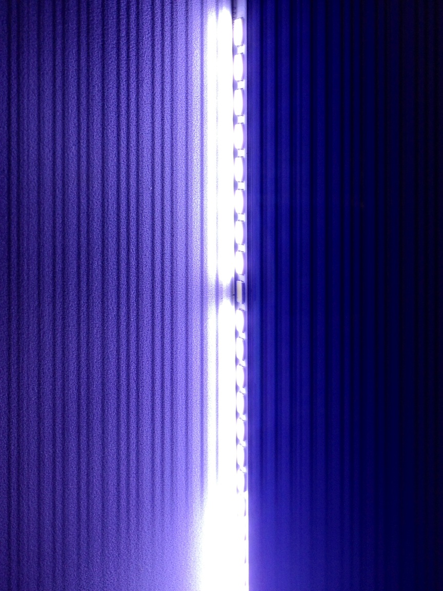

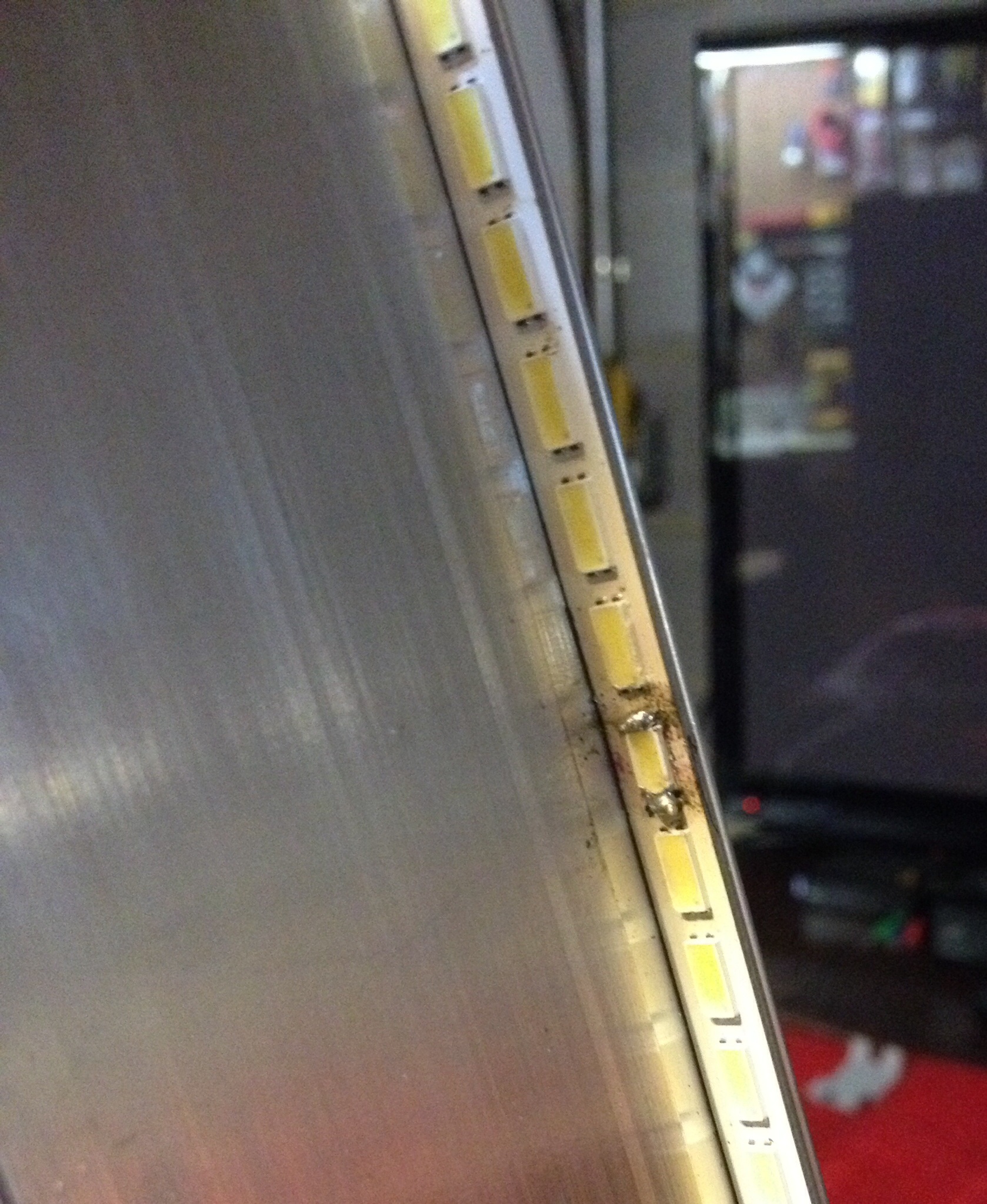

                Update used a Led out of a LG that could handle the voltage. Pardon my horrific soldering job as it's getting late and Cuervo is starting to win the battle.

                  Re: Toshiba 46L5200U LED Replacement Help Needed
                  Fully lit
                    Nice,
                    Stange the zener didn't work.
                    What was the voltage? Think it would need a 6.2 or 6.8v zener.

                      He needs to find out if the LED he has is dual LED or single LED, and also if the Zener is put in correct way which is reverse bias.

                        Did you reverse bias the Zener you need to on a set up like this ?

                          Also good work soldering isnt the best but good for practice nice job

                            Sorry for the delay gentlemen, I did not have the zener in backwards, it was actually was 3v where as it needs to be 6volt. Also about 18" of the screen was perfectly lit and the rest was about 25% lit. The paper backing and plexi wasn't Perfectly aligned! I finally got time to break the tv back down and install the new zener diode. Currently I'm trying to get those right! I've replaced the lcd bulbs in 4 different sets, and thought that was kinda a pain in the hip, but this led tv takes the take for being a pain in the hip! Be very cautious and rack the assembly out another table as you dissasemble the set! Also reference the youtube vid as you do the reassemble. As the paper backing and plexiglass has to be aligned perfect! Thanks for all the help with this set, I just hope I can get the dang thing back together correctly. :-/

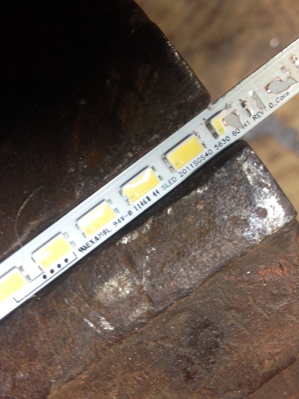

                              After putting the tv back together the diode broke loose, and shorted 5 LEDs out. That puts me back to square one again... I've searched and searched the web for a replacement LED strip, and haven't had any luck. On a last ditch effort I posted an ad on Alibaba for the LED strip. The part number that I used to research the led strip is LJ64-03495A. If I get a hit off that site I will post a link to where badcap members can purchase them. Once again I would like to thank everyone!
