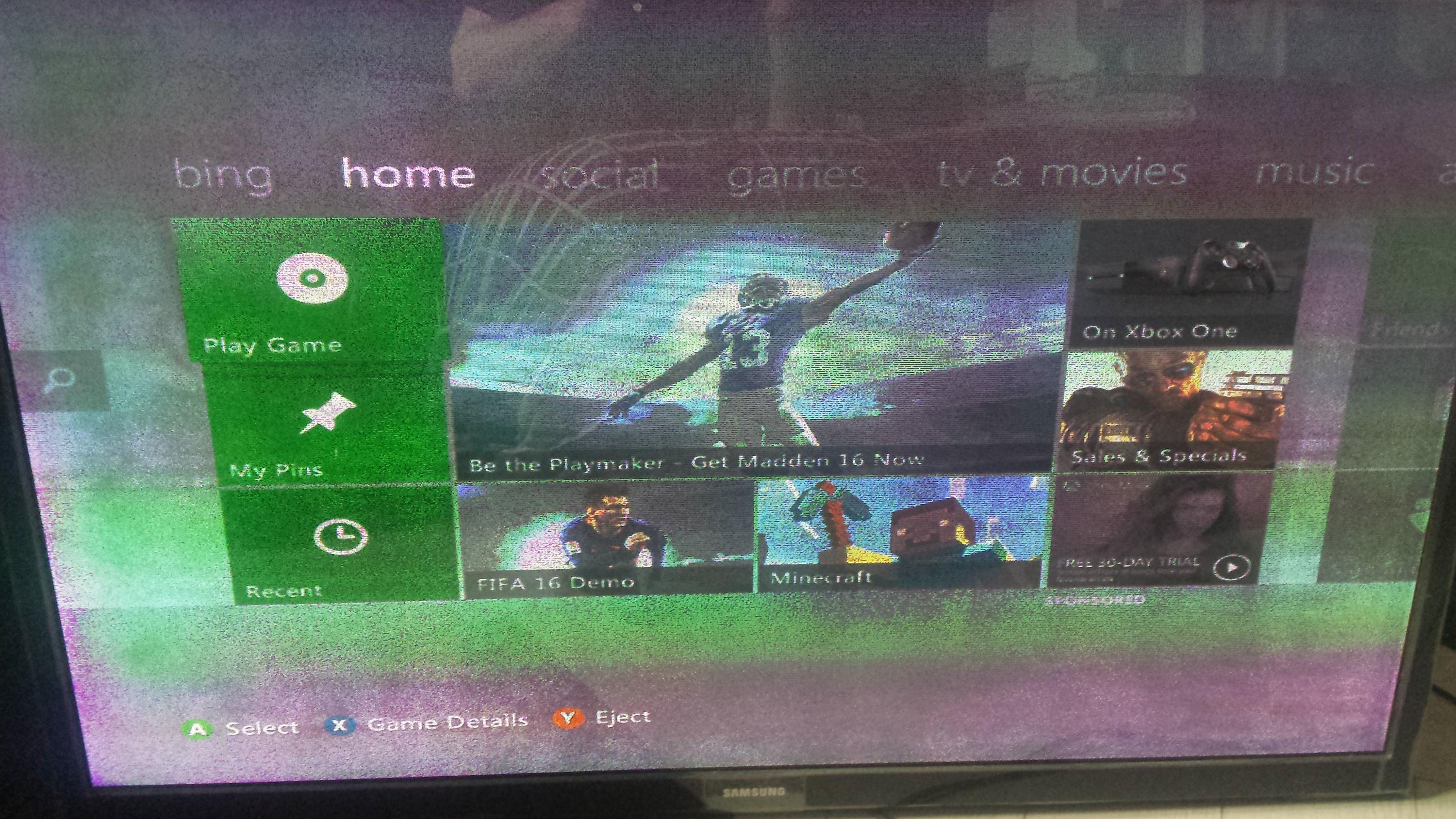

    Hi guys i got my hands on a Samsung 43 inch Plasma tv which has this fault. what could be the issue, im assuming not the buffers but something else ?

    Looks like Zsus issue whats the model of the tv that would help ?

      Model : PE43H4500AW
        Re: Samsung Plasma distorted and dark picture.
        wow, new set.
        X-main (Z-sus) failure or set up ramp on Y-main (Y-sus) is stunted/missing

          is there anything i can do to inspect or will it need a new board ?

            Do you know how to check for S/C ?
              no...

                Ok probably best to learn how to before replacing boards, do you have a DMM ?
                  yes ReeceyBurger123 i have a few multimeters
                    mikeyboy S/C = short circuit, since you own a few multimeters I bet you know what a short circuit is.
