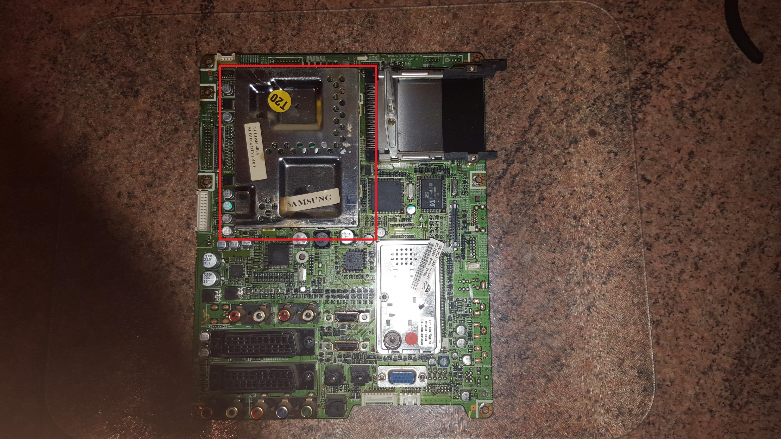

    So i removed the heat sink and gently warmed around this area plus used a hair dryer to warm up the board and now the tv is staying on
    so ill recheck this again in the morning when its cooled down
    • CapLeaker
      Leaking Member
      • Dec 2014
      • 8340
      Re: Samsung LE46M86BD Constant Restarting
      there are caps underneath that cover you warmed up. So check the ones that are closest to heat first.

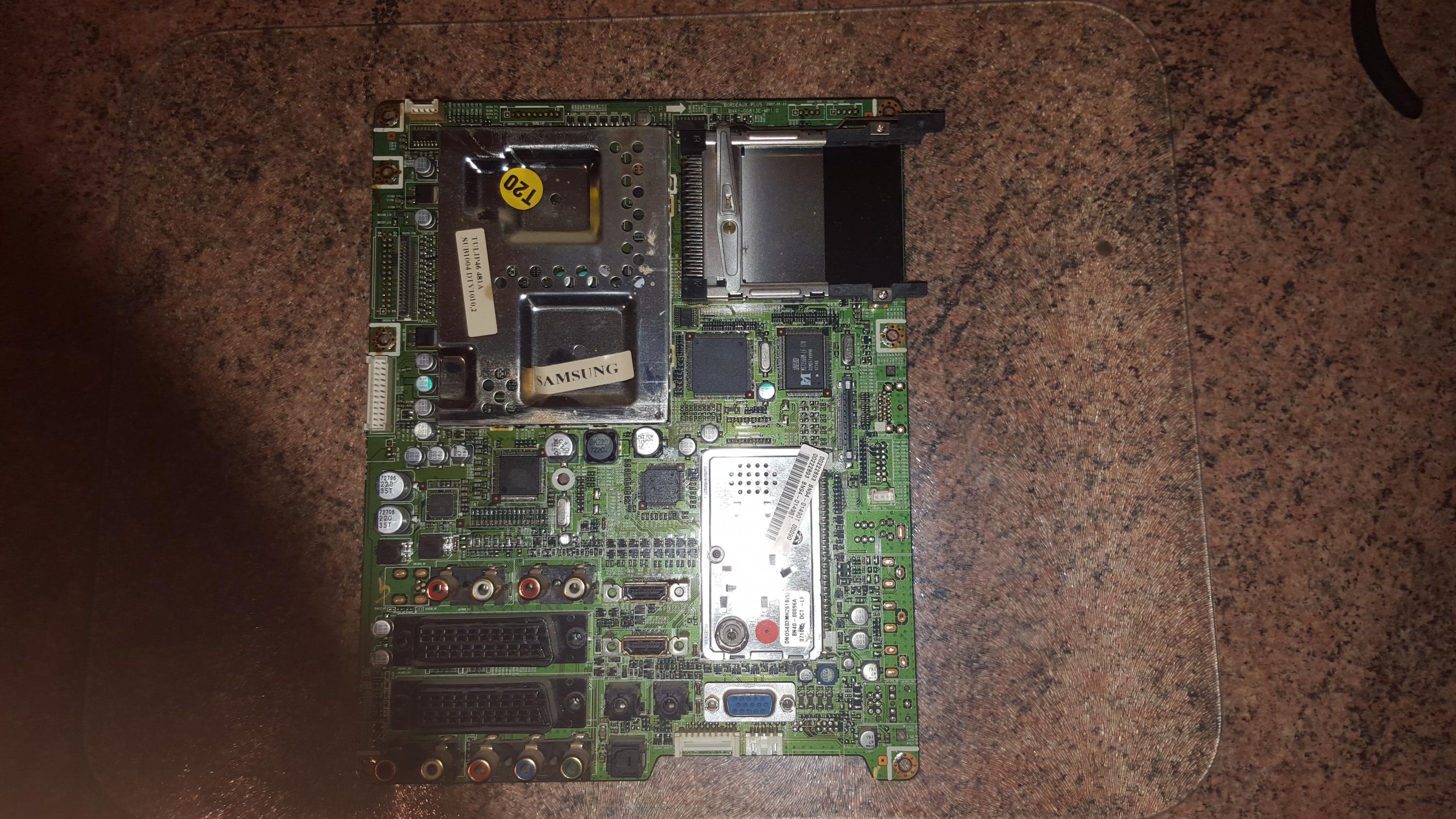

                        I can't believe I just found this thread, I just registered to make my own thread.
                        I have the 40 inch version of your TV and have a similar problem. How did you remove this heatsink? Do you have to desolder it? I don't want to force anything.
                              Originally posted by Alastair E
                              You have to de-solder the tinwork from the underside--They are a pain--and will need refitting once done, or the chips will overheat....
                              Thanks, it was messy but I managed it.
                              Originally posted by tuke81
                              Be sure that you fix your psu before that(secondary side electrolytic caps). Bad voltage from psu is the reason why main board is failing in the first place. Oh and be sure you have a similar problem, so use hair drier to warm up that heat sink. Restart loop should vanish quite quickly. And like Alastair said it's a pain to de-solder it, but certainly doable.

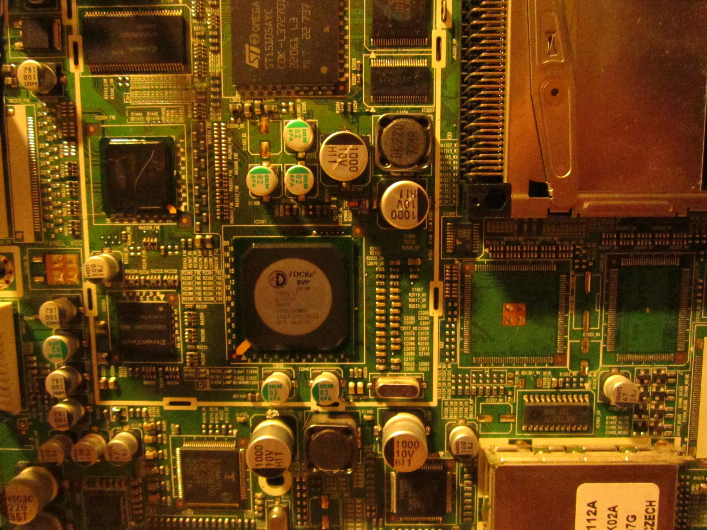

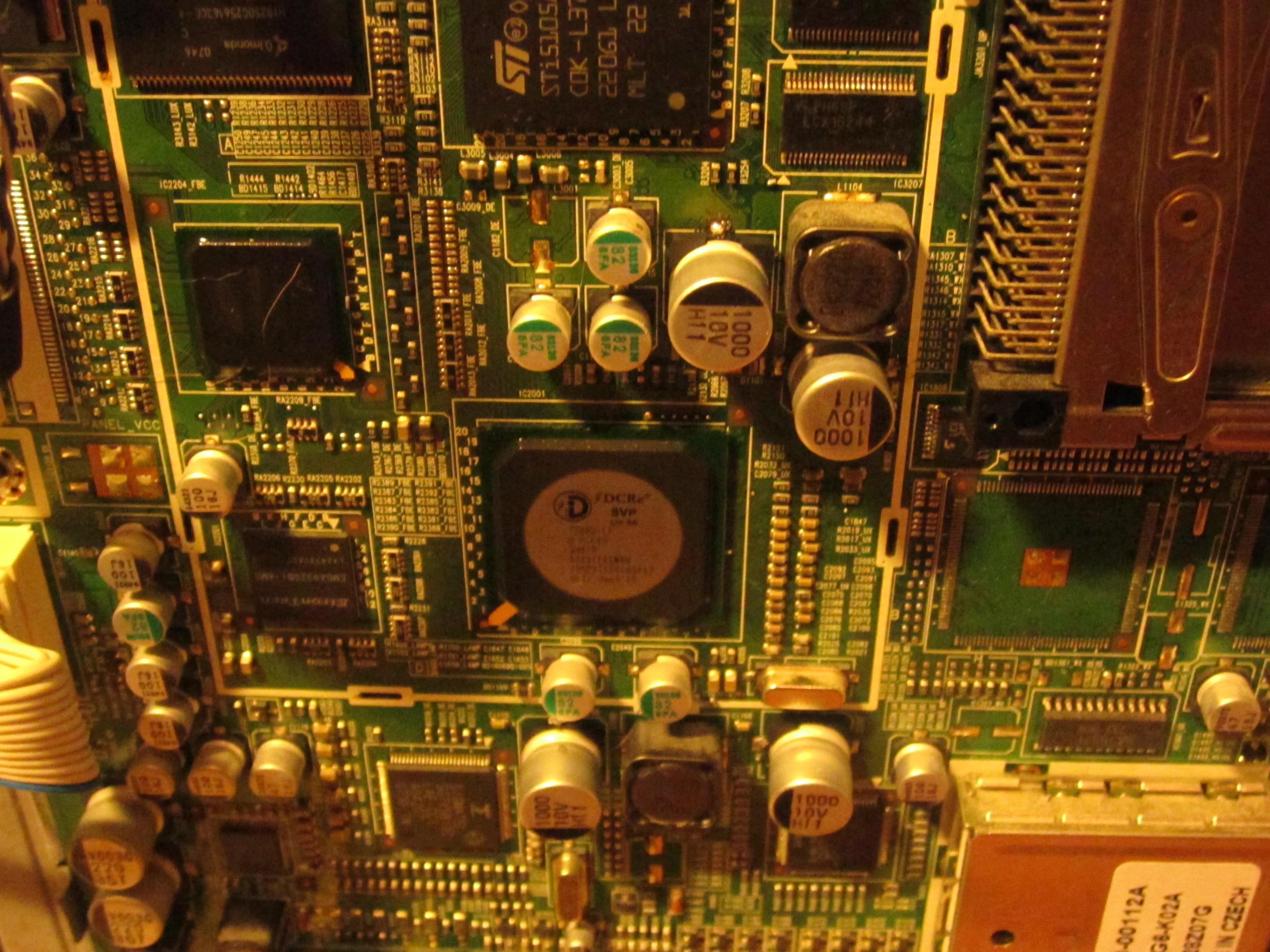

                              Thanks. I was kind of hoping I'd find some obvious blown caps but there's nothing. Every cap looks fine on the psu and main board. I will definitely use the hairdryer trick.
                              I'm not sure where to go from here, I don't own a multi meter or esr meter and have no experience on how to troubleshoot the fault.
                              Should I just replace the caps under the heatsink on the main board like in this thread or should I replace the caps on the psu too?
                              Should I invest in an esr/multi meter to test voltages and caps?

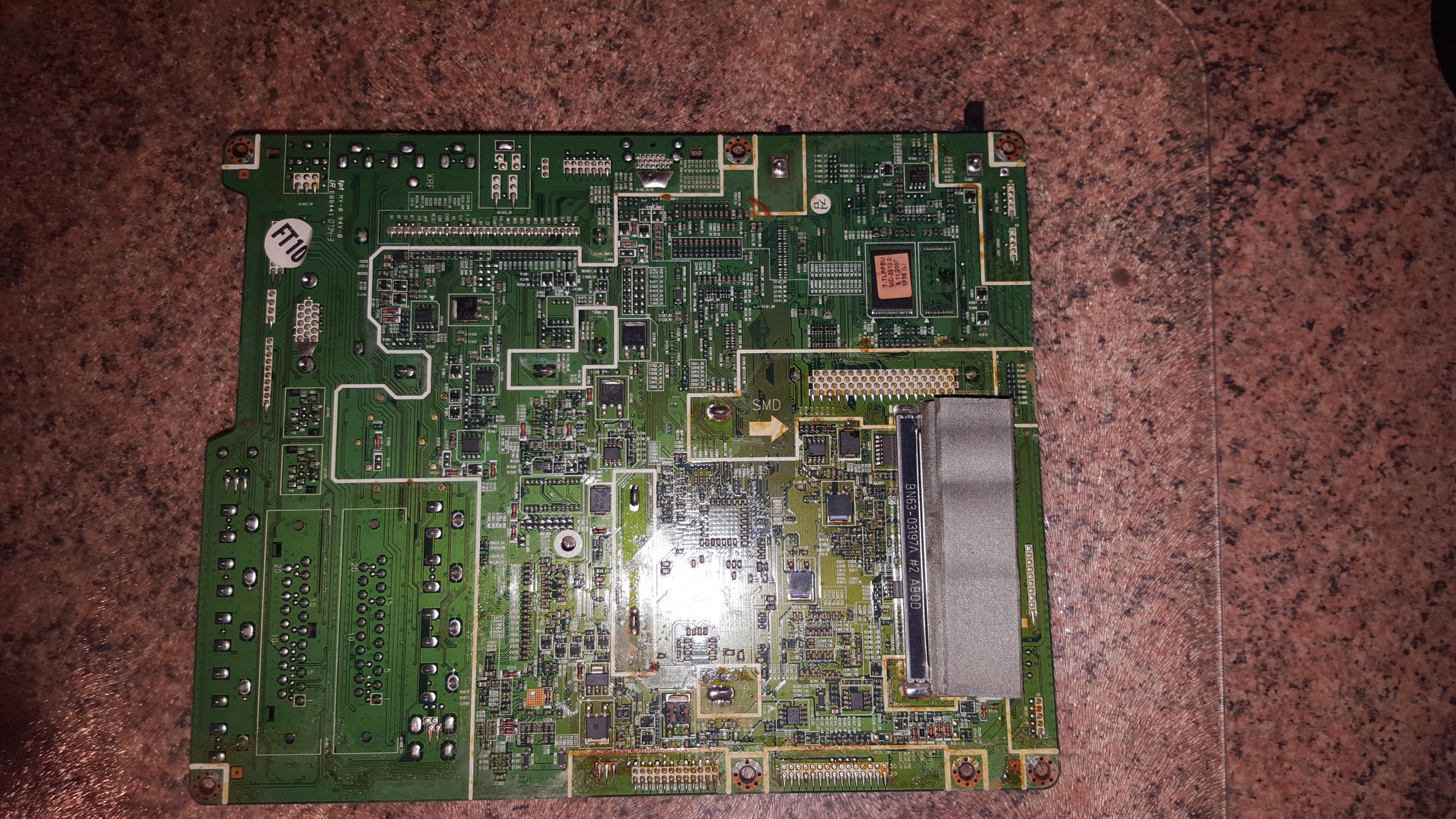

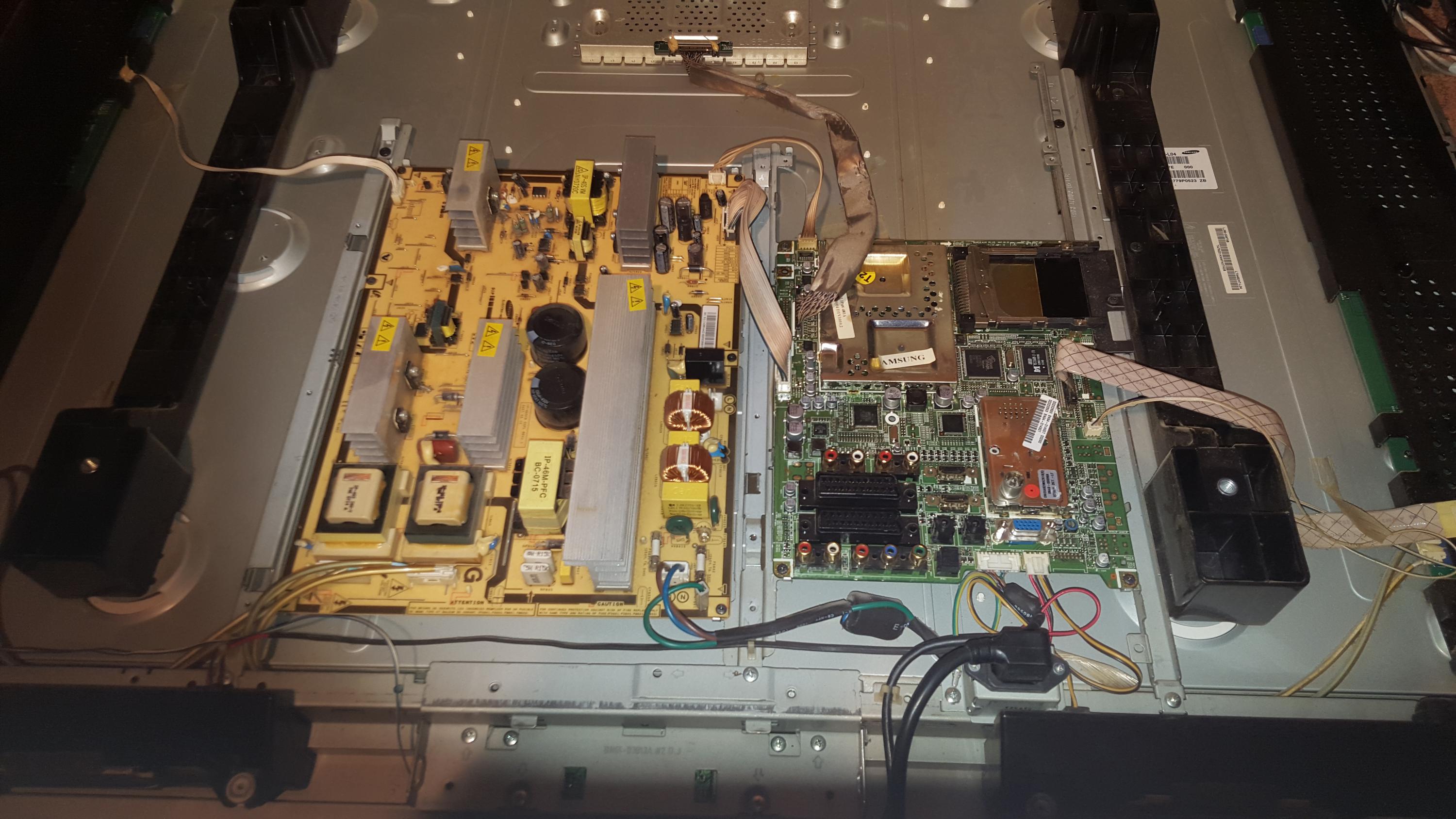

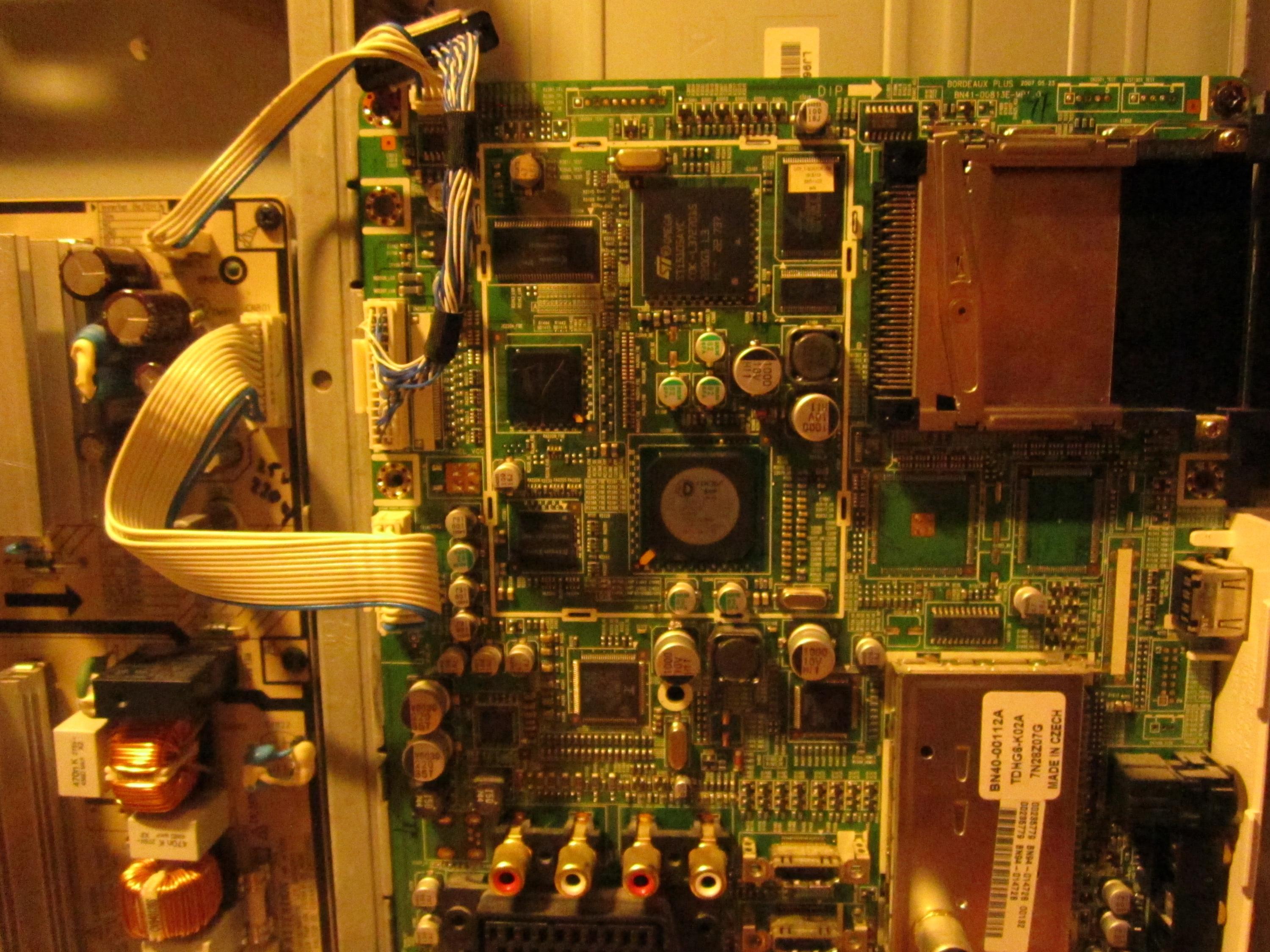

                              I should probably make my own thread but here is an album of my boards: https://goo.gl/photos/sAt5NG6tQ9wNpJum7
                                Bad cap can look normal, no bulging does not mean it is good.
                                You should have at least Digital mulimeter and good soldering station if you want to do repair works
