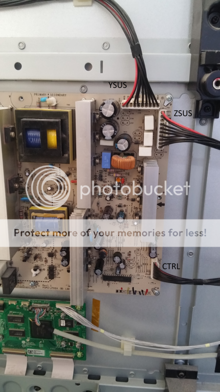

    I need help repairing an LG Plasma.
    I've replace caps on the power board, one 400v270uf caps had gone bad on the primary side, both 250v220uf on secondary side. I measured the capacity but changing them didn't help.
    Voltage is as it should be?
    To YSUS
    2xVS=193.6-193.8
    2xVA=59.5
    2xM5V=5V
    To ZSUS
    2xVS=193.6-193.8
    2xVA=59.5
    2xM5V=5V
    CTRL
    16.5=16.3
    12=11.9
    5V+5V_DET=5.0V
    The part numbers are as following;
    Powerboard: REV1.1 PSPU-J702A EAY39190301
    YSUS-board: EBR50038901
    ZSUS-board:EBR50044801
    Symptoms;
    I turn on the tv and the standby-light goes from red to green, blinks six times and goes solid green. I can hear a relay clicking once and there's a green light on CTRL-board. I've also checked the tv for blown fuses. Any help is highly appreciated. The screen is black.

    Does anyone have an idea of something I could try to get this thing fixed?
