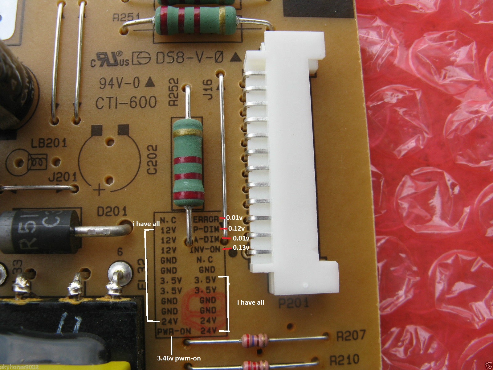

    - mainboard - eax64664903 1.0
    -power source - eax64560501 - 1.6
    is no red light when power plug in, i dod not find schematic
    i edit photo with voltage . If i remove cable between power and main. i have only 3.5v
    Hope you can help me.

              I think you have to bridge with a 100 ohm resistor the 3.54Vdc STD-BY - to the PWR-ON, check if you are getting 12Vdc and 24Vdc then using another 100 ohm resistor bridge from 3.54Vdc STD-BY to INV-ON and check if Backlights come on.
                Re: LG 32LS4300 , no red light , no power
                PWR-ON allrealy have 3.5v , i have 12v and 24v, check the photo.
                i will try 100ohm rezistor between pwr-on to inv-on
                  OK...I did not look at the photo before.....I'll have to agree with Hamie...looks like a Main Bd issue...
                    Check voltage/software at IC401 24C256, IC1401 MX25L8006E from main board. In the worst case you have IC101 LGE2111A-T8 faulty.
                      IC1401 MX25L8006E have 3.5v pin 8
                      IC401 24C256 - no voltaje, but when try to measure a sound is hearing from IC101 LGE2111A-T8
                      and IC101 LGE2111A-T8 is a little hot
                      after 5-10 min , i want to measure againg and i notice that the red light is on, and now is starting.
