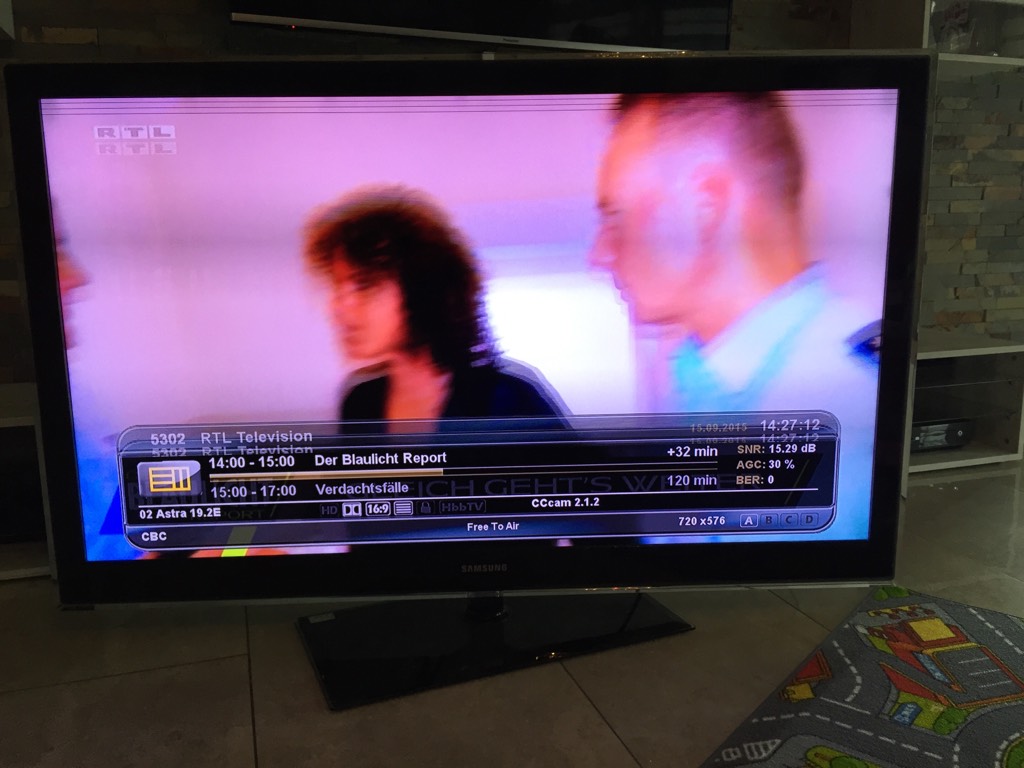

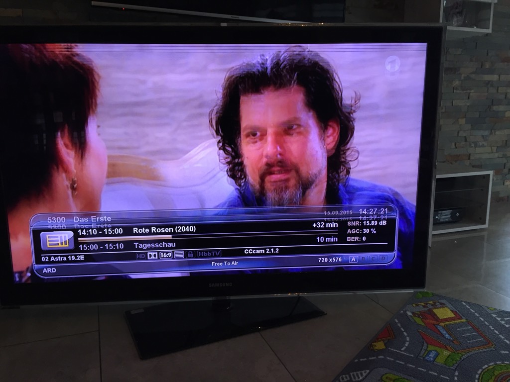

    I have a Samsung 55 inch TV (UN55B7090).
    Since several days, there is an overlay of the picture. See attached pictures.
    Does anyone know how to solve this problem?
    Best regards,
    argonid
    Re: Samsung UN55B7090 - picture overlays
    Try flexing the screen to see if it will change.
    BTW, I see those 3 Horizontal bars on the top section of the sceen, are they there all the time?
    It looks to me you have bad panel.
    • Maklaud
      • Sep 2015
      • 56
      • Russia
      The problem is most likely in the glass matrix. Try disconnecting the left ribbon cable,and then right ribbon cable from t-con. And you will see.
      • argonid
        • Jul 2015
        • 14
        Yes, they are all the time.
