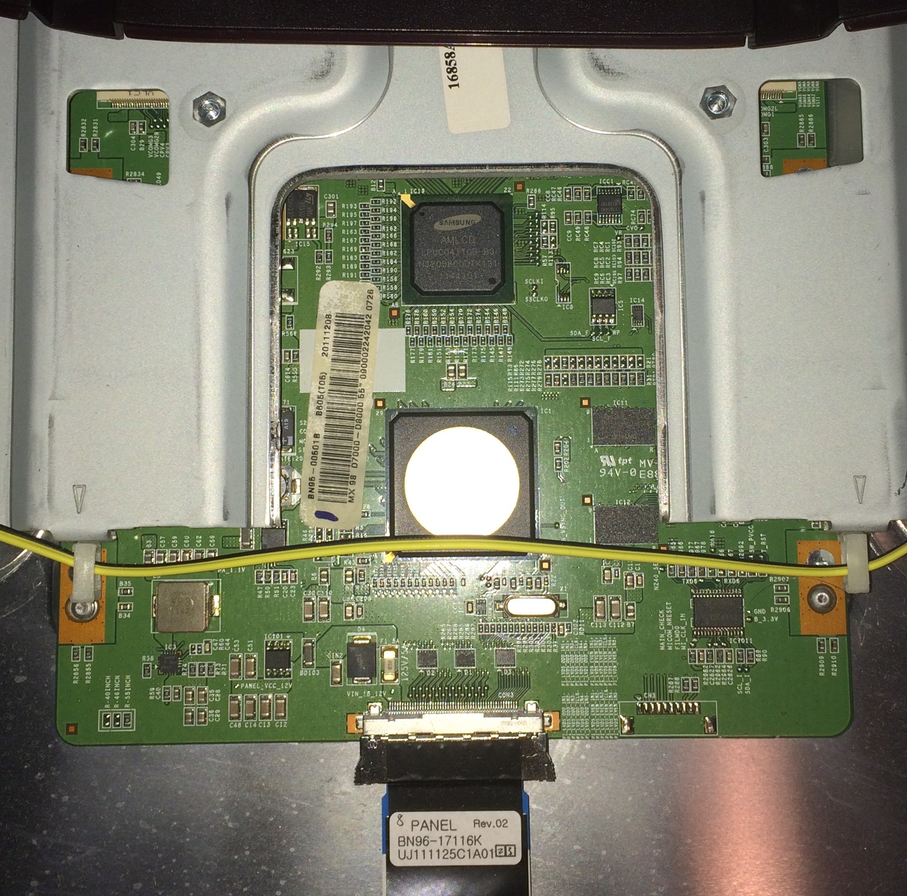

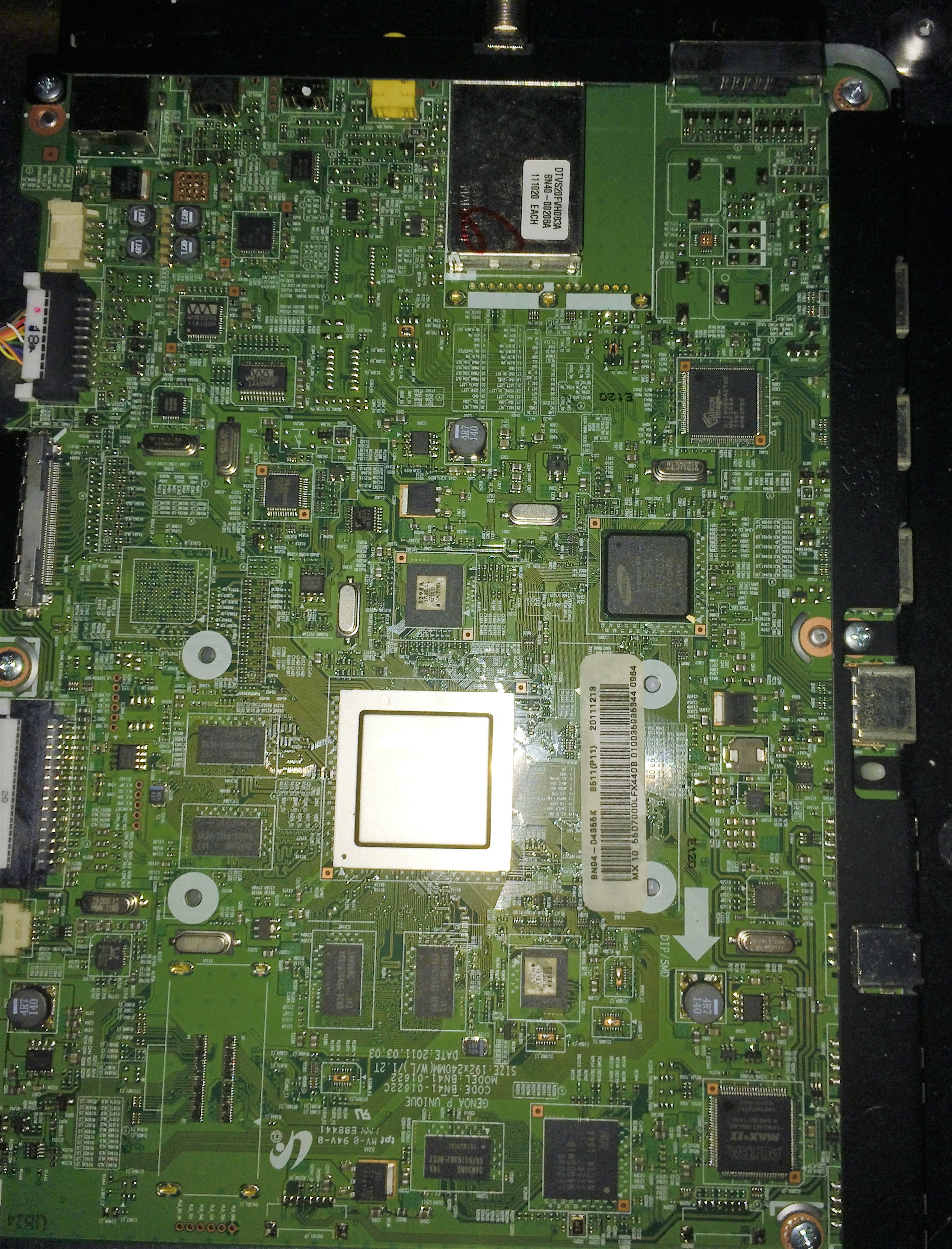

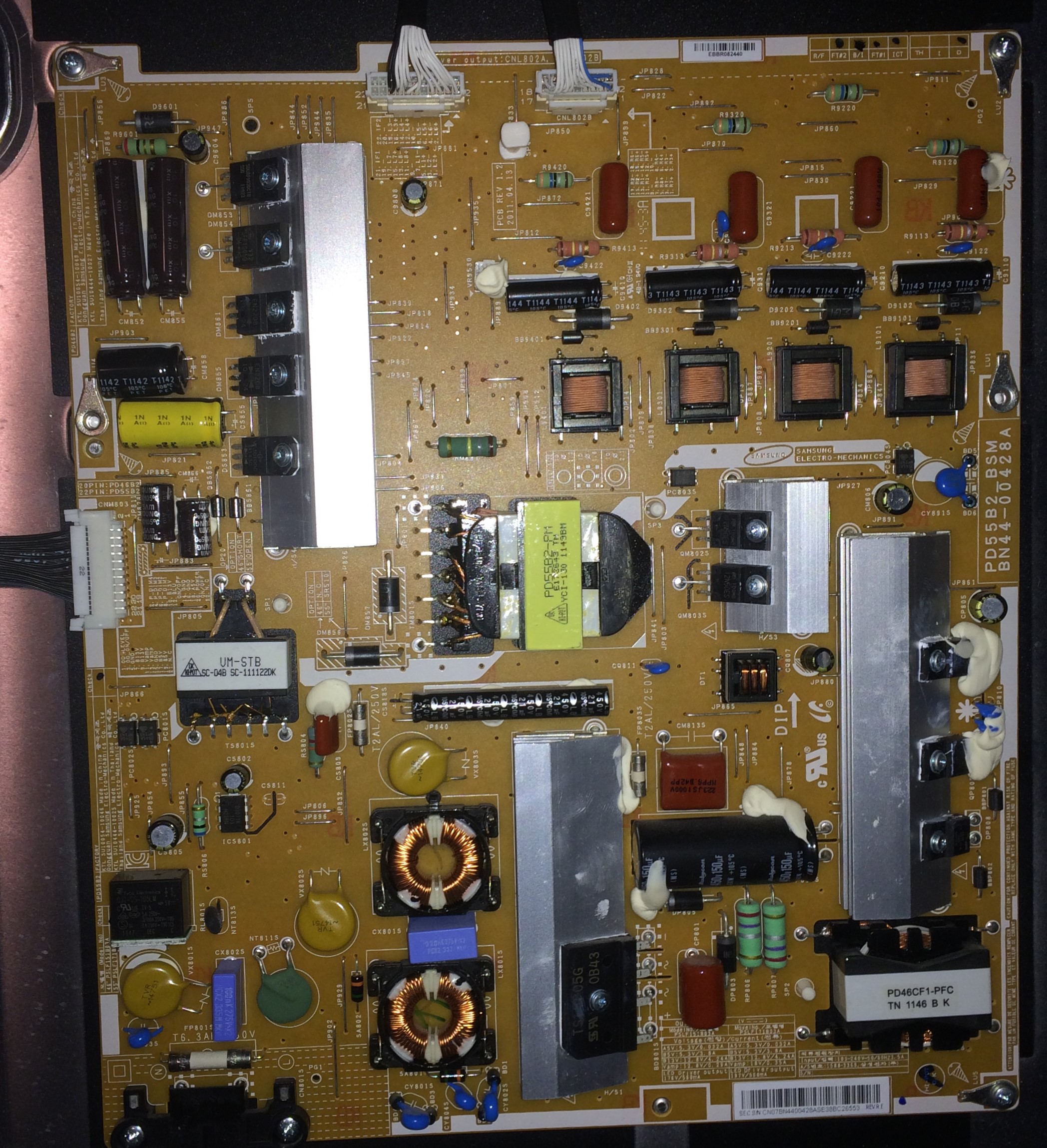

      Re: Samsung UN55D7000 clicks but does not turn on
      Attached are pics of the SMPS, Main and T-Con board. The pinout for the cable between the SMPS and the main board can be found on the 2nd page of this document:
      I'll try to get voltages and power the SMPS board on as suggested as soon as I find the PSon points.

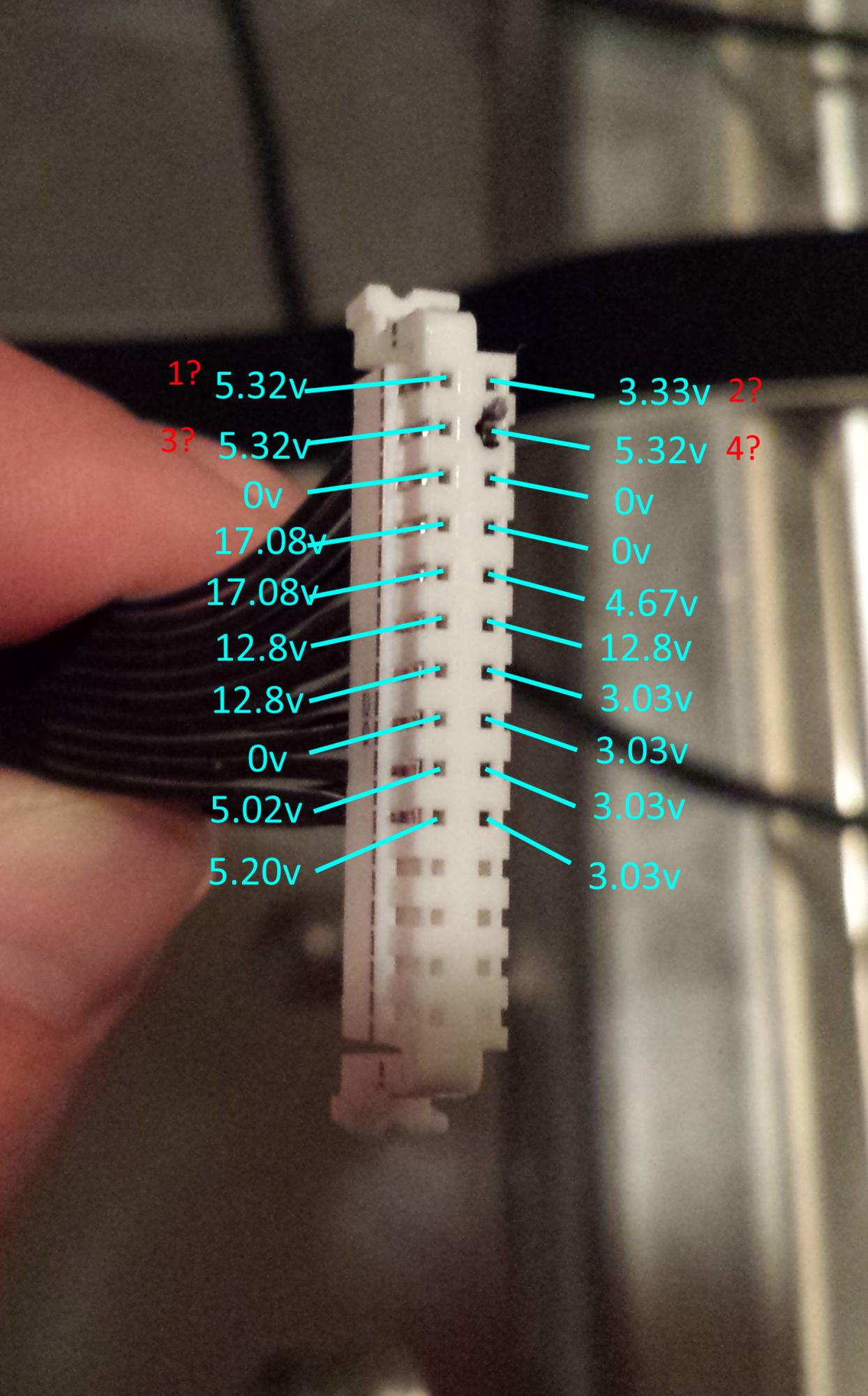

        Measure all voltages in the 22 pin connector on the left in the first picture with pin out.
          +1, please make sure to put each Voltage reading after each pin number and pin names so we will know what is missing.

              Thank you all for your support, I have a few n00b questions:
              1. I can't get contacts with my volt meter on the either the SMPS or the main board side while the cable is connected. If I unscrew the main board to make the measurements across the bottom, will it affect the pin-out readings, meaning will it affect the grounding?
              2. What is the PS_ON wire, I don't see a wire with this label in the 22 wire pin-out. Ref.: pg2:
                So per info from the the service manual, when you disconnect the CN201 wire harness per service manual, do you get the backlights to come on and stay on? That will tell you if you have main board or power supply board problem which you have already done that.
                Pin 2 on the CN201 is the PS-ON pin, but do the test by disconnecting the cable.
                    Yes, all the backlights work when the SMPS board is disconnected from the main. Attached is a list of all voltages measured while ground the black lead to the tv. The bottom two pins correspond to pins 1 and 2 on the SMPS board.
                    Which pins are STBY and BLon? ...I don't see them labeled this way on the pin-out in the above link.
                    Thanks...
                      Look at the power supply board CNM803 Pin 20 (POWER_ON/OFF), PIN 12 is the BL-ON (BLU_ON/OFF) as shown on the connector of the power supply.
                        Thanks...
                        Everything is there...
                        How come the connector is damaged? Does the damaged pin make contact with the board?
                          I thought he marked it with the black marker, if not it looks burnt.
