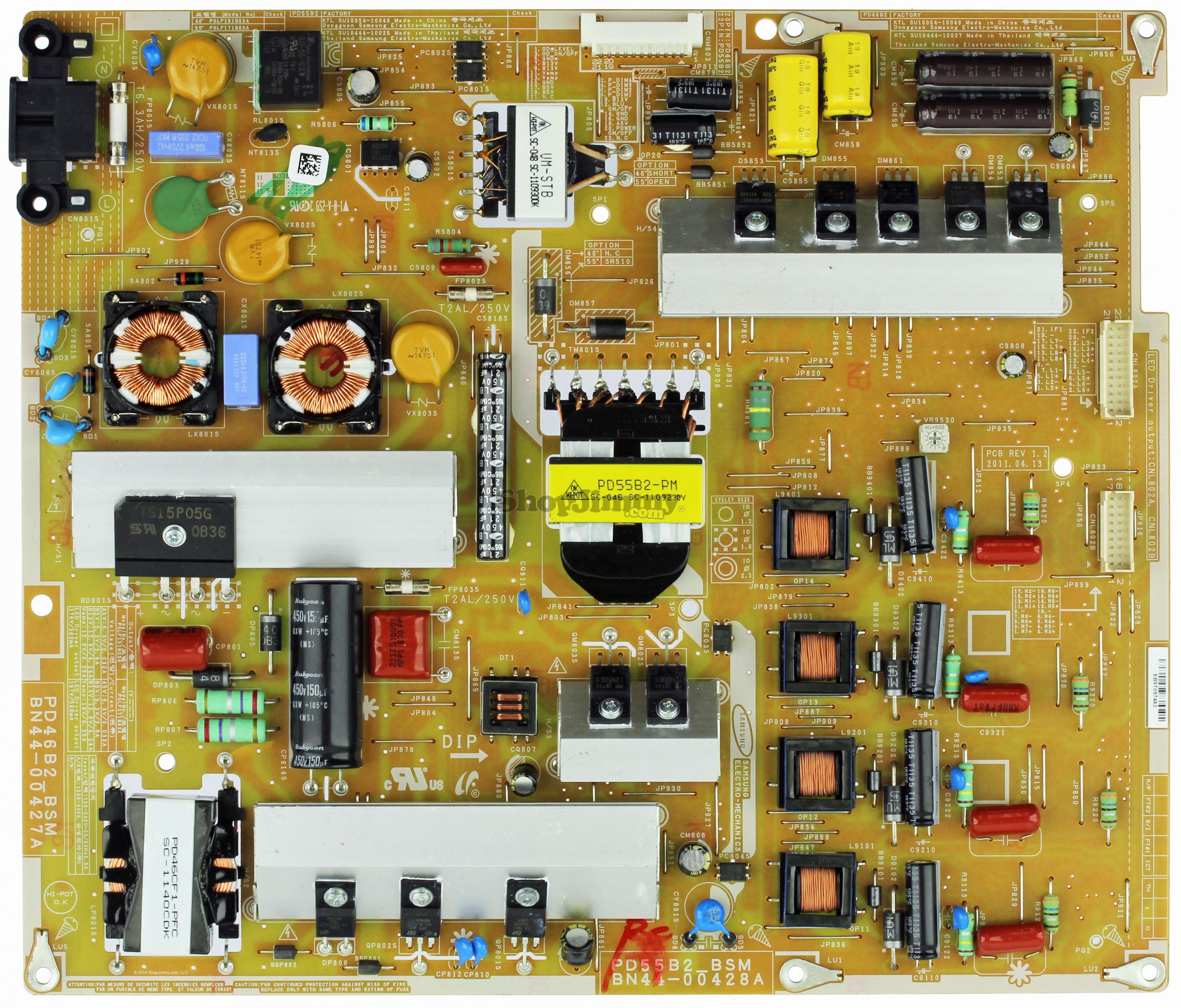

        What is YOUR power supply board P/N BN44-xxxxxx?
          Re: Samsung UN55D7000 clicks but does not turn on
          By board P/N is BN44-00428A

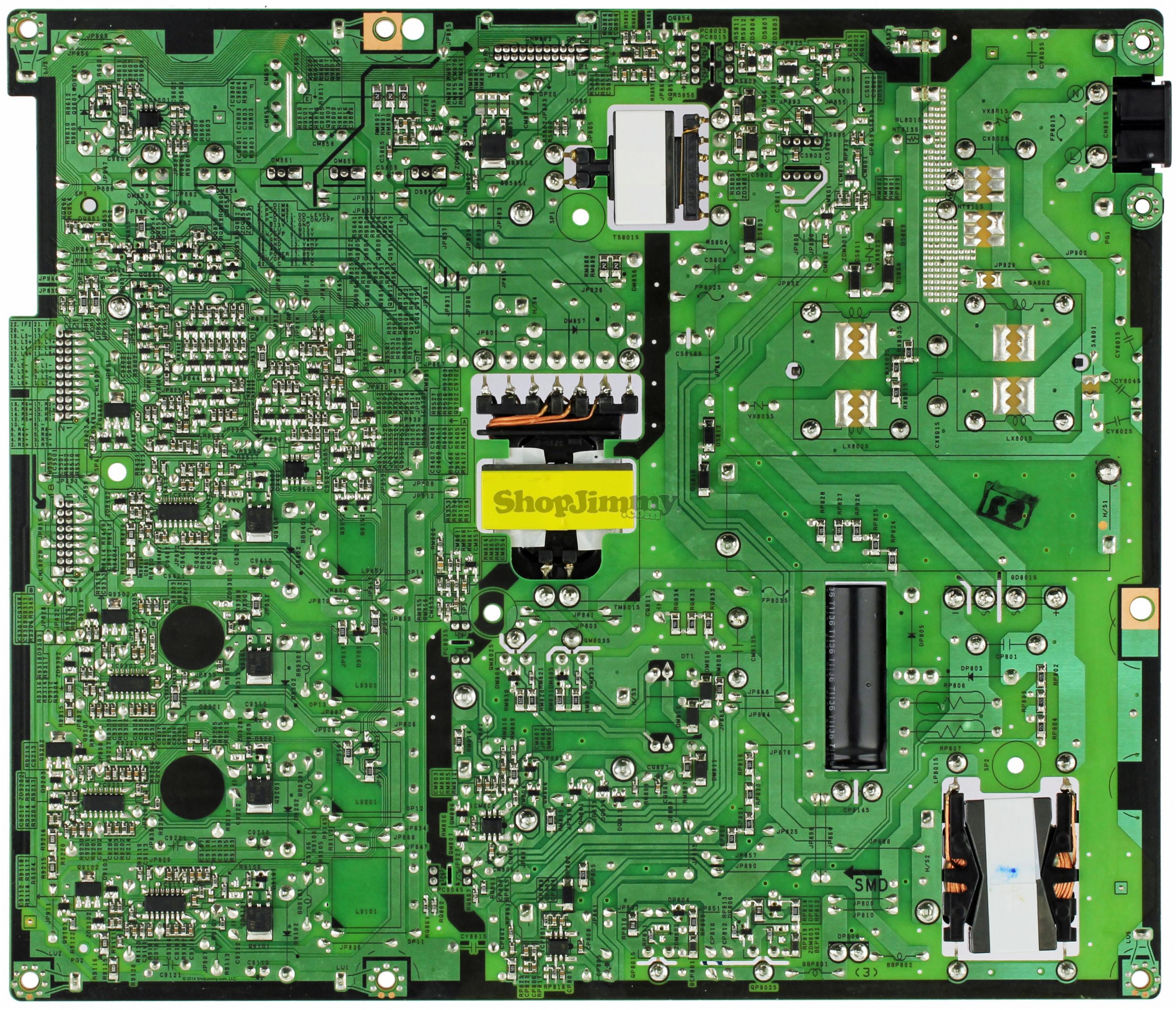

                      BN44-00428A provided by shopjimmy.
                      As you can see what the pin names on the power supply board are for CNM803 hwich goes to the main board.
                      Pin 1: OD_LEVEL = ???V
                      Pin 2: P_DIM4 = ???V
                      AND ON AND ON AND ON.
                      It is hard enough to troubleshoot complex electronics without having the real unit in front of us to look, so good clear and correct information must be provided to us for you to get proper helps.

                          The pictures I provided is for the BN44-00428A that you told me is what you have so, verify and see if it matches your board and then take the readings..
