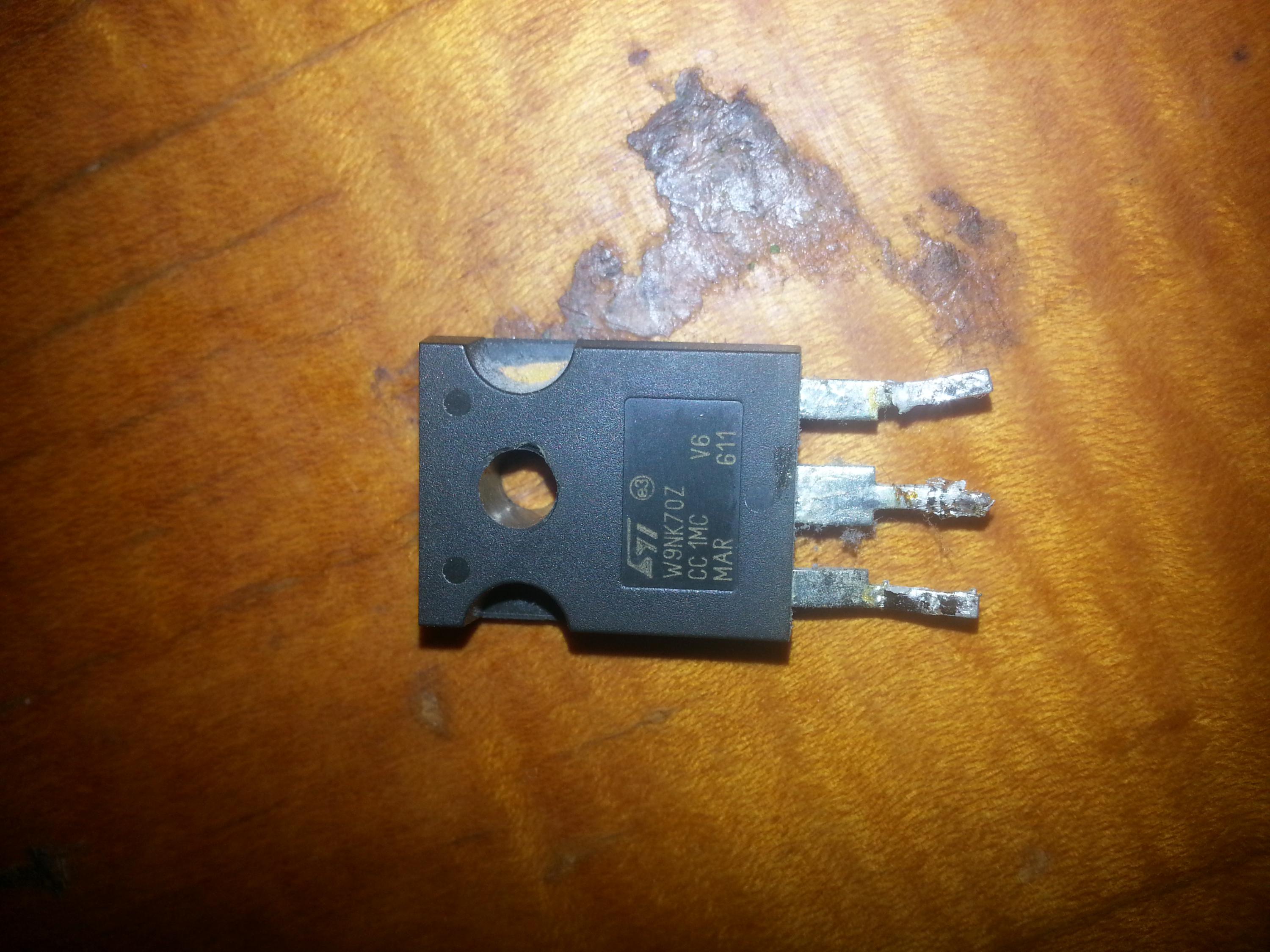

    Tv clicks on then clicks off after 1 second. The power light flashes 4 times then goes to steady red. If I unplug the ysus from power supply it comes on with sound but no video just a black screen. I have changed all fuses. Tried the reset with holding power button for 30 seconds unplugged. I have tried to jumper the ac detect. Nothing works.

    That means the Ysus is short and loading down the Psu causing it to go into protect mode. When the relay clicks off does the Ysus make a high pitch buzzing ?

                    Ok right take the Ymain out of the tv and check for S/C on the devices mounted on the heatsinks. Simply probe the leg of the device and if its a dead short the meter will beep.

                        I think I found the problem. All those transitors were reading fine except 1. The numbers on it are W9NK70Z.

                                There is not anyof those transistors on it. Im gonna have to order that one that tested bad unless theres another kind I can use.

                                  Re: Lg 42" plasma wont turn on
                                  'V8 got IPM's innit....?
                                  That MOSFET above looks to be from 42V8/X3 series--Its one of the Pass Fets, One of 4 or 5 on heatsink....
                                  --No 30J124 etc in 'em.
                                  10-1, the IPM will be stuffed--especially with the description of the POP sound when it failed....
