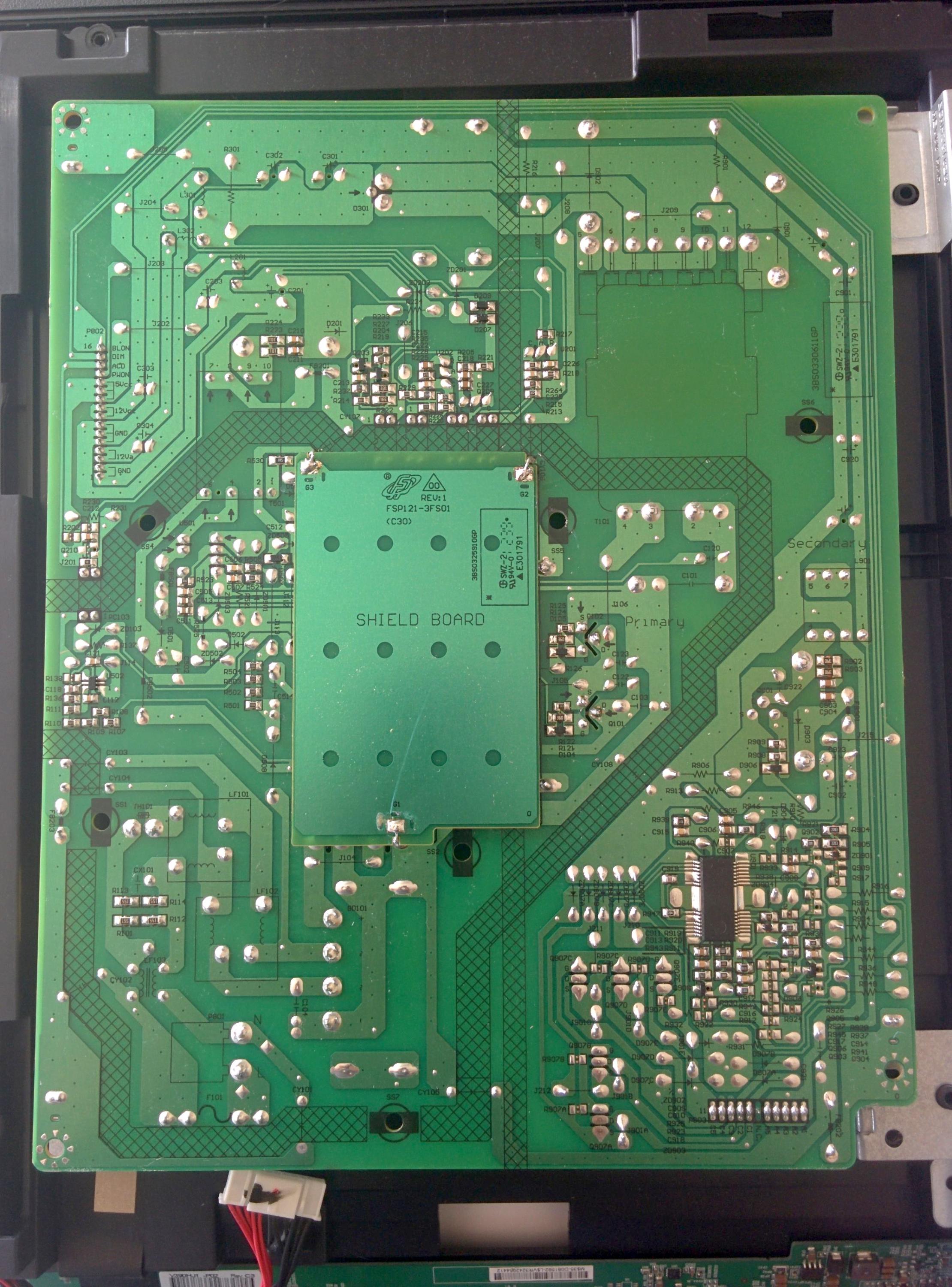

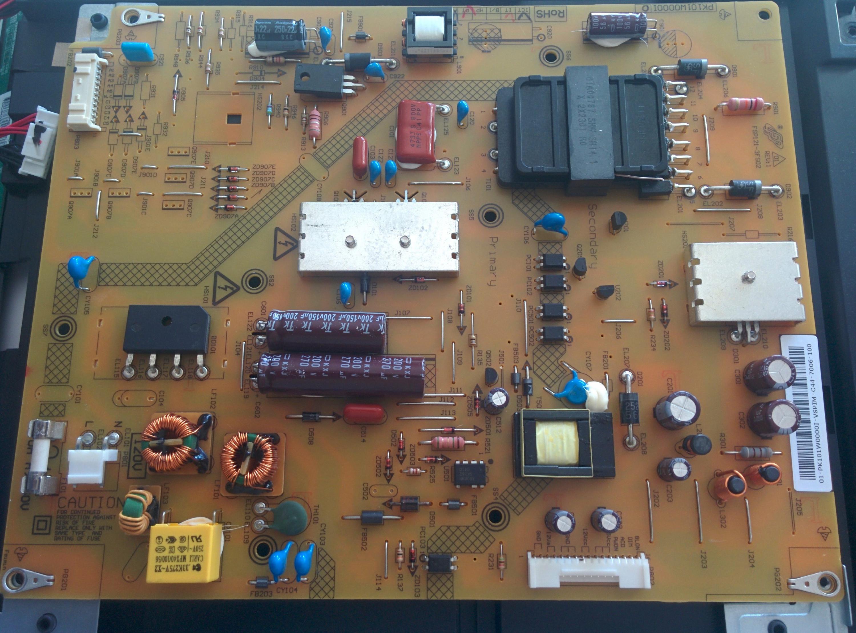

          Re: 39L22U Toshiba LED TV
          PSU front and back.
            With the 5V being back on the PSU and the mainboard plugged in, does the STBY LED do something on front of the TV when you try to turn the TV on?
            How the flow of power goes:
            The PSU has 5V STBY, that is always there, regardless. That goes to the main board. When you turn the TV on, that is get sent back to the PSU to PSon and BLon, turning on the whole power supply and the backlights.
            So what you want to do here is to measure the PSon voltage, to see if there is a main board problem or not.
            To check the PSU, unhook everything but the backlights from the PSU. Take two 1k Ohm resistors and jump 5v to PSon and another one from 5V to BLon. Once you plug the PSU in, all the voltage rails should be up and the backlights should be on.
            I still wonder if something else is shorted on the PSU. It just would be too nice for the fuse to fail.

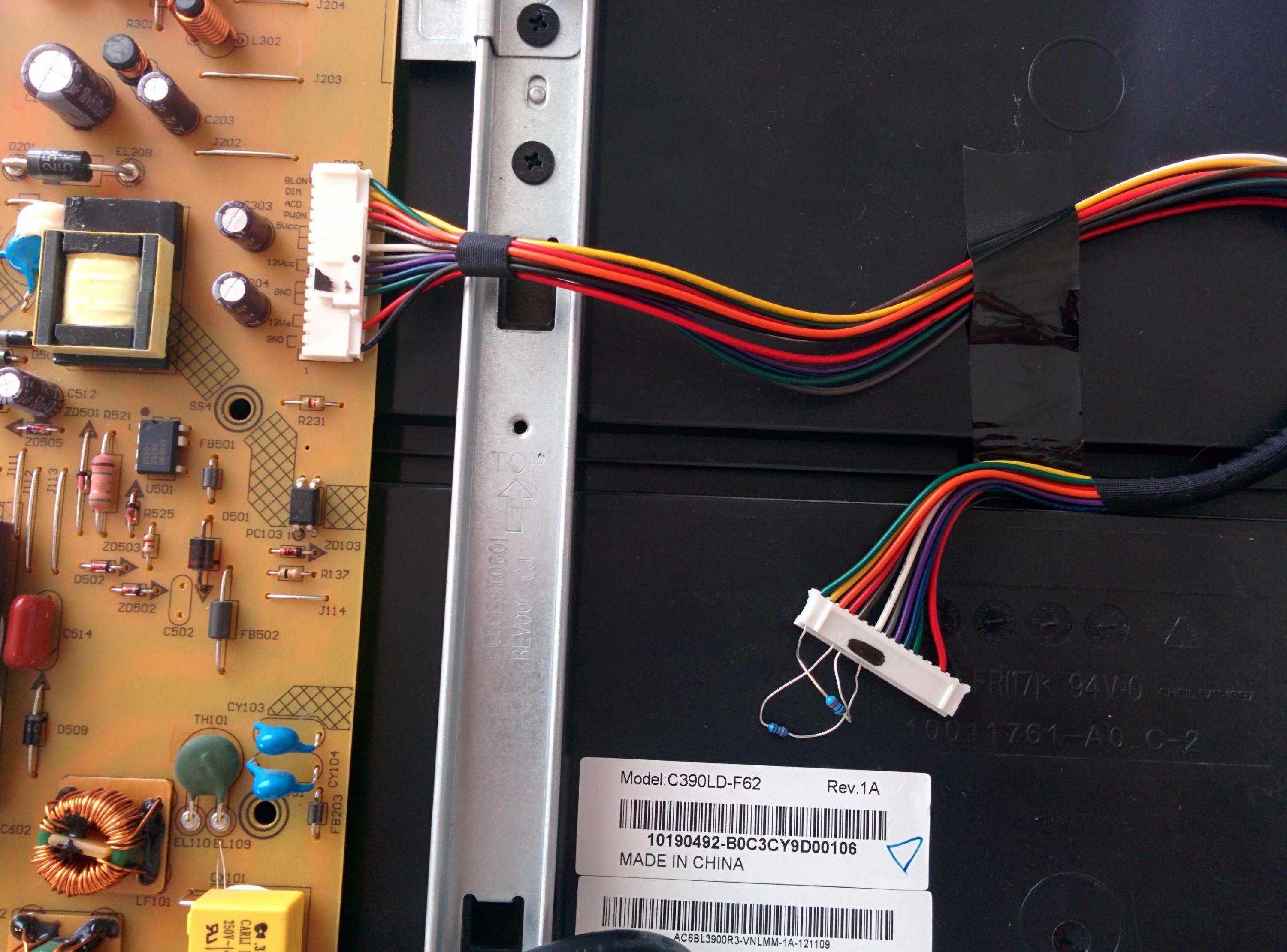

                I've inserted 1K ohm resistors from the 5v connections to BLON and PWON and no light comes on.

                    #29
                    Yes.. I've just taken the end of the ribbon from the PSU that goes to the video board and inserted the resistors to the plug. Essentially just making a direct jumper to the PSU.
                          Is my connection in the picture above correct?

                            #33
                            I can't tell, as there are 2 green and 2 red wires. You have to trace them and make sure they are correct
                            However, now check all the voltages and post them with the pinout. Are the backlights plugged in and are they on?
