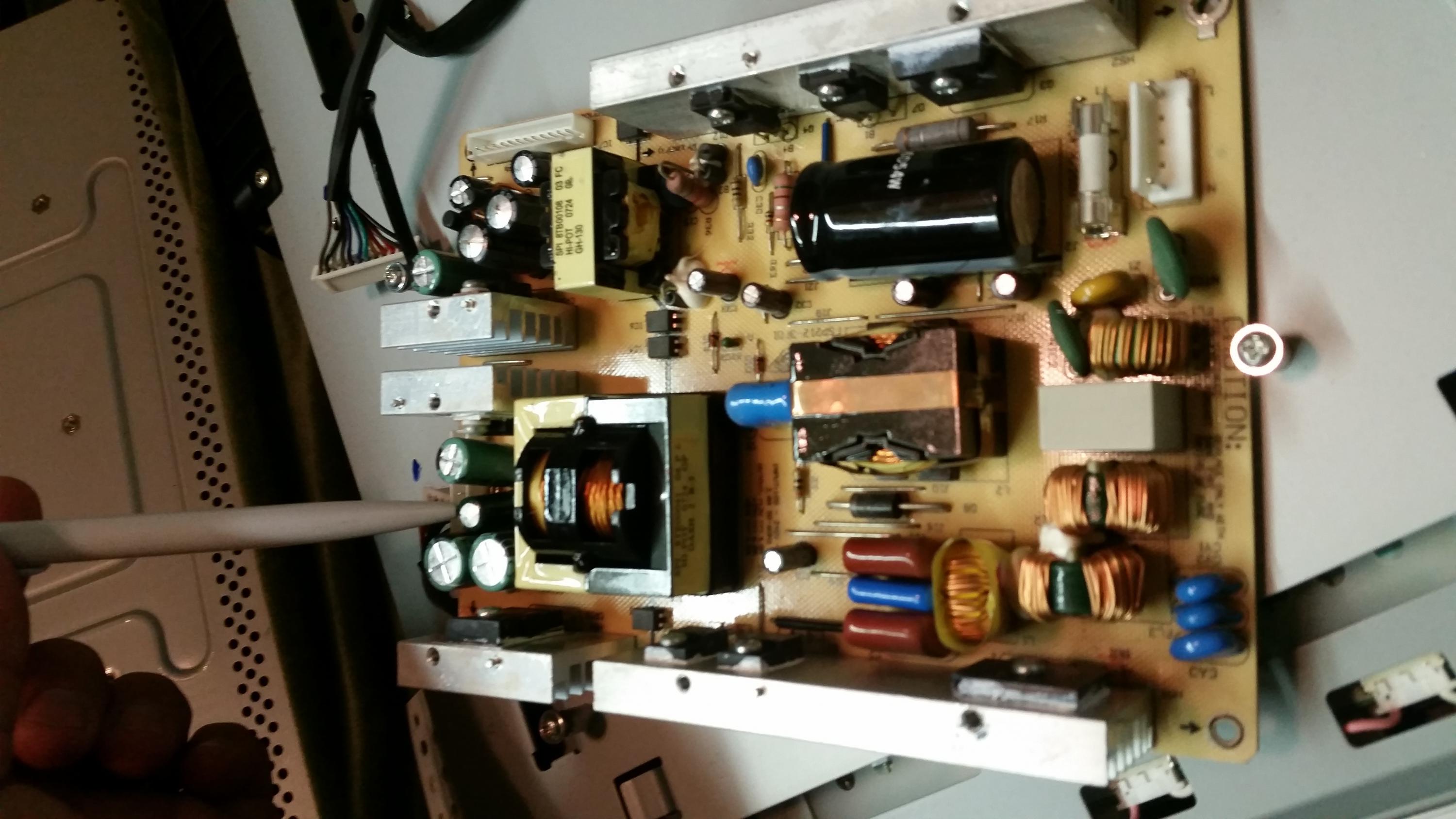

Viewsonic N2635w cap. question
  • tram704
    • Aug 2015
    • 12
    • US
    Viewsonic N2635w mod. VS11769-1M
    I have a few noticeable bad caps. I can tell voltage and uf on all but the one in the picture(white ink pin pointing to it). I know I can order kits or individual bbut want to make sure I get the one in question correct size. This cap is sitting in CS19 on board. Can anyone tell me correct cap size. Thanks
  • Lumberjack777
    • Dec 2010
    • 464
    Re: Viewsonic N2635w cap. question
    What you need to do is to desolder it from the board and see. Sometimes when they are surrounded and pinned in, it's the only way to read the value. When you are putting them back in, make sure they cap goes in the right way, as they have polarity (+ and -)
