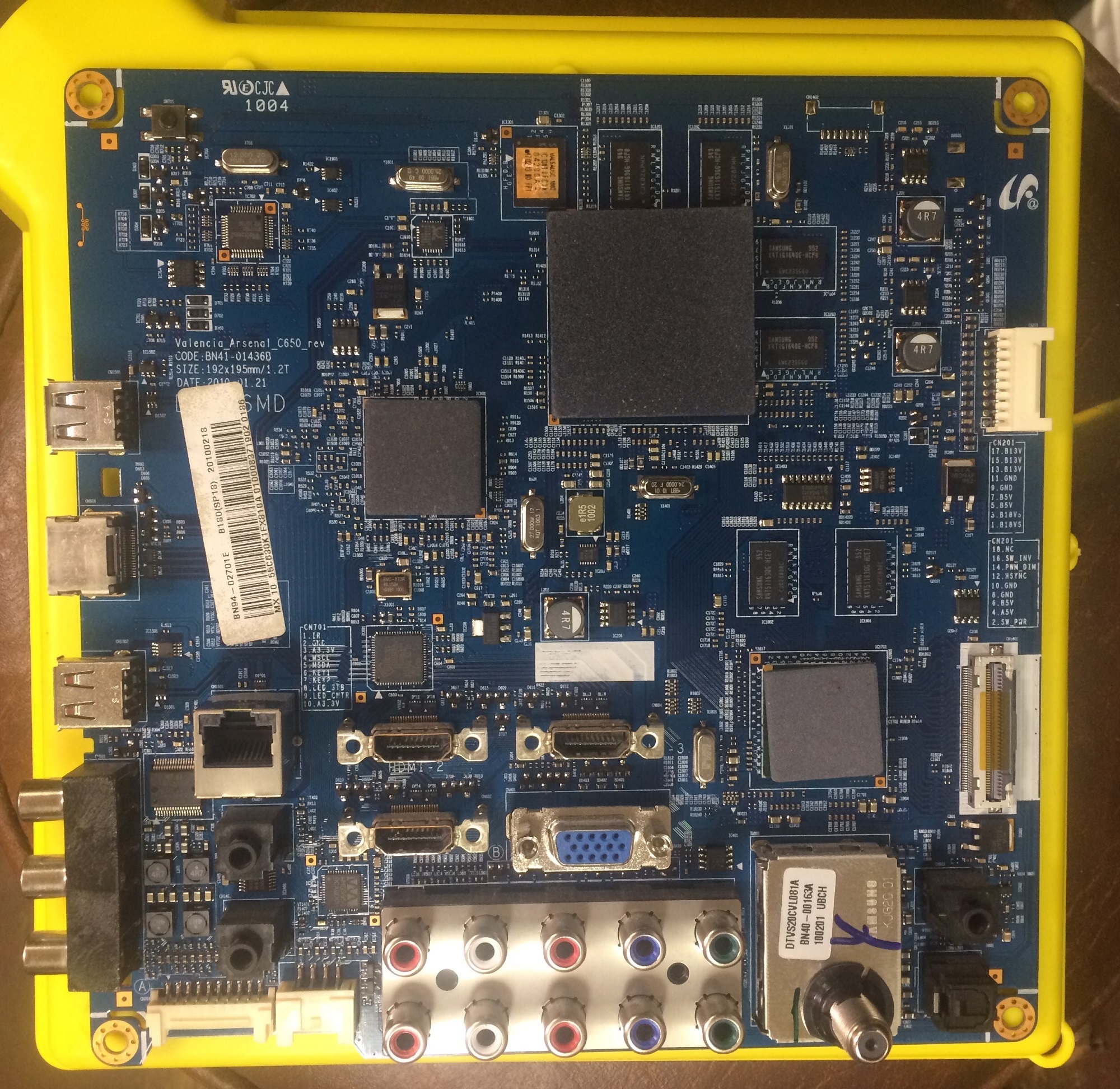

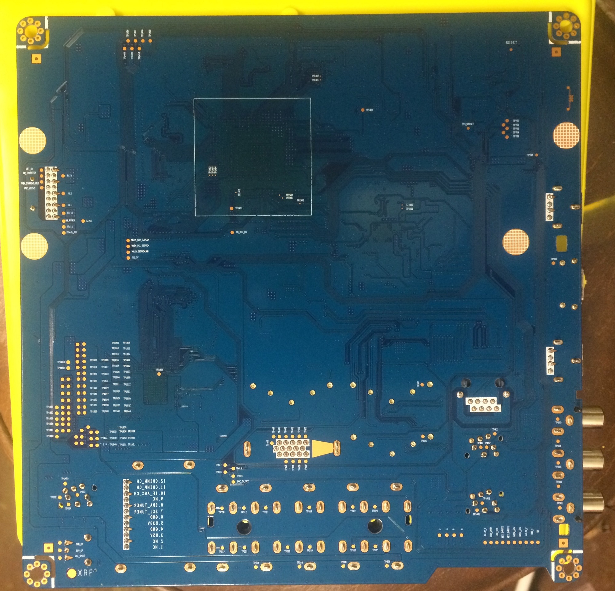

                Ummm... if you don't mind, upload some hi res pics from both sides of the main board? Maybe me or someone else can "see" something
                • Captain1511
                  • Aug 2015
                  • 6
                  Re: Samsung LN55C630K1FXZA
                  Attached is a picture of the front and back of the main board.
                    Well, I don't see anything obvious. I looked at the fast track SM for this TV.
                    http://www.toms-service-manuals.com/...h=Submit+Query
                    Maybe look at the low voltage supplies mentioned on page 2.
