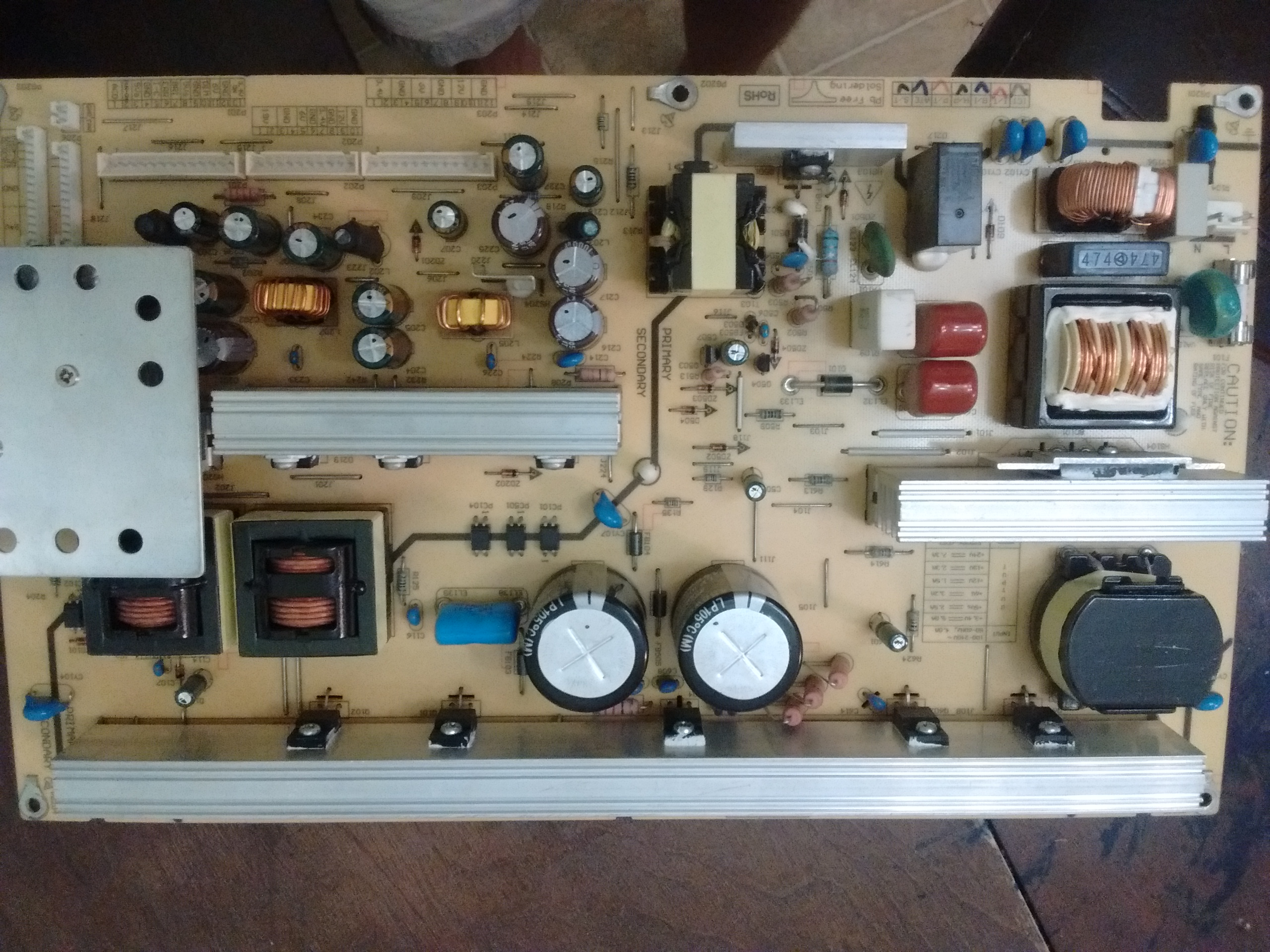

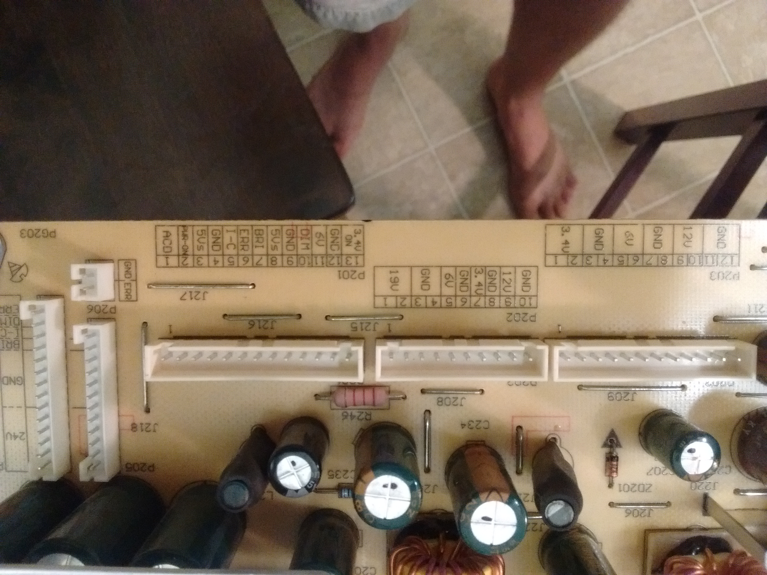

    Re: Lg42lb5 no standby or turn on
    Here is psupply pictures, I have no voltage at the 5vs or anywhere, what could be bad.
      No voltage on main filter caps

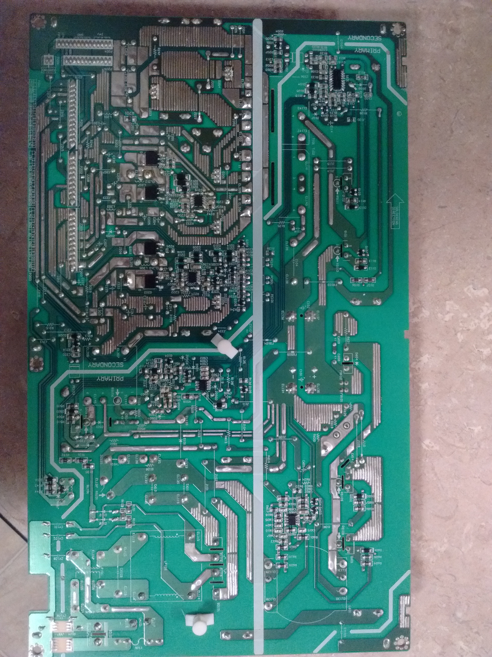

        so there is really nothing on those 2 big black caps on the bottom? Make another picture of the backside of the PSU.
          No voltage on two large caps
            Back side of ps
              check fuse F101. If that is ok, check the bridge rectifier (4 legged thingy mounted to the heat sink).

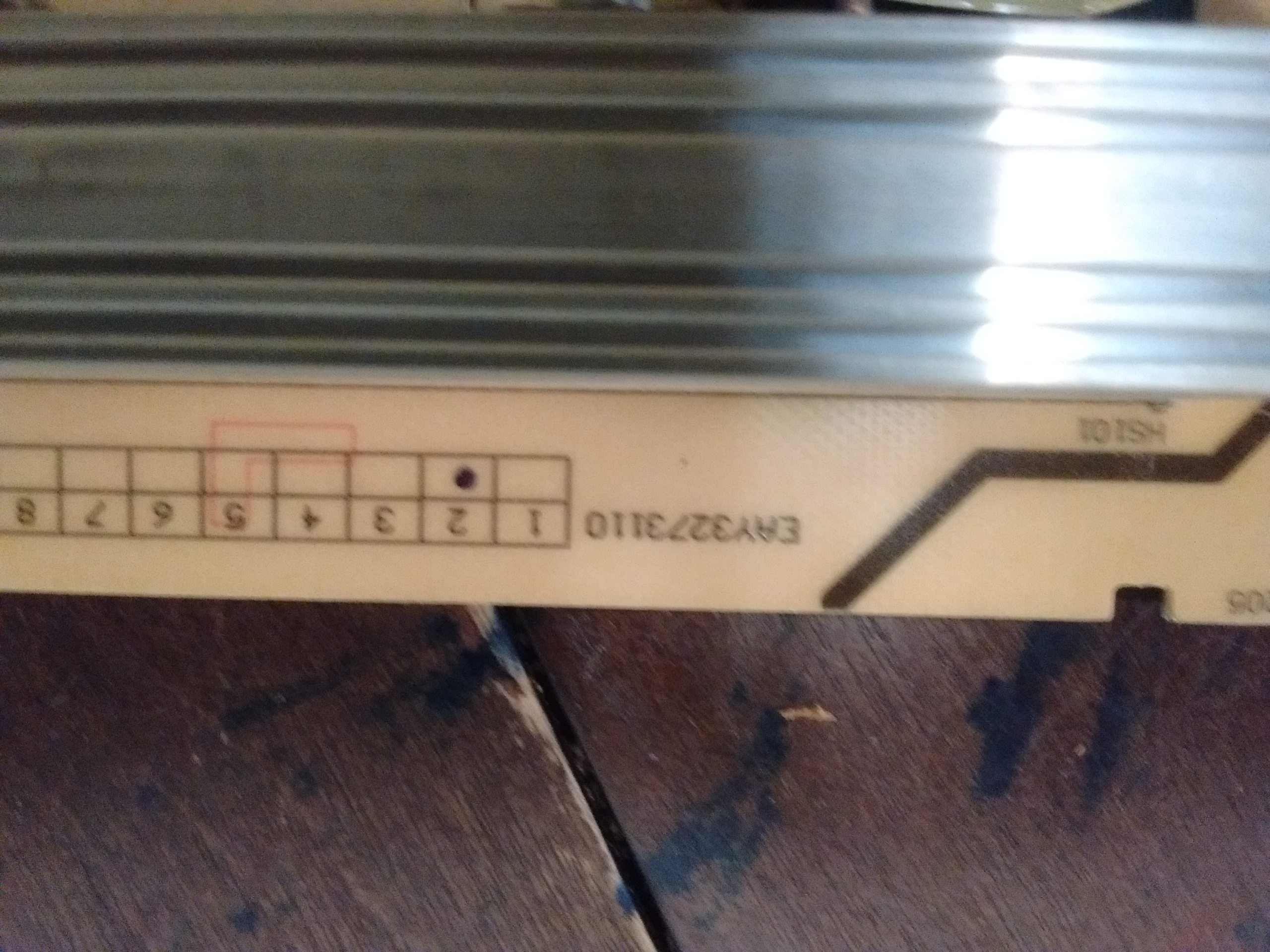

                                      Board is eay32731102
