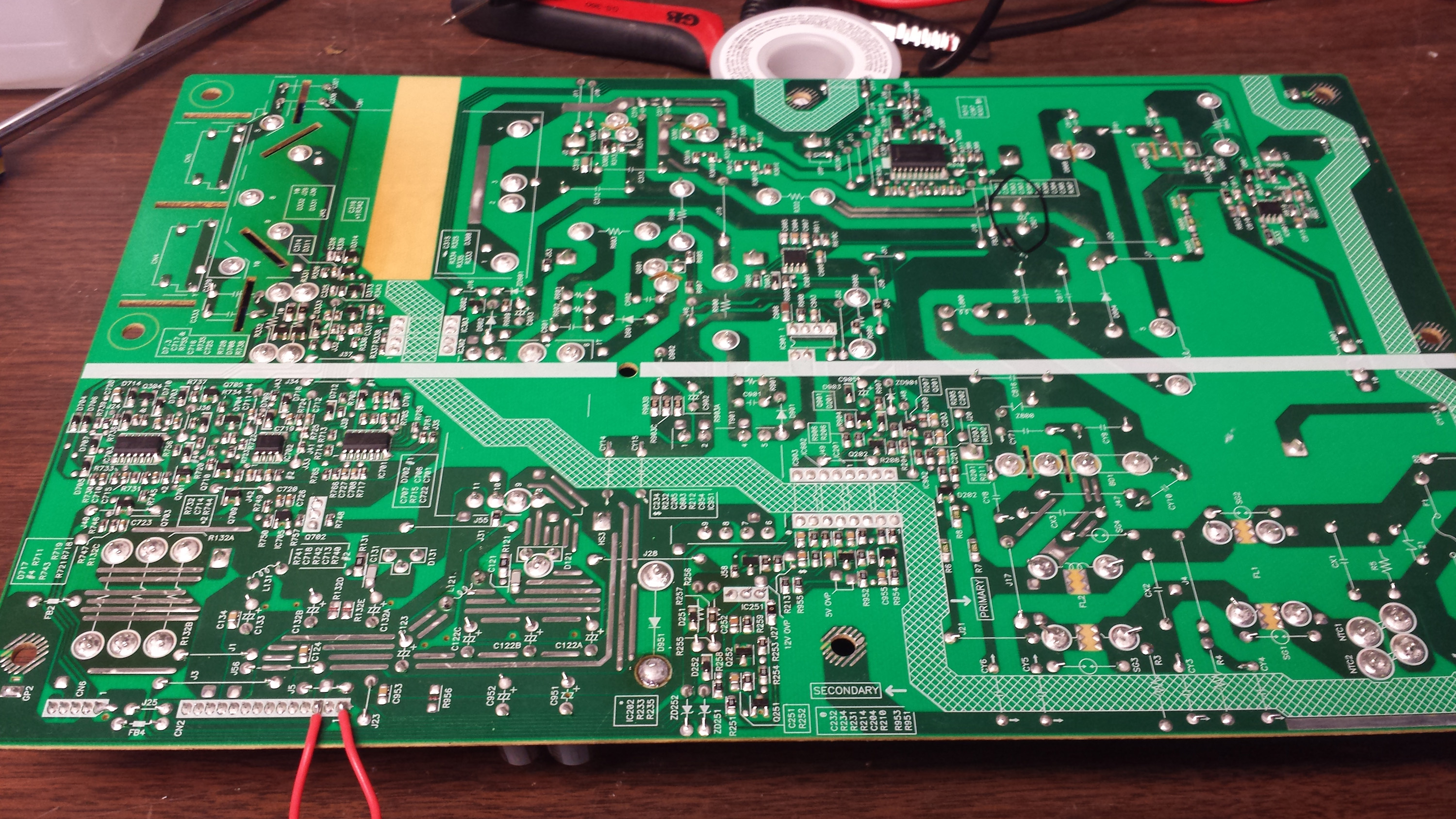

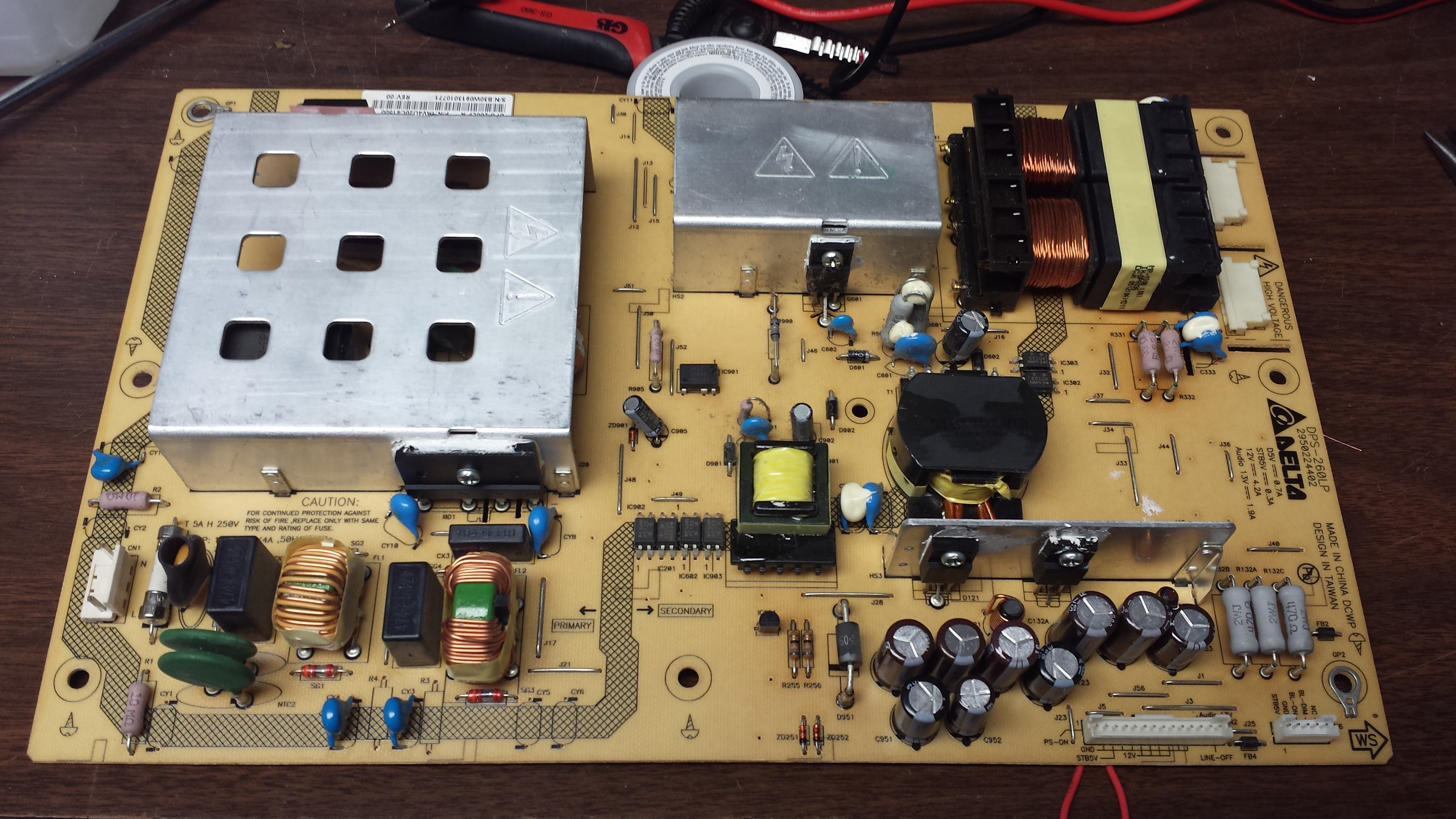

    Pictures component/trace side of power supply board.

      Re: Sanyo DP42849 - Power Supply Issues DPS-260LP
      yep. force the psu on without the main board and see if all voltage rails come up
              trace the stby voltage rail from the pin back to the secondary of the transformer. Check cap and diode. if that's all good, you have to check things on the primary side. So be very careful there. Kind of need to find a schematic, or you have to trace it.
              Look at D951 something drew a lot of current and it got hot.
                Don't mean to jump in but I think i have a ps problem as well. The ps board is the same as pictured above. My bl-on only has 2.4v I think it is suppose to have 3.3v. I can see picture after powered on for one second then it goes black, sound is good. I just so happen to have a second main board from another set that I tried to see if the main board was preventing the bl-on voltage to be low. There was minimal change in voltage. Gained .1v with second board.
                      Wondering if anyone has found or had this problem power supply board burns resistor R1 and R2 ???
                        http://www.shopjimmy.com/catalogsear...t/?q=DPS-260LP
                        LP or LPB?
                        R1 and R2 are the through hole 10M Ohms resistors as I can see in the pictures, is that right?
                        What is the board not doing?
