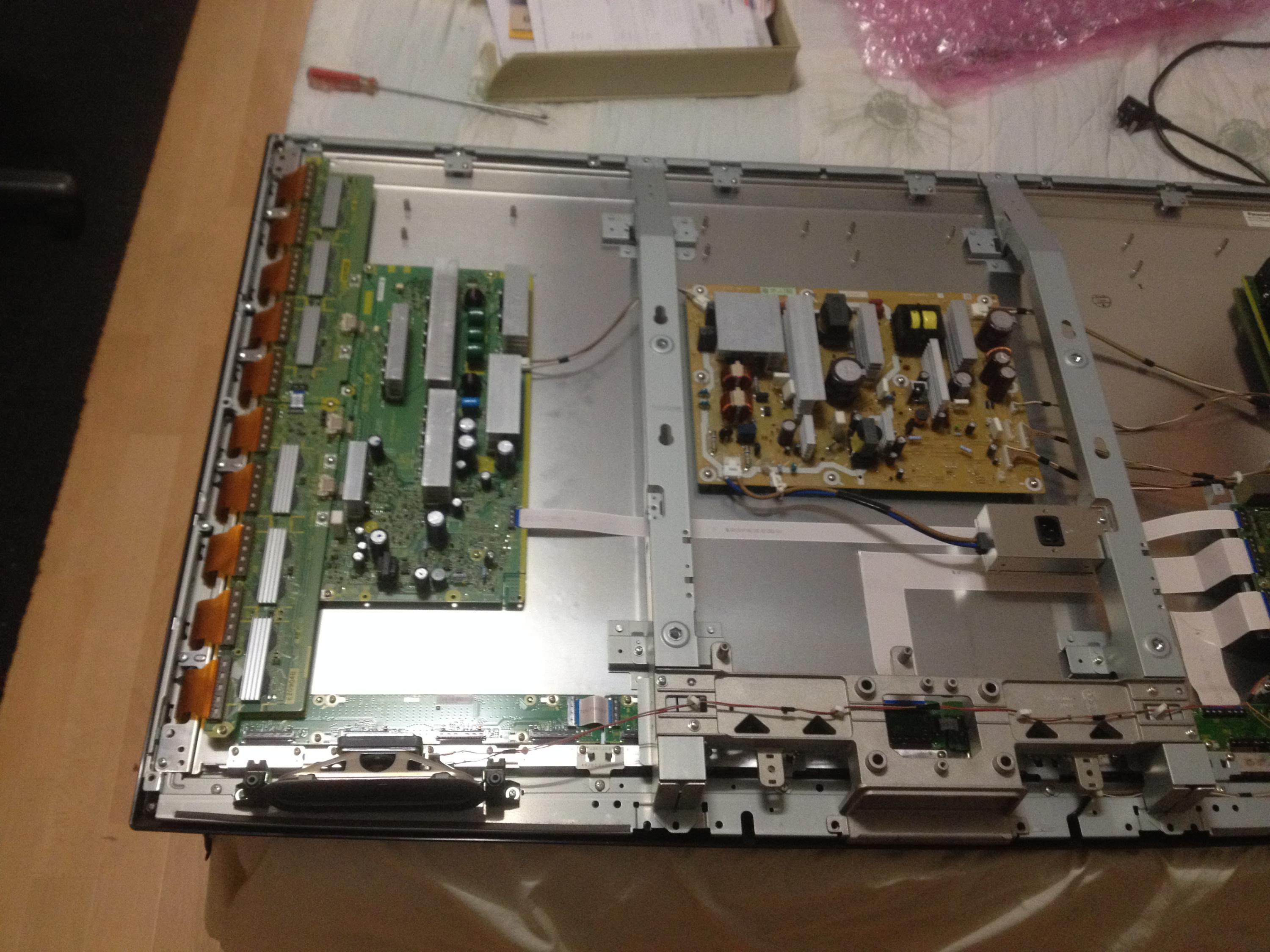

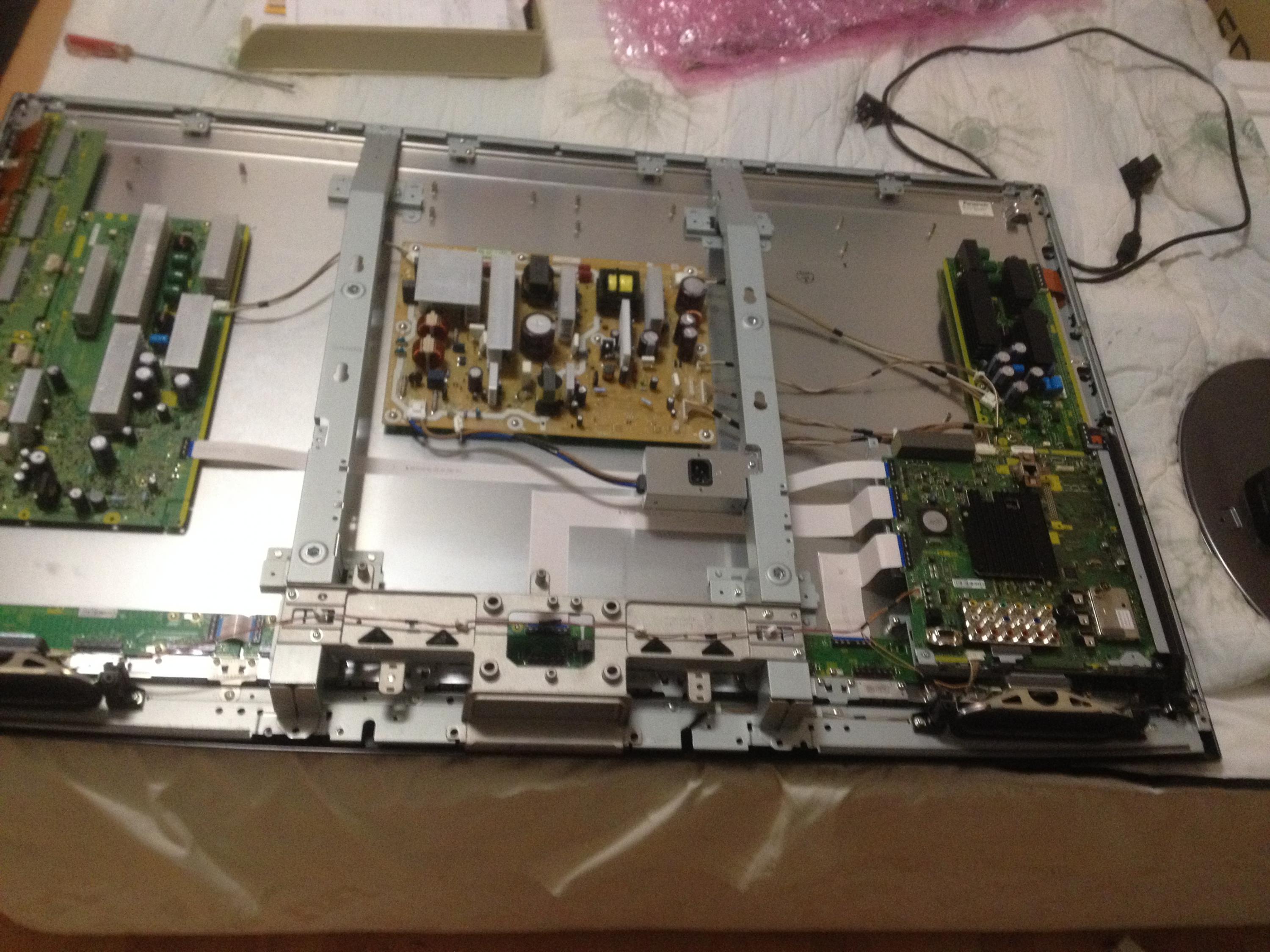

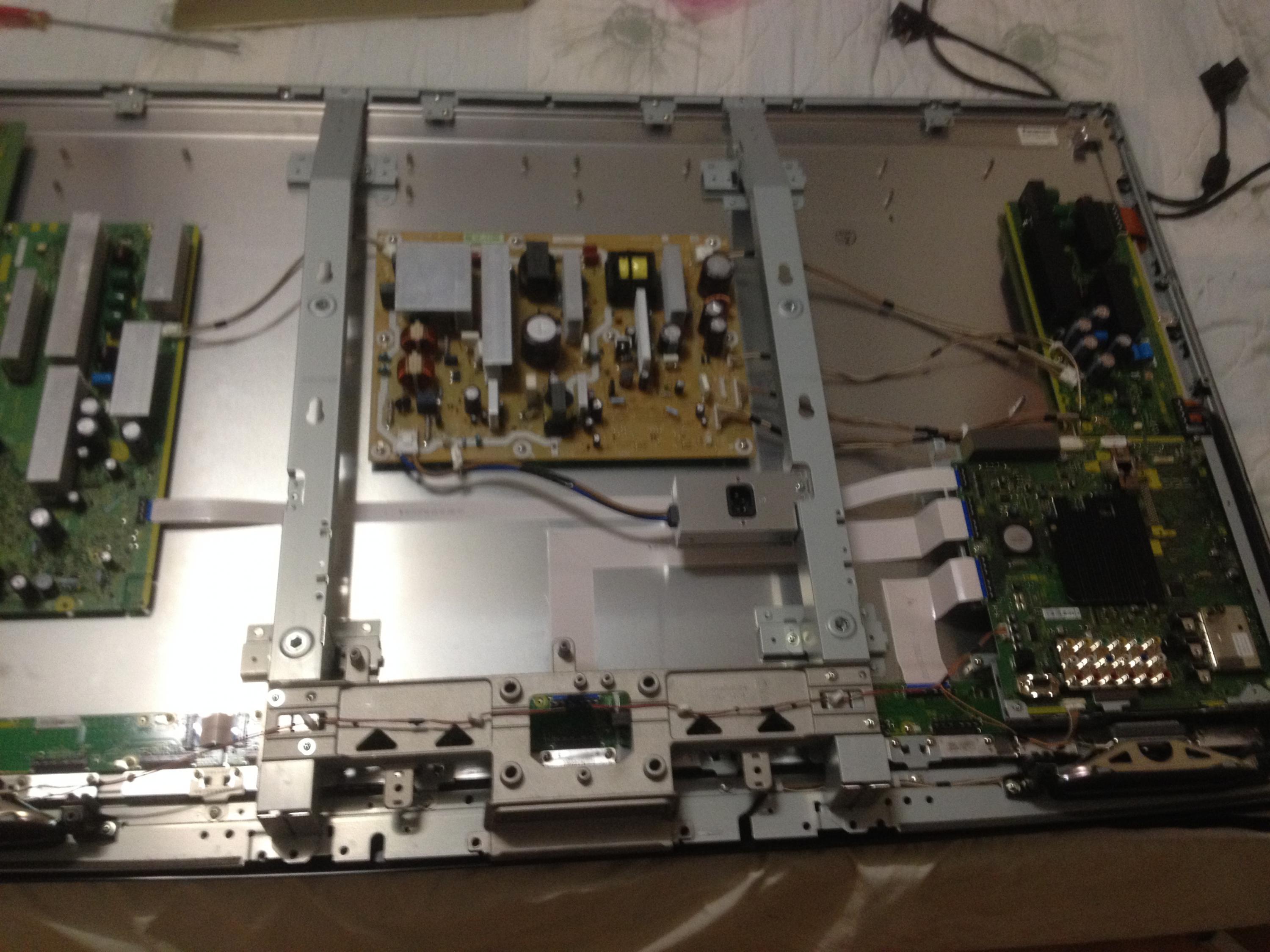

    Hi All,
    my tv model is Panasonic plasma TH-P50VA20A. It got 7 blink fault and the repairer said that it was the SC circuit board fault but he does not have part for it.
    The SC circuit board was TNPA 5081 AF. I managed to find a similar SC board model TNPA 5081 AY (it comes with the other two boards attached to it, sustain and buffer). I replaced my faulty one with the one I just purchased (the whole set of three).
    However, now I have four blink fault. Is it suggesting a power board fault? is there a way I test it?
    When I unplugged the connections to the SC board, I then got 6 blinks. When I plugged them back in I got 4 blinks again.
    I attached here the photos of the
    SC/sustain/buffer set, power board and the whole back of the TV photos.
    Thank you very much in advance for your help.
    I have read other posts here but have not been able to figure out what to do.
    Van.

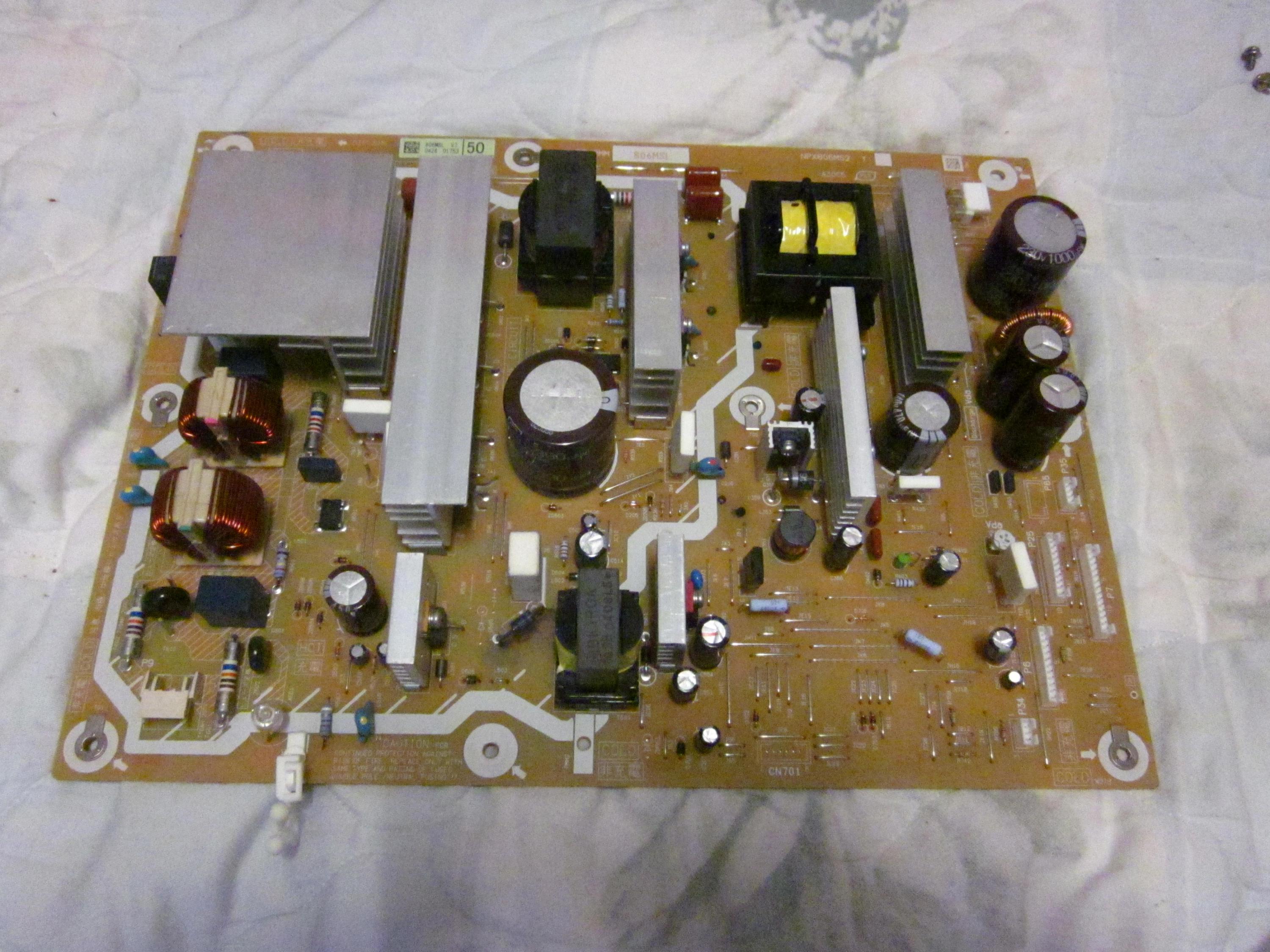

    Here is away to self test the P Bd so you can be absolutely sure it is good.
    Build a test-jig by connecting two (2) 220V 100W light bulbs in series so that the two (2) wire ends can be connected to a circuit.
    Follow these steps in order:
    1. Disconnect all the connectors to the P Bd, except the AC input connector.
    2. On connector P7 connect a1kOhm resistor across pin 1 (StBy 5V) and pin 5 (F-StBy-ON).
    3. Connect another 1kOhm resistor across pin 1 (StBy 5V) and pin 7 (Panel-Main-ON).
    4. On connector P35 connect a wire to bridge pin 1 and pin 3.
    5. Connect the test-jig across connector P2 ( Vsus output voltage and chassis GND).
    6. Apply the AC and the test-jig should light up.
    7. Measure the DC voltage across connector P2, it should read approx. 192 Vdc.
    8. Observe the intensity of the test-jig. If it starts to dim then there is a problem with the P Bd. If the intensity remain then the P Bd is OK.
    9. Measure the other output voltages on connector P7 15Vdc etc. (Nerves of steel required)
    NB: a. Be careful not to short any pins on P7 when making solder connections.
    b. Look at the connections for shorts and rectify before applying AC.
    c. be careful DMM probes do not slip while making voltage readings.
    d. If Step No. 8 passes the test then confidently diagnose the A Bd as defective.
    Good Luck and remember BE CAREFUL!!

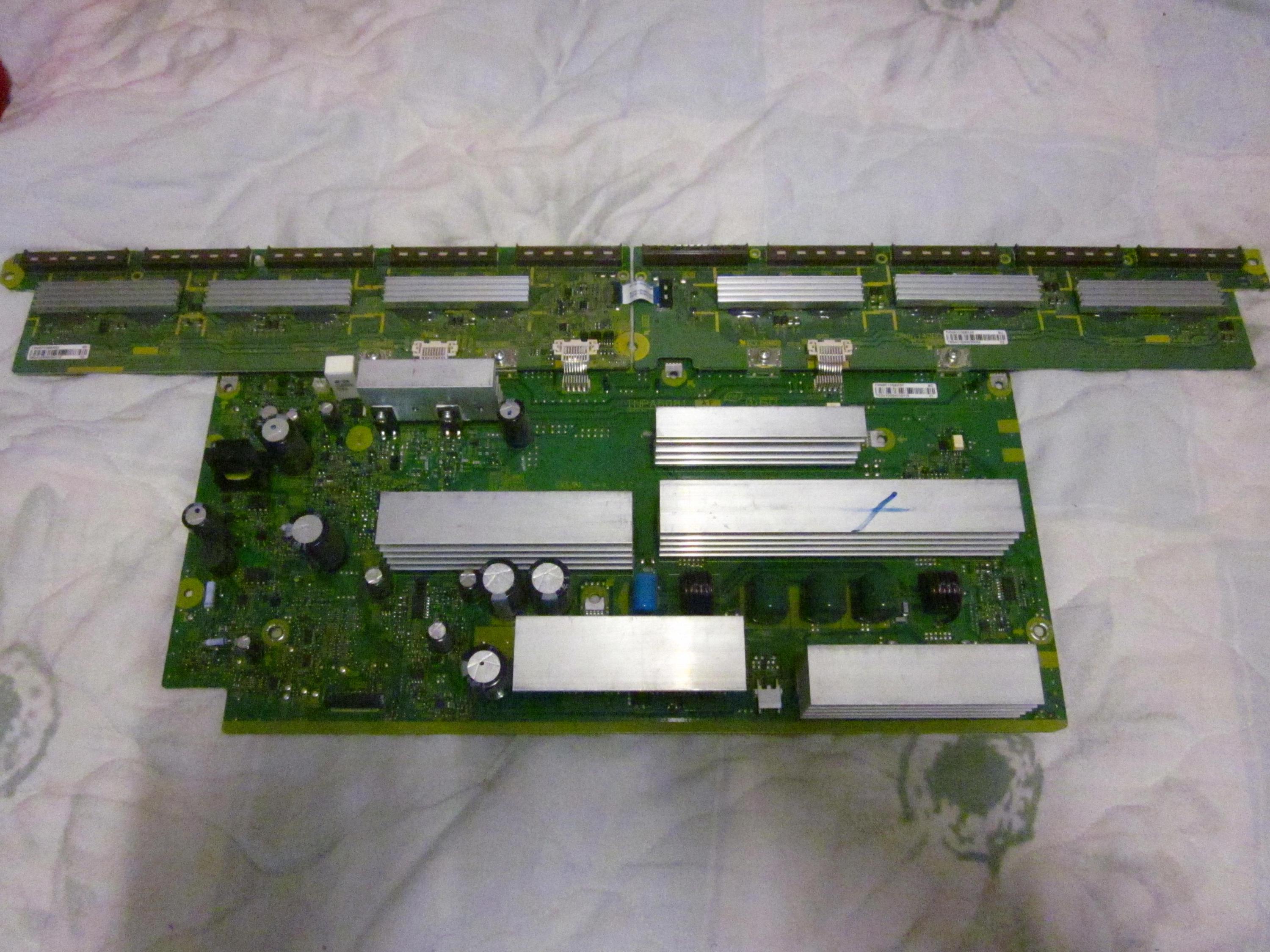

          I have attached here the SC board and the P board taken using a camera.
          I still have my original board as shown in the photo.
          Please let me know what to do next.
          Van.

            If the replacement p board is identical part number as the original then it may has well be left unless you can return it and get some money back.
            Did you check out he AY revision SC and see if Sc2 was shorted out?
            The tech has stated Sc is bad, 7 blink but let's not assume.
            You can
            a. go to that guide and locate the resistance checks for the sd/su boards and see what you get, they'll need to be isolated from the SC and each other. A decnt meter that can autorange and get to about 6 megohms would be handy
            b. re-install the SC without any buffer boards, make sure the board is bolted in, i.e earthed, sc20 and sc2 leads connected
            make sure all other boards and leads are connected as normal.
            on the SC, there is a 2 pin connector SC50, short those pins together, then turn the Tv on and see what blink code it gives or if it goes solid green.
            This is test is also outlined in that guide

                      yeah, ok. so the Ay board is your 4 blinker, dead short on the Vsus
                      765 ohm is bad, what range is the meter set to or is it auto ranging?
                      Typically you'd see 300 k ohms on first probe, take them off then probe again and it can then change to megohms.
                      On your AF, Q661, it's a RJP63F3A are those legs shorted when you probe any 2 legs? heatsink with 2 transistors next to Sc50 connector

                            If you want to confirm A & P are ok this is what i do. disconnect Sc2,SS11, P35, 3 white ribbons at the A board. now turn on, should see the TV start blinking green then lock on solid. that's a pass , don't run for more than 30 secs or it will shutdown with maybe a 4 blink due to no load on th P board.
                            don't connect any of those leads again for at least 5 mins so the power bleeds off or you can spike the boards especially P35 which feed to the panel via the C boards and will not then be repairable
