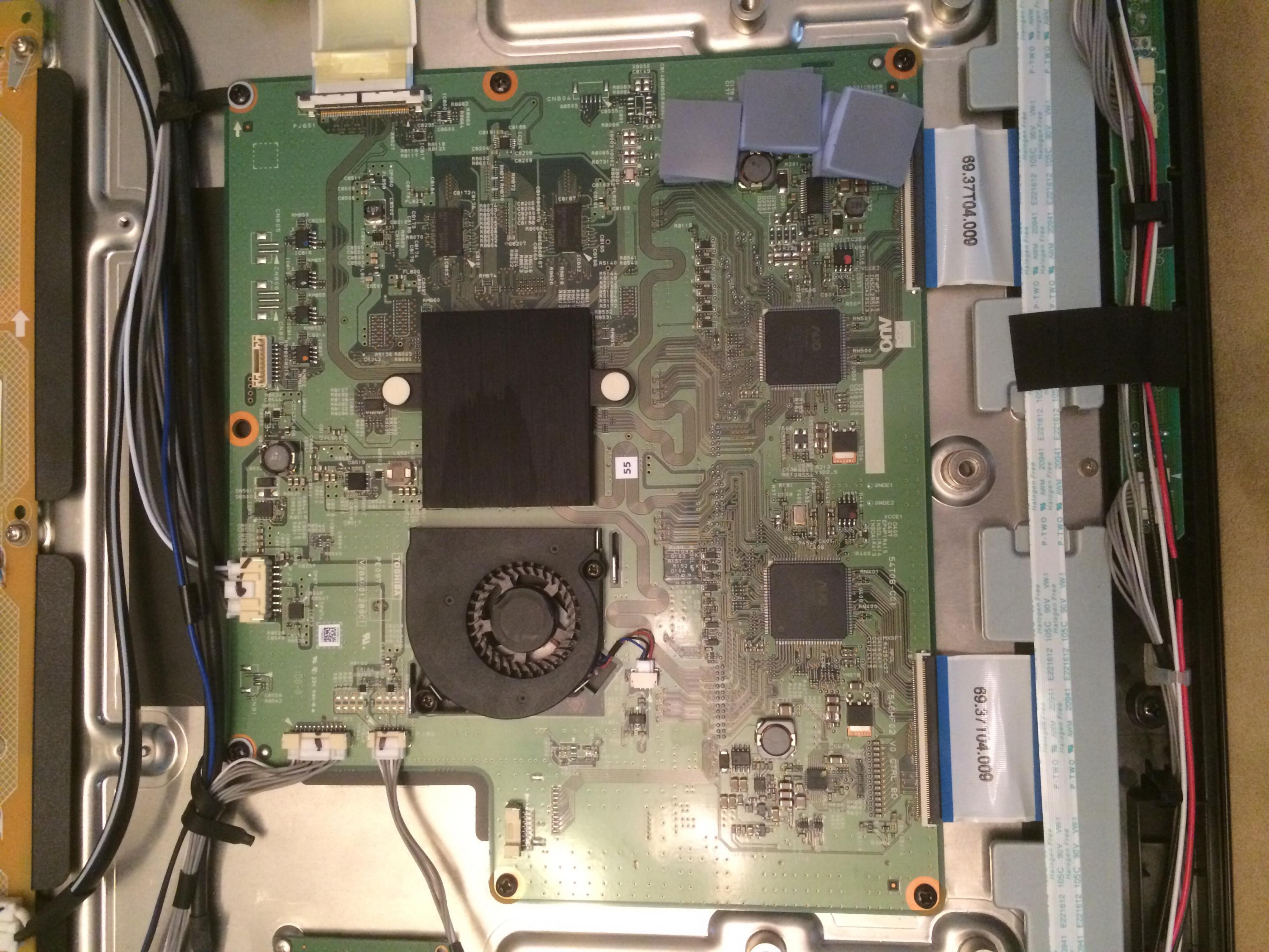

          I checked the fan and there are three wires going to it. A black Blue and Red. I'm guessing the blue wire is the tach? I'll post a pic in a few minutes.
          • KevinCro
            • May 2014
            • 104
            Re: Toshiba 55ul610u blinking blue power light
            Here is the whole board. Any guess why all those thermal pads are stacked up in there like that. That's the way it was when I first pulled the cover off.

                  The Blue wire may be for the ROTOR LOCKED error signal line, check the DCV between GND and Blue wire when the fan is running, then try stopping the fan to see if the DCV on the blue wire changes state. I cannot find the spec of the FAN so I do not know if HIGH on blue wire is normal or LOW is normal, but that does not matter because it should change state when fan is forced to stop.
                    With the fan running I get 45.5 volts. With it stopped I get anywhere from 2 to 3 volts.
                    • KevinCro
                      • May 2014
                      • 104
                      I am getting the 5v standby and then the power tv goes high when I turn the set on. It seems that the tv is turning on. The cooling fan on the tcon runs. The backlight isn't turning on but I couldn't see an image on the screen with a flashlight. I'm willing to take a shot in the dark and replace a board. Any suggestions on which board is most likely the culprit? The blinking led is supposed to be a fan problem. So I'm guessing either a signal is not being sent to the main board to tell it the fan is running or the main board isn't properly receiving it. Thoughts?
