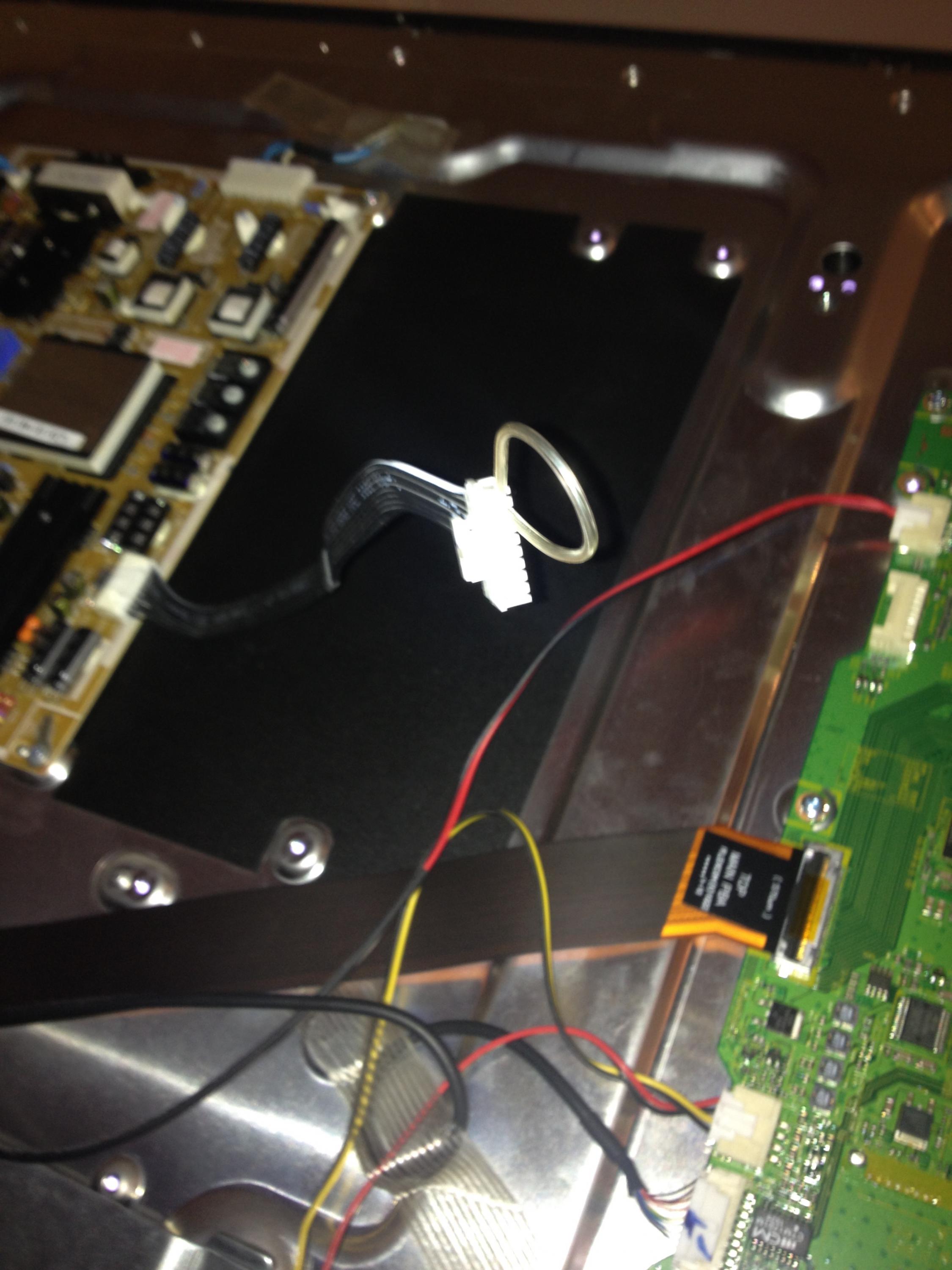

        Re: Samsung 46" LED Ua46C6900 : power on prob
        hmm, i had a look through your guide... im not sure what i should be doing im sorry.
        the return signal from the mainboard PSon is at 3v when its trying to powerup, and then just clicks, and drops off again.. should i remove the mainboard plug and jumper the standby and PS0n pins to try to turn it on without the mainboard in the loop ?
        I have tried isolating the problem by trying to turn on with each plug disconnected but nothing seems consistent. it looks like all the power supply pins are doing what they are supposed to when its attempting to poweron.
        With it turned on, I checked the BL and that was showing 4.9 and the DET too showing 5.3 and the PWM will move from .3v (backlight setting on 0) to 5.3 (backlight setting to 20 (max)
        Im wondering if i leave the backlight setting either higher or lower than it was on, and see if that makes a difference to the reliability of it turning on or off?
          "the standby and PS0n pins to try to turn it on without the mainboard in the loop ? " Yes but us the 470~1K resistor instead of direct connection in case you have accident so the current will be limit, but you MUST disconnect that PS-PON wire going back to the main board first. Try that and see if the TV will stay on with backlights and images on the screen.

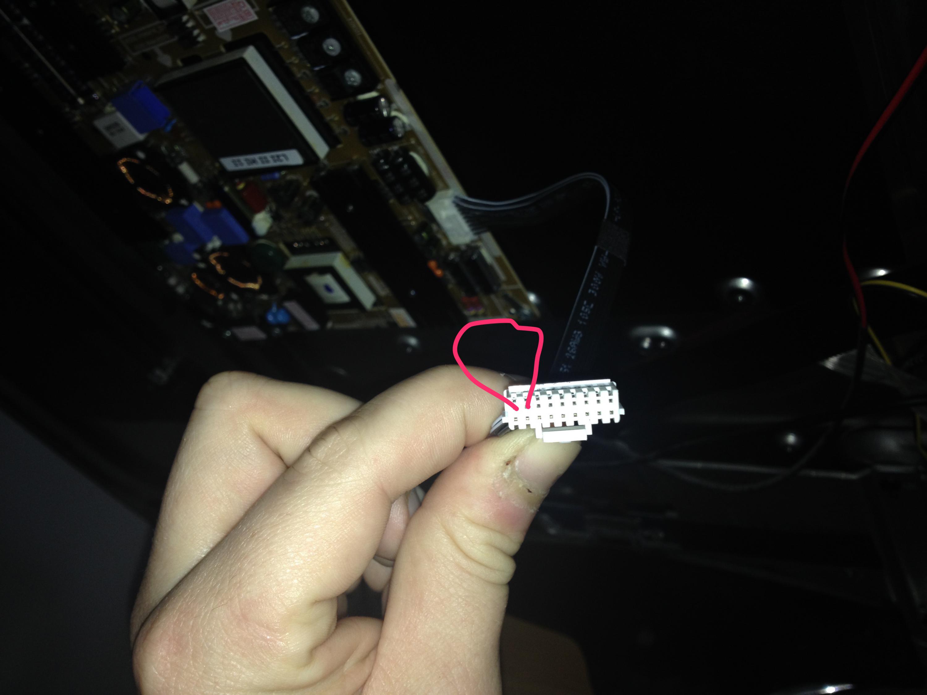

            ok, so i will disconnect the 18 pin cable form the mainboard,
            put a resister between pins 16 and 18
            try turn it on, see if it stays on without clicking and get backlights turn on etc.
              You will have that connector put back in place without pin 18 wire in place (the wire on pin 18 that you removed will then be connected to pin 16 through the resistor, so the main board will get the SB Voltage to run and also for the main board to be able to send the bl-on an di signals to turn on the backlight.
              If you do not have the connector plug in, then all you are doing is to force the power supply on only and the main board will be dead due to no power, if you want the backlights to be on also, then you will need another resistor to force on the BL PIN.
                Hmmm, but in the other thread, the guy did the jumper between pins 16 and 18
                https://www.badcaps.net/forum/showpo...7&postcount=26
                Going off their theorys, if i do that, i could turn the tv on, and the power supply should click but would it stay on, ? or would it do what its doing now, cycle on and off clicking its head off?
                  "Hmmm, but in the other thread, the guy did the jumper between pins 16 and 18" That is to turn the power supply on, he did not show how to turn on the backlights did he? Unless the BL-ON line is already has the pull-up resistor to make BL-ON pin HIGH. Try it as shown in that link and see if you will get the backlights.
                  When you force the power supply on by using the resistor, then the power supply should stay on as long as the resistor is in place to simulate the PS-ON signal.
                      ok when i got home tonight, i put a peice of wire between 16 and 18, stood back, plugged the power cable in. power supply clicked on, stayed on, backlights were on and it was showing blue on the screen. So is this telling us its somthing on the mainboard that might be the problem ?
                        #31
                        It is telling you that the main board is not sending the proper PS-on to turn on the power supply, and the BL-ON line has built-in pull-up resistor so it does not need the resistor for forcing on the backlights.
                        So you need main board.

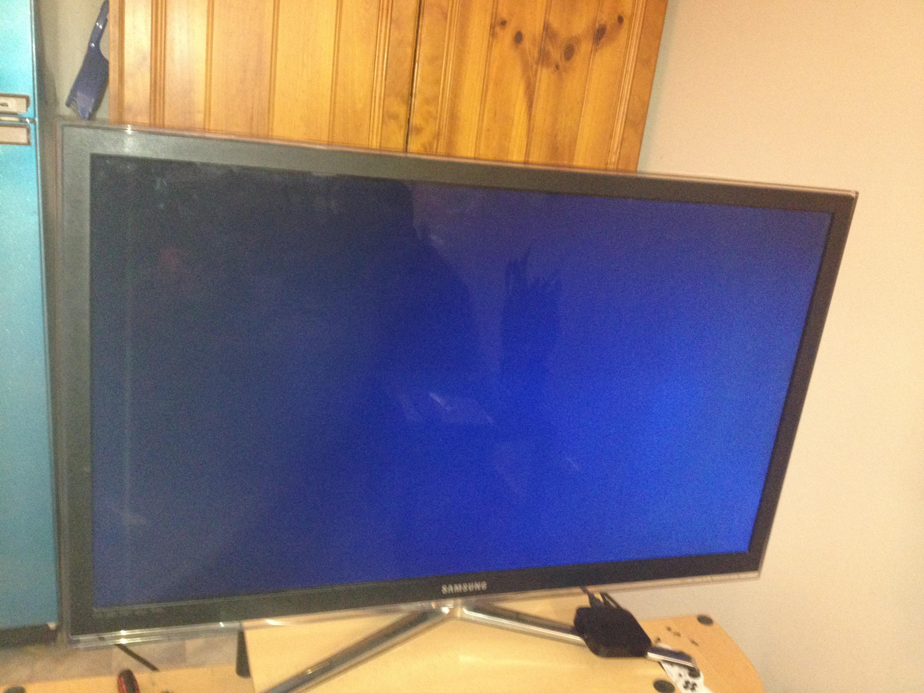

                                Bit of an update.
                                I took the mainboard off last night, took off the 3x stone heatsinks from the processors, pre-heated the oven for 10mins at 200degC
                                Then put board in the oven for 10 mins at 200degC.
                                I then turned oven off, opened the door and let it cool for 30mins.
                                Once i put it back in the TV, it powered on immediately when pressing power.
                                This wasnt too suprizing, as i had found unplugging it for an hour or so would generally work the first time after replugging it in.
                                Whats new is that, i was able to turn it off and on throughout the rest of the night without any issues.
                                I left it plugged in overnight (standby) and first thing this morning, it powered right up like its supposed to.
                                So, i wont get too excited untill its behaving itself for a few more days, but its looking promising that this may have fixed it.
