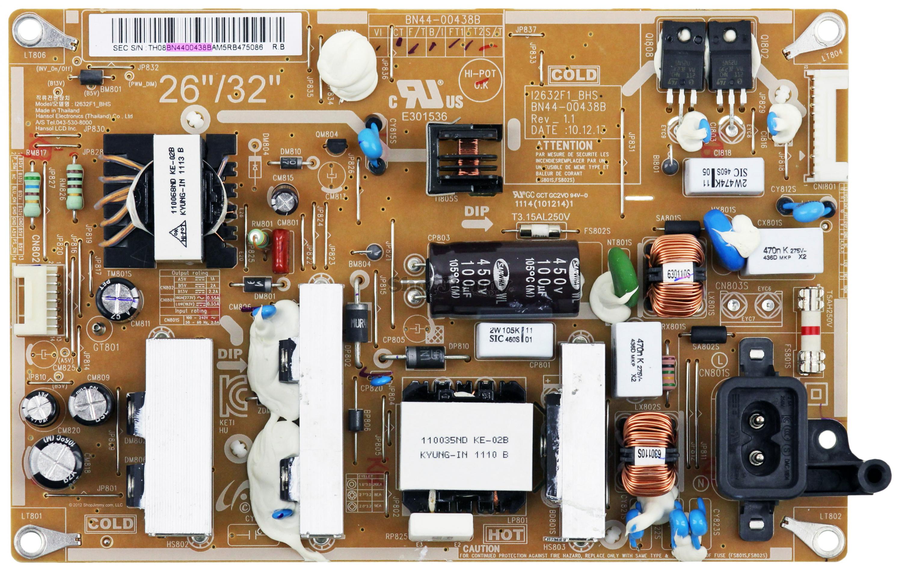

    Model LN32D450, Sound, no pic, picture evident with flashlight.
    History. Watching TV, went to bathroom, returned with no backlight.
    Turned off and on, picture returned for 5 minutes then black.
    Since then on power on, no backlight, no flicker on power on nothing but audio.
    Tried new inverter board off Ebay. no change.
    Measured DC voltages on inverter board. VCC =12v LD (whatever that is) 12V. 5V AC going to transformer module thingy inputs.
    Any suggestions on next steps for troubleshooting/measuring?

      Pic: Inverter board intentionally pulled out from CCFL connections.

              OK, I found good clear pictures of the power supply/inverter driver board atshopjimmy but it does not have the pictures of the bottom side of the board, I will the pictures to trace out the connections of the Inverter transformers driver circuit.
              Do you also get any DCV at the connector CN802 BLU_ON (backlights on) pin when TV is on?
              You also need to check the DCV between the two legs of the main filter cap CP803 to see if it has >360VDC when TV is turned on.

                No 360V on filter cap. 160VDC off, ~156VDC on.

                  OK, you need to find out then why you are not getting the PFC Boosted Voltage, you need to get that working first, the inverter circuit needs that boosted Voltage to work.
                  Check the Diode DP802, DP810, verify that you do have P-ON (PS-ON) signal on pin 2 of CN802.

                              Can I measure those diodes in circuit or do I have to remove them to check?
                                Re: Samsung No Backlight
                                You can test them in circuit for now, if the readings do not look right then you will remove them and test them off the board.

                                    Diodes check out good (~0.4Vf). Backlight not on when mainboard is not connected.
                                    Just need to figure out how to get the probe on PS_ON pin. Its on the RA connector with the pin in the back row. I will post a better photo in a few.

                                        Do those diode has MURXXX on the body? 0.4Vf seems low to me. Set meter to OHM mode and check the resistance both ways with the meter.
