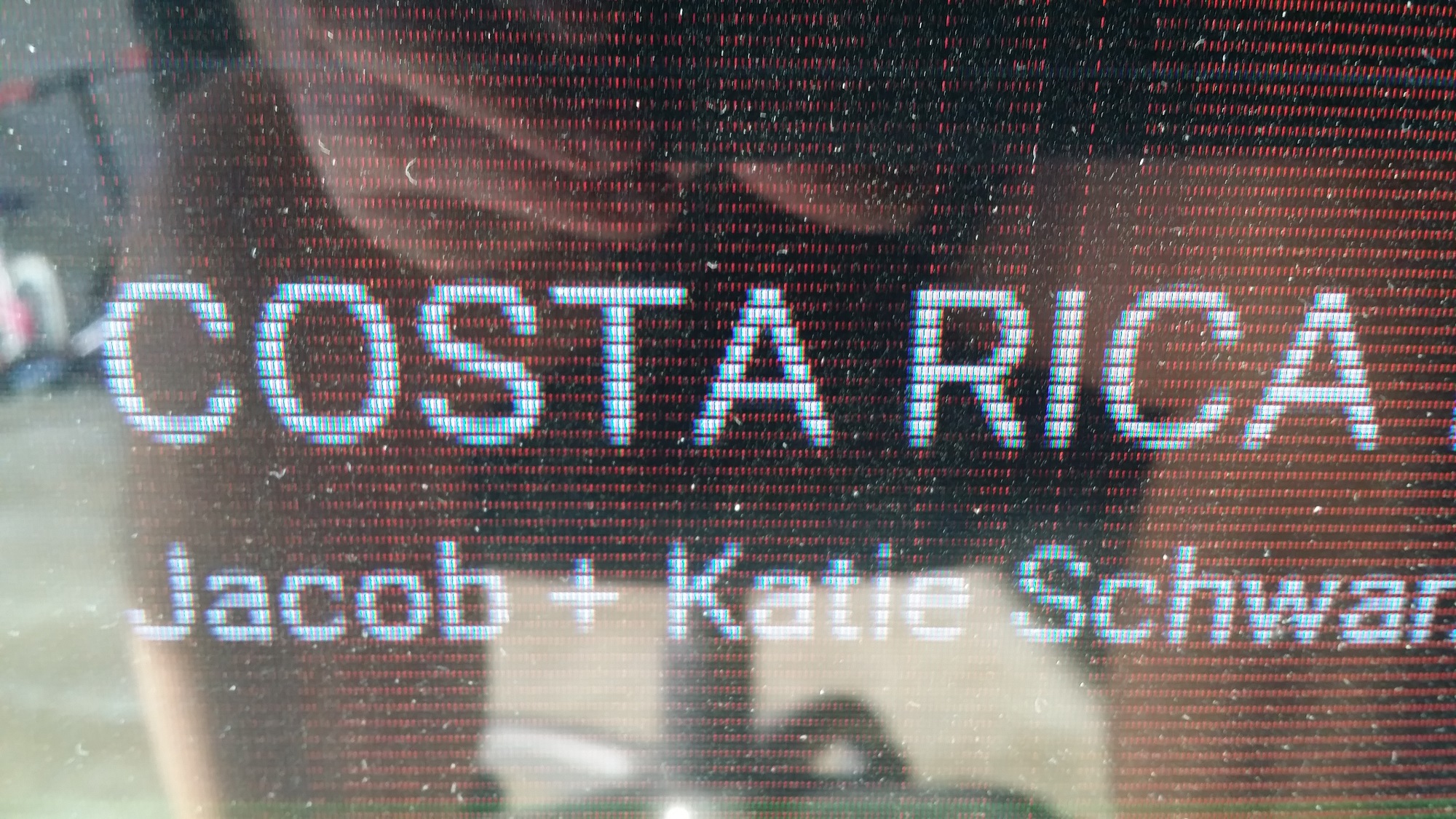

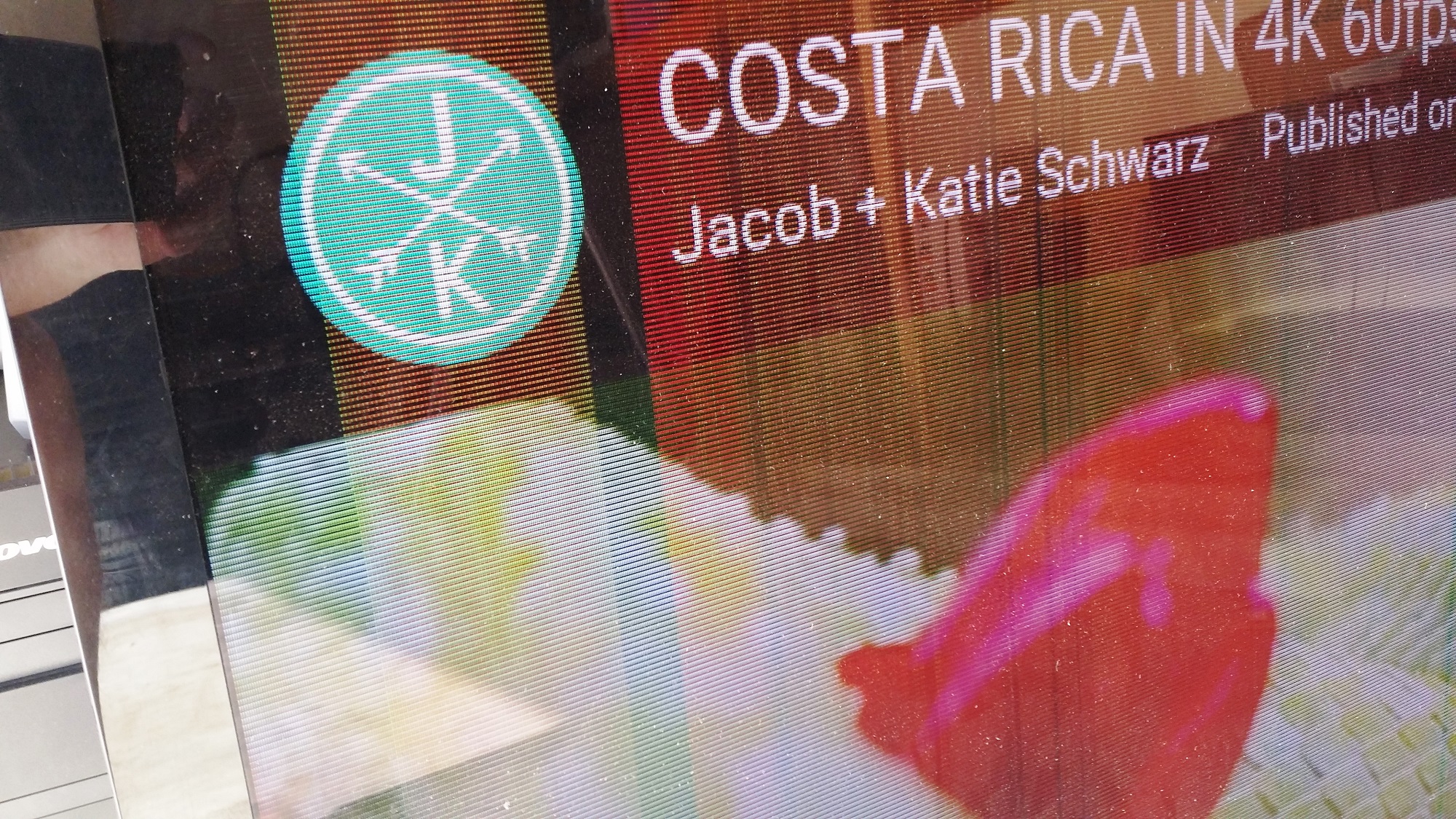

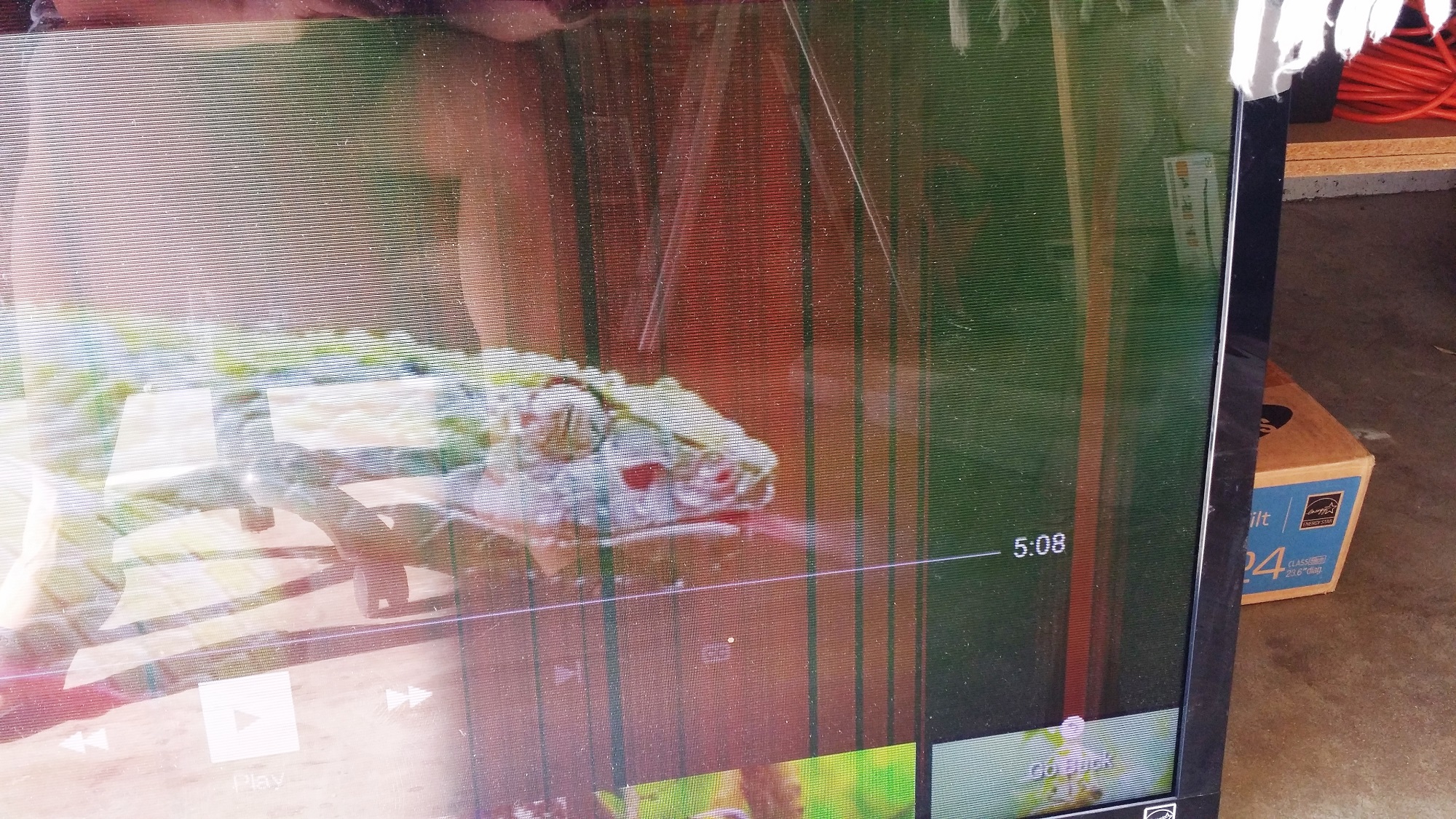

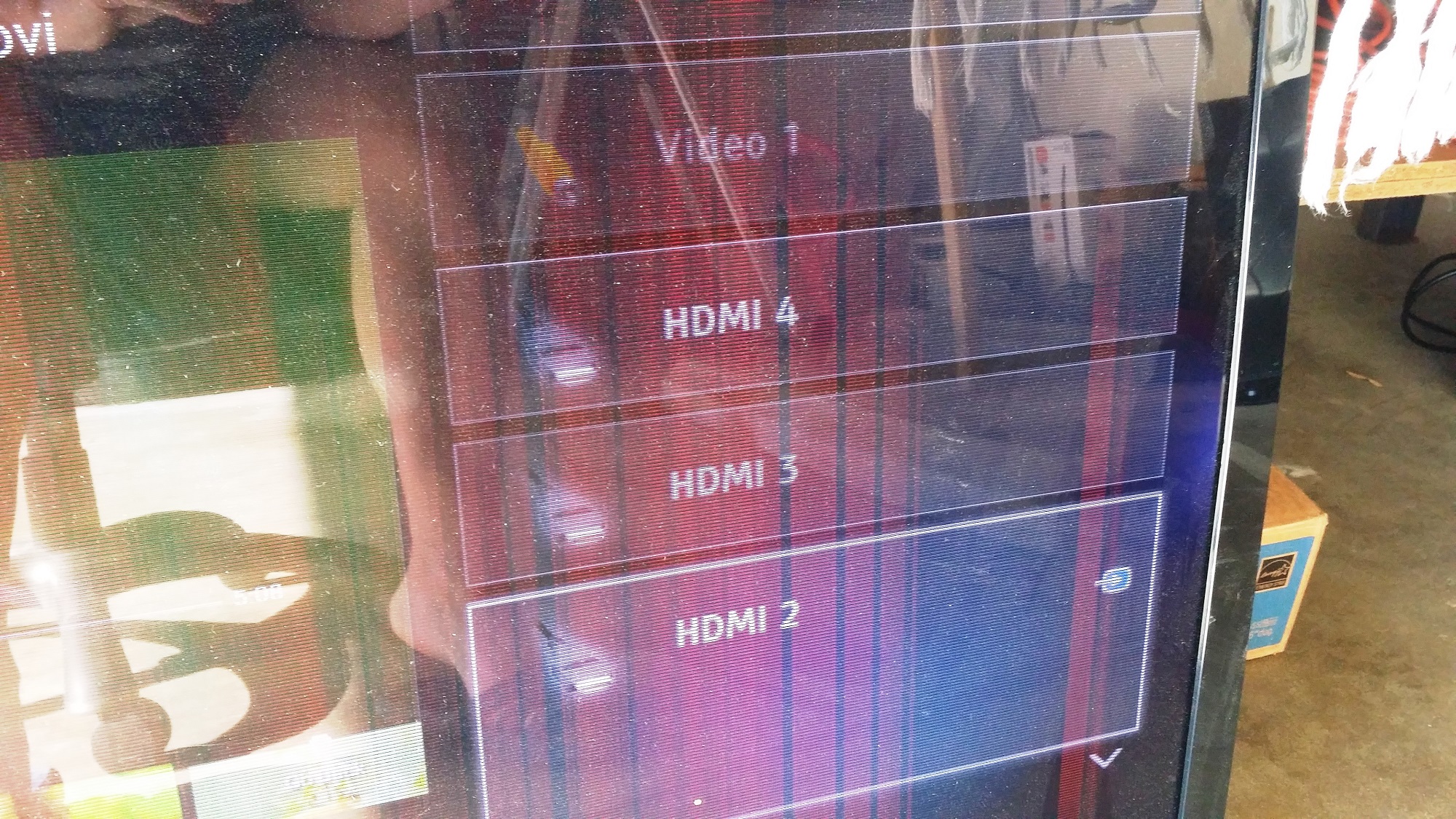

    Sony KDL-46HX729 vertical lines
    I have got this TV for free, from my neighbor.
    It has some vertical lines and I don't know if it's panel problem, or T-con board.
    Panel #LTY460HQ04
  • Shinju
    • Mar 2014
    • 1239
    Re: Sony KDL-46HX729 vertical lines
    Death by Windex!
    Panel!
      Panel, definitely.
