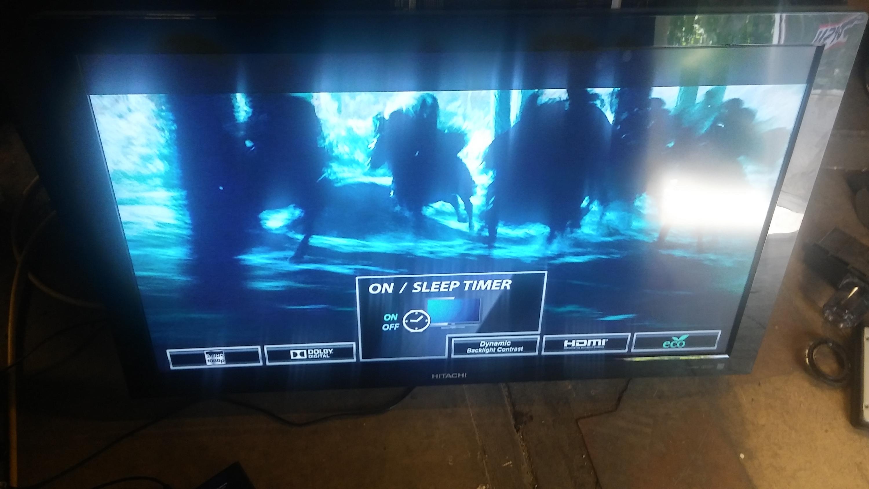

How to remove this menu from screen hitachi lcd?
  • mattstolte
    • Dec 2013
    • 612
    • usa
    I HAVE This hitachi l40a105e don't have the remote but I cant get this removed from bottom of the screen ive tried everything in settings menu
    • 31293
    Re: How to remove this menu from screen hitachi lcd?
    find and download a user manual, it may cover it.
    • Shinju
      • Mar 2014
      • 1239
      Order a remote or find a compatible universal remote.
      • ozy
        • Jun 2009
        • 44
        set your INPUT to TV mode and get the channel numbers displaying on the screen.
        You cannot access it on any of the Video INPUTS got to be on the TV's tuner.
        Press menu....select Setup.....Enter
        Select Auto Setup....Enter...E Pop Demo...enter and turn it off.
        • mattstolte
          • Dec 2013
          • 612
          • usa
          Thanks this worked just like you said
